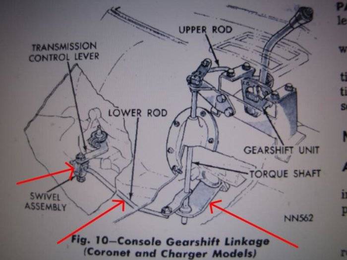

I have found diagrams of both levers, but have not seen a picture with both actually installed. It appears the shift lever may be straight and the steering column lock has a 90 degree bend?

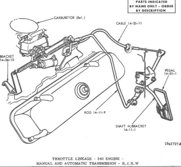

Scroll down the pictures and see if anything helps. Click on the PDF linkage adjustments at the bottom of the page. It has a few pages from the service manual and shows both console and column linkage pictures.

Thanks a ton. That does answer my question. It appears the shifter linkage and column lock attach to the same arm. The lower linkage rod that I purchased may have to be modified or exchanged however. I don't believe the stud on mine is long enough to accept the transmission arm and also extend through the forward linkage to the column lock out.
But again, thanks a lot. Great site, great people.
