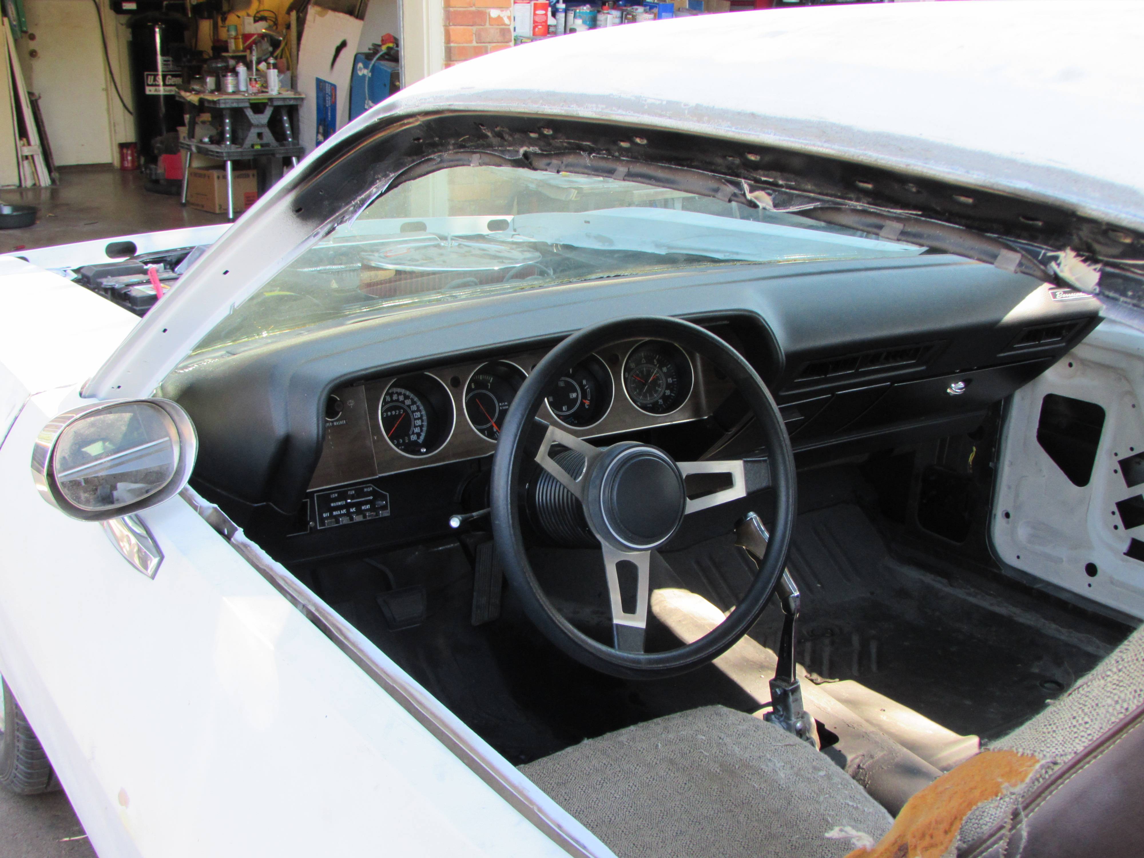

I personally like the tuff wheel. This one is a Grant repro.
Yup, I put the same steering wheel in my Cuda and used the shorter can from an A body. I'm 6'3" and had the same problem with the wheel being so close to my legs.
I used my original steering wheel to mark the holes on the Grant wheel and then drilled them and cut the slot so it would mount on the A body can. It was a pretty straight forward process.
