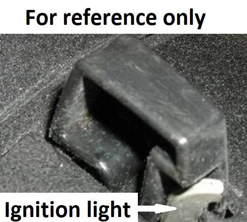

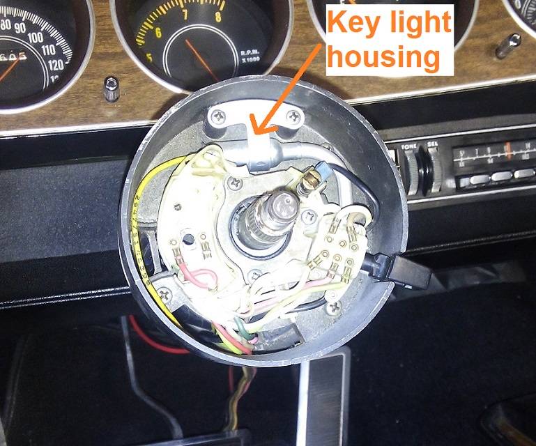

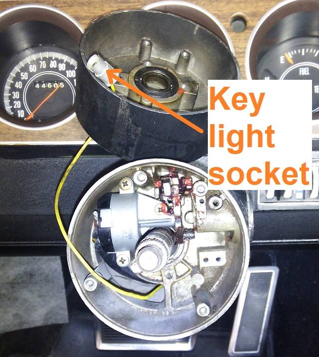

Decades ago I bought a used column for my column to floor shift conversion and luckily it was there. I don't know if my original had one. If your adding one you only need to remove the crush can and probably the turn signal switch. My second picture went deeper for an ignition switch replacement, you don't need to remove that second collar. I recommend using an LED too. Look by the hazard button, if you see a little plastic rectangle sticking out it's there.
Found the other picture I was lookin for. Also, look down the column for that yellow wire.
Thanks very much EW1BH27 for the pictures and detailed info. It will make installation much easier when I get the A01 light package.
