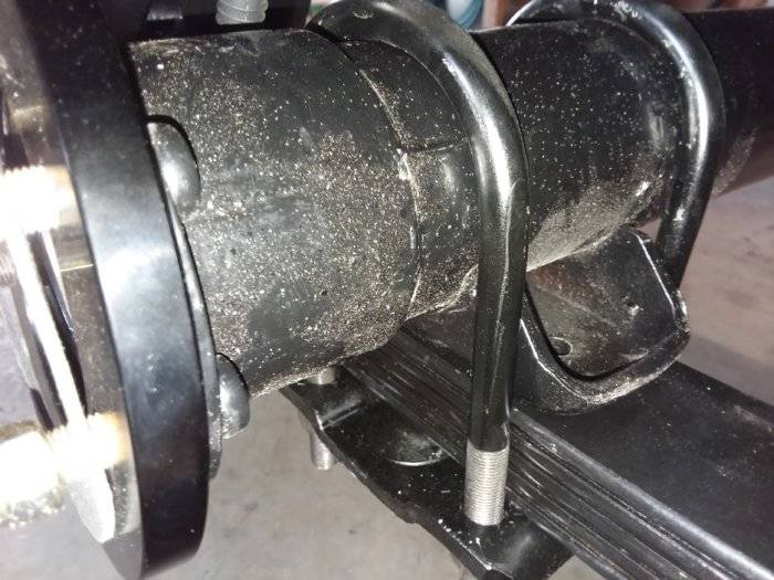

While I was working on the car today, I noticed what may be an issue with trying to use an A body housing. The U bolts are fairly close to the stepped up part of the housing close to the end. With the A body being another inch in, it would be close. I took a picture while I was there. Just one more thing to consider.

The problem is that the outside u-bolt won't fit over the step. If that pad only needs to move 1/2" out, you might just squeak it in without the u-bolt interfering, but you need to measure first.
