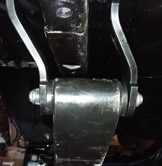

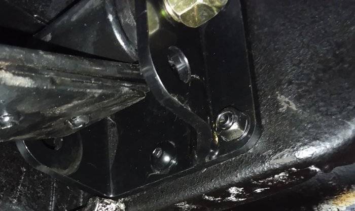

    Just a couple of pics for now of the offset shackle kit installed. The first one in the front, notice where the original 4 bolts are, and then where the bracket is shifted over. Also, notice the two mounting for the front of the spring. It is to lower the car without affecting the spring rate. The second pic is just the rear mount to show how they are offset. If you would like others pics, I would be happy to take them.

    Thanks for sharing the pics. It’s looks real good! So, the perches on the B body housing didn’t have to be moved, right? I like how you dropped it a bit and didn’t distort the spring rate. May I ask what vendor you used for the offset hangers and mounting brackets? It appears that you may get a couple inches of clearance. Very nice.

    Correct, the B body perches line up with no problems. The E body perches are 46 inches apart, and the B body is 44 inches. So, the offset is only 1 inch per side. Also, Cass from Doctor Diff told me that the pinion angle is different on the B verses the E, and I could use the top lowering hole to correct it, or use the angle wedge that he sells if I wanted to keep the stock height. The only thing I have to figure out is the rear shocks will not be standard length. Since the shock plates are moved in, and now lowered, it would bottom the shocks out quickly. It should be a simple measurement though. Here is a link to the kit I used.
