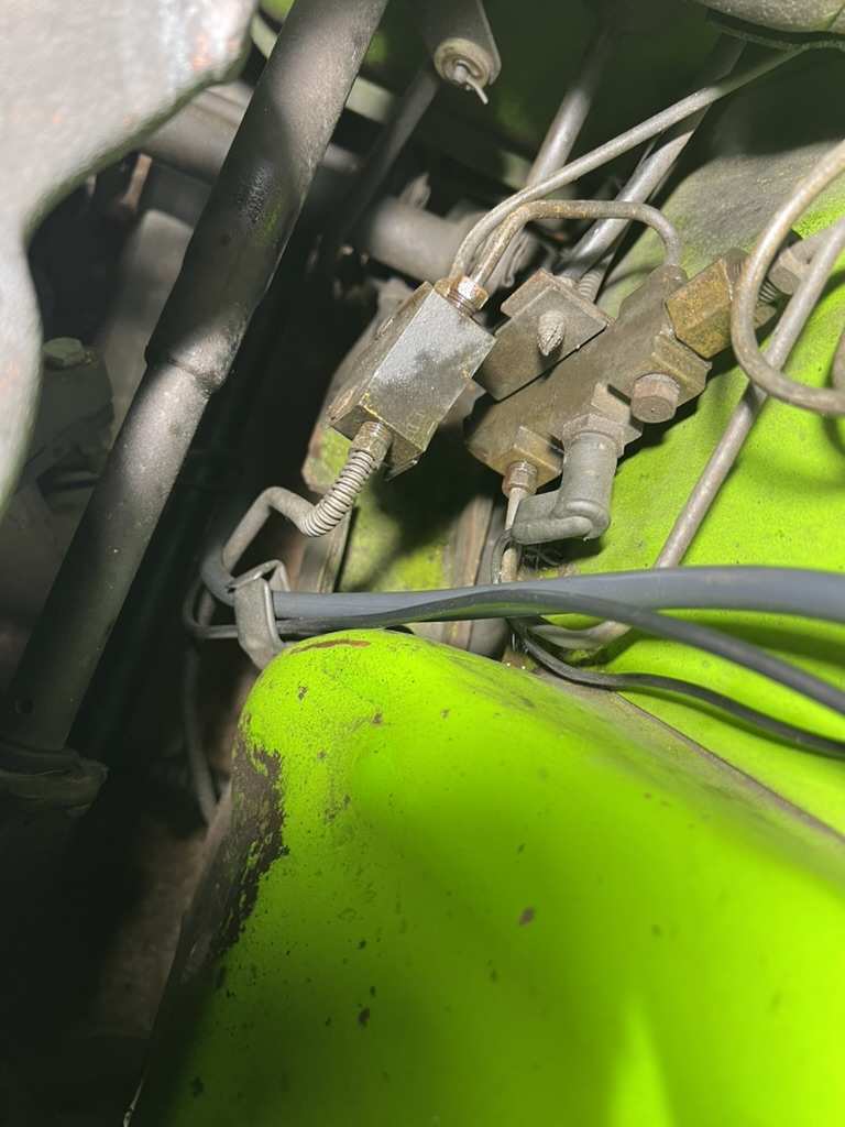

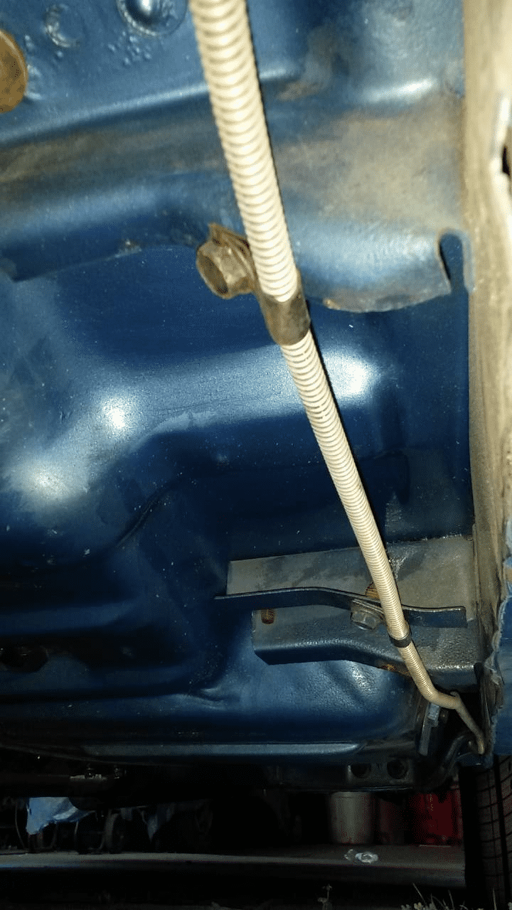

Do I need a 2-piece or a 1-piece rear brake line?

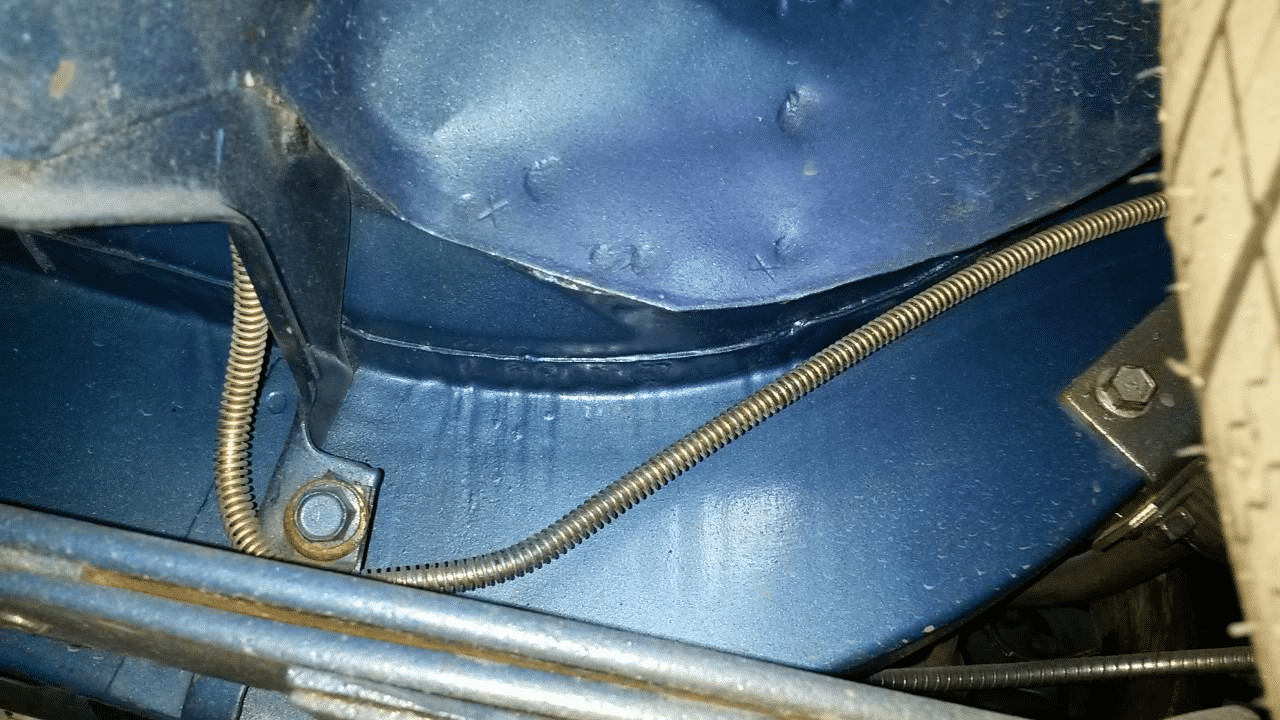

The rear brake line is one piece to the rear axle where it connects to a flexible brake line and then tees off to each rear brake. And use DOT 5 brake fluid in the future and you'll never have to worry about water in the brake lines! 🙂 I've had DOT in my 70 Challenger over 30 years now!

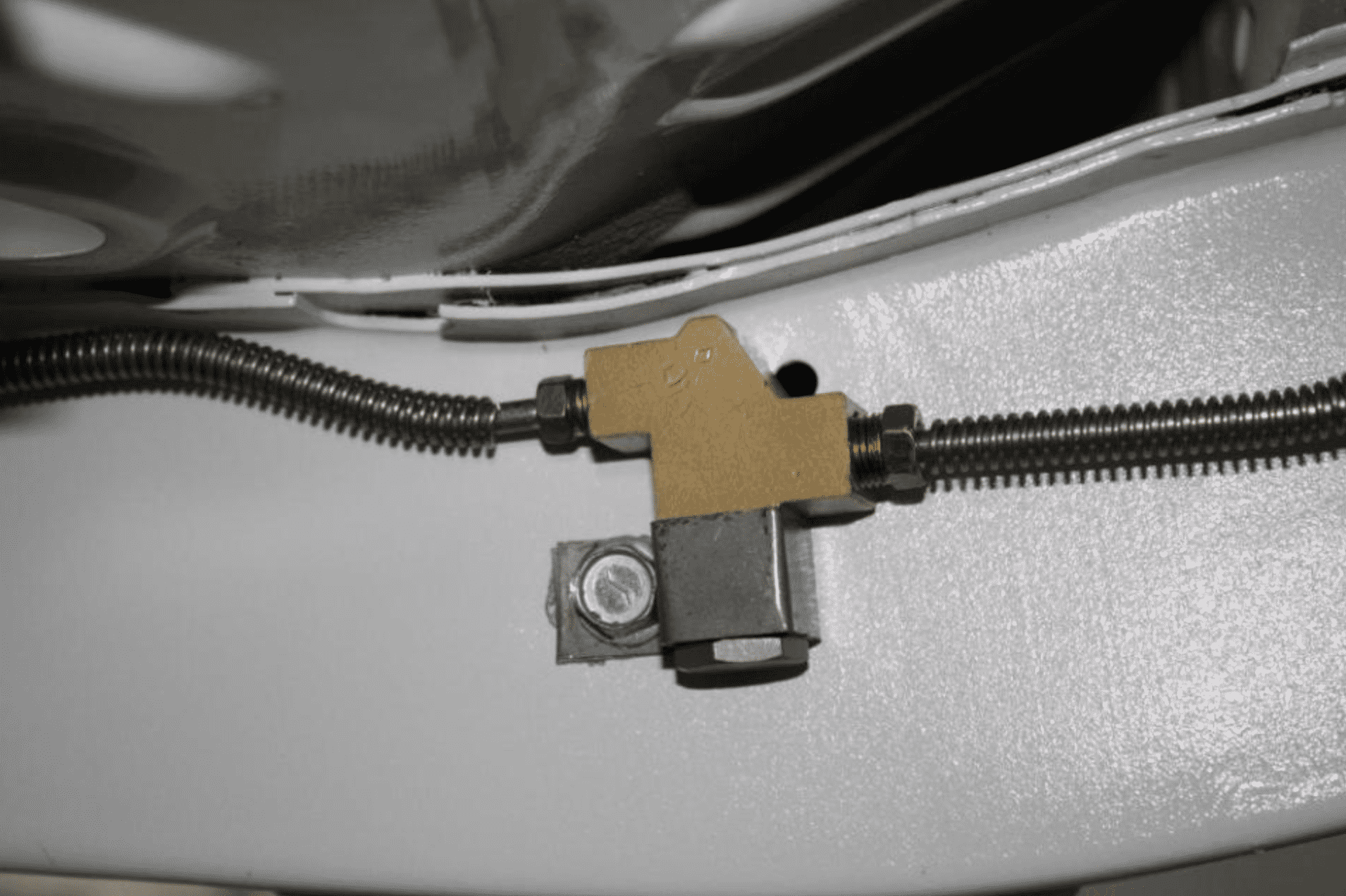

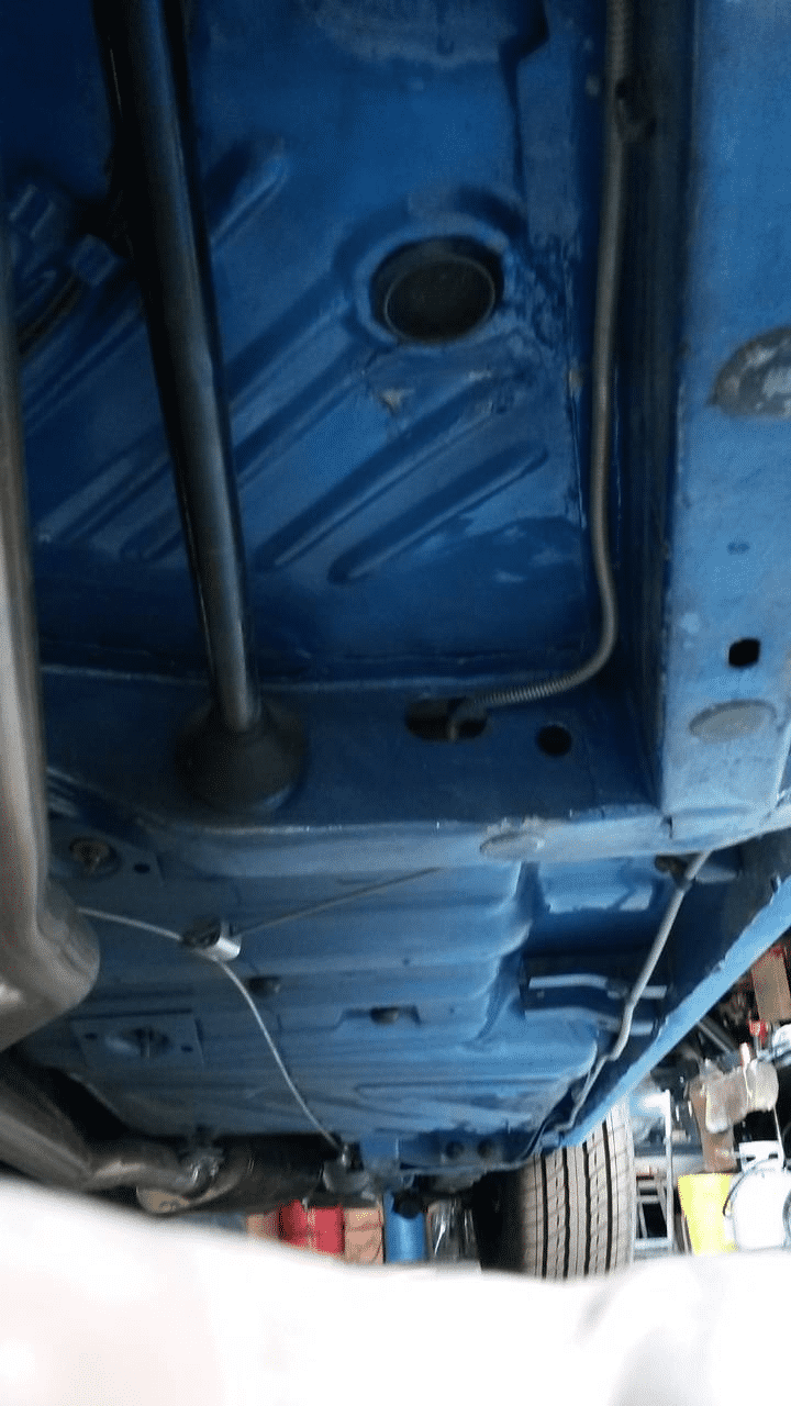

Obash, follow your rear line after it leaves the distribution block. A two piece line will have another brass fitting attached to the inner DS frame rail, maybe 2 feet or so aft of the distribution block that you show in your picture.

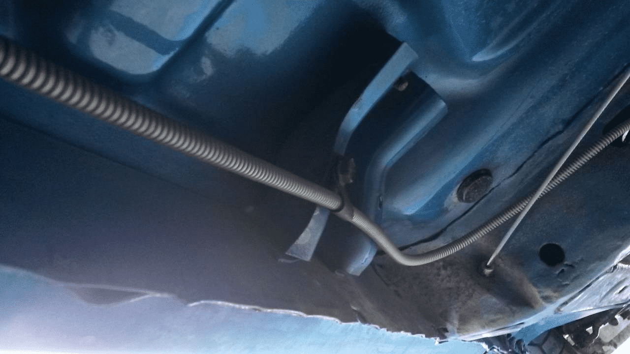

Here's a pic of a two piece line for reference. The front of the car is to the right in the pic.

Jeff K, I stand corrected, but there's really only one line going to the rear. Not two separate lines side by side which I thought he was asking. My bad.

Yup with AARs only being built in the second half of the model year they would not have the intermediate valve.
