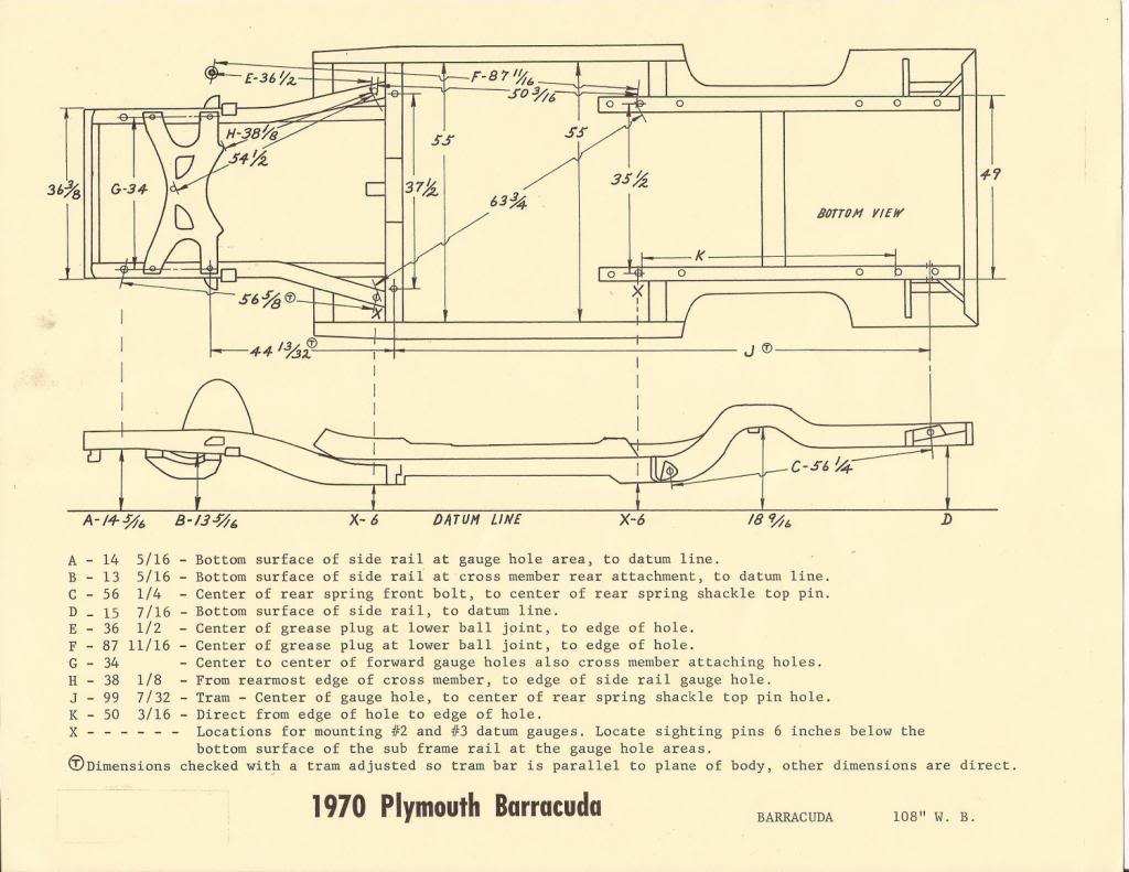

AAR 'cuda
Challenger RTA
Oct 28, 2018
4,536
2,506
PA Flood city
Cuda measurements.
Challenger RTA
Oct 28, 2018
4,536
2,506
PA Flood city
What to look for now buckles and bows. Door gaps, rocker panels, roof, windshield intact. Floor pan did torsion crossmember spot welds pull apart from floor. transmission tunnel pushed or bucked.

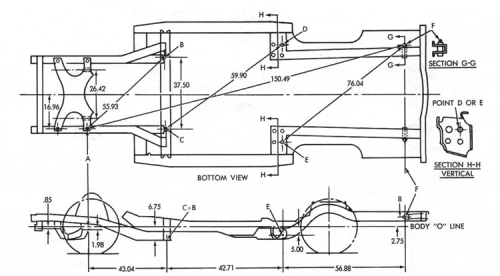

MoparCarGuy
Jun 28, 2020
966
882
Another dimension chart with callouts and more dimensions. AMD has everything needed to build a Cuda from scratch but nice to have.
