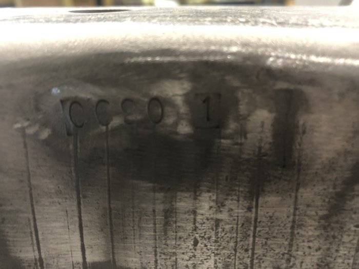

Great chart! Love it! Date code: This one right?
340challconvert
Feb 13, 2011
5,424
2,912
Parsippany, NJ
That is the date code on your k frame
First three digits are the day of the year
and the 4th number 0 stands for 1970
The final number 1 is the shift number.
Hard to read your first three numbers; looks like 068.
If it is, 068 translates to Monday, March 8th, the 68th day of 1970.
That would make sense since the Trans Am Challengers and AAR Cudas were manufactured around that time in 1970.

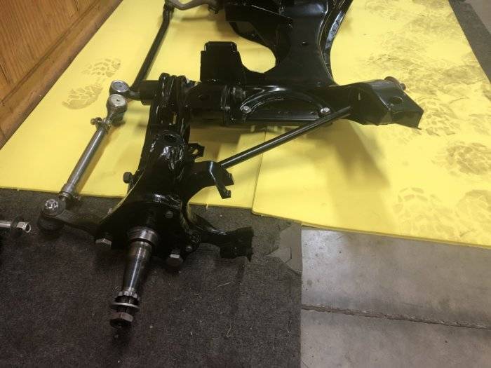

Todays work: Pre-assemble the K member to be sure all components are good to go! Still waiting on new rotors. This will basically go under the AAR for the body shop to move the car for finish body panel fit and to the finish paint area. I do not want all the best stuff under the car only to have over spray on everything! So some will be old parts while other stuff will be new. In any case all will be easy to remove. I am not going to tighten anything down to set the taper or rough up any powder coat if possible! Also note: Power steering will be going on!

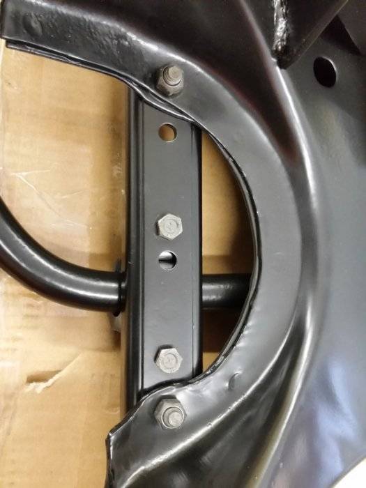

Rob, The brackets for the sway bar need to be bolted to the bottom of the K frame. Don't you just love bolting all those nice clean parts together:thumbsup:

Yes I agree, I reviewed my pix and changed them this morning. Thank you for keeping me on the straight and skinny !
i believe these photographs show correct component locations. Thanks for your help.

One thing I see is the orientation of your front sway bar bracket nuts/bolts are backward from original. Nuts should be facing up for the brackets and down for the bushing retainers. Feel free to check out my T/A restoration thread for assembly line-correct finishes and other assembly photos. Looking real nice man...

Thank you for your info. I will follow any help I can get. Please keep me on the straight and skinny! However you may see on a few fasteners the use of SS bolts and nuts. This is what the owner has requested. So when you see different design fasteners it is a mutual agreement between myself and the owner. I intend on following OEM layout and design. Again thank you for all your help.

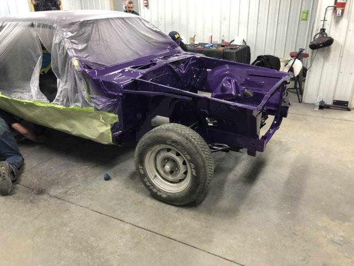

A bit more work is done. The under side is looking very good!

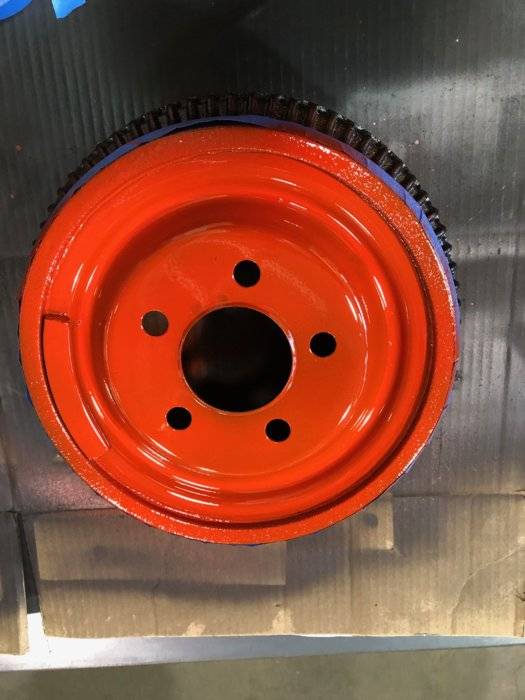

Even though the drums look "orange". I did paint them "red"! My cell phone just "changed" the color!

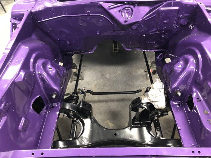

Suspension in basic form today. Installed for roller and finish body panel fit and finish...about six more weeks of quality work to go! So far real good!

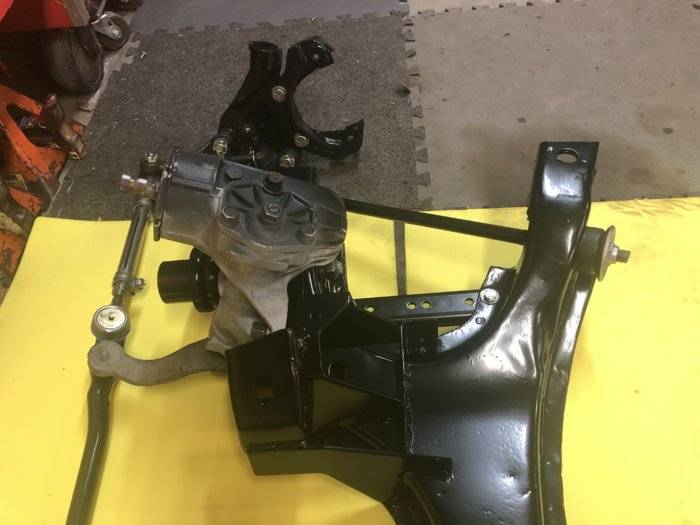

Customer has requested a firm feel power steering gear box. This will be done. In the mean time the manual gear box [original] will be on for moving the car from area to area.

Do you know if it had the quick ratio steering arm from the factory...some did and some didn’t I believe
