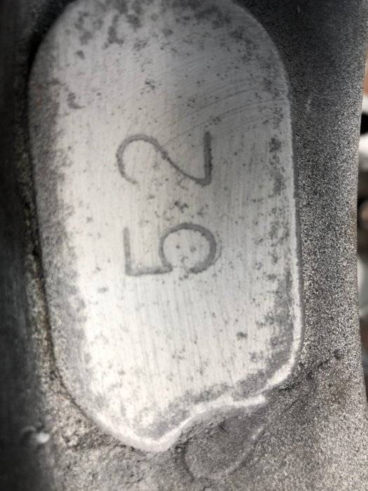

The tag contains the last two digits of the K member part number. Check out this cart;
K Frame Identification
There should be a small round or oval "coin" on the front with a 2 digit number stamped in it. That will be the K-Member part number. There is also a very small 4 digit number stamped near it. Those small numbers is the date. The date will be like 3229 = 322nd day of 1969.

Your "52" coin would indicate crossmember # 3583052 for the above mentioned engines. There is also a date code on about the center front of the k member
