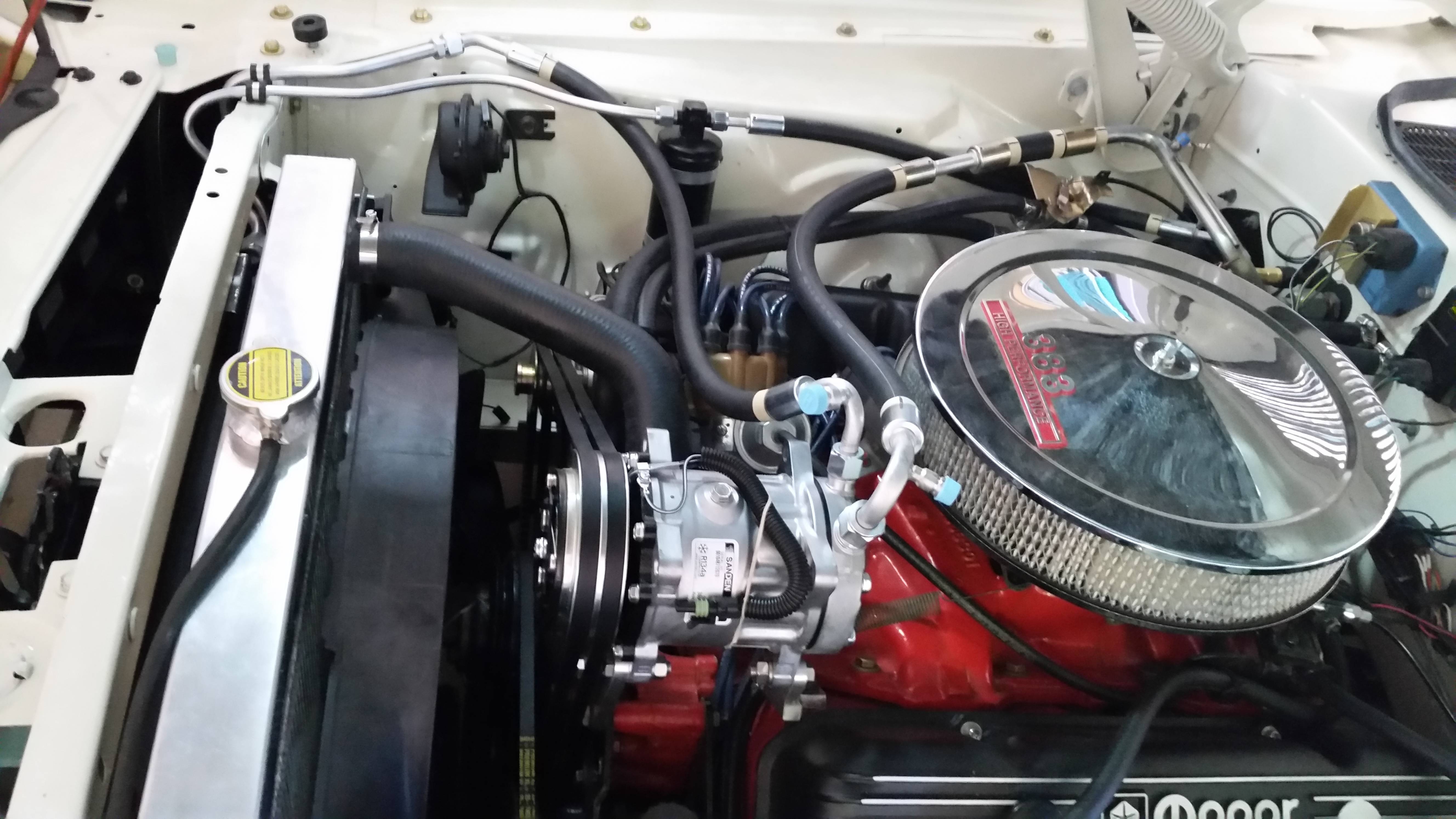

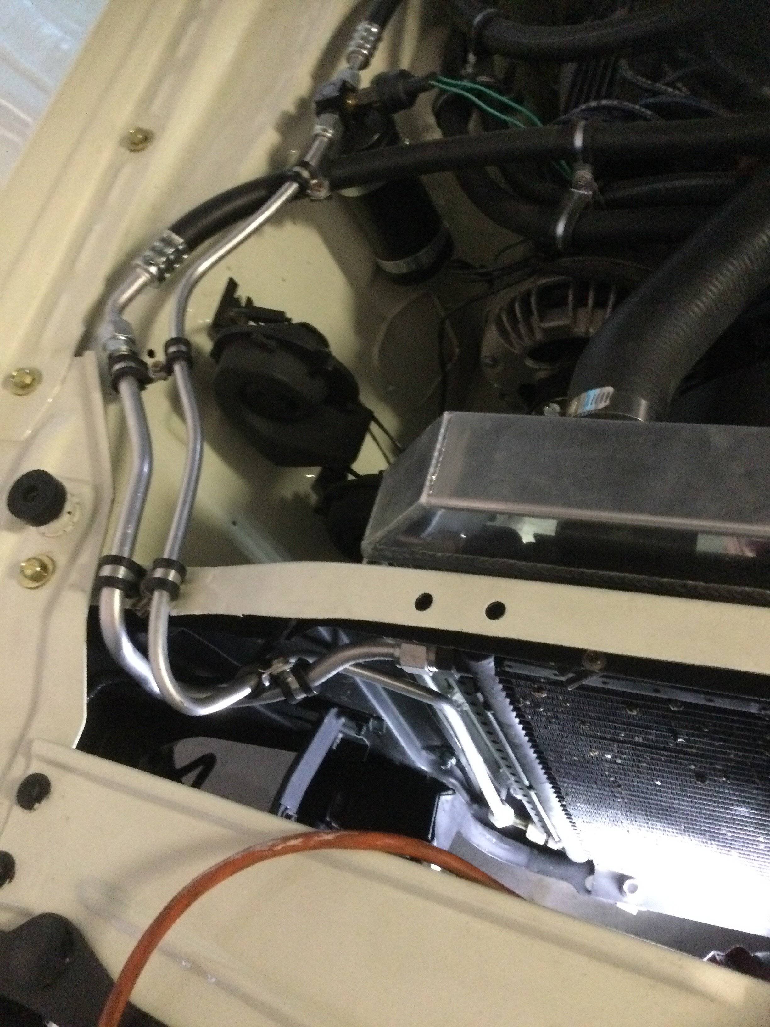

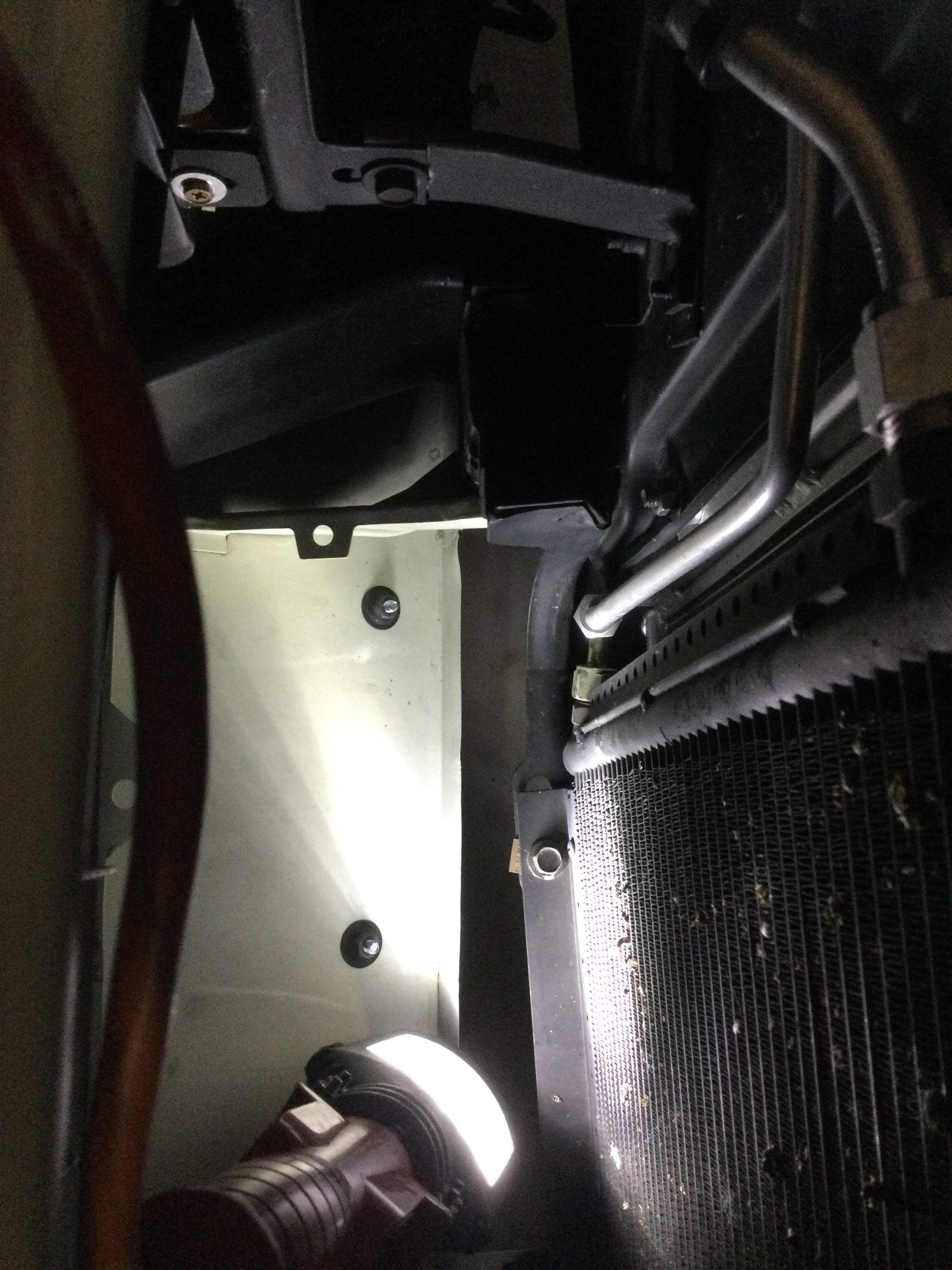

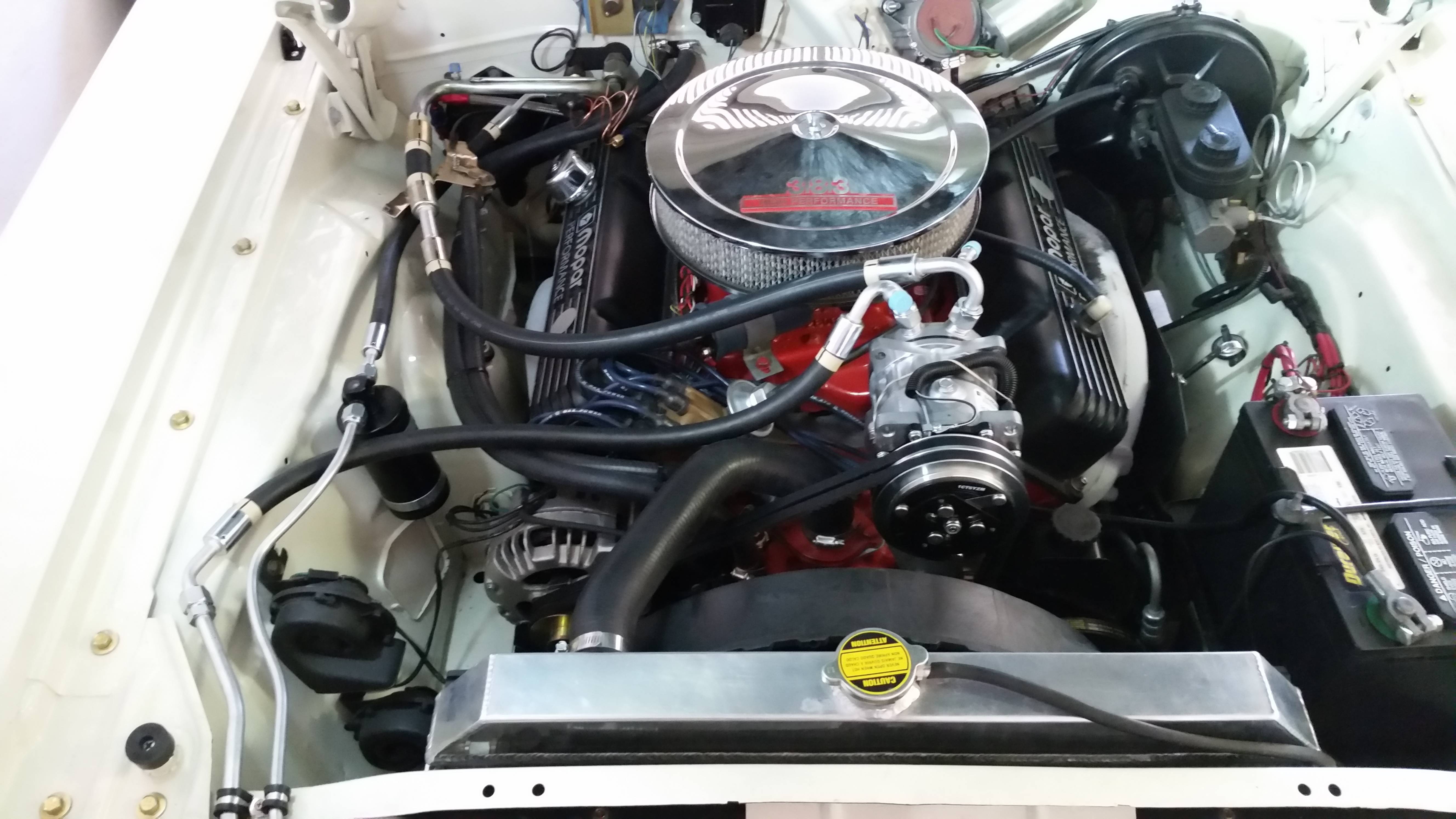

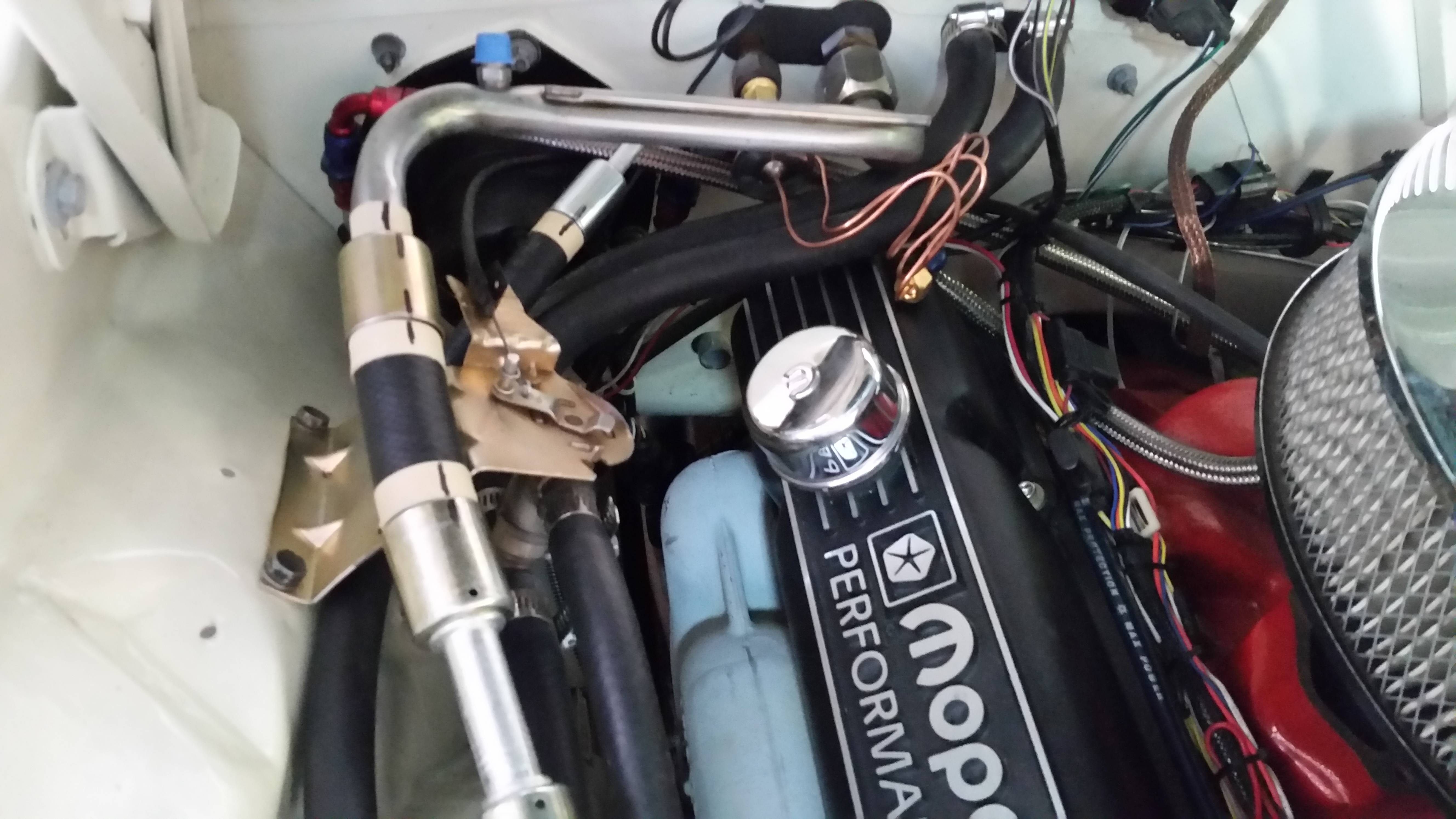

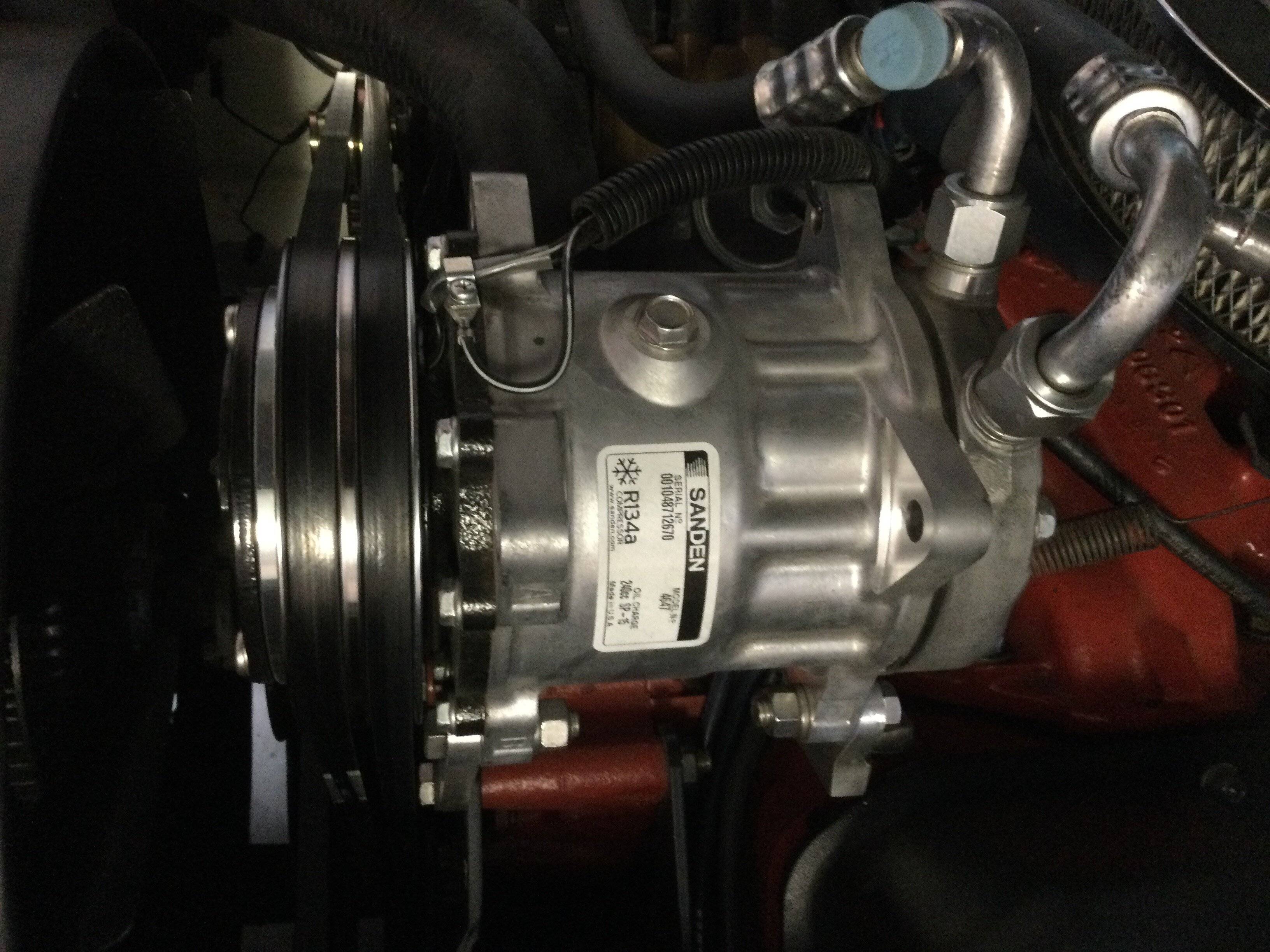

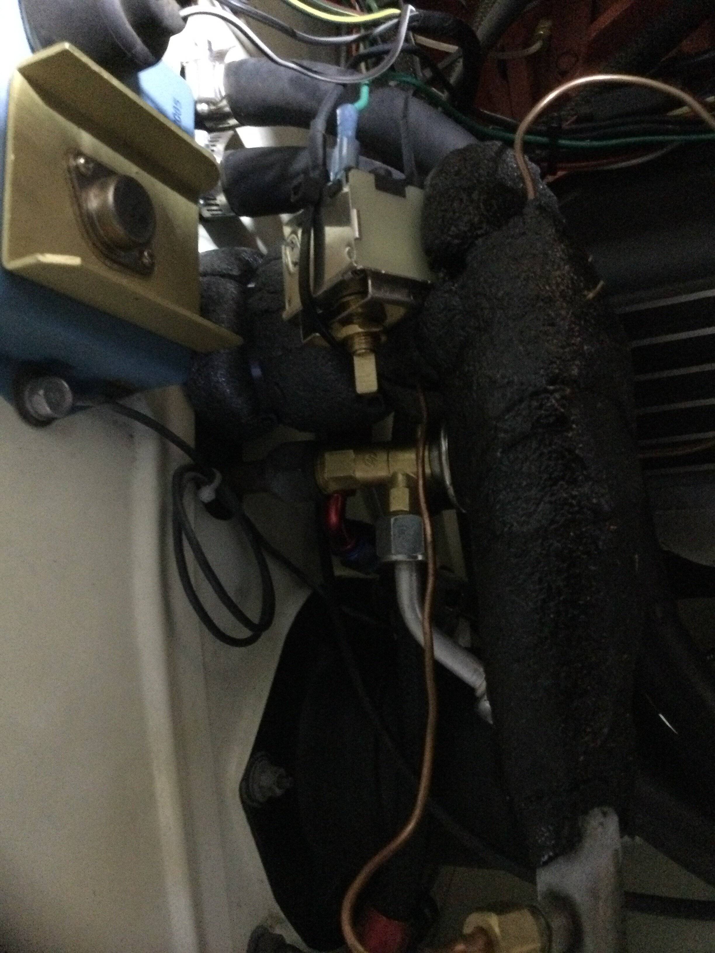

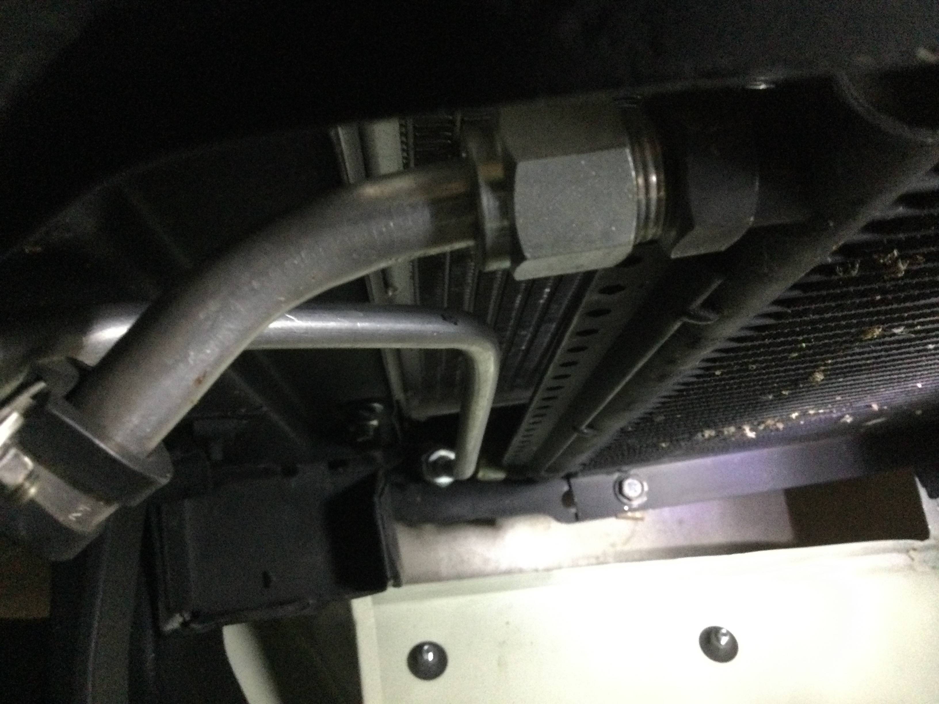

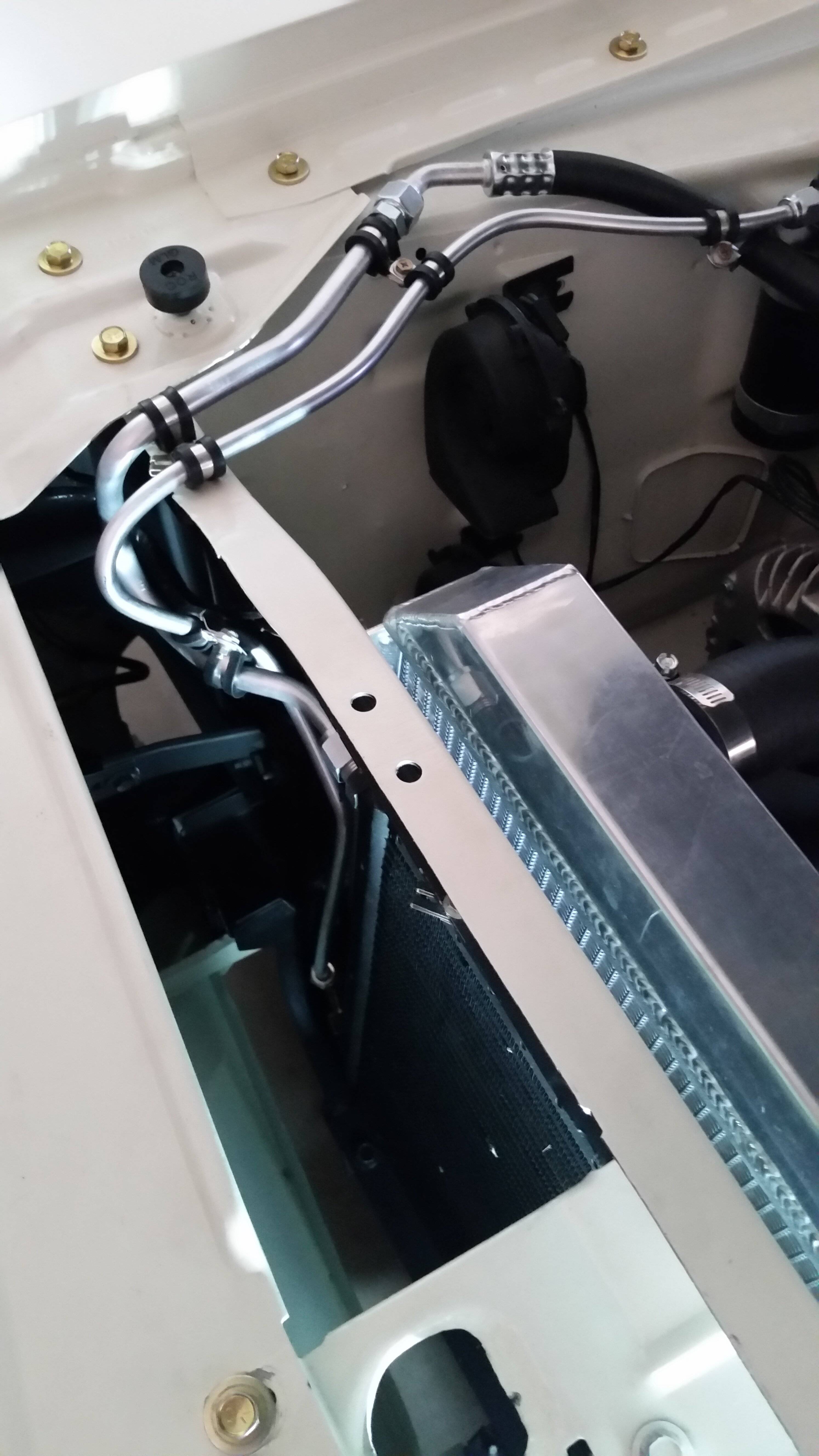

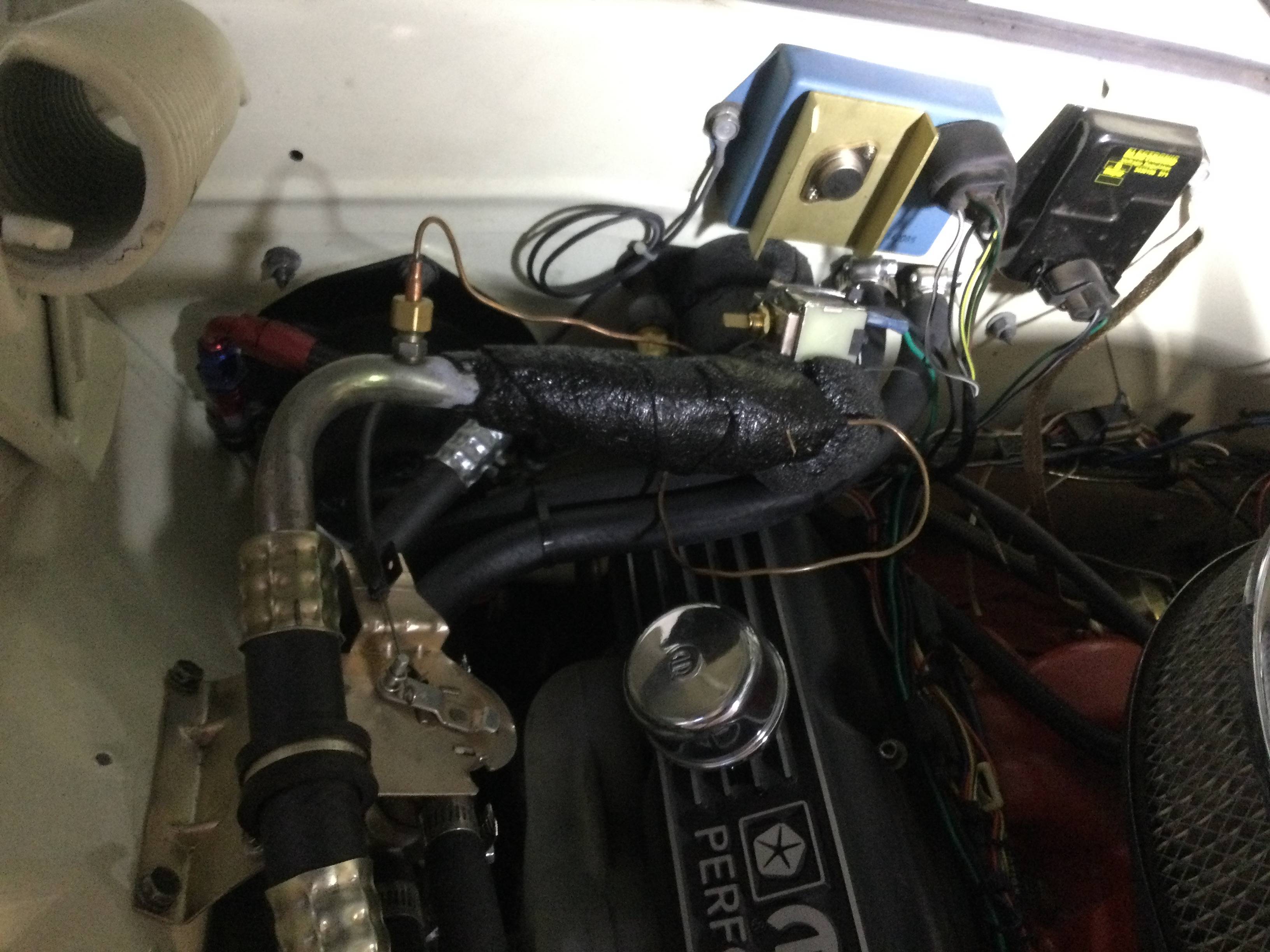

Scratch Build Auto AC System
However chooses to build their own AC system can alter as many things as you wish, I came up with mine this way.
I extracted the hard piece of tubing from the suction hose just off of the expansion coils at the firewall. To me this only made sense to use this piece to install the expansion valve. Use a expansion valve # 38844. I used an adapter to reduce that piece of tubing from a size 10 to a size 8 that will connect to the compressor. This piece of tubing is where I installed the system cycling switch. You can also install it inside the heater/AC box inside the car just aft of the expansion coils. Your system will need this switch, believe me, this system will work so good it will freeze the expansion coils up and no air will flow into the cabin of your car. There are different types of cycling switches with adjustable settings as well as per set temperatures. I’ve posted pictures, see pics.
I purchased a hose kit off of eBay that had all 3 sizes of hose that would be needed to construct the system. It came with o-rings, Binary switch, and drier. If you choose, you can use all hose for the system but I chose to use some hard lines on my system, I just like the likes of hard lines. Hard lines can also be purchased from eBay, summit racing, or jeg’s in different sizes and end combinations to install to you liking. Now if you’ve never formed hard lines this may not be a choice for your system.
Again I used eBay to acquire the condenser, CNFP16 x 24. I attached it to the radiator from support with small “L” brackets, use your creative ability to make it look good to you.
Now for the compressor. You can use any brand you wish. I’ve chosen to purchase a Genuine Sanden compressor # 508. The prices very a lot so this is one of the ways to really cut down on the expense of the system. Also take into consideration your belt drive system of your engine, either V-belt or serpentine belt, that makes a big difference but not on the price.
There are many different styles of compressor mounts that fit on small block, big block, relocating the compressor to a lower position to hide it from view, you will be designing your system the way you would like it to look. I used the existing single wire that comes off of the bulkhead to make a complete lope through the cycling switch to the Binary switch and then connect to the compressor, this will power the compressor clutch and energize the system.
Here are some pictures of my system up close so you can see what I’ve created. Ask questions if you need.
