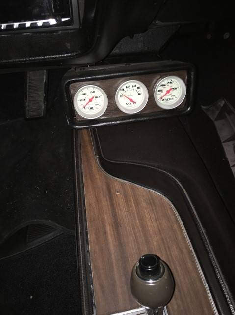

I built this for my 70 Challenger and really like it. I pretty much use Autometer exclusively but have used a variety of others, find a look you want and that will compliment your interior. The gauges in the picture are relatively cheap Equus gauges I got at O'Reillys but have since replaced them with Autometer units.

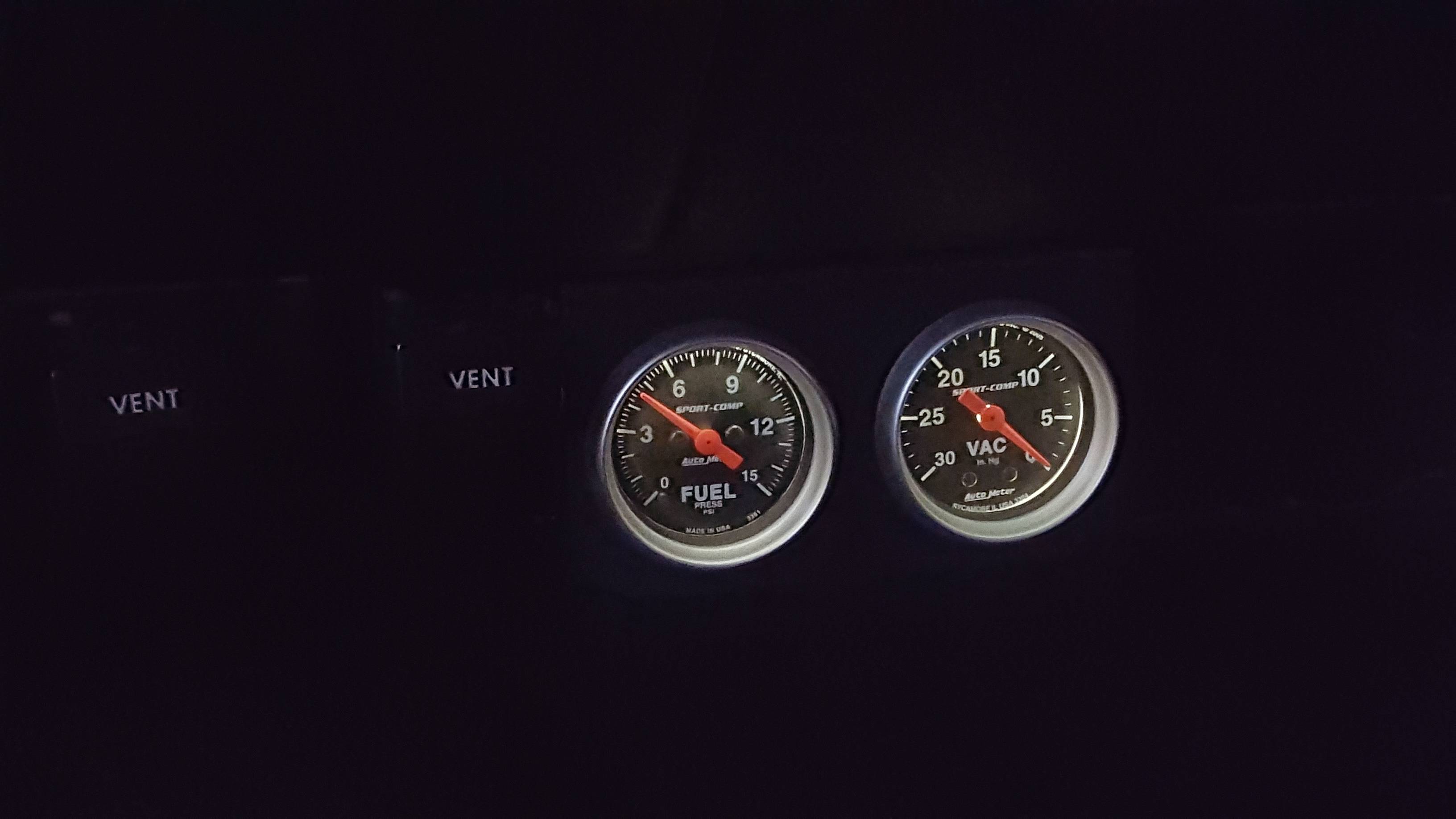

I added a vacuum gauge and a fuel pressure gauge. I picked Autometer gauges that matched the stock white on black format. Then, I used a two gauge mounting bracket, also from Autometer, but transferred the hole pattern of the holes that were already there, so I didn't drill any new holes. I also drilled and tapped a nut plate from some scrap .25 thick 6061 aluminum, so I didn't have to hassle with individual nuts and washers inside the dash frame channel. You can see where the gauges are located, relative to the vent controls. Next, I used the green bulb covers, supplied with the gauges, to match the stock lighting, although the green doesn't show very well in my picture. Last, I wired the gauge lights to the orange wiring that is controlled by the factory dimmer for the gauge lights, so I can dim the new gauges the same as the stock gauges.
