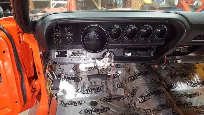

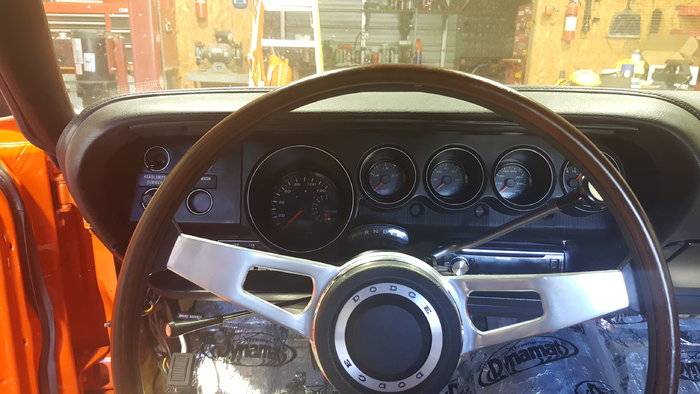

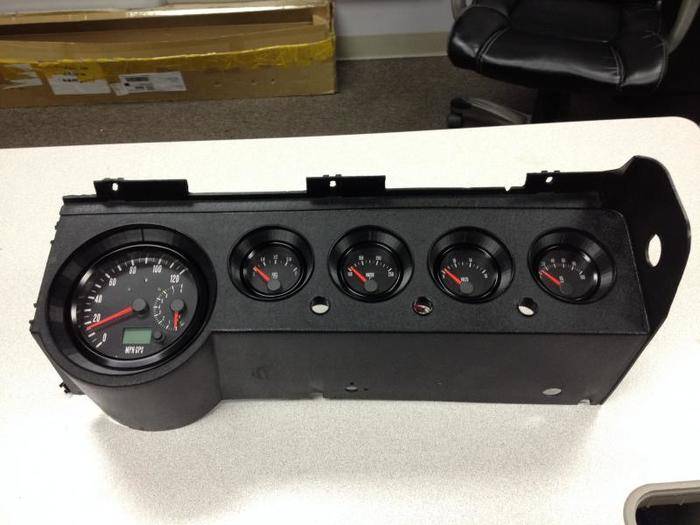

I have been working on installing SpeedHut aftermarket gauges in my non-rally Cuda dash.
Here's a shot of what it looks like. I used 3d printed gauge sleeves I designed and had 3d printed from ABS plastic.
And what it should look like in the dash.
Cheers!

rbbruno3, that looks awesome! I believe you have achieved an oem looking assembly using aftermarket parts.
Cheers!

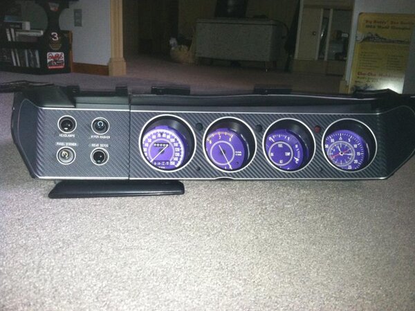

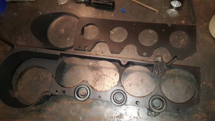

This was my first crack at customizing my 71 Cuda Ralley Dash. I'm not completely happy with the spacing and will probably do it again when time permits. It wasn't that difficult since I had a spare dash frame to modify.

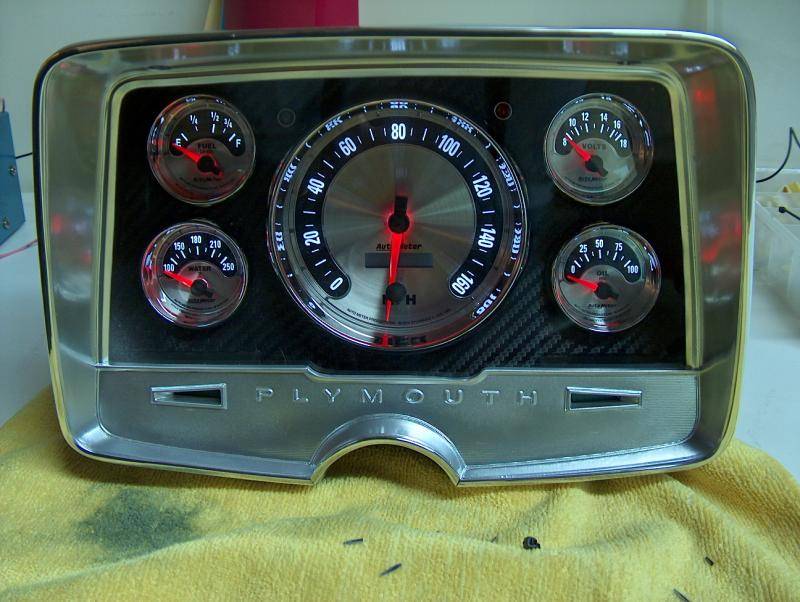

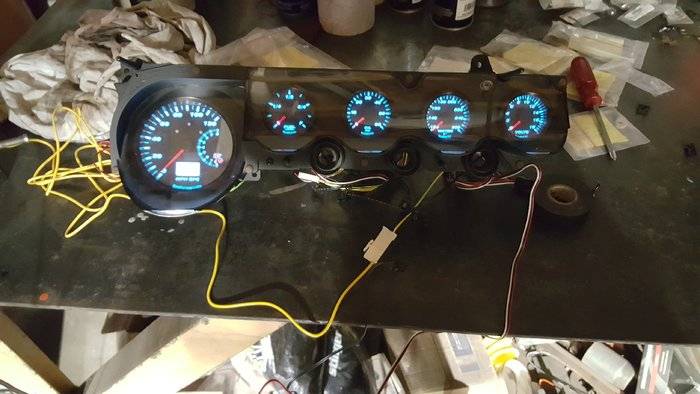

Some after market gauges look really slick like the ones posted previously. Many of these gauges are back-lit and are hard to read during night driving or have a "yesterday's" yellowish illumination. I will say with certainty that Autometer's new gauges certainly are visible and if they're a bit too bright Autometer sells a dimmer. Here's a reworked speedo head using their gauges.HPIM3780.jpg

Is the gauge panel (dash) all made with a 3D printer? Is it a big job to 3D print a complete dash frame from programming to finished frame?
No I designed and 3d printed the sleeves that are holding the gauges behind the OEM dash. It would be very pricy to 3d print the entire assembly.

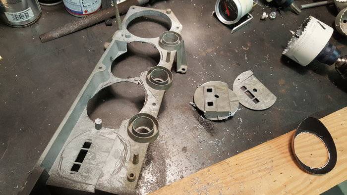

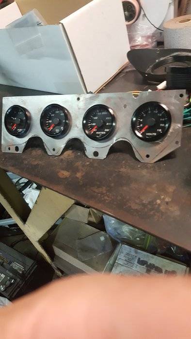

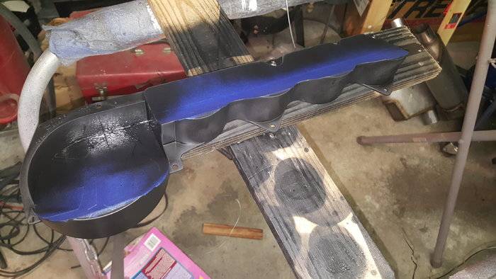

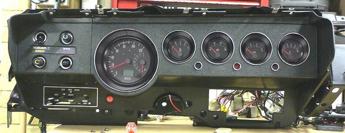

Here's mine off a base 70 challenger. Used stock cluster including the clear lense and assembly. Just did a little drilling,made the panel and installed speed hut custom guages.
Jimmyspeed59
Jun 2, 2017
67
29
What i liked about it is that I was able to retain the stock cluster for easy installation or removal and kept the stock brake, oil,temp lights. Also without cutting or hacking the dash or plasic dash bezels. Even kept the factory light bar above for additional lighting and everything is dimmable with factory dimmer switch. The speedo has 8000 rpm tach and is gps controlled for very accurate speed indication regardless of whatever gear or tire combination. The antenna for the gps is small and magnetic so I tore out the paper off the front center speaker and stuck it to the speaker frame, covered it in black cloth to look like a speaker then installed back in center stock speaker location. Totally hidden but has clear line of sight through windshield with no wire showing anywhere. Very clean and stock install for the low low price of 700 bucks. Hopes this helps fellow e body memmbers.
