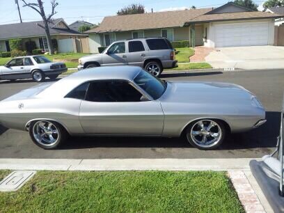

i had my challenger aligned by and old school guy not to long ago .. he doesn't use the lasers and machines like most shops have . I took the car over to him because most wont touch my car because its lowered and has billet wheels however it still doesnt feel right .. seems as if it likes to wander when it goes over a slight bump or at high speeds .It doesnt pull right or left and according to him the camber is at 0 which he said is maxed out on adjustment for my car. he dosent have a problem re doing it im just wondering where he got his specs for it .. thanks for you help guys ..
8D69DA31-C92B-4383-9123-19DFB01CB561-1074-00000013186294F8.jpg this is how how low it sits

Actually there are no specs for a lowered car. Your wandering is because of caster. Unless you replace the upper control arms with longer aftermarket arms you will never get the alignment even close to what you need. Remember that the suspension was engineered to have the caster and camber angles set a certain ride height. Whenever you change the ride height , all of the angles change. The factory can only the engineer the suspension to have a limited amount of adjustment. You will never get a proper alignment as long as the car is lowered. If you insist on keeping the car lower than stock, you have a few options.
Number one, replace the spindles with special made lowering spindles. This lowers the car without cranking the torsion bars down , which just bottoms out the front suspension causing a lousy, hard, unstable ride. The custom spindles lower the car without changing the torsion bar setting or affecting the normal amount of suspension travel that was built into the front end.
Number two, is to replace the upper control arms with tubular aftermarket control arms. There are several companies making them. They are designed to give you more caster and camber adjustment to make the front suspension feel more controlable.
Any time you try to reengineer something on the car, you are just going to cause problems that must also be modified.
The domino effect.

i understand what your saying here however it was just as low before , but it had a some negitive camber something that doesnt matter a whole lot to me .. and it steered just fine didnt pull and drove straight . maybe ill get some upper arms i know that will take care of the ball joint issues and most of the alignment on it but for right now i know i can get it to not wander around..

this sounds more like it .. its not that low if you look at my upper arms , they are angled up just a tad ill give these specs to the guy who did it and see if he cant do it again....
