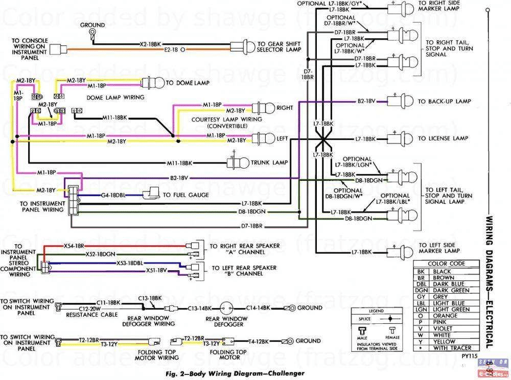

Look at the colored diagram I posted. Unplug the connector under the column.

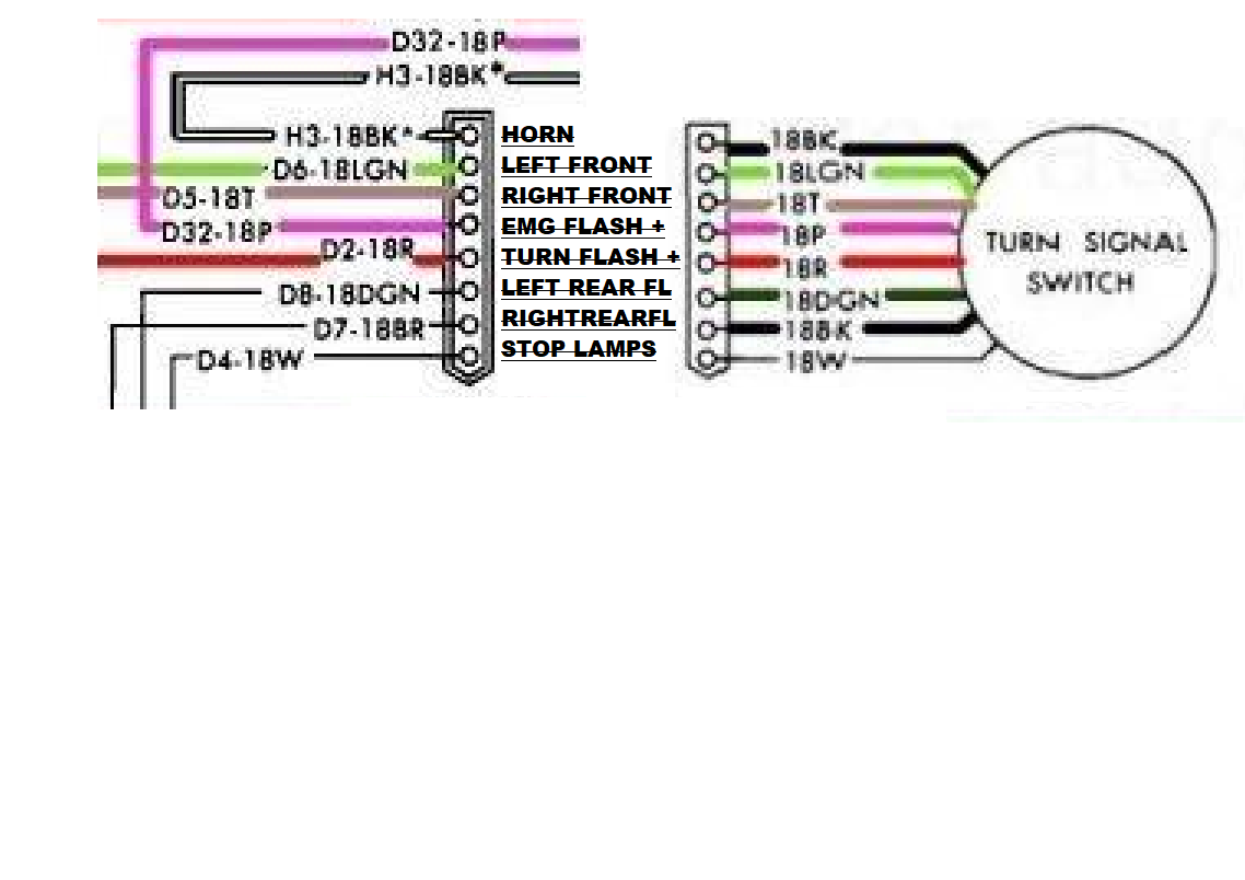

Check if you have power to the EMG Flasher and Turn signal Flasher. Use one of those powers to jump to each connector. You may see a small arc. The horn needs ground .touch to ground.You will here it. Then touch to each connector as someone watches would be a help. This way you will know if everything else is in order
Everything goes through the TS switch , pink to the brake switch , white up the column to the switch , then 4 wires out to the 4 corner lights the brake lights should activate the 2 wires at the rear & interupt with signals , , 2 wires for each turn signal L&R , and all 4 wires with hazard lights .
If you short the 2 wires at the brake switch the white wire up the column should be powered

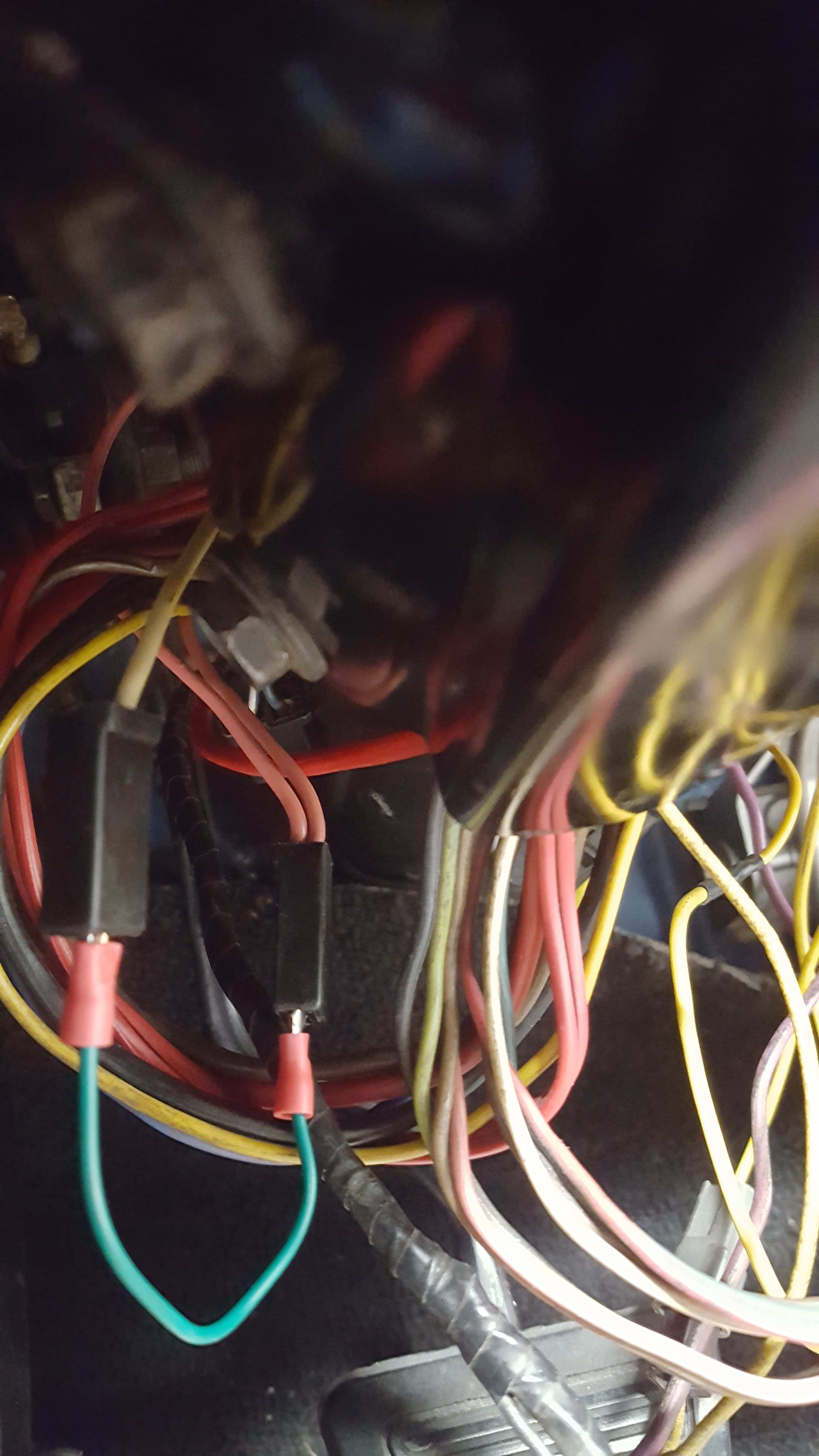

Short cut. Unplug the wires from brake sw. Put a jumper in see if they work.
This is the plug under the column.
This diagram is an in general diagram for pin out connection. Not for wire color code. Don not follow. Could be GM Ford or other.

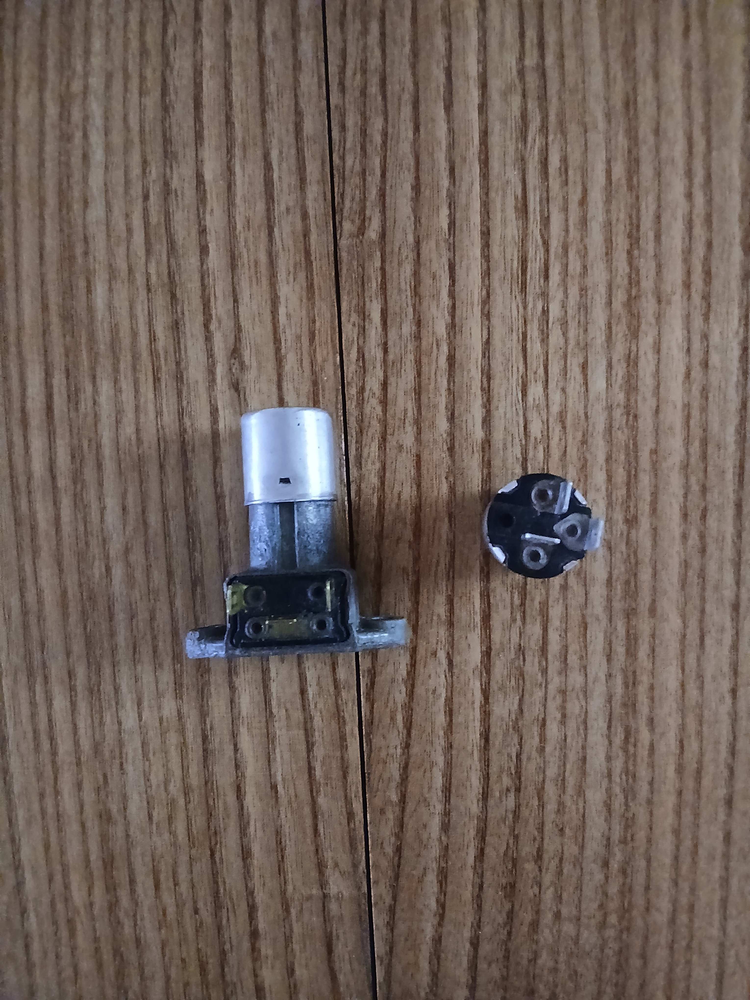

It definitely was the ground!! Thanks for the help you all. Now I got a bad dimmer switch, and flasher. Looking for a place to get them quickly.
