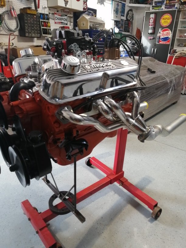

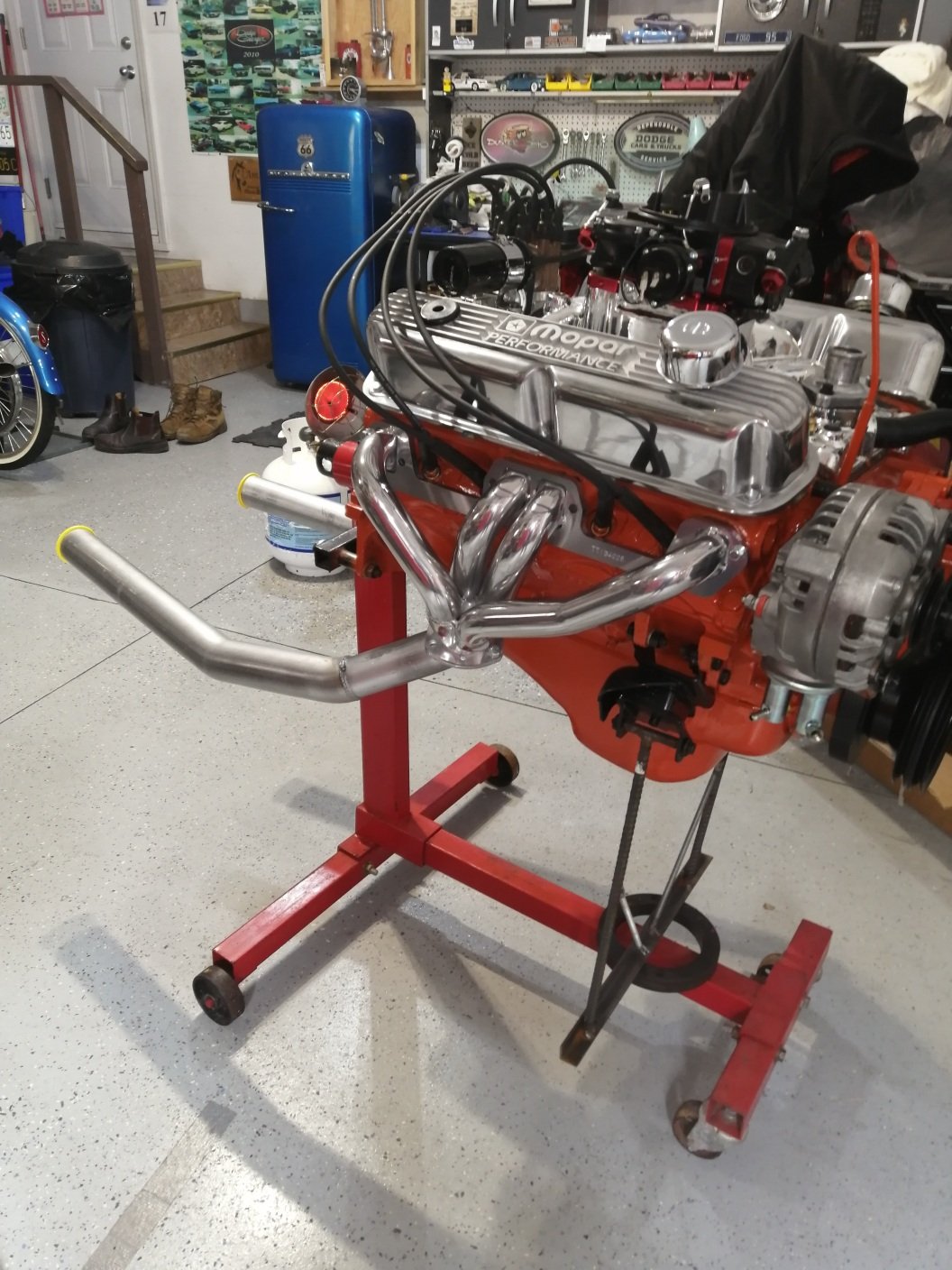

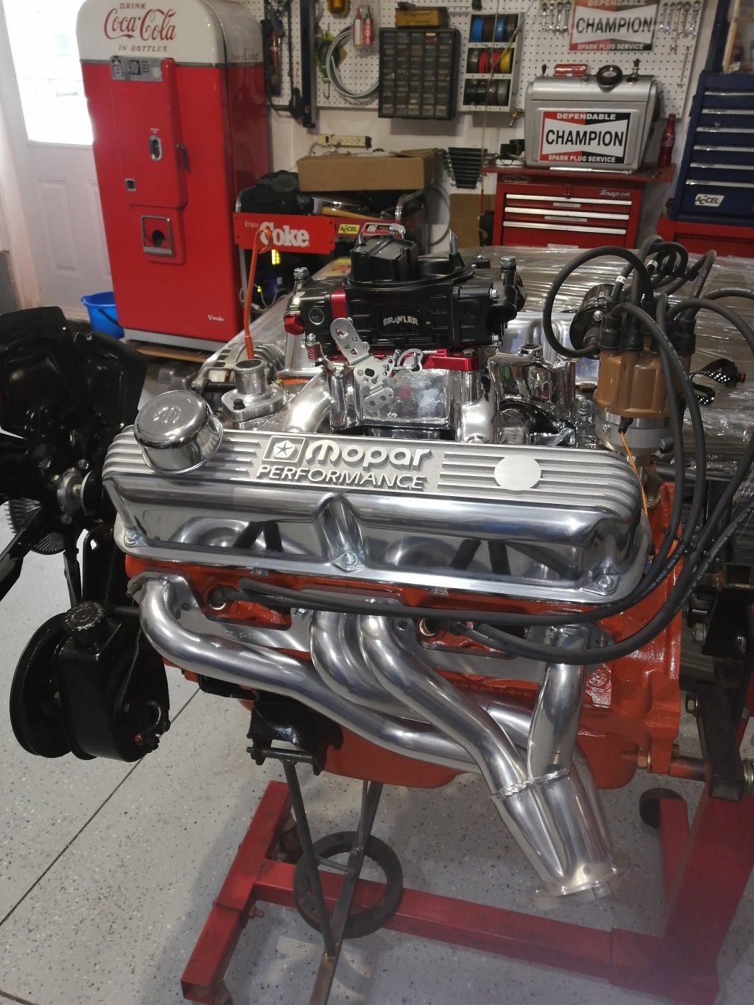

If you're going with the shorty headers, they only come in 1 5/8 tubes.
I personally have not used any small block TTI Shorty Headers, but the long tube headers sure fit nice. No issues with the oil filter or Mopar mini starters. Some aftermarket mini starters have weird electrical posts that require an adaptor. If space allows, I highly recommend some kind of insulation for the starter. Headers, even shorties expel a lot more heat.

Shorty headers should be better! And adjusting TTI headers to not hit torsion bars is not uncommon. In TTI's defense, they designed their headers for Mopars built to dimensions! However, we've found out some of our Mopars are half an inch (or more) out of specifications!! Thrust me, Shivvy and Phord were worse!!
