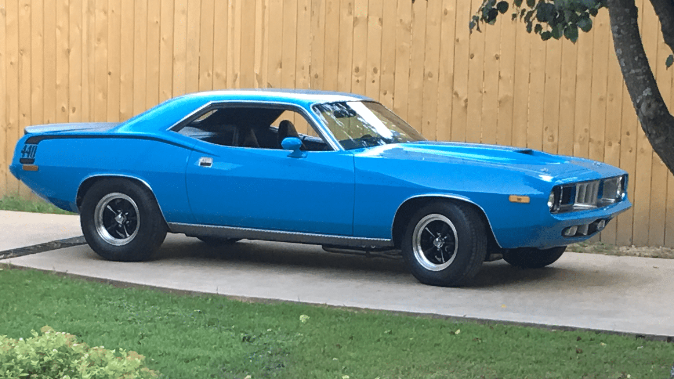

I’m running the 275-60-15’s on the rear. 215-70-15 on the front. They aren’t super stock springs but, HD if memory serves. This may not be the downward front stance you’re wanting, just sharing what I did. Regular duty shocks.
