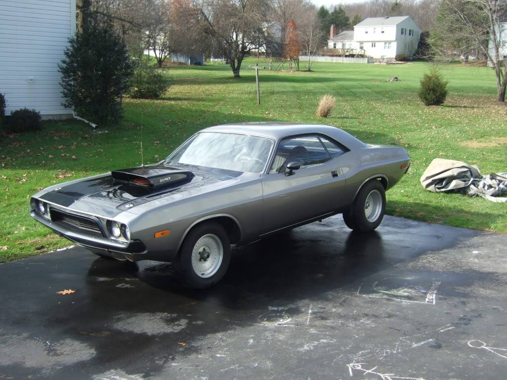

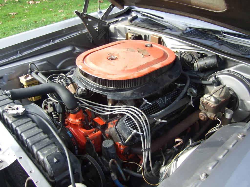

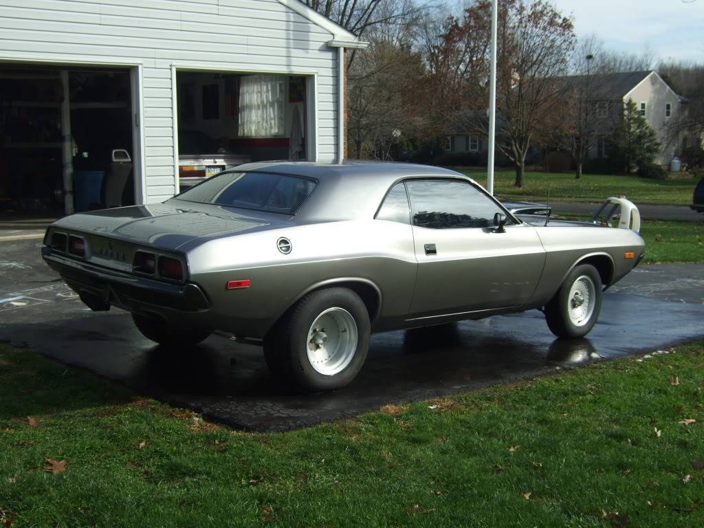

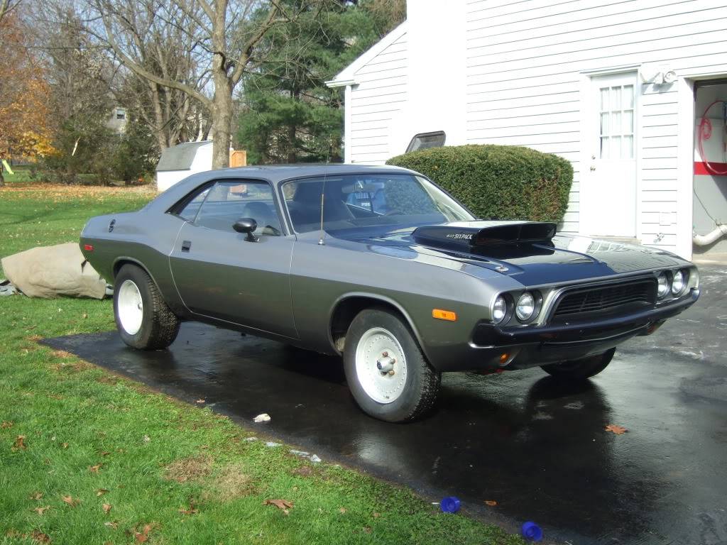

Here are a few pics...
I like the driveway drawings. It reminds me of when my daughter drew them everywhere.
If you are not sure what the engine is, it's not going to get you anywhere trying to decide if headers will make or break it... However, in terms of costs... If you're looking for a set of factory manifolds you're likely to spend upwards of $250-300 for them. Then you have to but the studs and nuts, the nuts are unique... then have the pipes extended up to meet them. By the time you are up and running, you will be within a couple hundred bucks of the TTis, and more money than the cheaper sets. You have a mid-grade set of headers on there from the looks of them. Are they leaking, or just rusty? My truck's cheapies are 8 yrs old and rusty as hell, but don't leak. If you're concerned with the visuals, it might be ok to wait a year and get something then.
