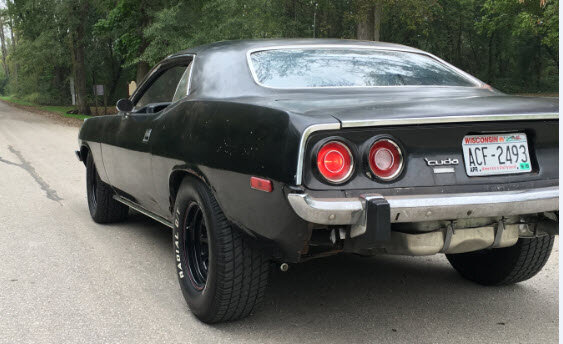

Hey I have the same problem you have. The tire I want is a BF Goodrich 295 /50 /15, But my problem is they only make that tire in a 15 inch rim size passenger tire , I need a17 inch rim because I have add big rear disc to my car . I don’t want a rubber band tire real low profile , The tire I want is a 295 /45/18 aSUV tire. The wider the tire you want your rim size goes up and your profile goes down 45/40/35/30 , 18-19-20 rim size, I’m looking at Mickey Thomson tires , I want to do some auto cross so I want a High Performance Tire , not all tire manufacturers offer the size and profile I want and the prices are $250 to $ 500 a tire !! I’m going to rethink what I want, Good luck on your project Ray

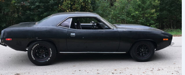

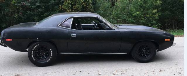

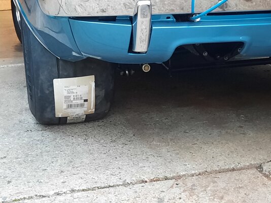

Cooper makes a 255/70-15 and I have them on the back of my Cuda on 15x8 wheels. It's supposedly a 29" tire and it definitely fills the wheel well. In my case the offset of the wheel pushes it out to the limit of the fender. No room on the outside but plenty of room to the frame rails. front is a 255/60-15

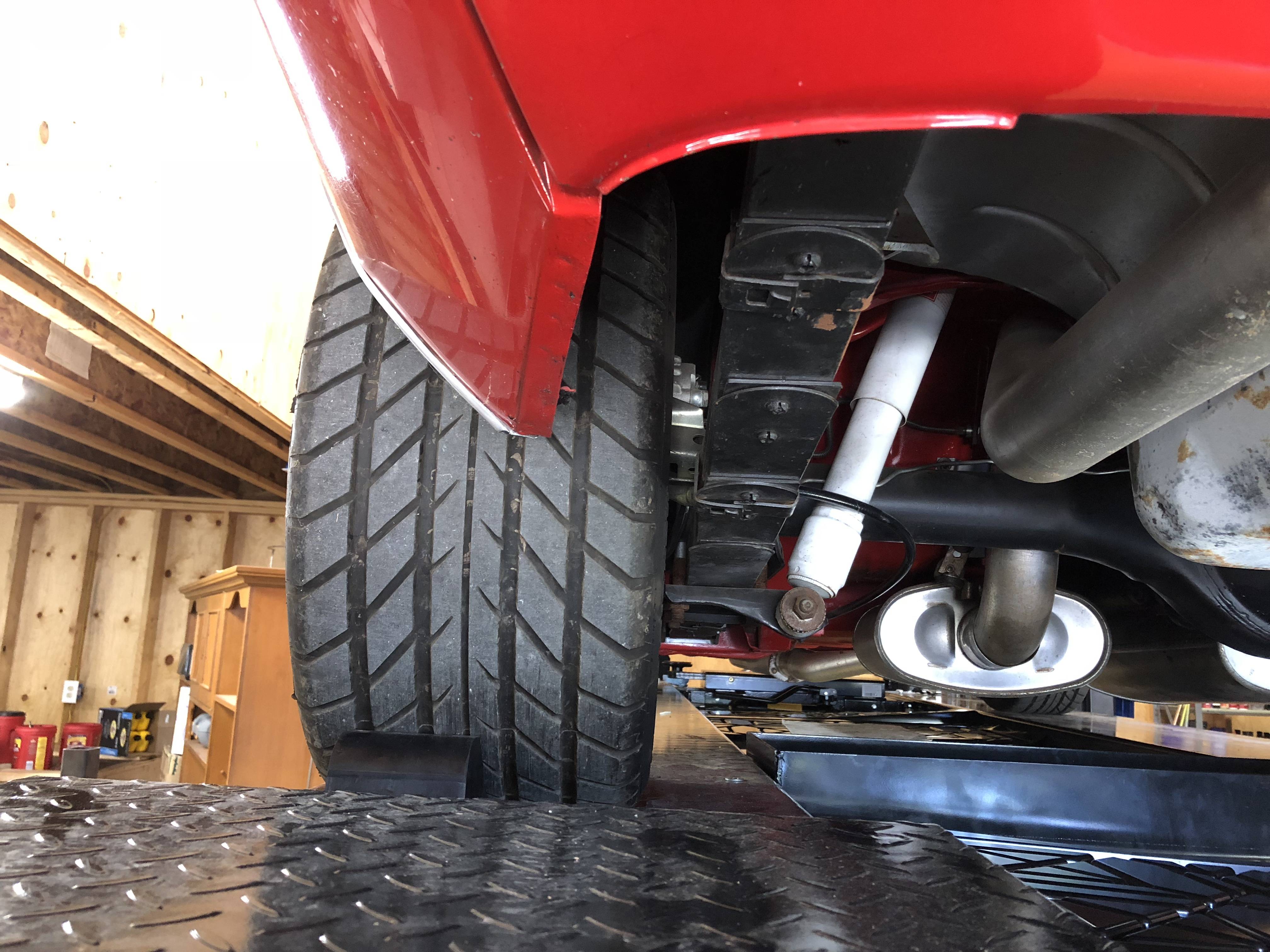

a few pics.

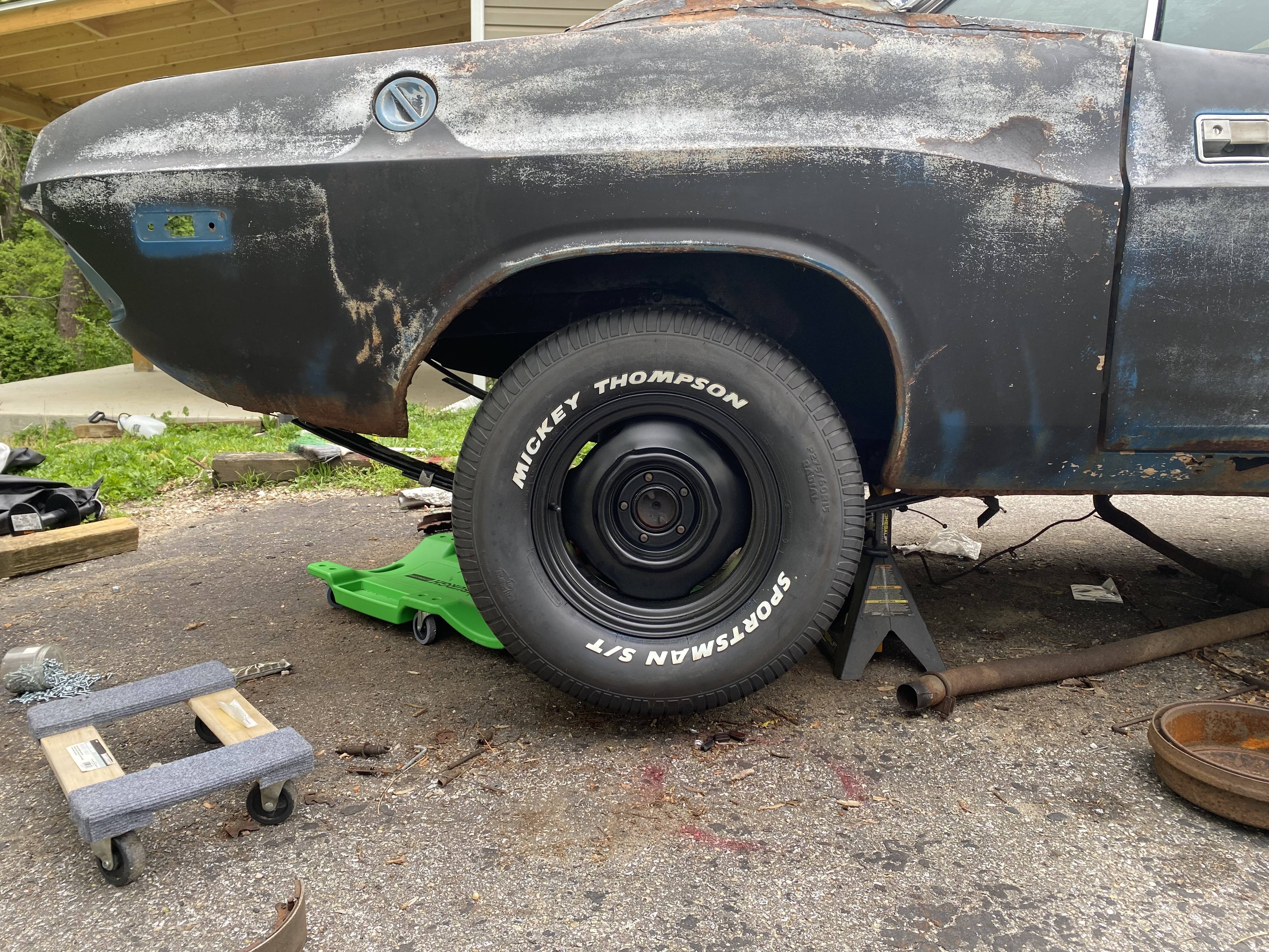

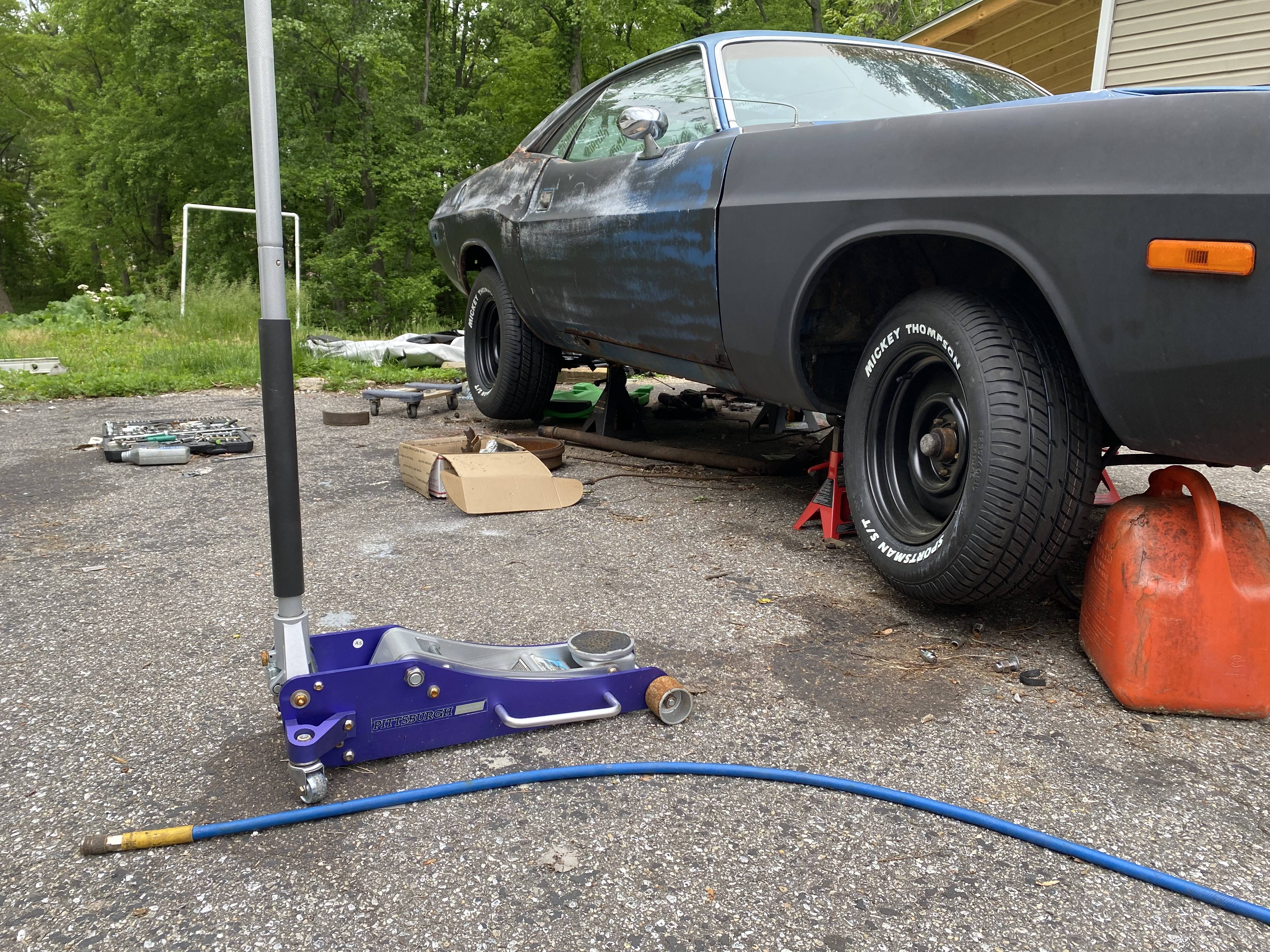

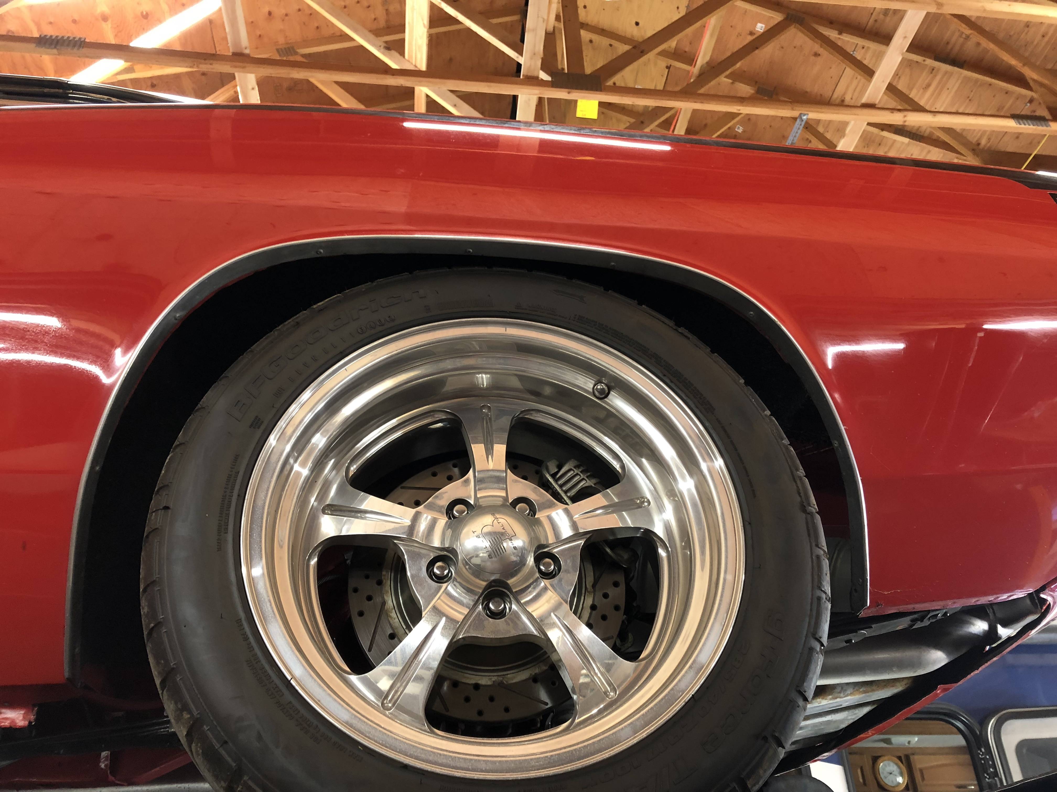

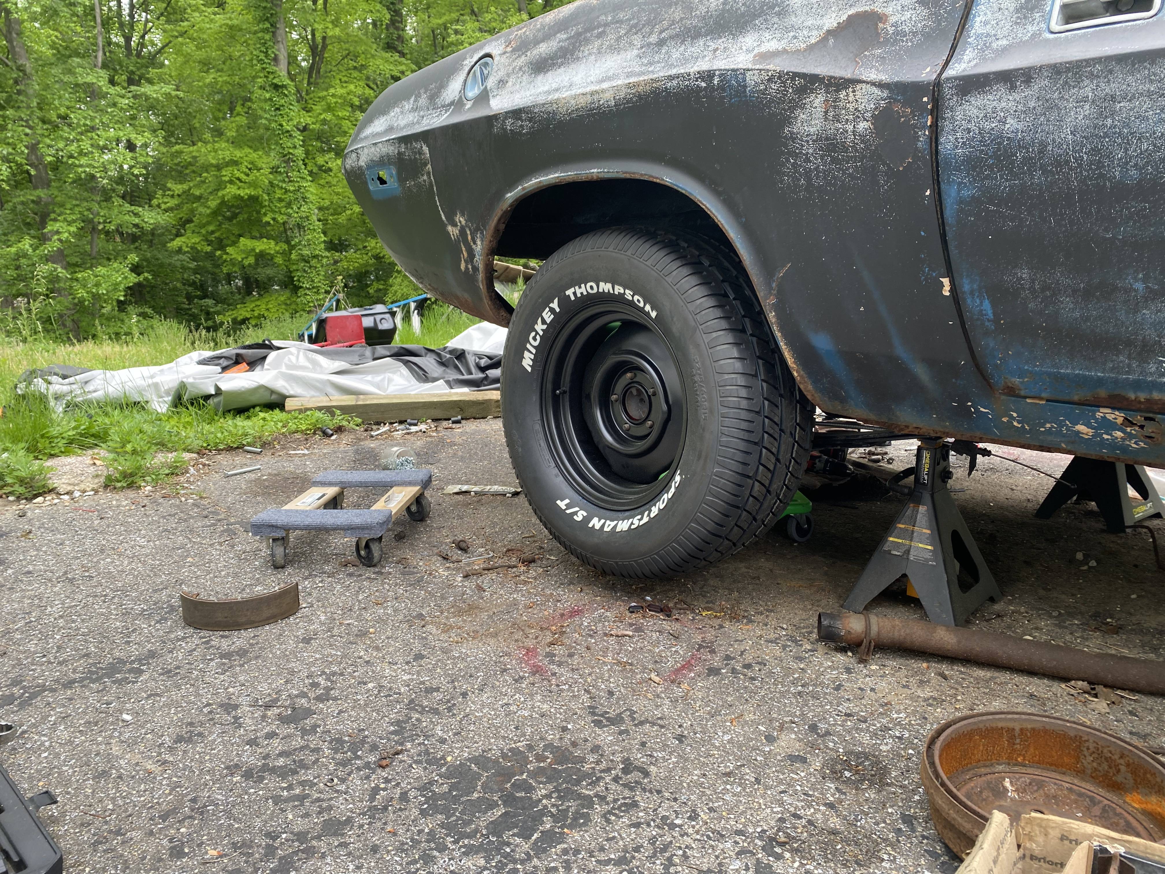

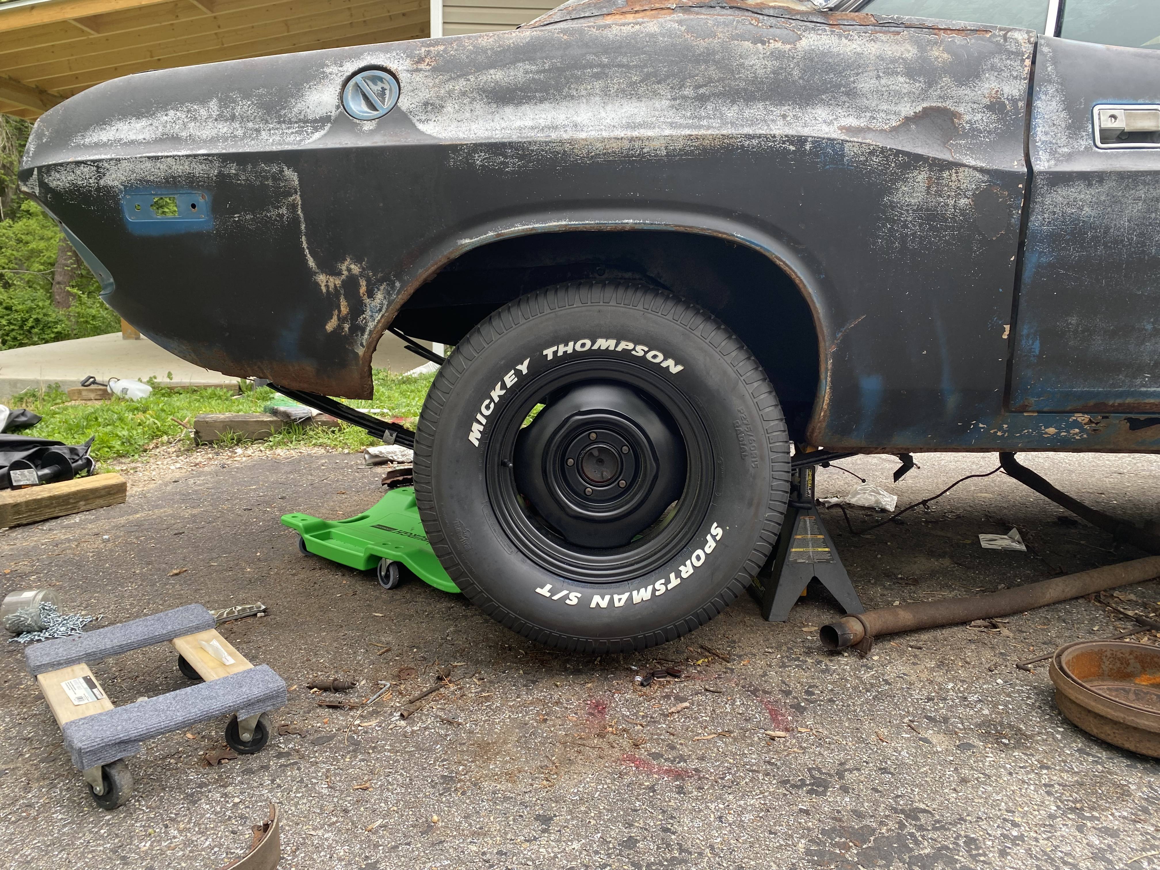

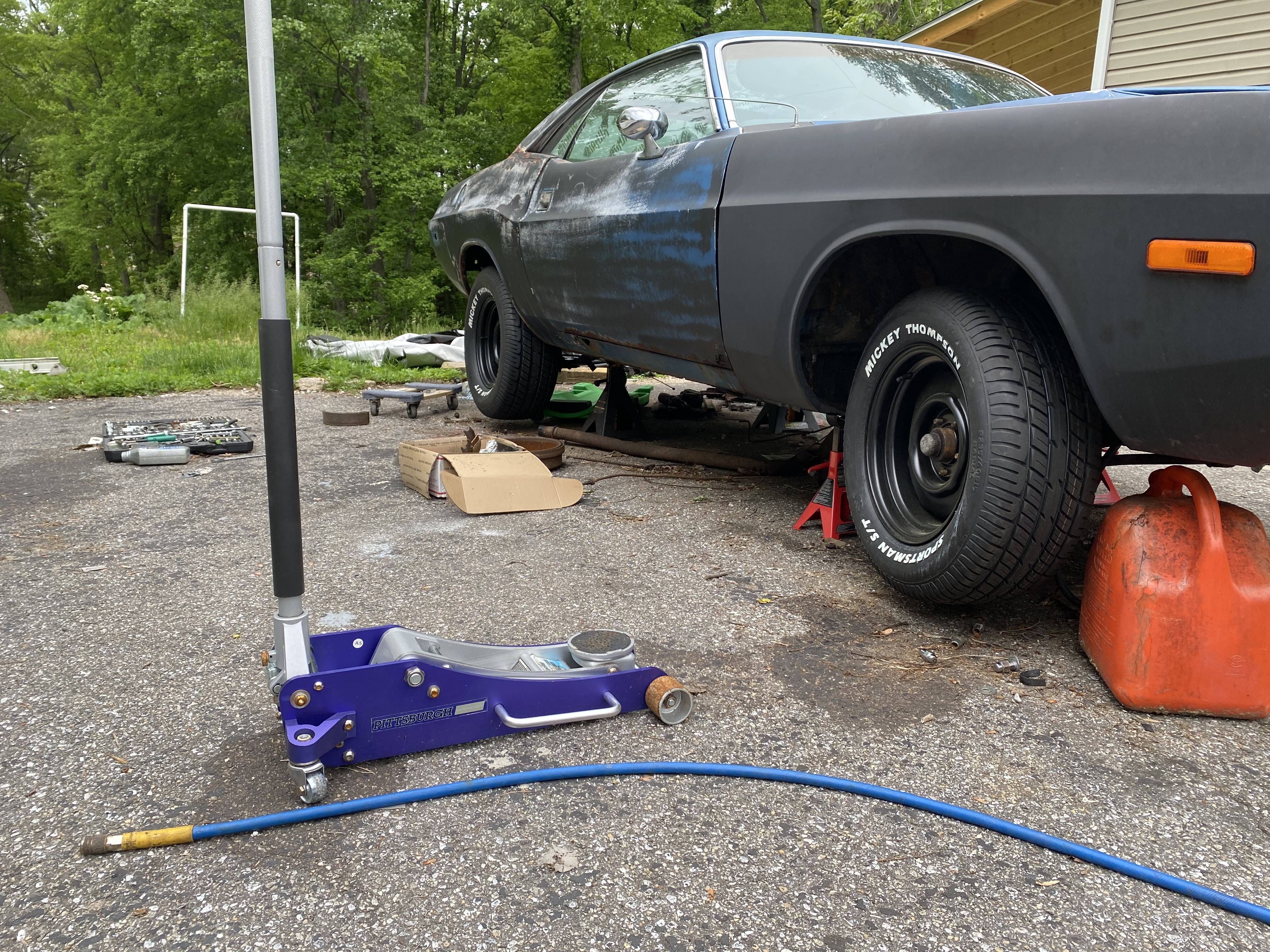

Gzig5, those fit really well and look great!

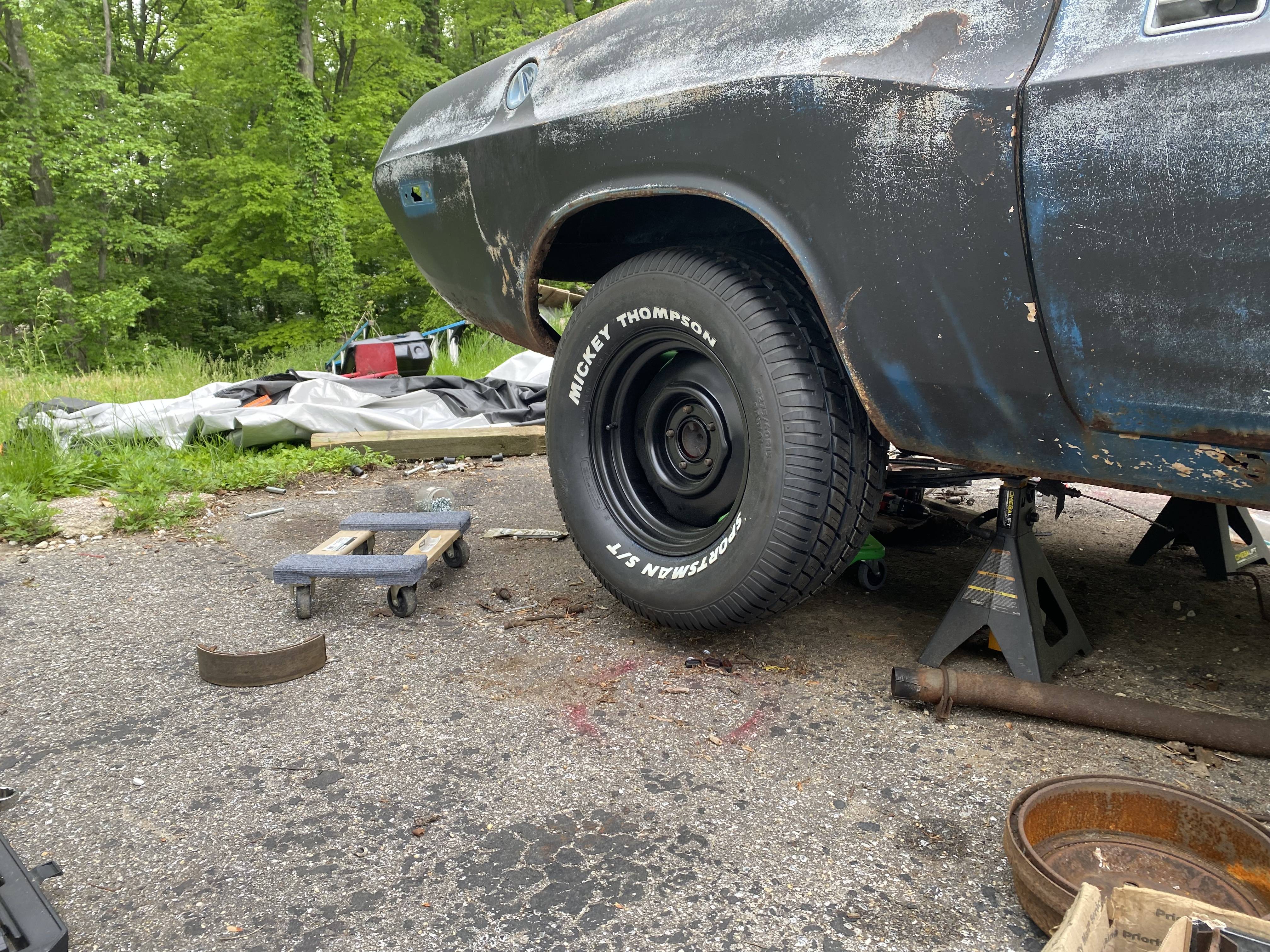

I have Micky Thompson's, 29.5x9.0-15
Thanks. I like the look but it would be nice to have a 275-295 width. I'm currently in process of replacing both full quarters and will be trimming or rolling the fender lips before paint to maximize the available width. I've got a 66 B-body housing and 1" spring relocation brackets which should allow me to get a 305 wide tire on the back. Have a ways to go before I need to decide on the size. I'm hoping I can find something in 17/18" wheel but there is a much better selection in the 19" diameter.
I'd say you've about maxxed out what can fit in that opening.
I think it will look better sitting on the ground or at least jack stands under the diff as the wheels hanging down doesn't give you a good look at tire fit.

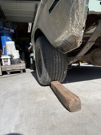

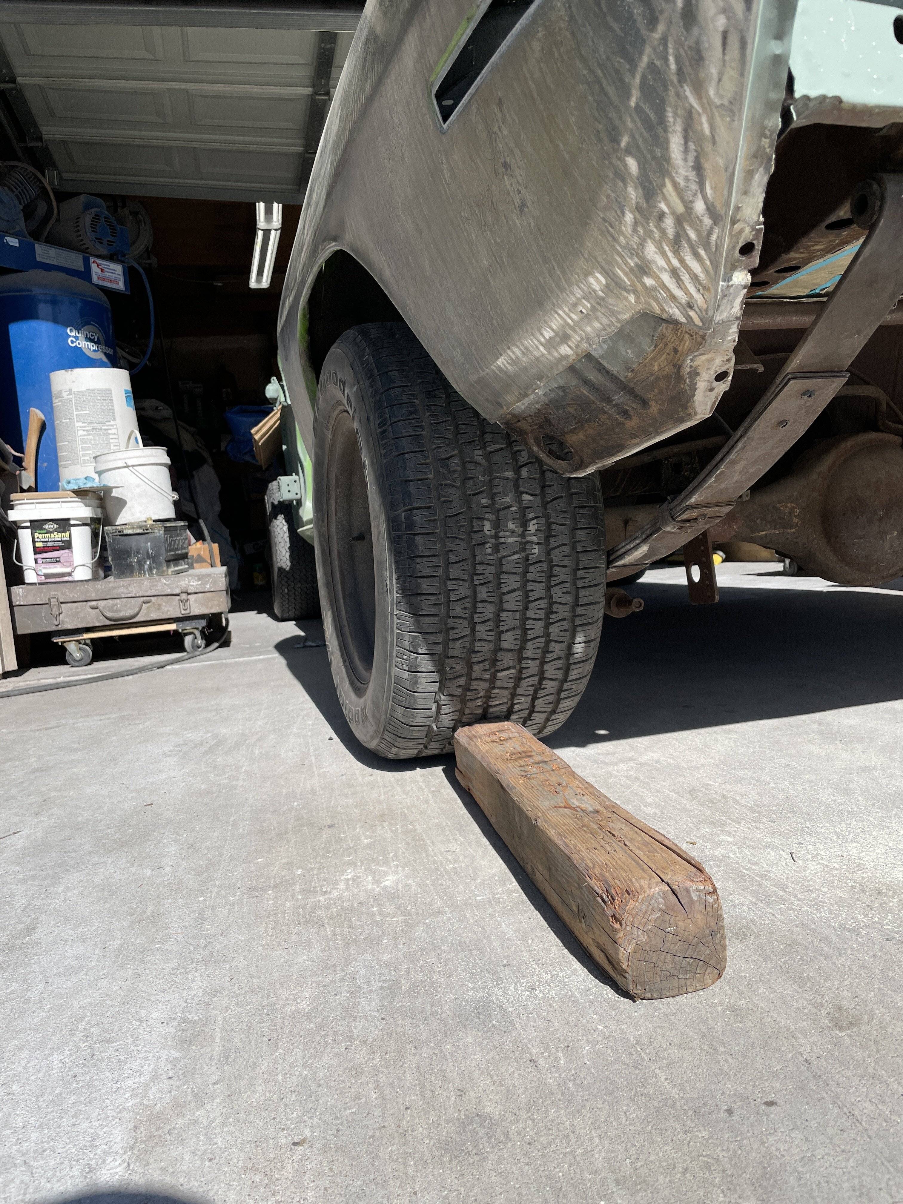

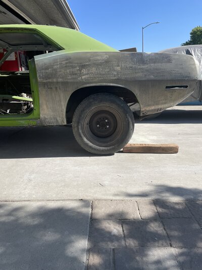

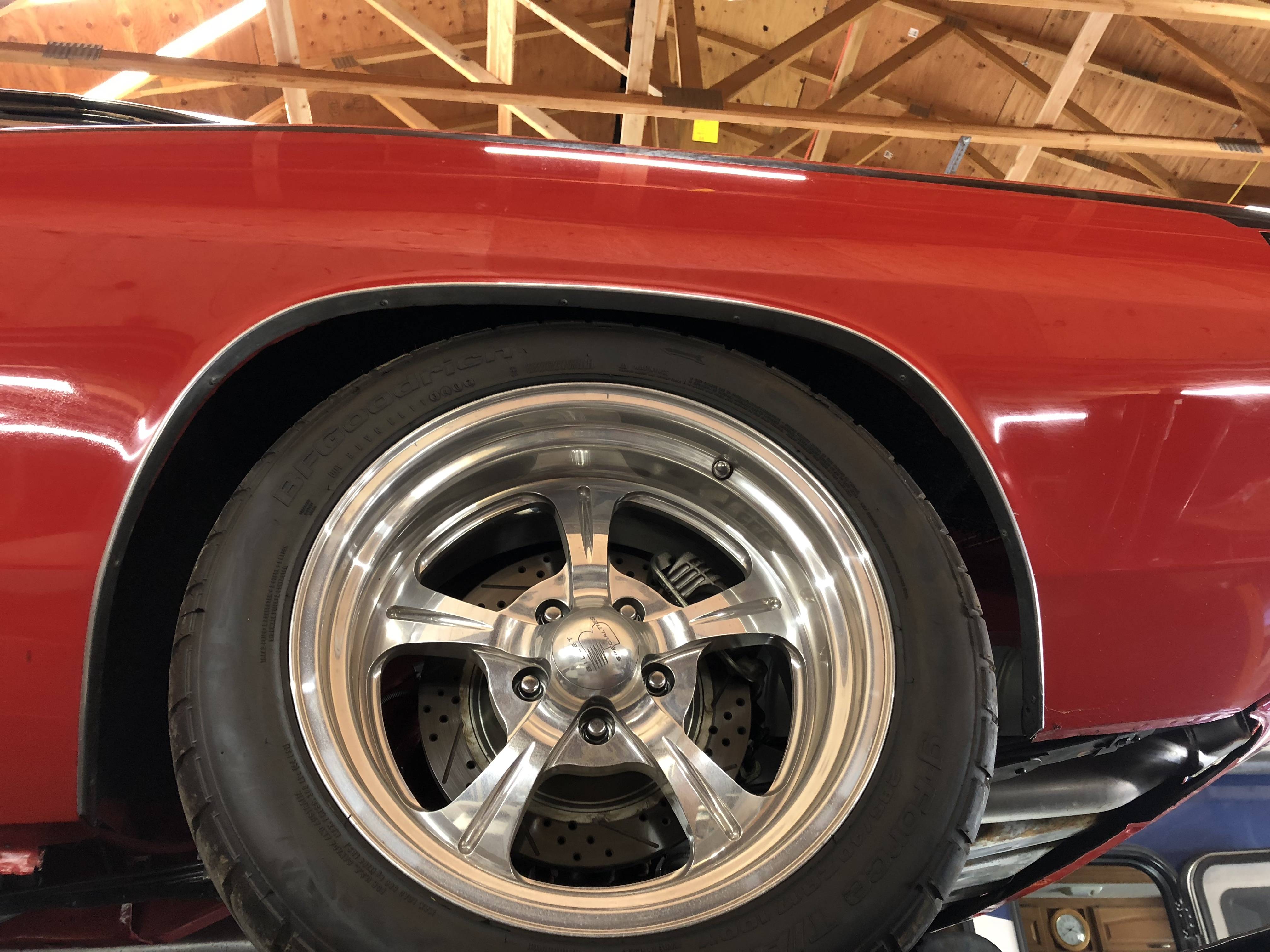

Here’s a picture of the BF Goodrich 295/50/15 on my Cuda w/15/10/ 6 1/2 backspace this rim has a center that slides in or out to see what size will fit underneath your car. That’s the look I wan but rear discs won’t let me run a 15 inch rim have to go to at least 17 or 18s

Like someone else already said. You have the suspension hanging, put the stands under the axle housing or put the car on the ground. Someone asked about the same non existent size ( 275/70- 15) a few months ago...
The answer is still the same, they don't make a passenger tire in that size. Period. Never will. The only way to get a taller tire that is just as wide is to go with racing tires. or truck tires. same answers.

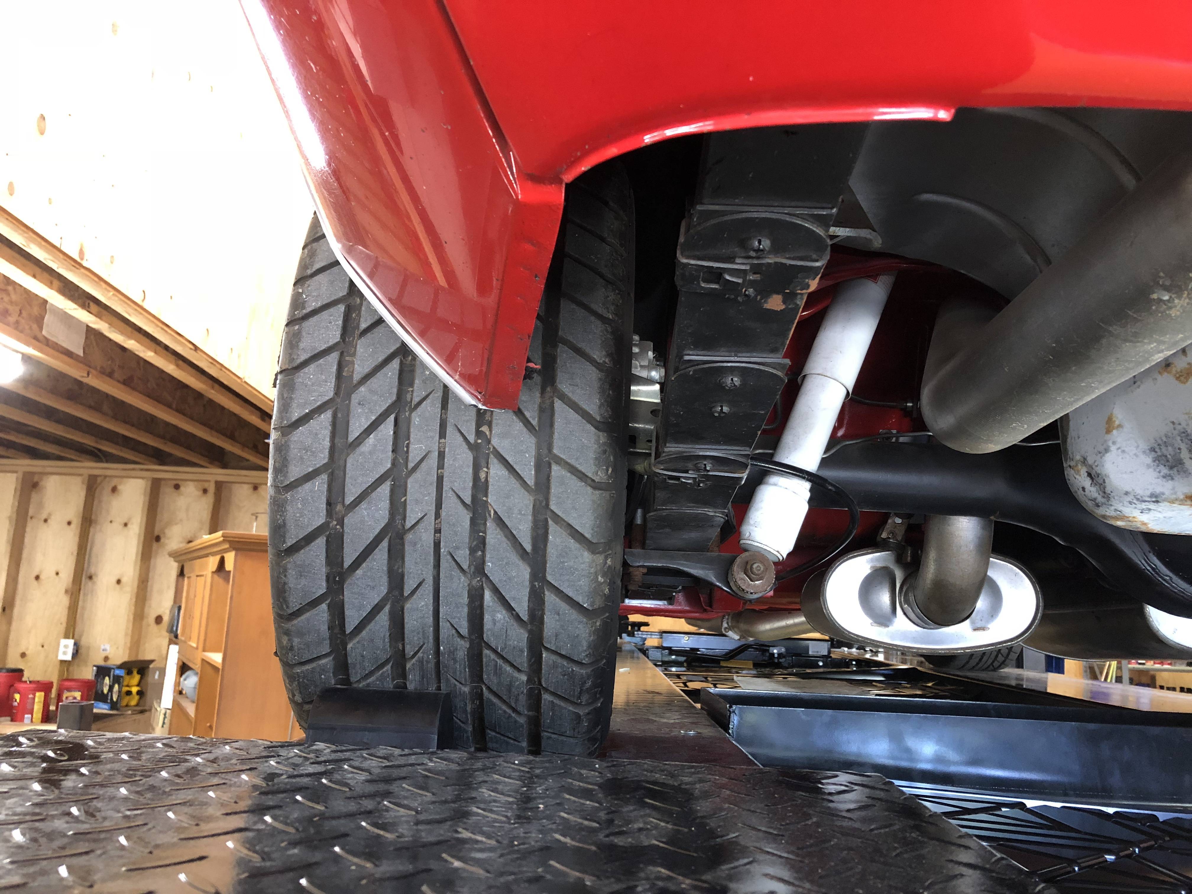

295/50 R -15 with little clearance to the leaf spring. Fits inside the wheel wells though. Re: E-Body Tire Combos

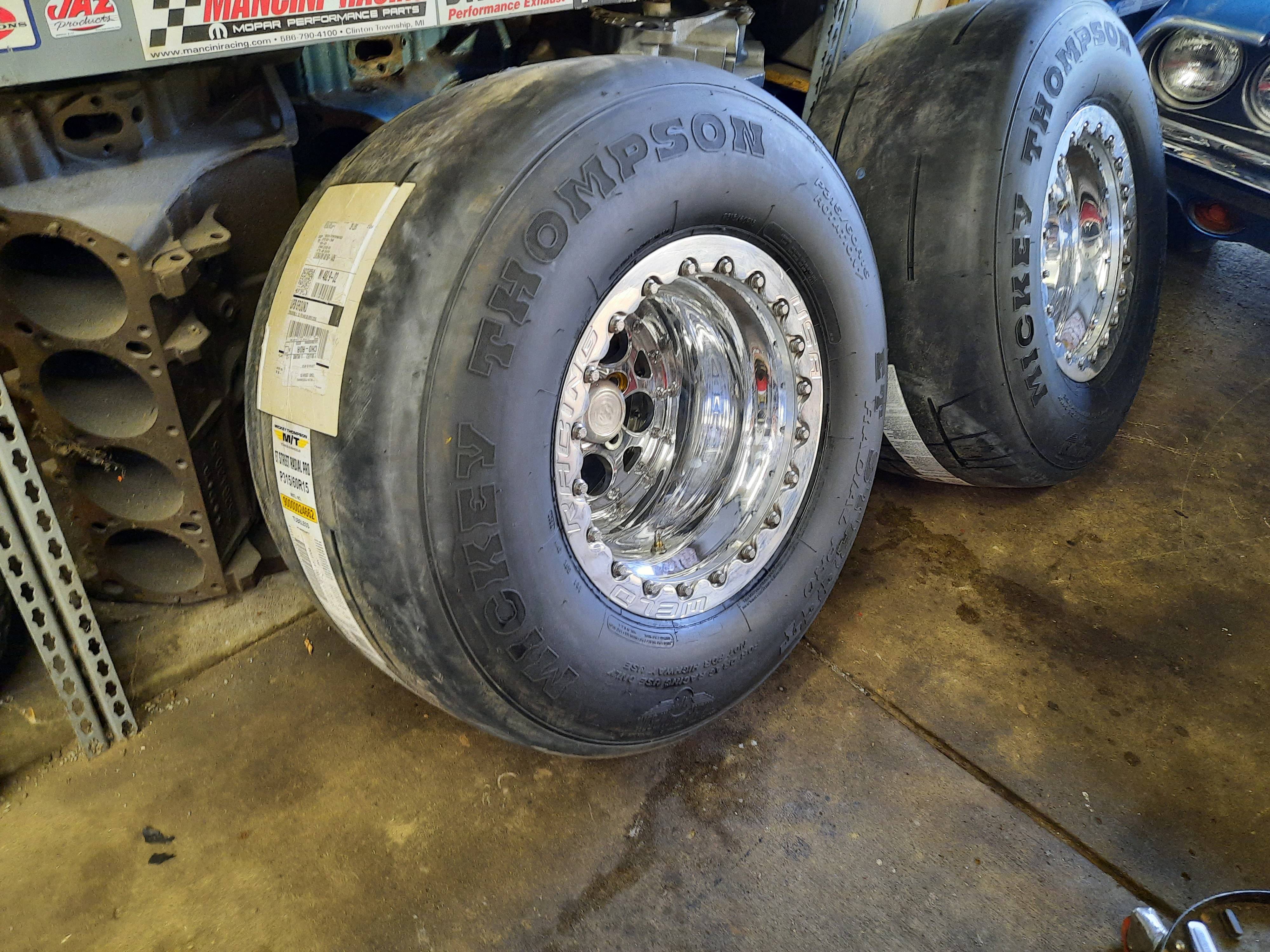

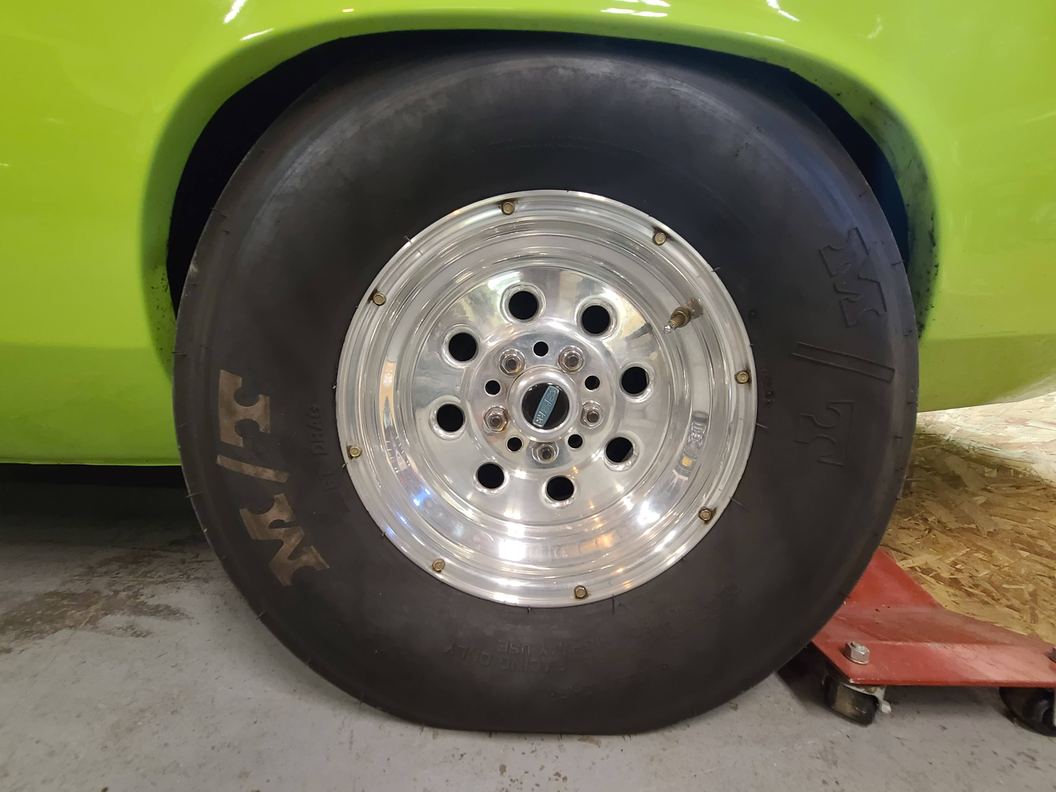

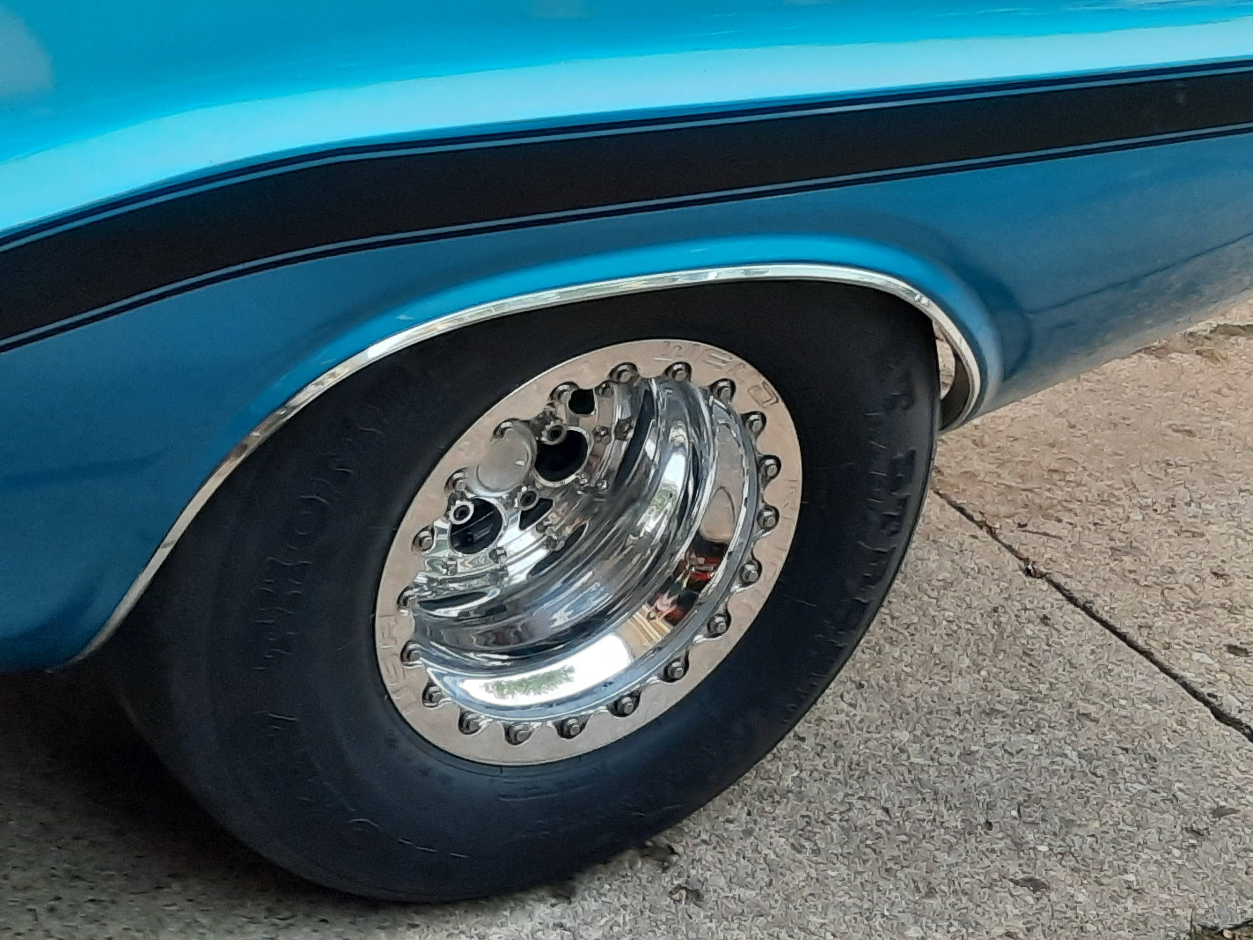

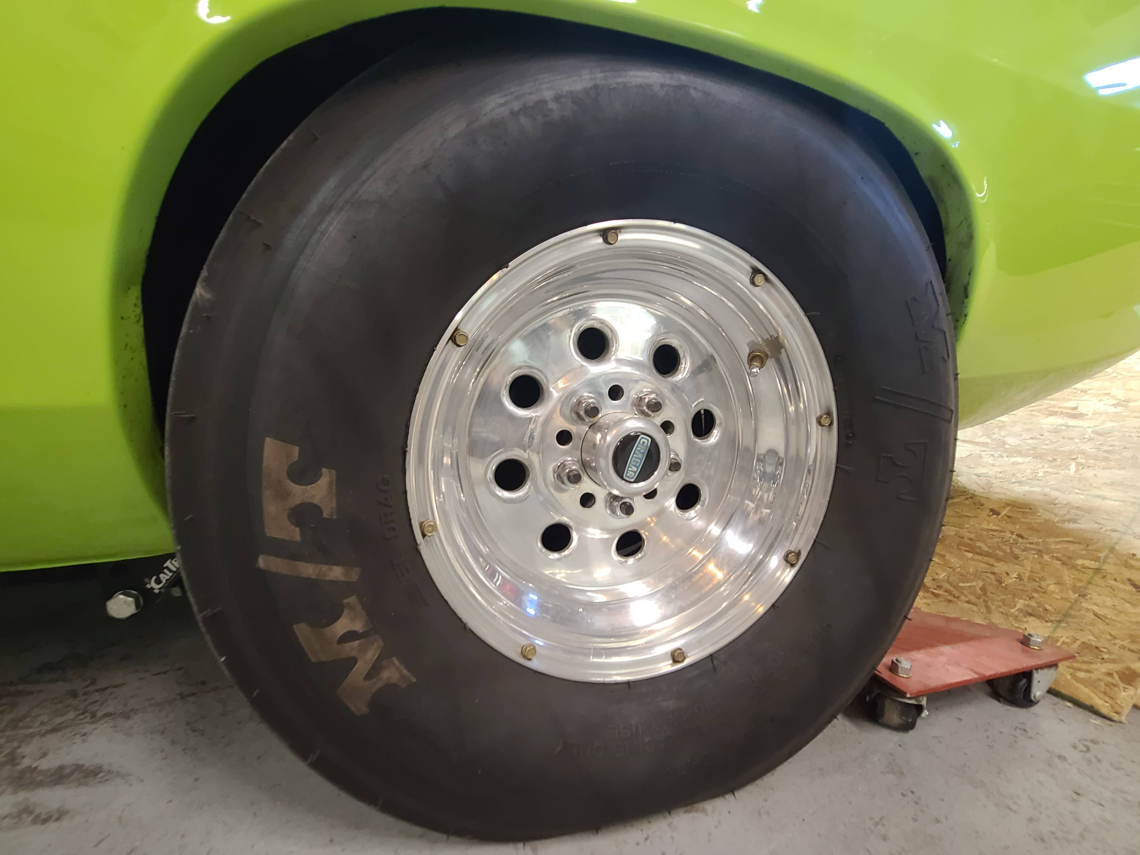

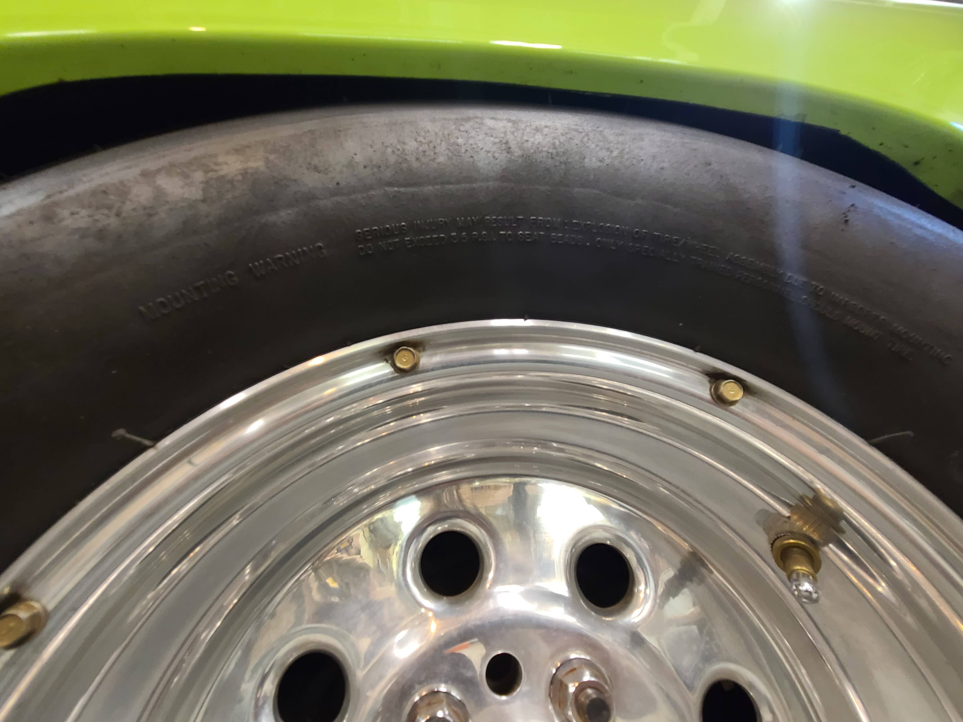

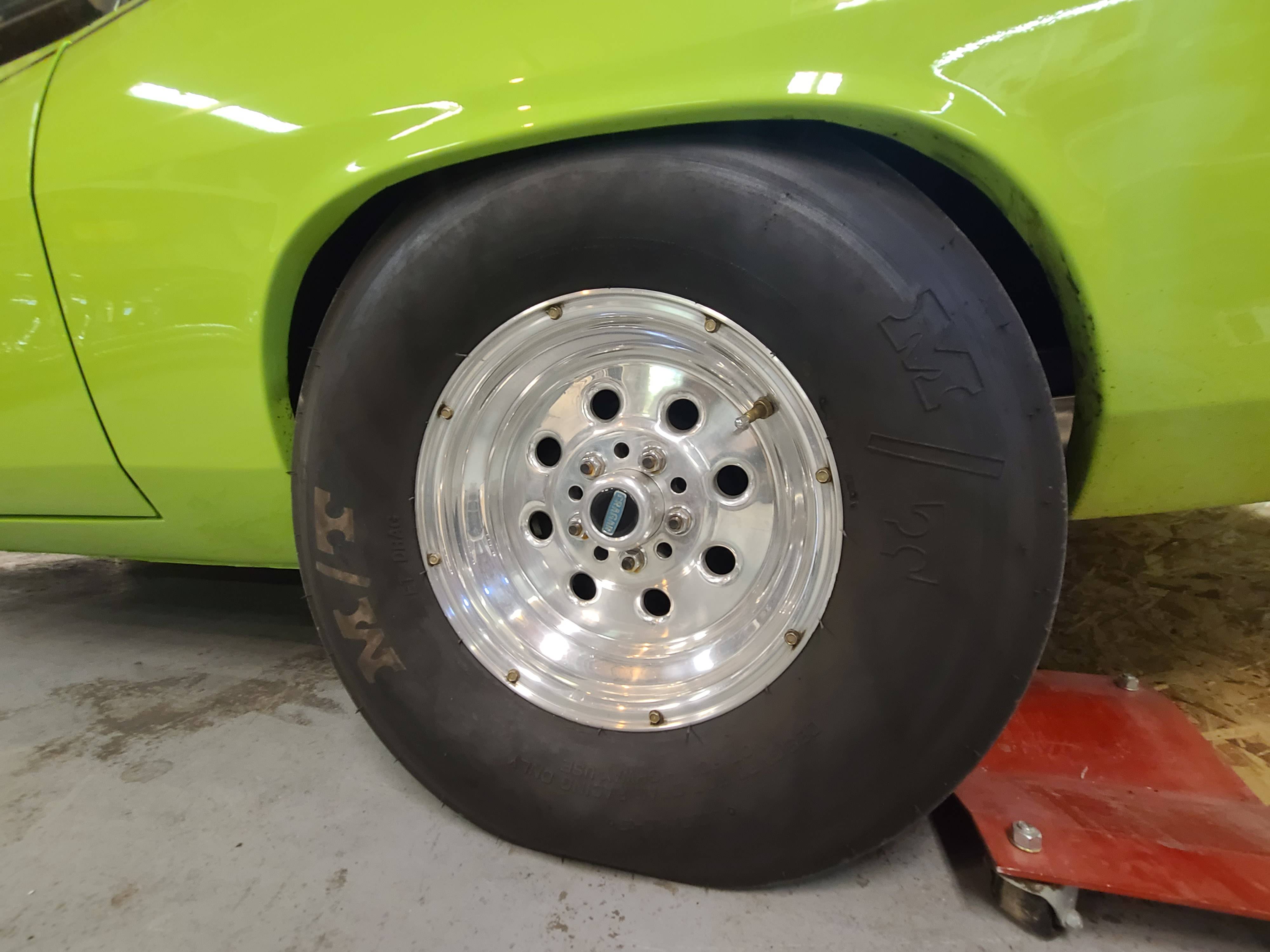

I have 315/60/15 Drag Radials on my Challenger. They are 30" tall and fill the wheel well on dia and width.
