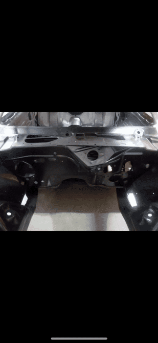

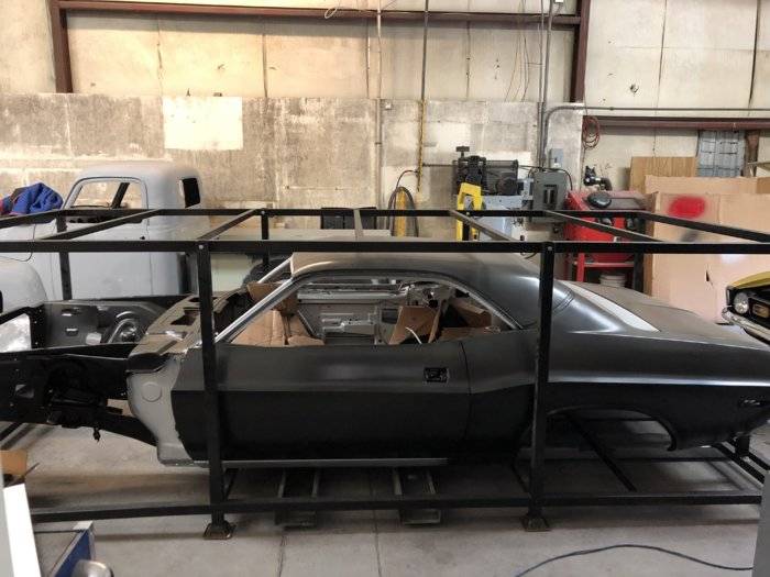

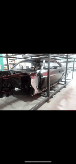

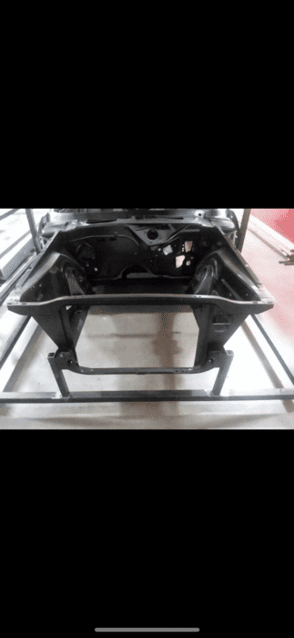

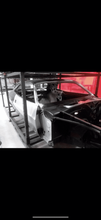

    Update: so I’ve decided to pull the trigger on the Dynacorn body shell. This is 1 of 2 available on the market but word is they will start to manufacture them again after SEMA. I haven’t taken delivery but these are the photos of the shell before it ships my way. I’ll post more info once I receive it for those considering this route.

  9. aussiemark
    aussiemark Well-Known Member
    Messages:
    1,152
    Likes Received:
    502
    Joined:
    Nov 29, 2014
    Location:
    Perth Western Australia
    That looks sweet has to be better then a repaired rusty one. I can see door hinge bolts so the doors are bolted not welded like the one seen at the SEMA show. I have read an article about one in New Zealand some brothers bought it and made a restomod T/A car from memory I will try and find it and get it to you somehow.
  10. budascuda
    budascuda Well-Known Member
    Messages:
    452
    Likes Received:
    267
    Joined:
    Jun 17, 2017
    Oh man o man.....
    It looks great, I can't wait till you take delivery of it. LOL.
    The hinges look like they are bolted on like they should, the one Adam saw at sema must have had been rushed-up for the show.
    Congratulations!

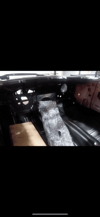

    Yeah I’m anxious to see it in person. I’ll send more photos once it’s here. Everything appears to look exact to factory spec when I compare photos however there’s a few holes on the passenger side of the firewall that aren’t in my current 70 challenger and I’m not sure what they’re for.

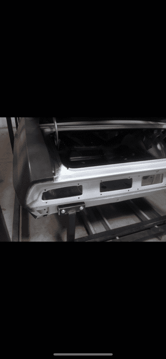

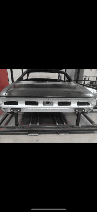

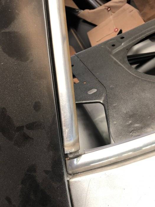

    Took delivery of the shell. Out of the gate I found a problem...the deck filler doesn’t sit where it needs to be. I first noticed it from the way it was pushing the trunk lid out. I ruled out the possibility of a misshaped trunk lid and further confirmed it when I compared the fitment of the window reveal molding. I hope this is the only discrepancy that I run into. Fingers crossed.
  15. Blake129
    Blake129 Member
    Messages:
    19
    Likes Received:
    4
    Joined:
    Jun 29, 2019
    Location:
    Ascension Parish, Louisiana
    See attached
  16. moparlee
    moparlee Well-Known Member
    Messages:
    1,395
    Likes Received:
    604
    Joined:
    Jul 25, 2011
    Location:
    Mid Michigan
    Have you talked to Dynacorn? There is no excuse for that, it's not even close.
  17. Blake129
    Blake129 Member
    Messages:
    19
    Likes Received:
    4
    Joined:
    Jun 29, 2019
    Location:
    I left a voicemail. Not too happy about it.

    Thanks, yeah thats one of my fears that the bolt holes for various things will be just a hair off. I guess id have to break out the welder, fill the holes and tap new ones for a correct fit. Hopefully it wont come to that.
  20. Adam
    Adam Well-Known Member
    Messages:
    1,161
    Likes Received:
    459
    Joined:
    Dec 25, 2012
    Location:
    Washington
    Looks good. Yes, the Dutchman panel is a bummer, but could be fixed in a few hours... you should hang the hood and fenders to check the fit.
