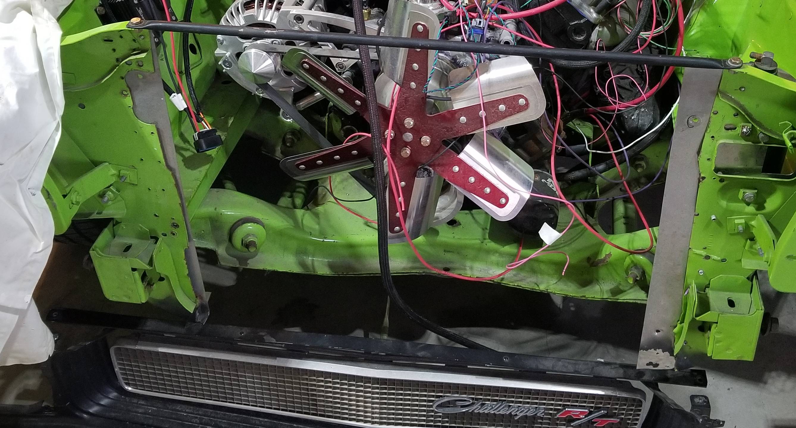

The rad support on my Challenger has been cut. Both the top and bottom.
The car is painted, and I don't want to remove fenders or damage the paint with welding when replacing the parts.
I am not a welder, but I have read about plug welding, which may be an option.
Can I just bolt the new pieces backed up with 3m Panel Adhesive?
Thanks

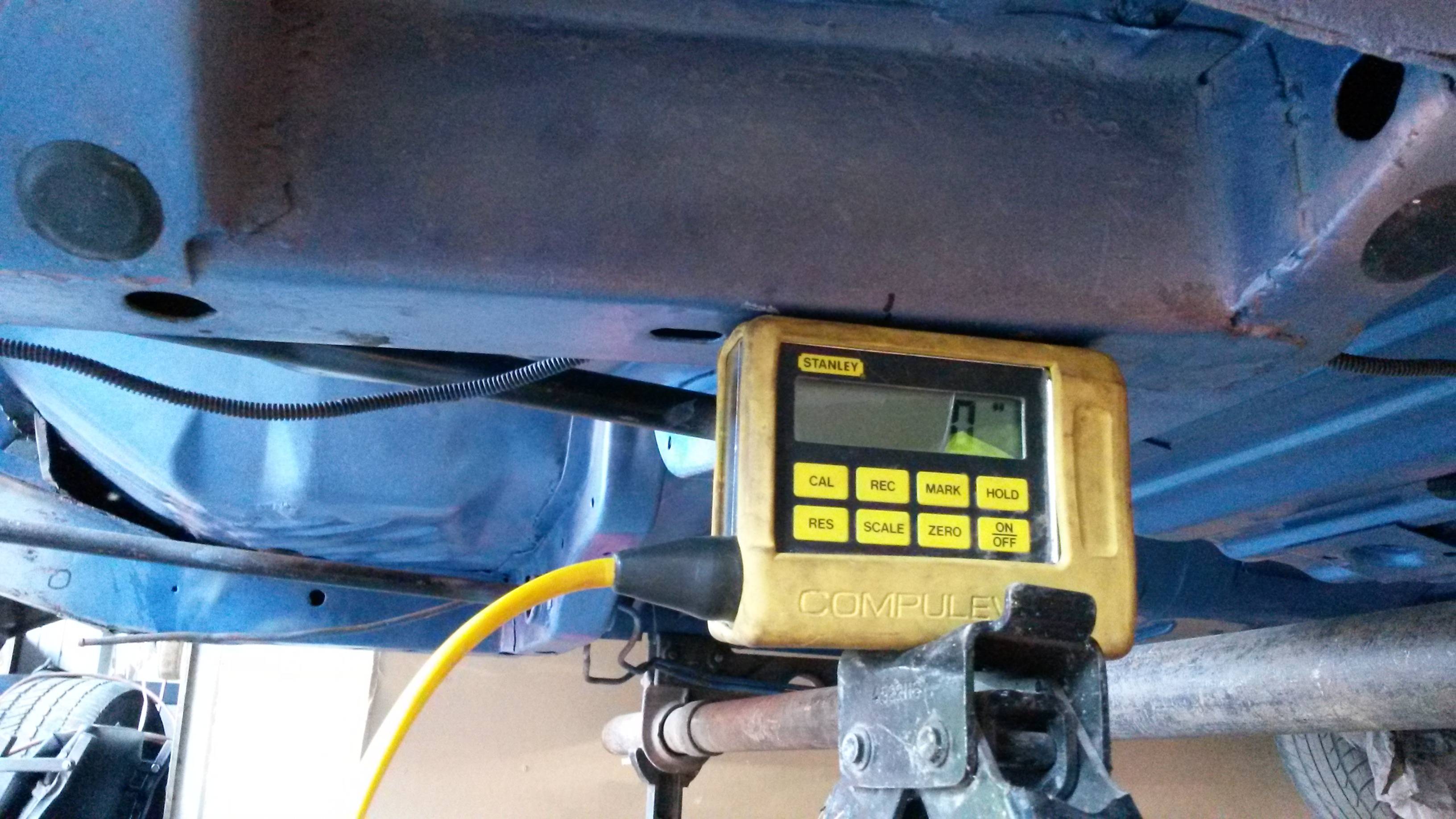

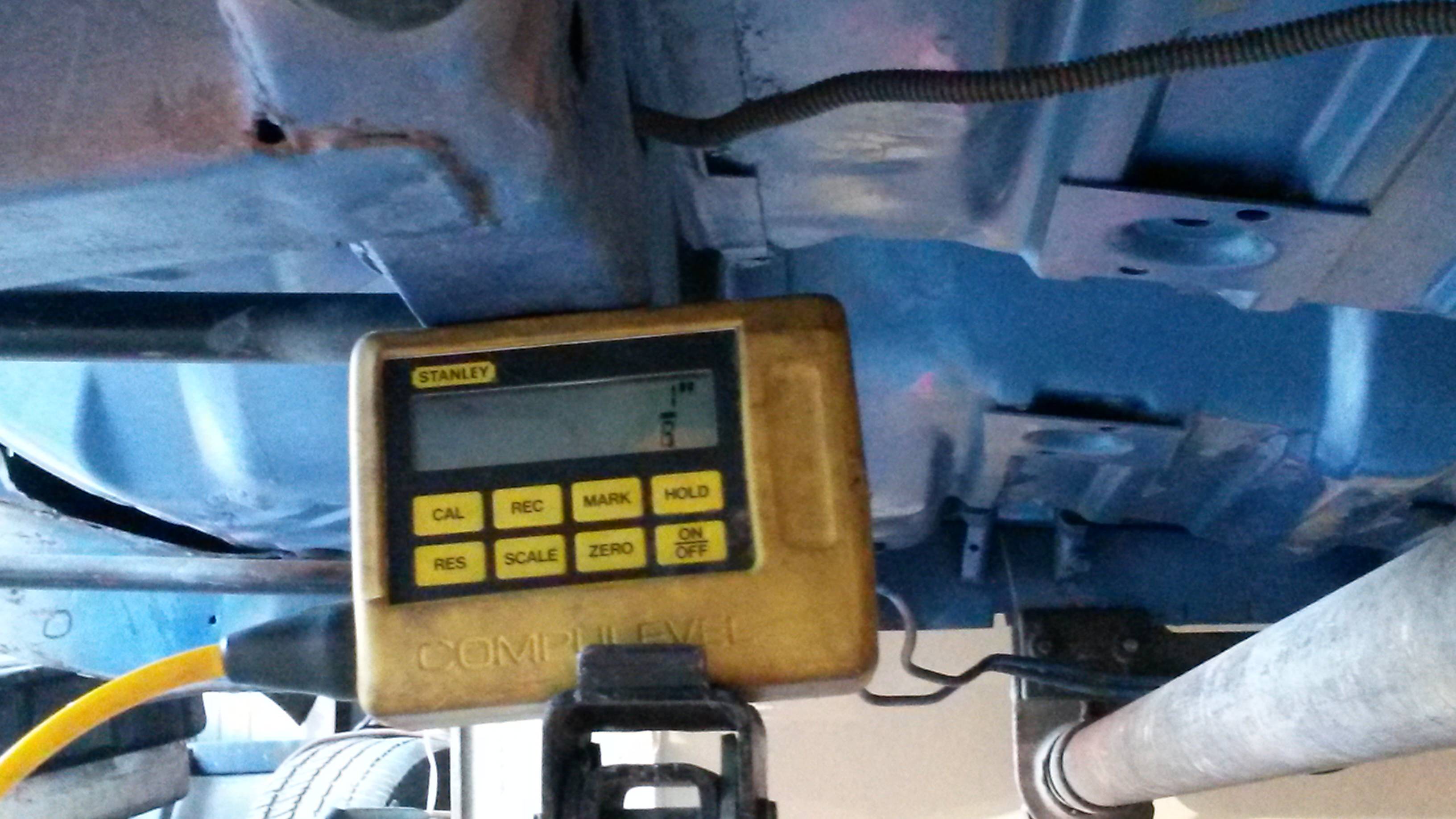

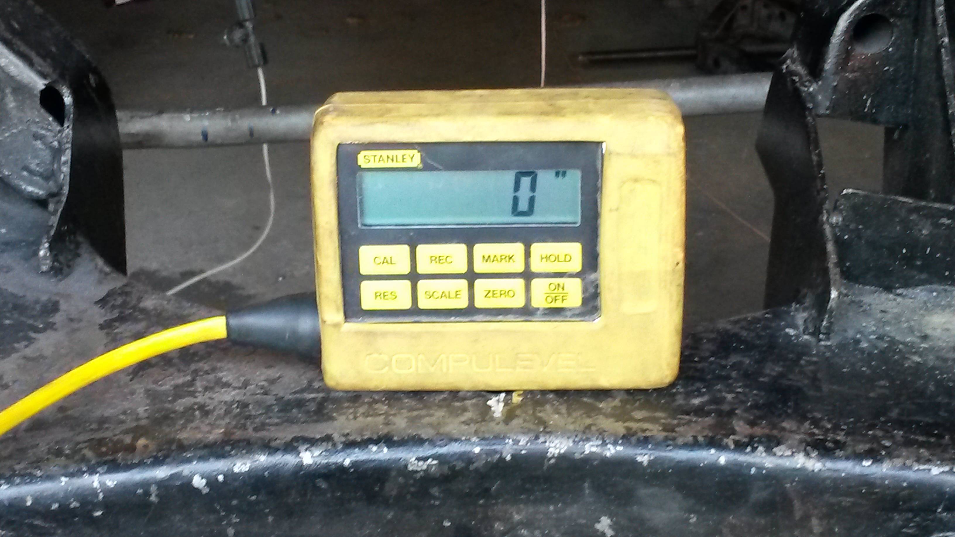

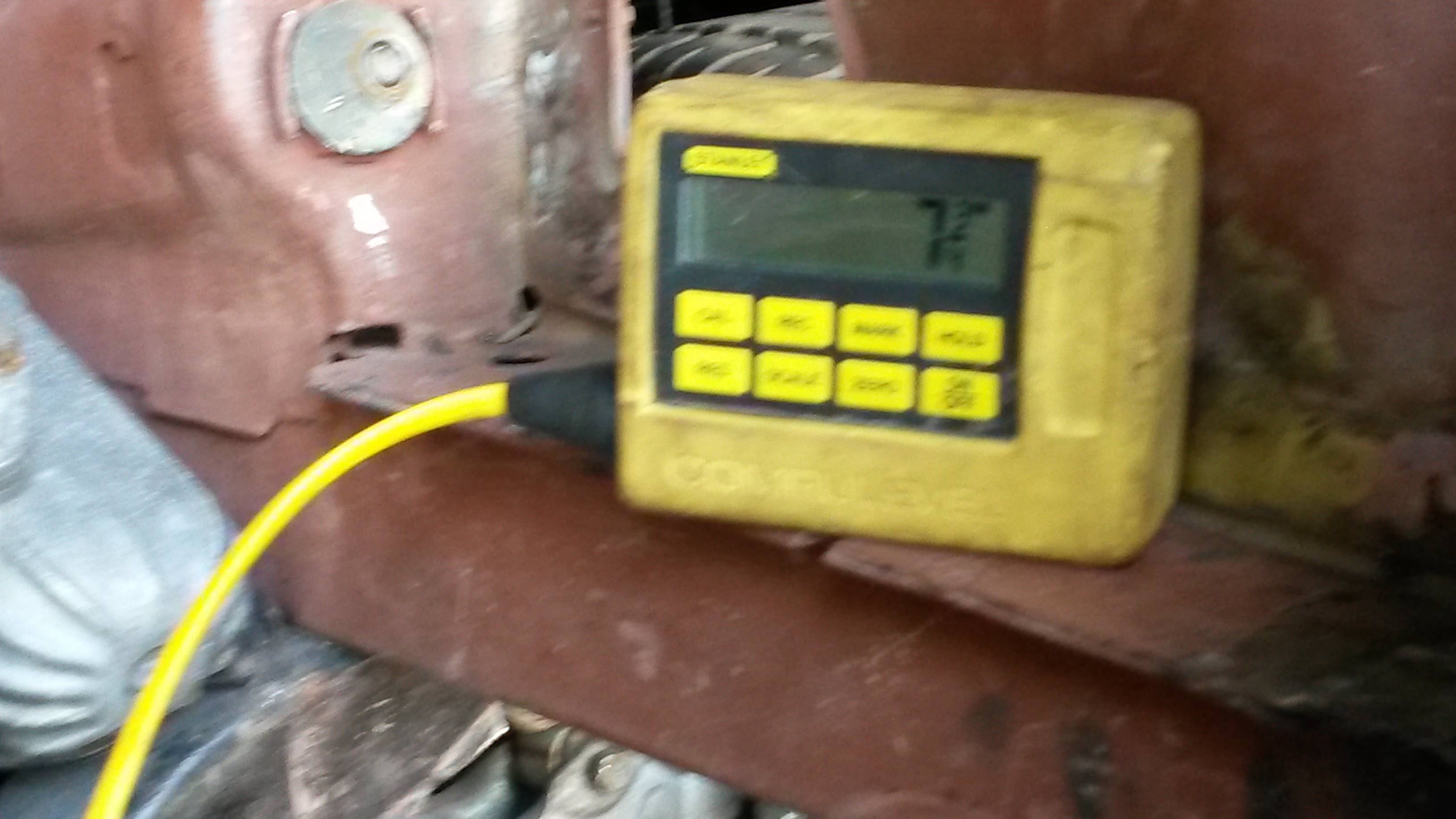

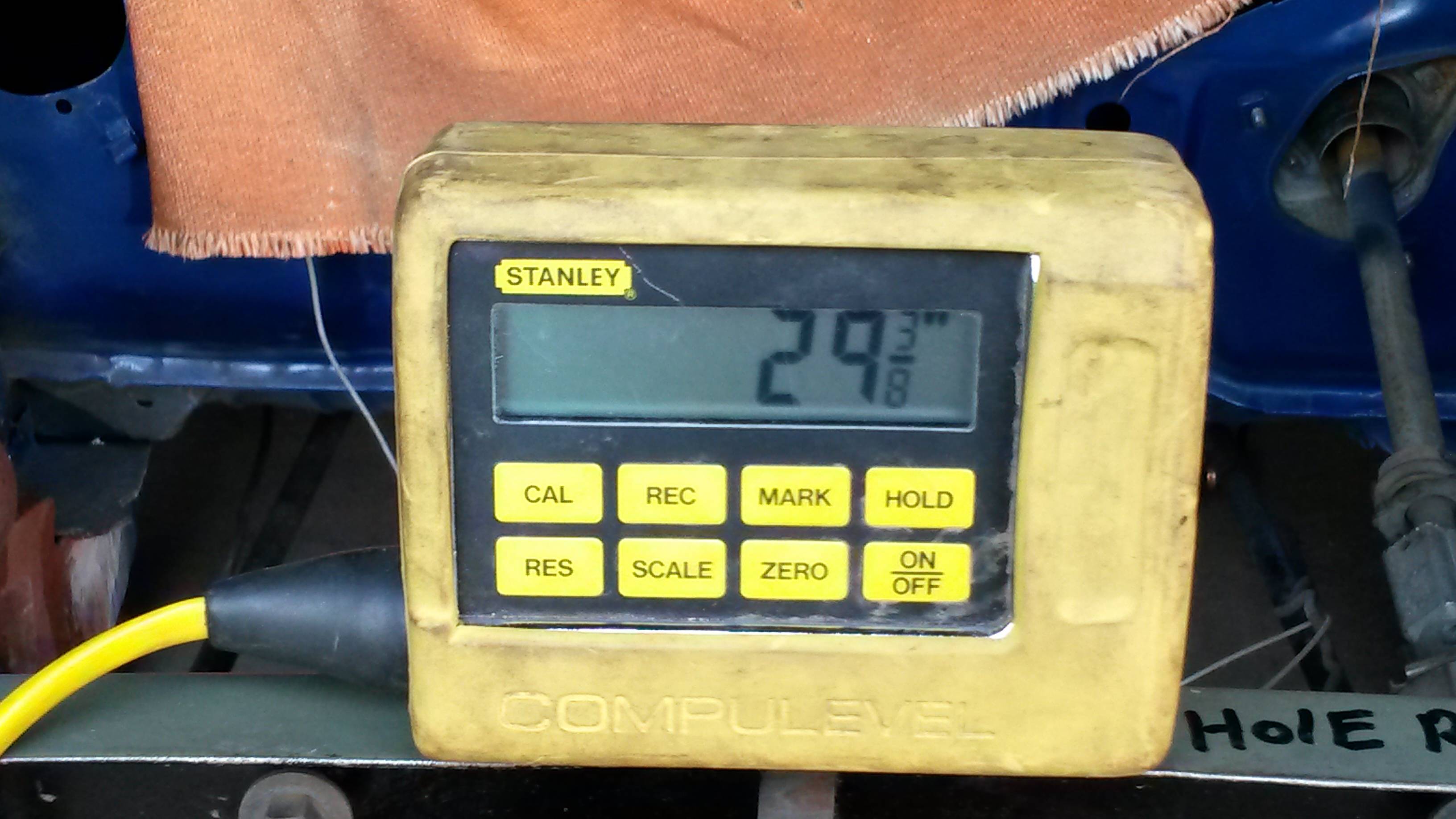

Here's a few measurements that might help.Before you pull fender. pull measurements in front and back. or mark. the last 2 picture show how accurate the reading are. 16 gauge is 1/8 inch. Most of the jig holes are still on you parts take note.
Ok 1 more picture.

The whole upper and lower core support need replacement. The whole thing is missing, not just the top and bottom sections.
It holds the entire front of the car together.. Imagine if you cut the torsion bar crossmember out of the car and just drove it as usual. What would be the result ?
