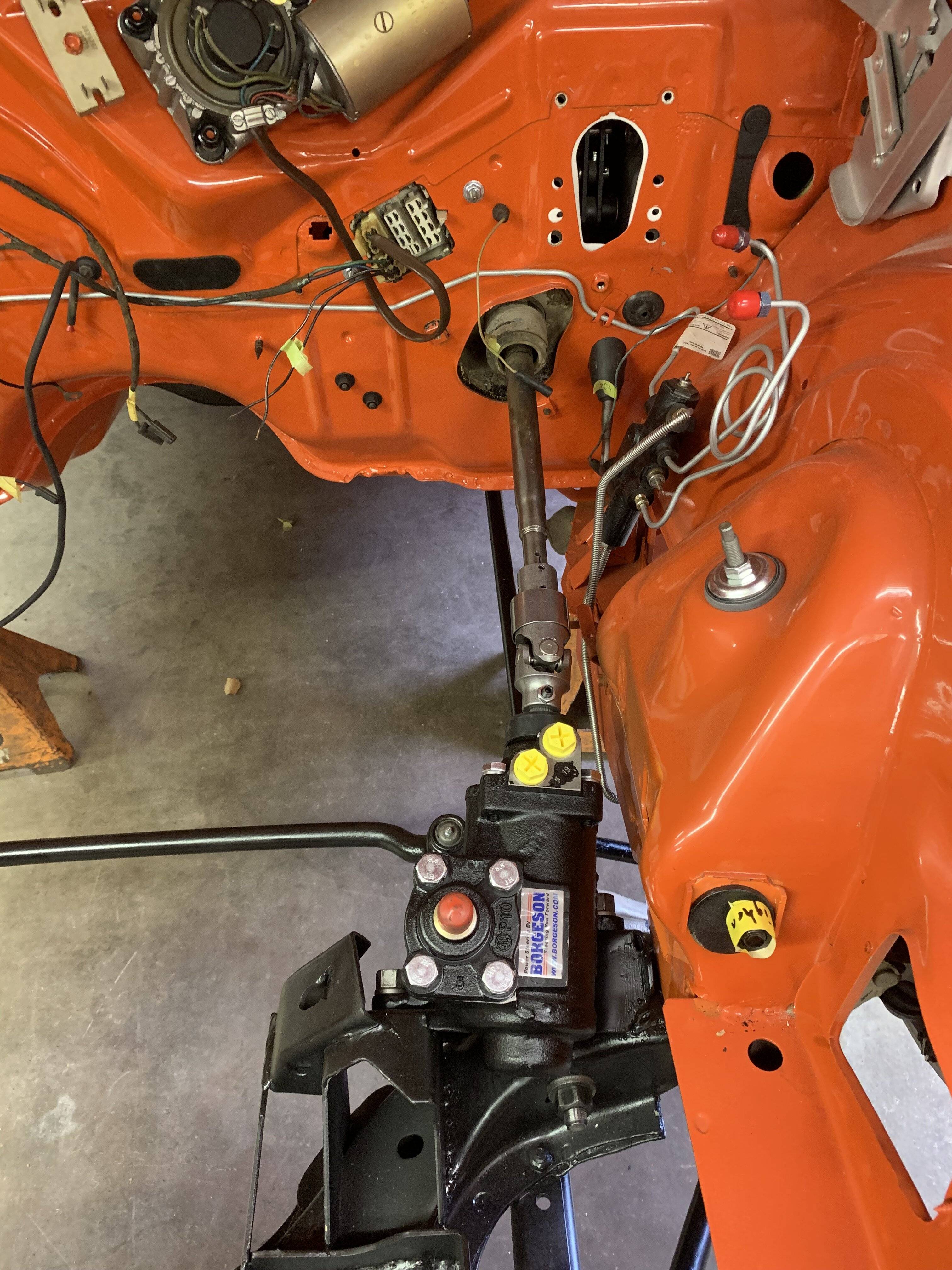

I have installed a Borgeson unit on my Challenger with no problems.

The way that I did mine was to mount the new Borgeson box to the K-member, with the new steering joint installed on the box, then bolt the k-member in the car for a test fit. Set the steering column back in place and carefully mark the steering shaft length long enough to seat fully into the joint, then remove the column from the car and cut the shaft to length.
That should get you ready for a proper install when you reassemble everything permanently.

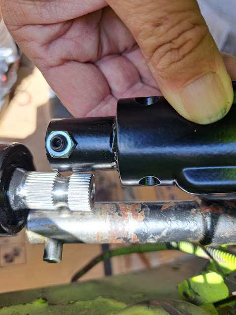

Hi Gents I am going from manual to power. There is no way that the Mopar original looking Borgeson coupler is going to work. (See Pic) I called Borgeson and the owner told me to hammer in the shaft. I think that is a bad idea. Any comments? Ron 340 what universal did you use.... I like it. Of course someone on this board said you could get vibration. Bill
