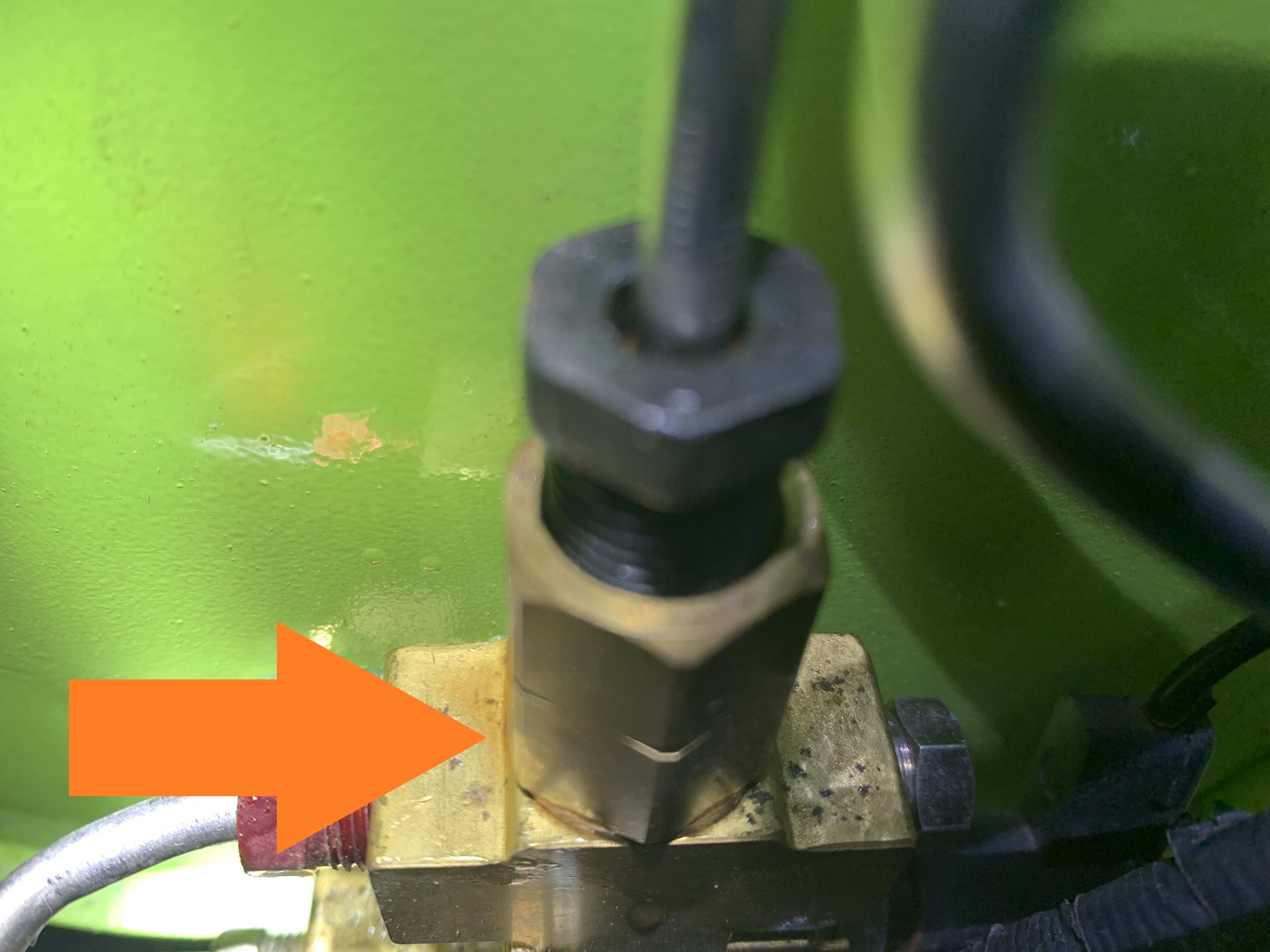

I had my stepson pump the brake pedal and I noticed brake fluid dripping down from the valve. I was on the ground. When I looked from the top the brake fluid appears top be coming out of the valve. Where the orange arrow is. I emailed the company. I will let you guys know what they say. I might be buying that original valve on eBay.
As I mentioned before, I got multiple bad repop valves and I couldn't solve my leaking problem until I installed an OEM valve. Spring for an original unit!

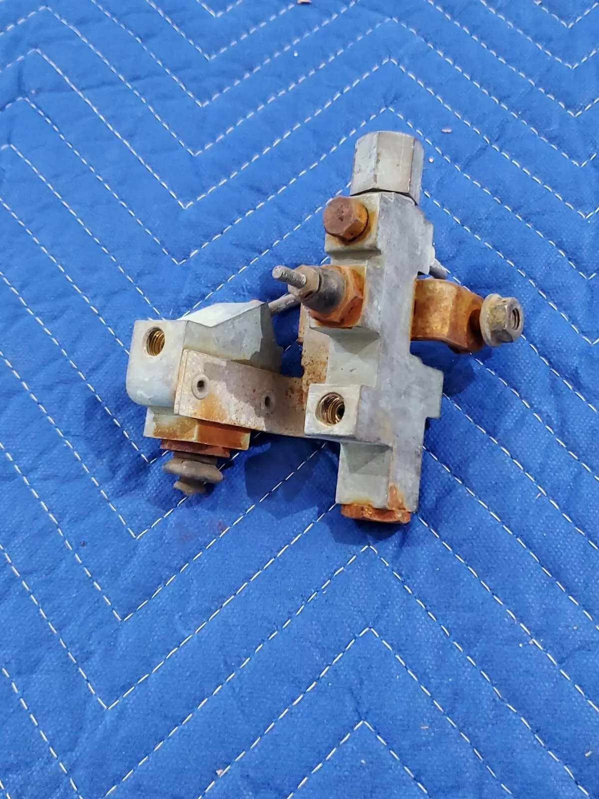

I have been thinking about what you wrote. I didn't miss it. I am seriously considering buying the one on eBay. I think it is still good but is there a way to restore it and make it look nice? It should be bare metal correct?
I did email In Line Tube and told them what happened. All the guy said was he thinks the valve is bad. However, I didn't explain to him that I bought it brand new from his company (although it was 3-4 years ago). So i did second a second email explaining that. We will see if he offers me a new one but even if he does do I want to trust another valve from In Line Tube?
Did I try to tighten it up? No, I didn't realize that part is just screwed on. I know, duh! I will give that a try. I'm surprised the rep from In Line Tube did not suggest that as well.
Here is a pic of the valve on eBay:

Update: Once I mentioned to the customer service guy from In Line Tube that he should do something for me since his part was bad right out of the bag he ghosted me. Well, I will be ghosting his company for any future purchases. If the valve had lasted even a month I wouldn't have mentioned it but right out of the box is totally unacceptable. So I was going to order the used original part shown above and I contacted the seller on eBay and asked him some questions about it. I just wanted to be sure it was still good since the price would be $200 with shipping. The seller, who seemed honest, checked it out and he found that the low fluid switch was rusted in position and then he removed the valve from eBay. I told him about my troubles and he even gave me some suggestions. So that part is no longer an option.
Next, I tried tightening the top part of the valve but I couldn't get it any tighter.
After thinking things over I decided to just order another reproduction valve and new steel lines from SS Tubes. Hopefully they come in before Carlisle.
