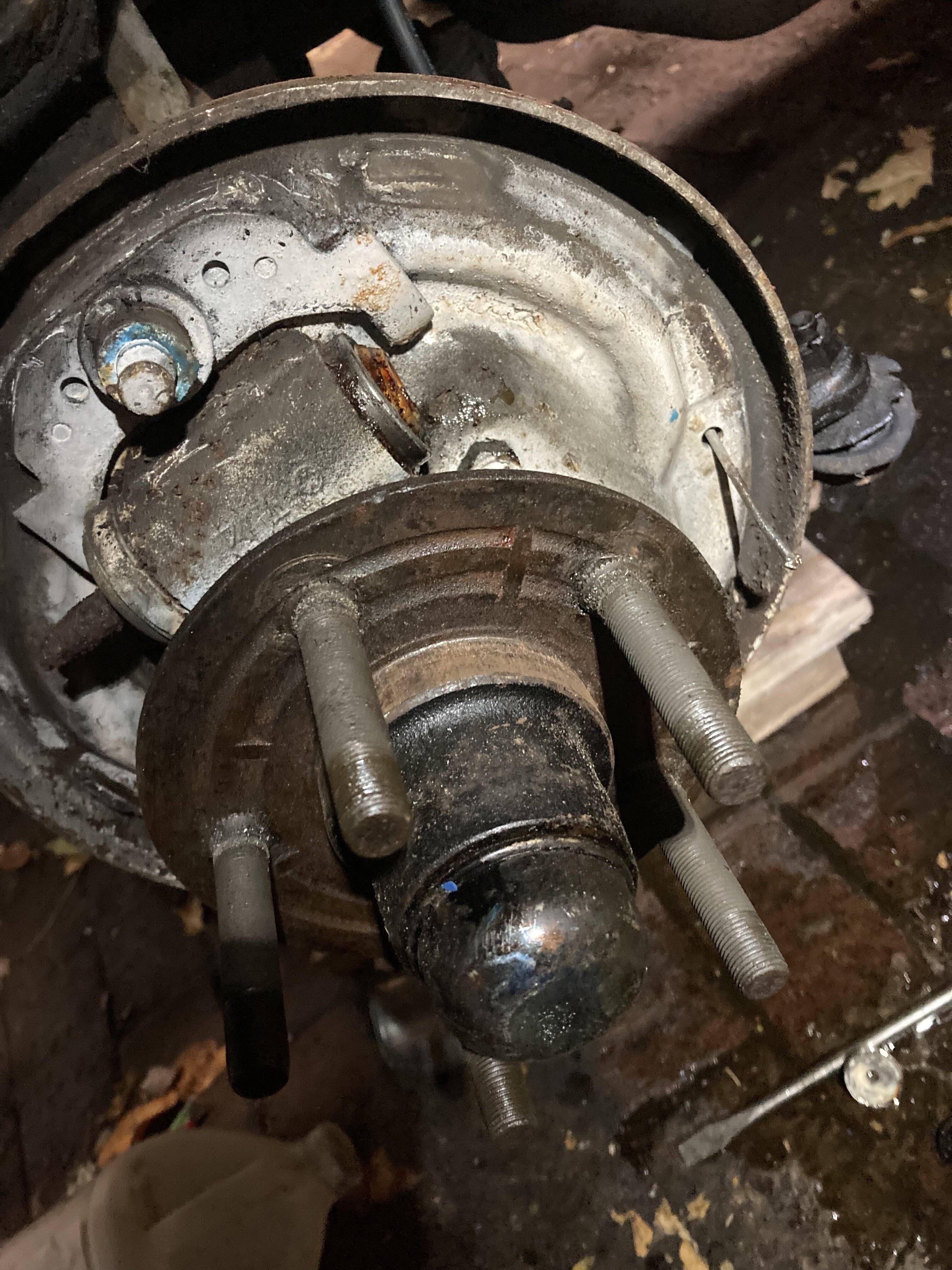

I’m trying to get the brakes working on my 1970 Challenger project.
So far I’ve replaced the master cylinder, all the rubber lines, and a few hard lines.
I had pulled the rear drums and the brakes looked decent.
I didn’t pull the fronts because I mistakenly thought I had to pull the hub off the spindle to get the drums off.
Anyway after all that I was bleeding the system, finally getting fluid from all the bleeders.
When I thought the pedal should be getting hard I heard fluid running out. It was the left front wheel cylinder.
Pulled the front drums and was surprised to see no parts inside the left side.
Now I’m having trouble finding a hardware kit. I think the shoes are the same as rears. I have some of those.
Originally a 318 automatic car.
At this time I am just trying to get brakes functioning so I can move the car around safely.
Does anyone know what hardware parts interchange on these 10” front drums?

For the time being I have just plugged the line to this wheel.
No sense getting carried away before I really know what I want for the brakes.
As others have said front discs are the way to go.

Yeah, Someone made a mess out of those drums. Why the extra long studs? I too have a pair of nice (stock 70) drums and hardware from converting my 70 to discs. If Rapidfire don't get you fixed up, let me know.
padam
Nov 3, 2022
20
7
Canton, OH
The car has Weld drag lites on it and the hubs are really thick on those. It’s an old race car.
I appreciate the offer s guys!
