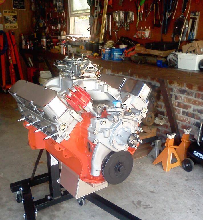

This is what $5000 looks like - full roller motor built from a $250 '67 440 junkyard turd (lots of 440Source parts used).
440amf
Aug 23, 2011
5
Hubba hubba, that's just pretty, thanks for posting it.
