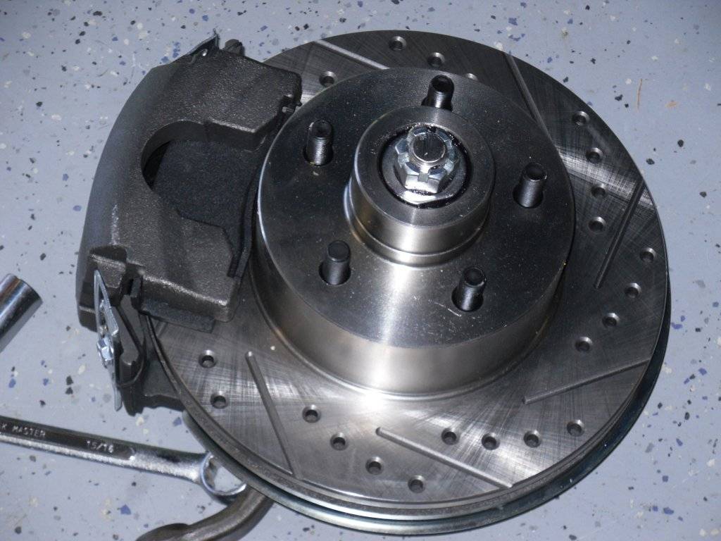

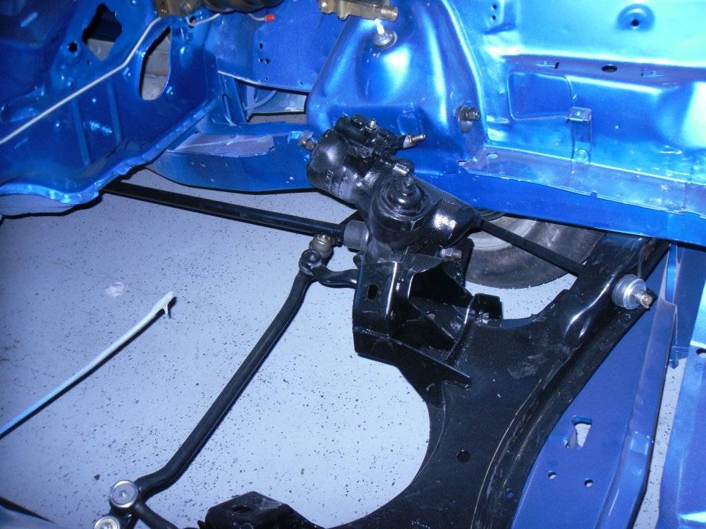

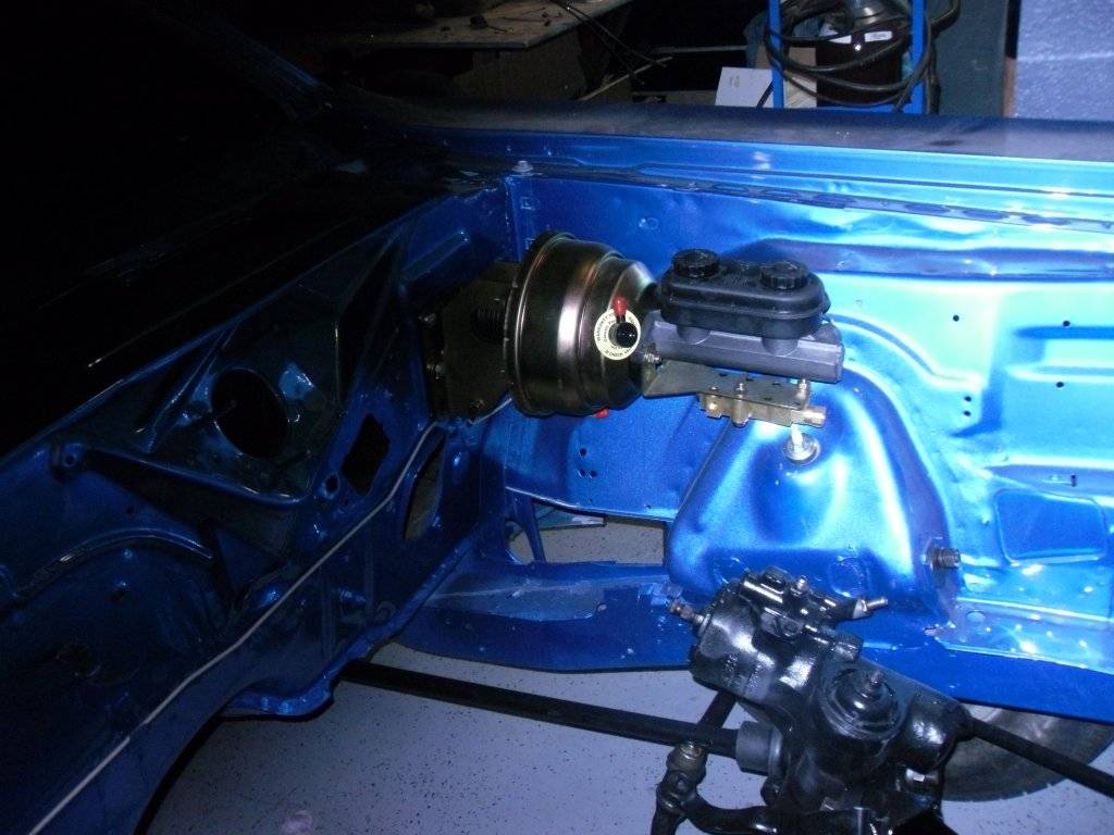

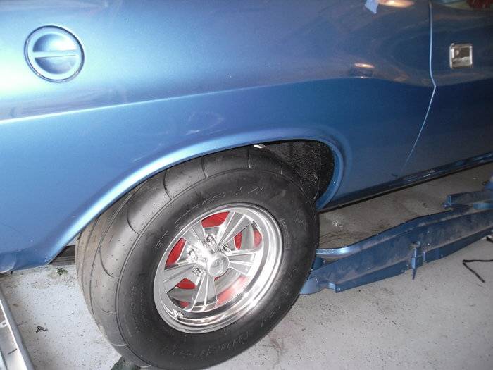

Progress report. Before you give me *&#@ I know! I know! I should have dropped the body over the K Member, with Engine and Trans. Unfortunately, My son was doing a magazine article on the CPP brake kit and upper control arms, so I couldn't get everything else prepped in time to do it the "right way." Here's where I'm at. Now sitting on all four wheels for the first time in about 1 1/2 years. Front suspension is in, rear suspension is in. Frame Connectors and Torque boxes are in. I boxed in the Lower Control arms with the PST stiffening plates, which worked beautifully. Brake system at 90%. (I need to adjust some brake lines to work with the CPP kit.) As you can see the CPP brake Booster and Master are enormous. I am a bit concerned if they will work properly with my engine setup and the anticipated TTI headers I will be using. I searched like crazy and could not find any photos or quality reviews from anyone else using that setup. The rest of the CPP kit fit beautifully and I love their tubular Upper Control arms.

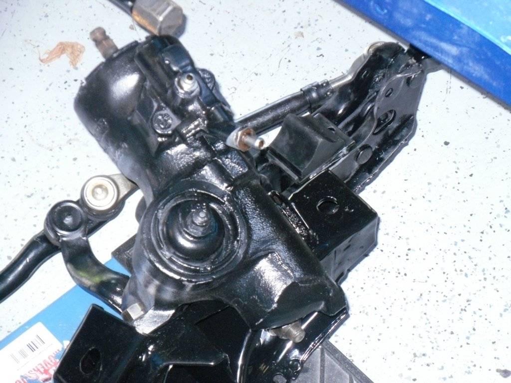

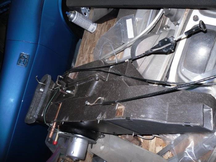

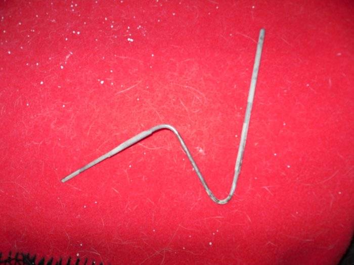

things are starting to move again on this project. Trans rebuilt and upgraded with lots of parts from Cope Racing and other suppliers. The heater box was freshened up. Starting to prep interior and under carriage. Looking for help on the part pictured on red blanket. I lost some photos and can't remember where that came from. (pics appreciated) Also, If anyone can post pics of brake line routing under the car. (particularly where the mounting tabs and clips are located) I can't find my pics of those either and not much available online or in my service manual. Just a point to anyone looking to do a restoration. Be sure to keep photos of everything in one safe place. I had mine scattered over multiple devices. In the years since I started several computers crashed or were no longer available, I destroyed a camera, and changed over Cellphones. I think this resulted in lost documentation. I now have everything I could locate on one external hard drive.

I'm not sure about the part; the car is coming along nicely, I love the B5!

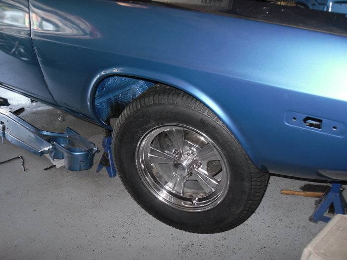

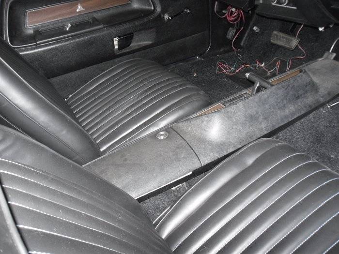

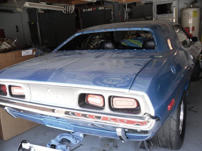

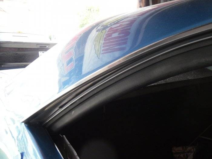

Moving faster now... Dynamat installed, side windows and door hardware back in, rear tail panel painted and tail lights restored, roof rail and door weatherstrips installed. Getting everything prepared to install interior. More to come Heres a few pics

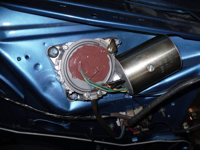

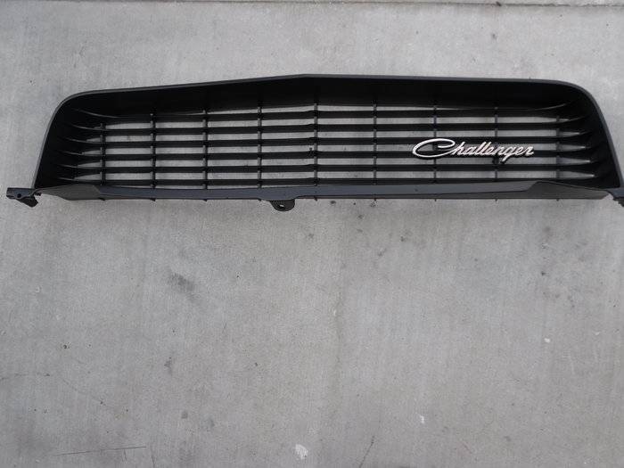

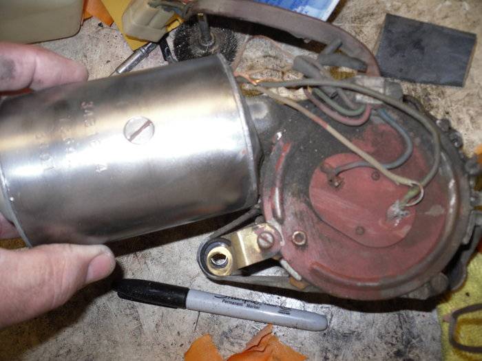

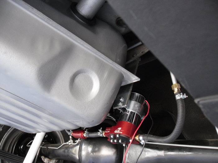

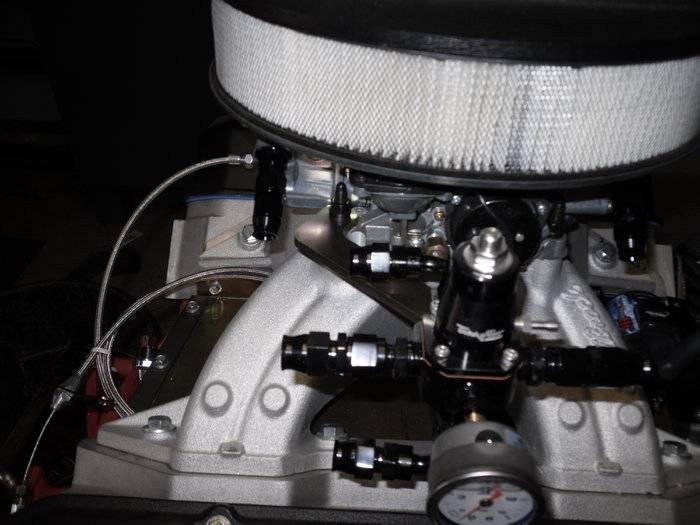

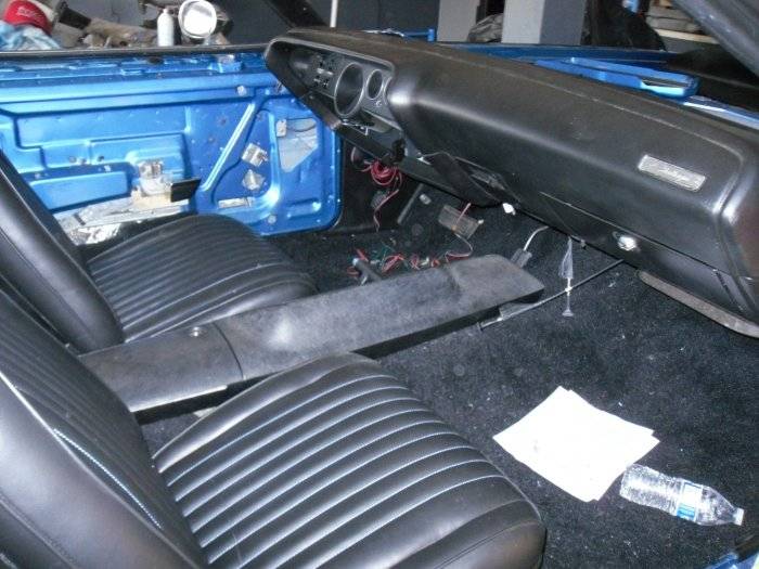

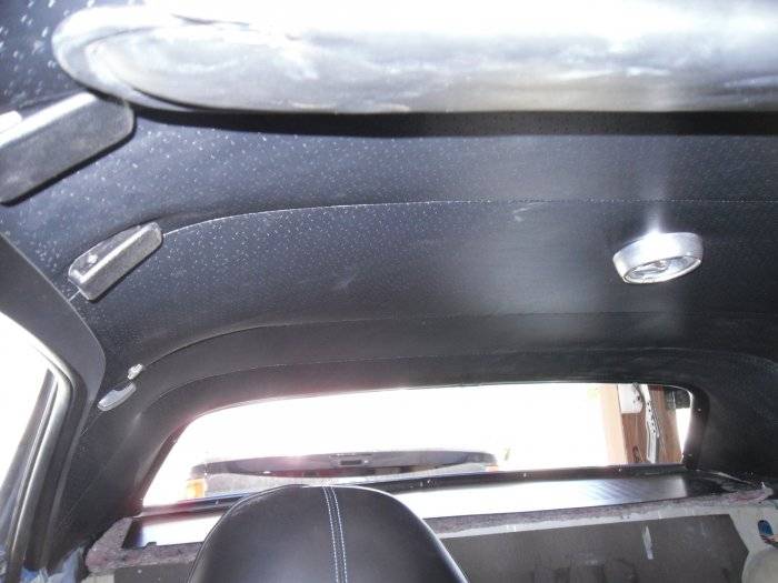

Interior done. Working on fuel system conversion to electric pump with return system. The rear section is done; tank, filter, pump,and new vapor seperator hoses. New inline tube fuel, return, and vent line setup to front. I can't really set up the front system until I get the engine in and decide whether I want to mount the bypass regulator on the firewall or if it will work on a regulator mount from the carb. Wiper Motor restored by Moparleo reference here on FEBO, Bruce Somer. Grill cleaned and repainted emblem restored. (Mine was originally light argent, but with the black hood I intend to install, I didn't want argent up front. I'm also prepping to get the windshield and rear window installed.

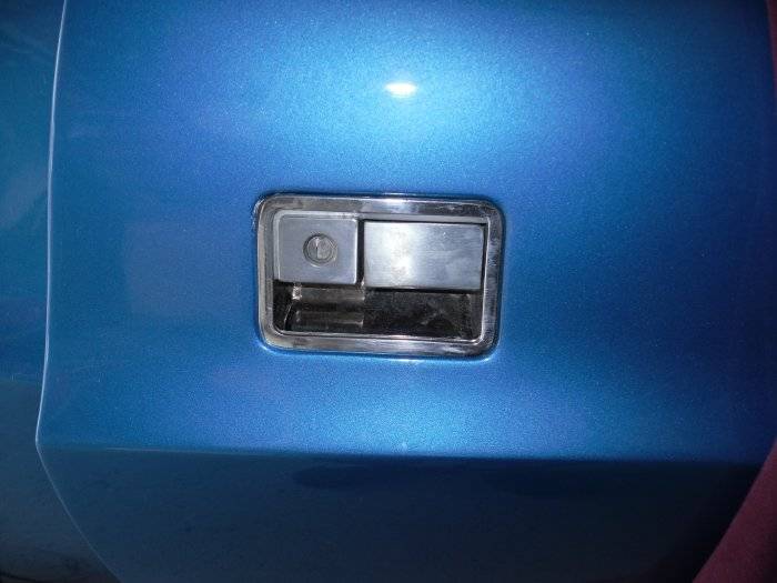

I do have a question if anyone can help out. I replaced by rear deck filler with an AMD panel. It does not have pins or holes for the reveal molding. I bought screw in type to secure the trim. Does anyone have a picture or diagram indicating how many of these there should be and measurements on where these should be located?

I found the best answer to the above Trim clip question on another Challenger site. For those with my same dilemma; the answer is simple. There are holes underneath the deck filler panel on the rear package tray/speaker panel. Look up under the deck filler and you can see those holes. They are larger than the trim clip screws to allow clearance. Install screw in style trim clips at those locations. Mine had 8. I'll post pictures asap

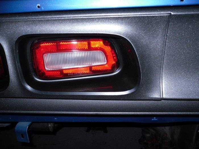

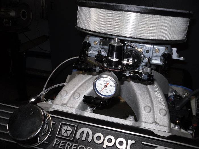

Progress update. Located a deal on new Goodmark bumpers and installed the rear. Fit was good. Quality not as good as original, but for the cost of rechroming vs these it was a no brainer for this car.

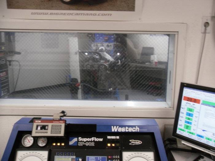

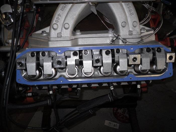

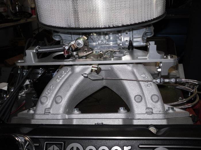

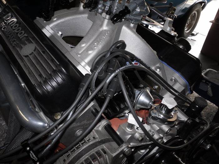

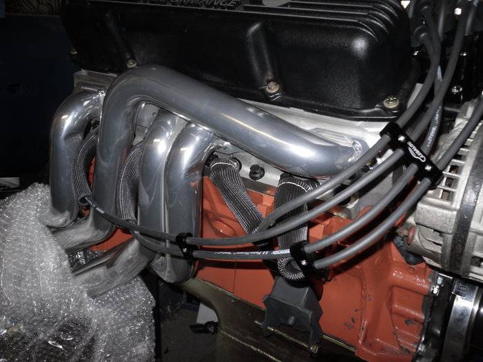

Prepping Engine for Dyno. Double checked valve adjustment. Had to make my own regulator bracket. started setting up Lokar cables. Mocked up the TTi headers and cut plug wires to length. made a bracket to mount coil close to distributor

The mystery part might be the fuel vent return line that goes to the charcoal canister under the hood. I have no ref pic right now, sorry.

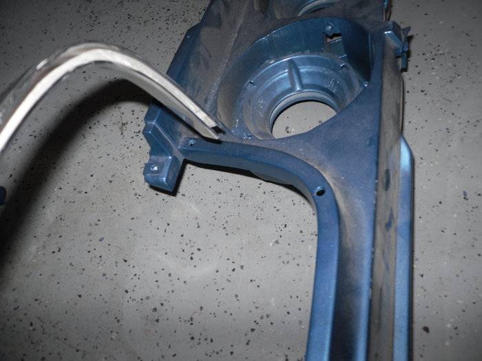

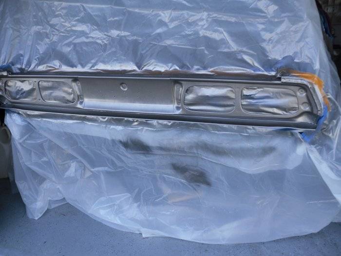

I could use a little help here. Not sure what clips are used to secure the Headlamp panel molding to the headlamp panel (See pic). I can't find pics online. I probably have the clips somewhere, but don't know what to look for. (The body shop took them off, so I never saw them.) Laysons restorations list a part # 356-40713 for them but the pic won't open. Apparently not reproduced..
