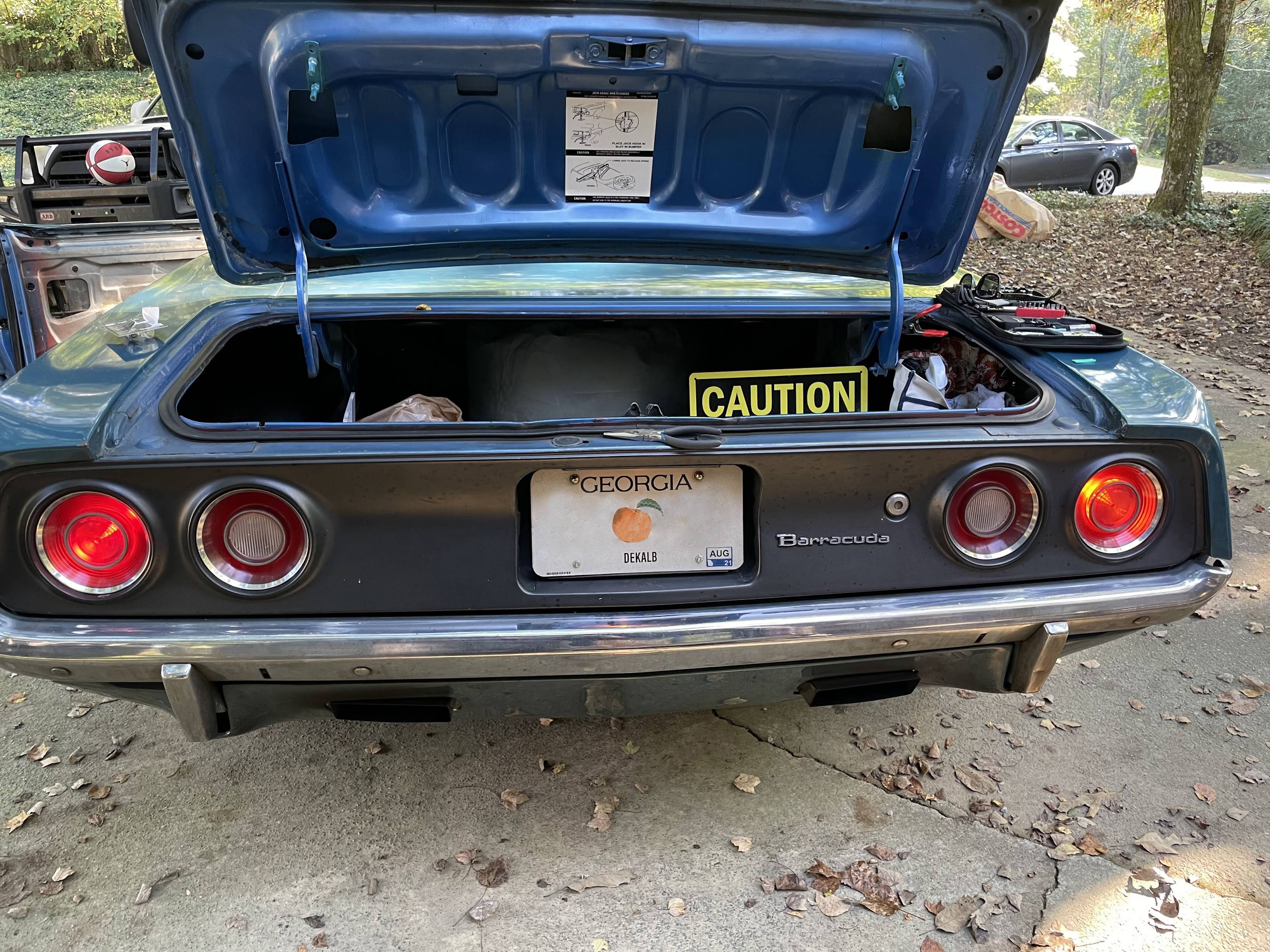

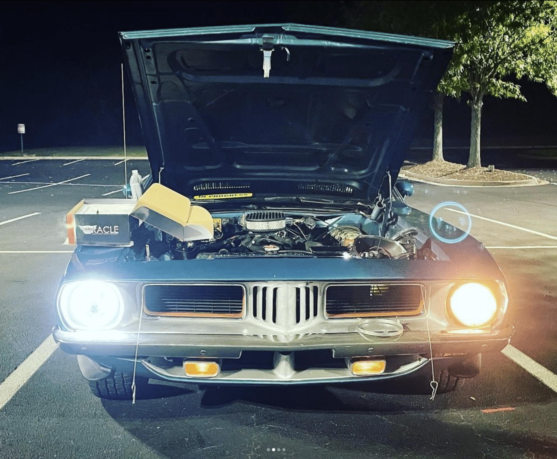

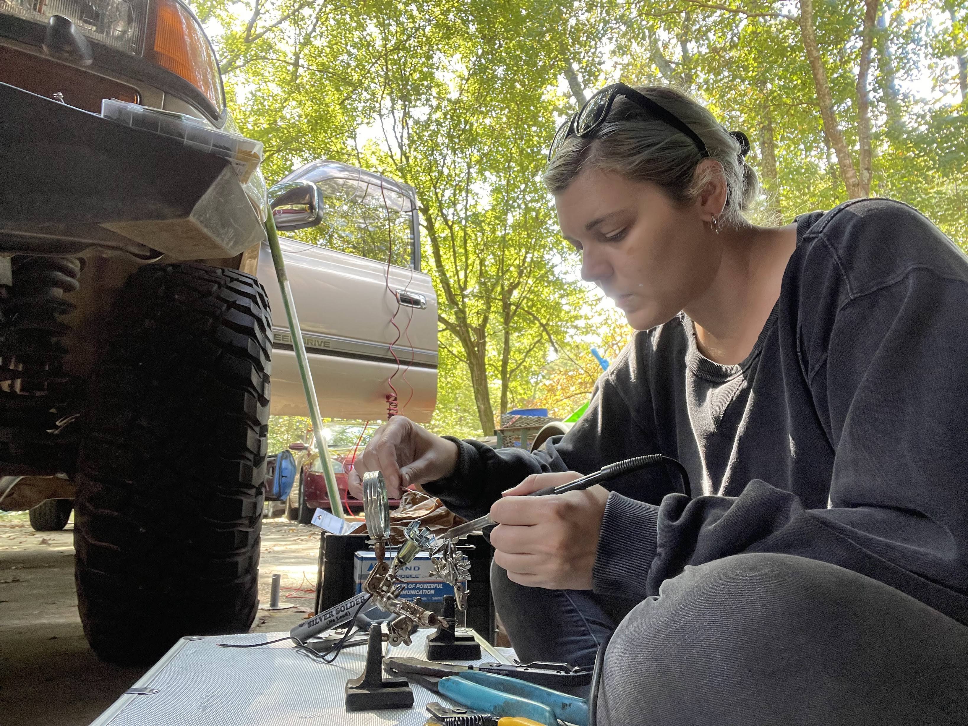

Couple other small projects over a few months. Both practical safety and just vanity. Replaced the normal headlamps with Oracle Halo bulbs and LED bulbs for the tail lights. Wanted to brighten everything up for better visibility. I also learned about having to upgrade relays and that the Hazard relay is not the same as the turn signal relay... ((Electrical systems are NOT my forte...)) I installed the headlamps just as is because it was getting dark and I needed to not spend the night in the Summit parking lot... But the plan is to set up the wiring so the halos will light with the ignition like daytime running lights, and only the LED's will turn on/off with the switch.

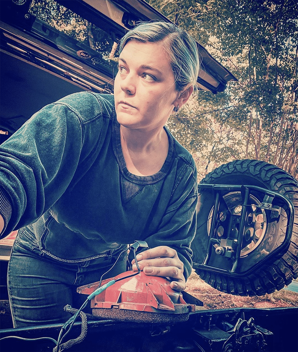

If I may ask, What are you soldering and why.
a bulb socket repair possibly?

Those headlights are amazing compared to the stockers.
