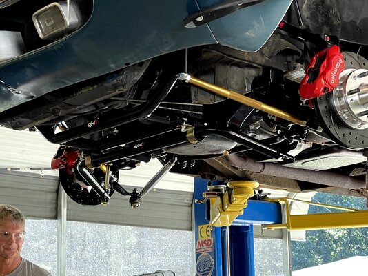

New leaf springs!! I got a pair of +2" Leaf springs from General Spring which fixed the issues with tire strikes I had been having after adding the newer 8" wheels. I had tried rolling the fenders, which mitigated the damage, but lifting the rear end a bit helped enormously while giving me that very 70's aggressive slant. This was a needed, but partial upgrade for the rear end as a whole. The "wooden Rollercoaster" feel of driving it has continued to diminish, but there's still a lot of vibration at high speeds... Not sure if I need an Alignment? Hoping it's not a bigger issue since all bolts were torqued to spec...

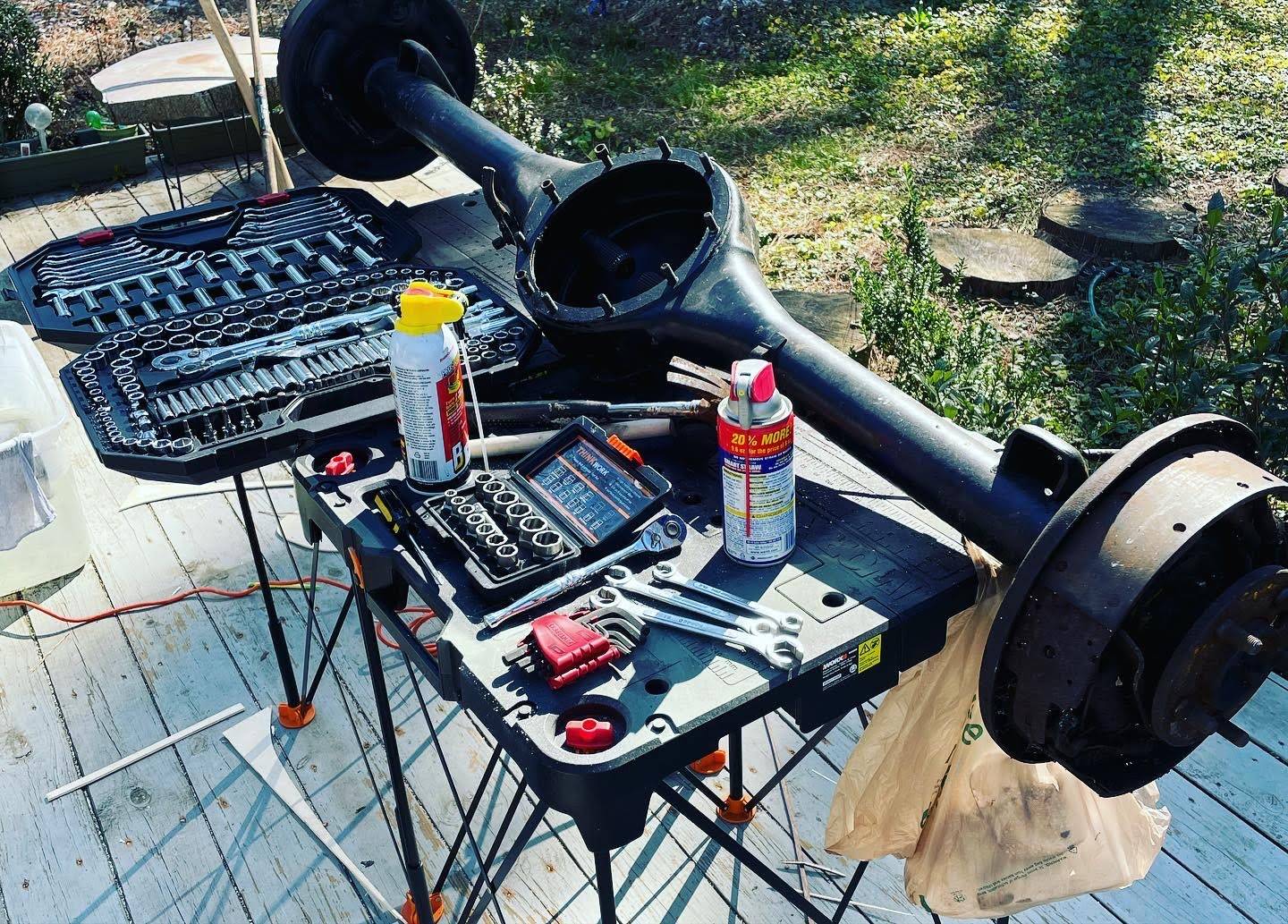

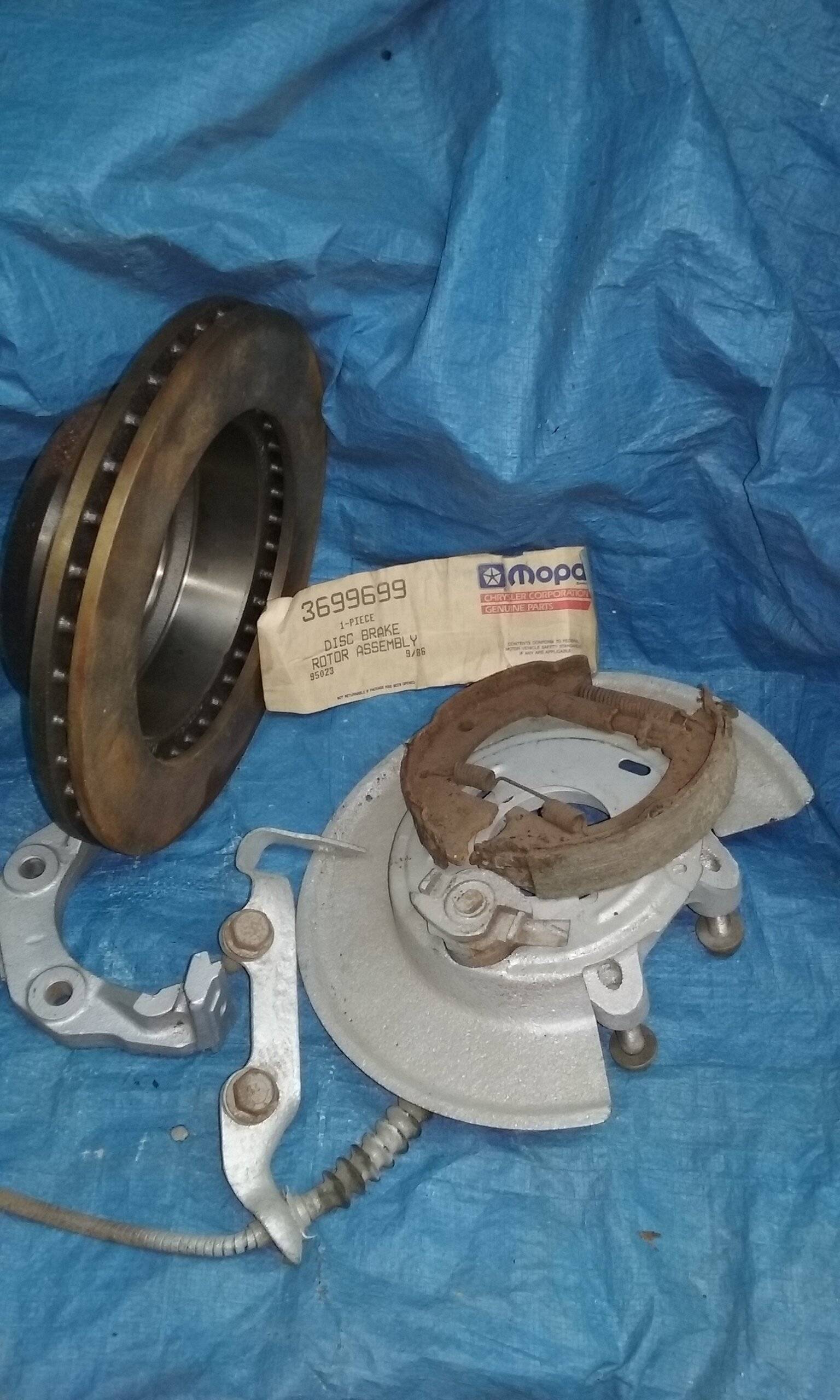

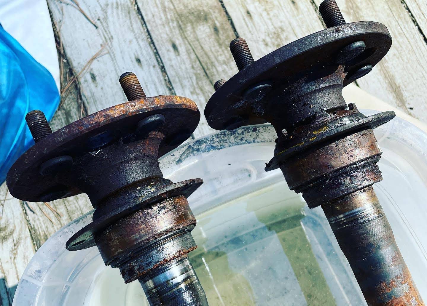

As of today I've begun prepping the new 8.75 rear end. I bought a full rear-end with drum brakes, early last year, but it took me months to find a proper third member for it. Today, I broke down the drum brakes and pulled the axels so I can replace the bearings with green. Once I get the new bearings pressed it'll be a process to put everything back together. I have a Wilwood disk conversation kit, and a ((mostly)) brand new 3.23 third member with Yukon housing. The plan is to build it all as one and hopefully do an easy swap of the stock 7.25 rear end currently there. Added to that project I'll likely add in the Hotchkis subframe connectors I got off a "Picture Cars" guy I know, and the much needed rear anti-sway bar that I was told 'should probably' be on the car, but wasn't... after that it's all about focussing in the engine...

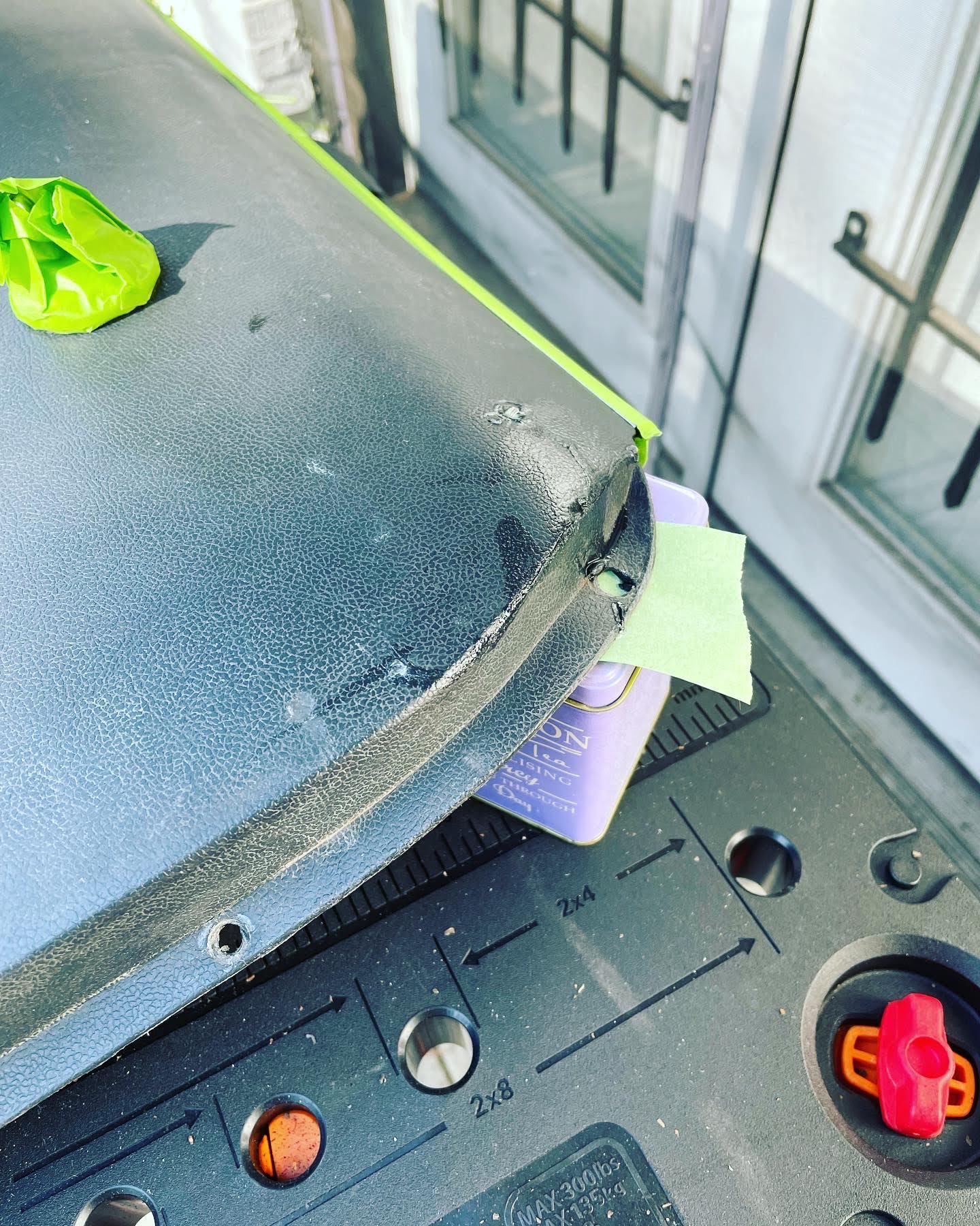

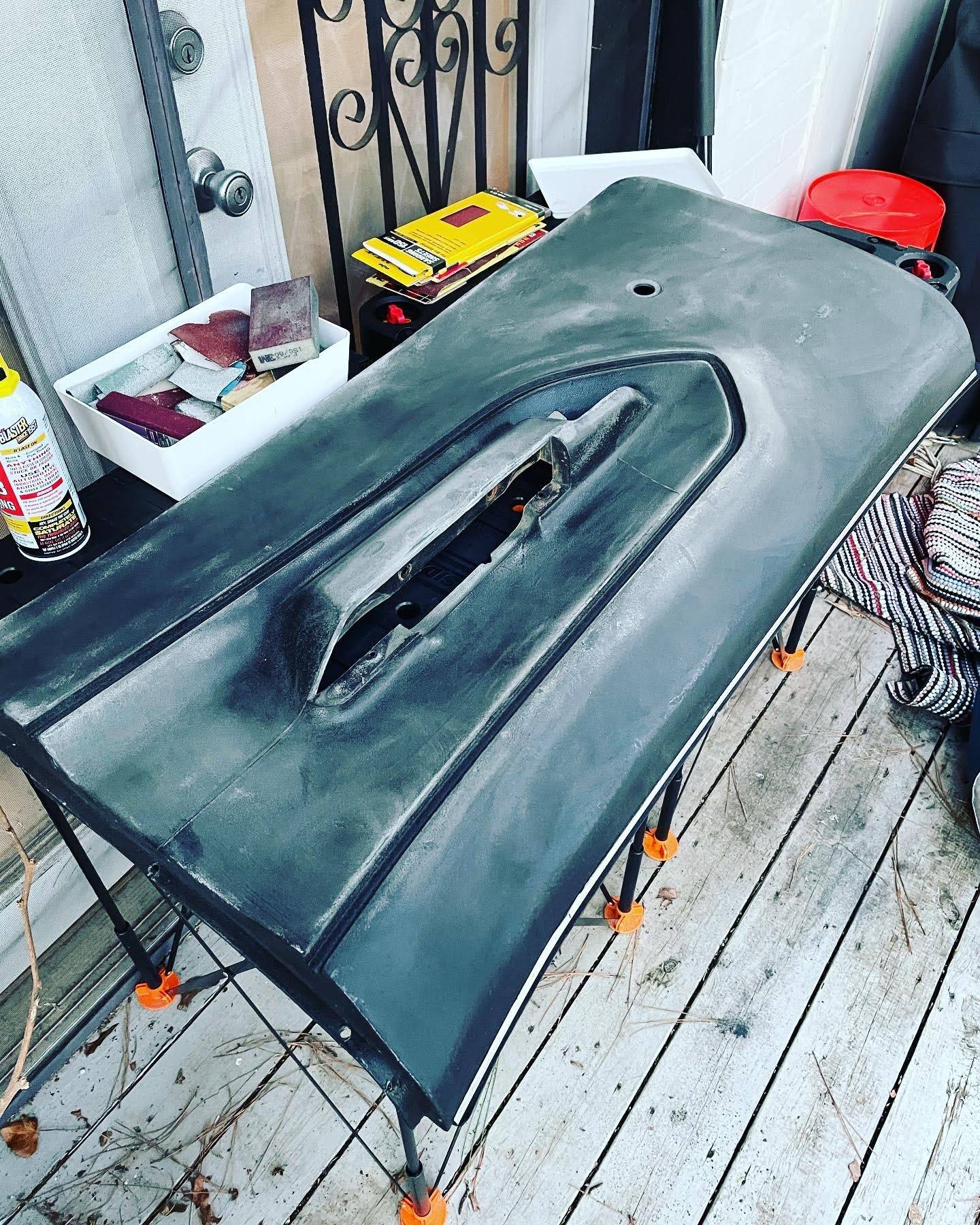

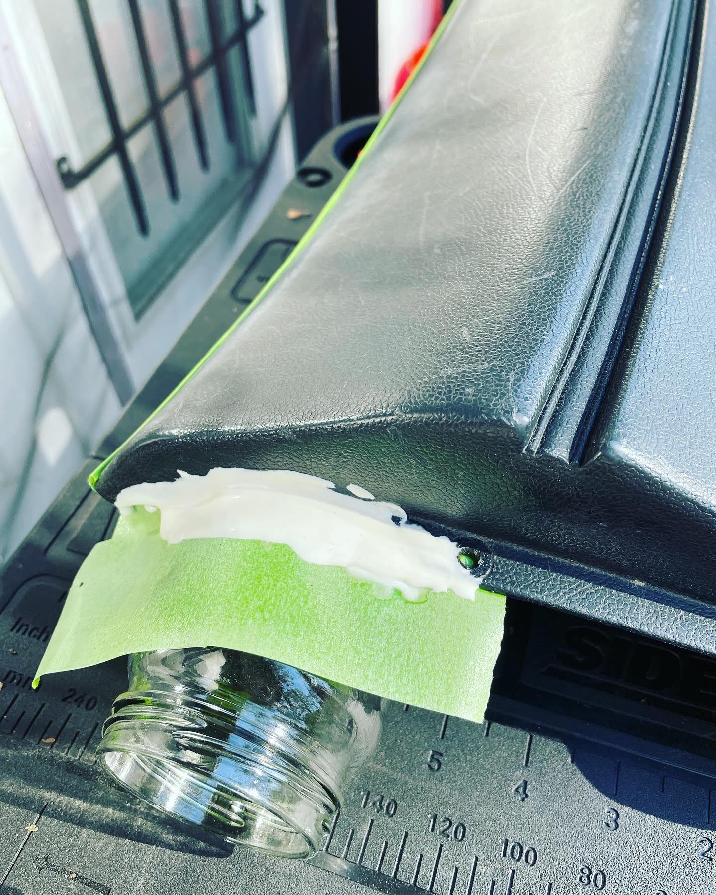

Also along these months some small interior revamps are happening. Since the door panels are basically trash beyond saving, I'm attempting to save them... Building up missing pieces with resin glue, and filling in cracks. Sanding off the faux leather texture to also remove the deep gouges in the plastic. Metal under-pieces scrubbed with wire brushes, and steel wool and painted with rust reforming paint to protect it. New arm pads had to happen, the old cracked and damaged.
But the overall goal is to clean up the interior cheaply until I can afford to redo everything right in a few years.
Let's be clear about that... None of these repairs/upgrades are meant to be permanent. A new trunk divider to replace the once missing, and some added insulation to help with sound deadening. Cheap speakers to replace the dry rotted ones someone installed back in the 90's. The badly 'repaired' speaker shelf replaced with a stained 1/4" birch plywood. The fiber insulation underneath recut in foam.

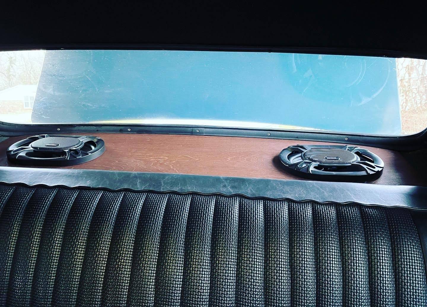

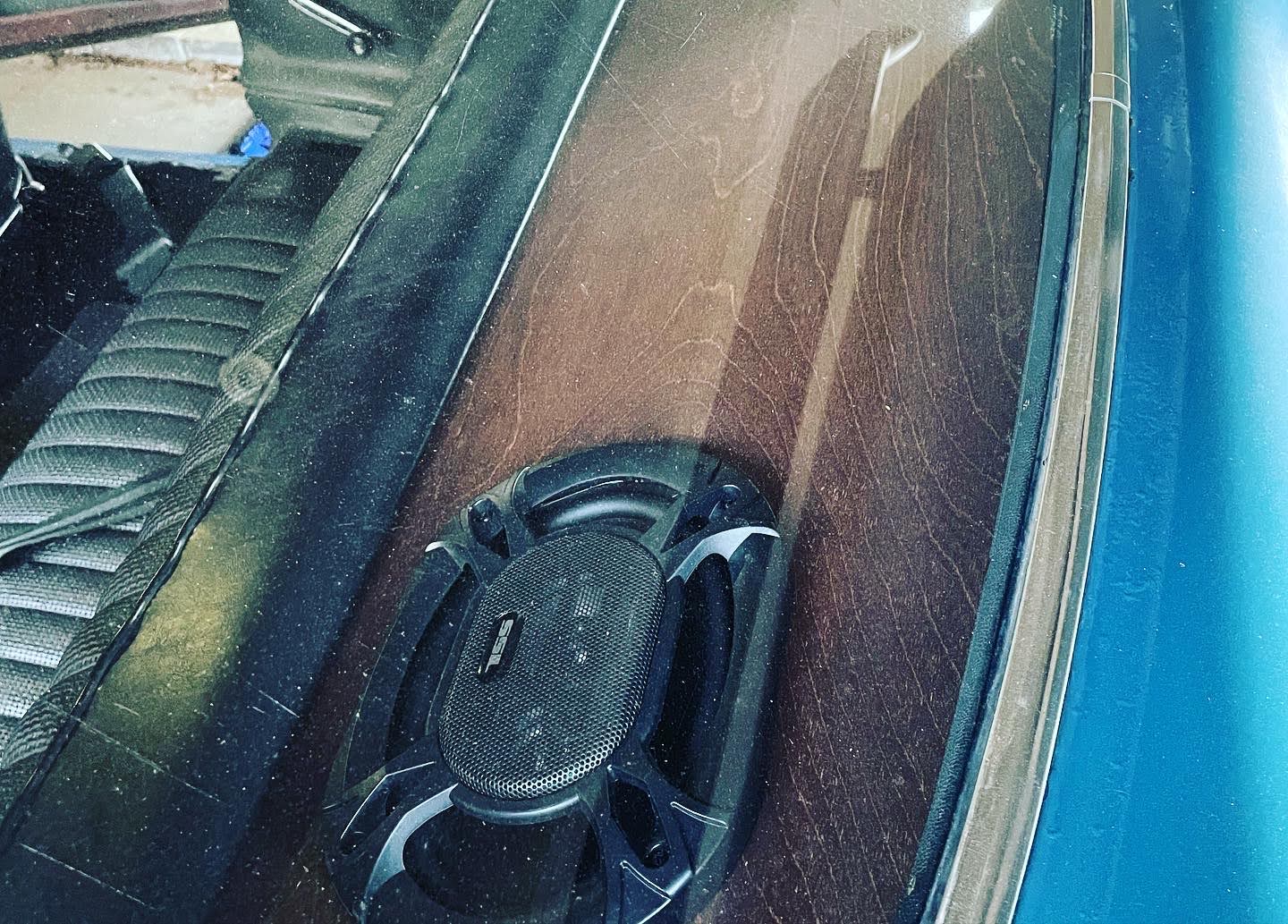

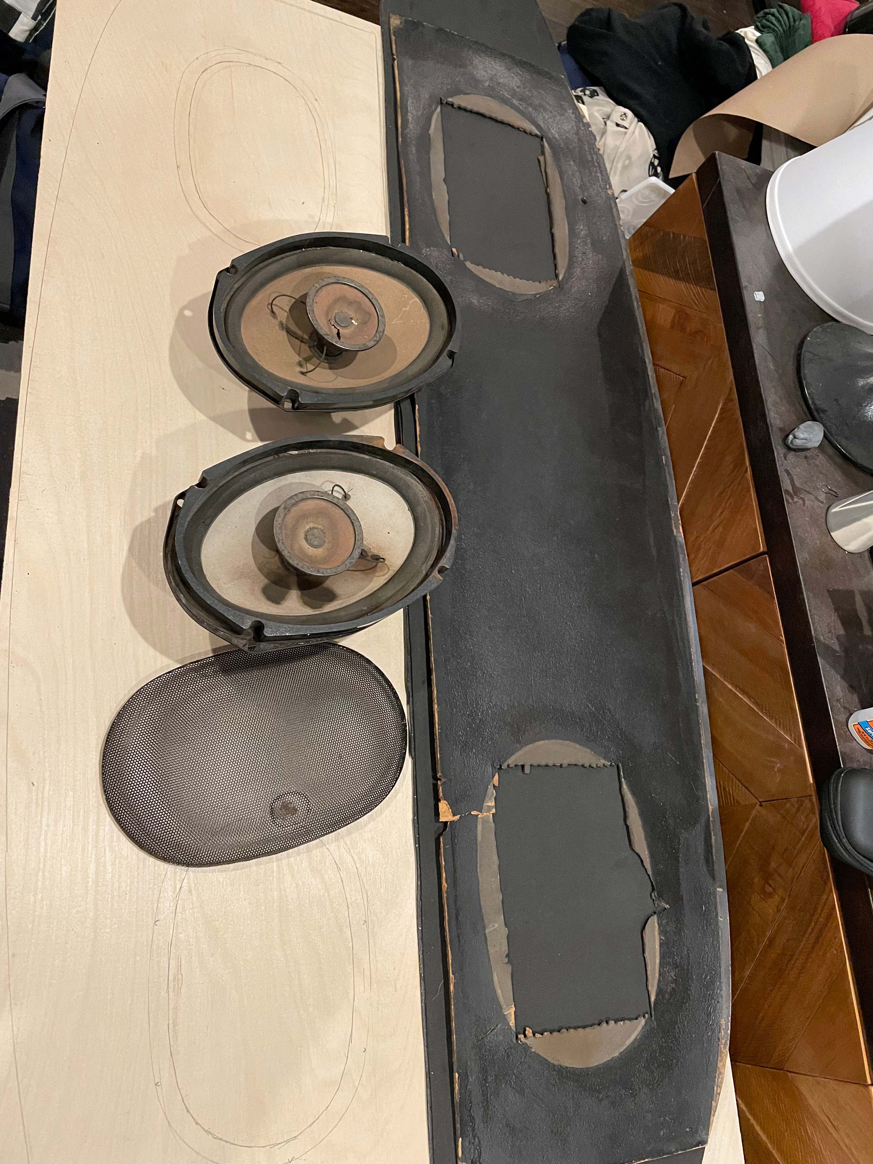

Of course it can never be easy and one of the speakers still isn't working... So that lead to tearing apart the cheap 90's Kenwood cassette player, grinding out the steel plate that was tack welded into the original stereo plate, and replacing it with a cheap Blaupunkt head unit with bluetooth. But of course this means updating the the face plate and adding a storage pocked to fill in under the DIN bracket. One day I want to replace everything with a proper "Vintage Stereo" that's had it's interior revamped to modern but still looks original. But that's $600 I don't currently have. But the wiring is the next problem to tackle. The original wiring is a rat's nest, and nothing like the new wiring the new head unit uses... Eventually I need to redo the whole wiring harness in the dash and interior, but I'm not ready to tackle that yet... I'm hoping I don't have to run new wire back to the new speakers, even temporarily...

JMO but converting to rear disc brakes is just $$$ and eye candy. Not necessary.
And the Green bearing conversion needed to do the disc conversion is a step backwards in strength and durability. Mopar knew what was best and it was not ball bearings.
The best place to put your brake budget is into the front brakes. They do the big majority of the stopping.
Remember that E-bodies are nose heavy to begin with and under braking most of the weight is being shifted to the front.
Just use high quality parts when you rebuild the rear drum brakes and keep them in adjustment. You will also get a much better brake pedal with the drum/disc setup. $ wheel disc tend to have a soft pedal.

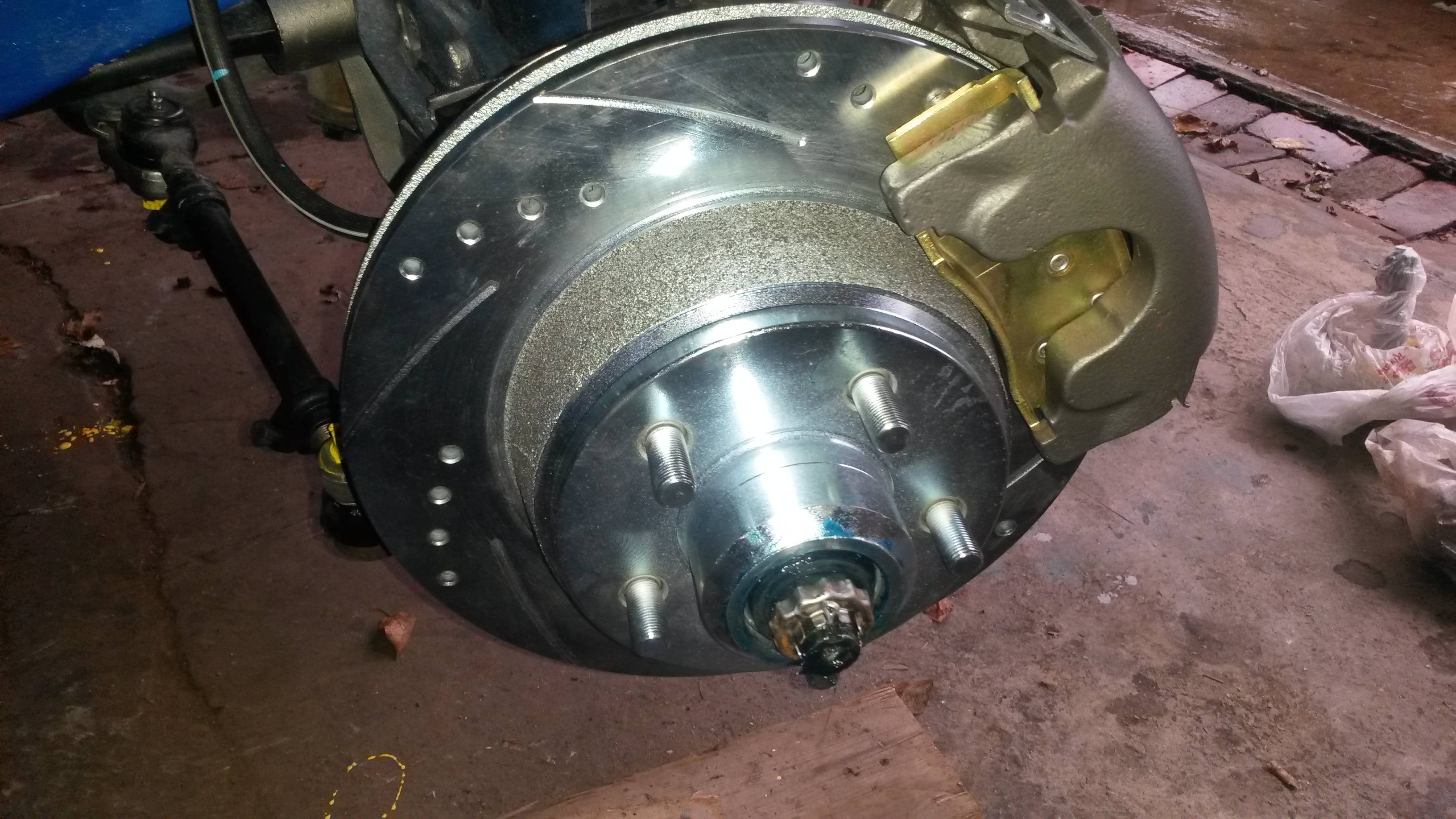

I do appreciate your opinion. I'm open to hear advice, even if it's advice I'm not planning to take. It's important to see all sides of an argument before you make a decision. That being said::
1. I've already done the front brakes and the entire front suspension system. It was the first thing I did because I knew the car was front-heavy.
2. JMO but if you're gonna rebuild something, you should build it better. I don't consider safety to be eyecandy. I live in Atlanta where people are awful on the roads and I consider the ability to stop on a dime the single most important thing I need in my vehicle. I don't consider drum brakes superior to disk brakes. I understand the science and that the difference is negligible, but disks still cool faster and there's less chance of break down if having to do fast, hard braking multiple times in a short time period. And if you think I don't have to do that in everyday driving, you've never dealt with I20 during rush hour. A side note is that they're easier to change the pads on, and yes, they do look better.
3. The green bearings were recommend by 4 different people for the needs I have in mind for the car. One had 30+ years of experience in Chrysler Certified Service shops and the other three were all drag racers with their own 30+ years of experience in various automotive industries and hobbies. At this point though any additional argument is moot because the bearings are on there and I'm not cutting off brand new good bearing to change them.

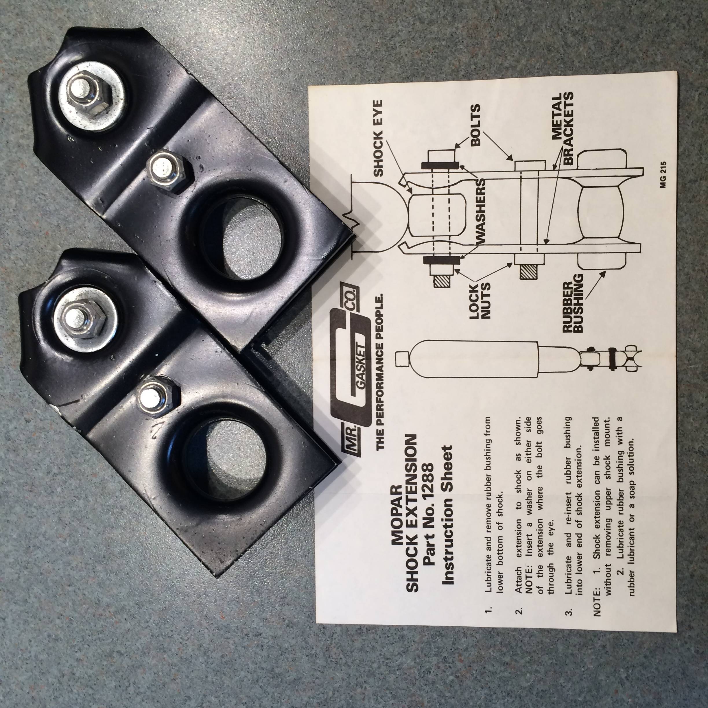

The Wooden Roller coaster feel can be reduced with air shocks and extensions can be placed on the top side of shock and reduce air pressure. Worked for me did a lot of highway driving. How ever it does change front end alignment a little bit. When done with suspension (put the big weenies 🪄on 11/16 tie rod) steering,brakes(There is so much more to be gained with larger brakes on the front 11 3/4" rotors.Or bigger! Best money ever spent.(70-80% of stopping power comes from the front).ABS rear would be the most beneficial.( Articular using Dakota rear ABS system and a Ford 🤮8.8 tone ring.)I have had 2 1/2 sets of hens teeth🐔 for decades and yet to put them on because of Green bearing. I would have thunk🤔 there would have been a fix for that by now?I agree the rear disc look good if you can see them.and other factors easier to maintain🛠️ and cool off quicker in racing conditions. Drum brakes done right last 100k miles.When the Parking brake is set the adjuster adjust the rear drums.// I would have it Aligned. Aligned📐 with the stance you want. check air pressure and bumper height for reference for street or strip. A little more on pass side helps 🦿with hooking up on track.If you have two singles shocks.//Vibration📳 at high speeds. Could be a number of things U joints. drive shaft splines worn,loose saddle or stripped.Weight has fallen of drive shaft. Worn,broke loose shocks steering components box rods,bearings,bushings.Bent rim tire has busted belt.Tires worn and out of balance?// The previous items are of safety concern that should be coincided. Just my opinion and maybe others. There are knowledgeable individuals here. I wounder what the combined experience is of the members? I understand personal preference rules over all.Game Set and Match! I didn't want to touch the rear.that could touchy and I would get slapped!!!

Air shocks and extensions are just Band-aides and not good ones. Damage to the upper shock mounts was common in the old Air shock days. Proper springs to establish ride height and good shock absorbers to tame the ride are the correct way to do the suspension.

Drag racing with green brgs is very different from street driving as side load / cornering is minimal & yet even drag racing I have seen green brgs fail , they will work for a while but nowhere near as long as a tapered roller , years ago I did find a disc set up where you could use the tapered roller but that was 20 years back & I can't recall which company made them & I didn't buy them , the customer did .

So like the full QA1 Suspension system I put in last August that replaced everything from the K-frame out to the wheels?
