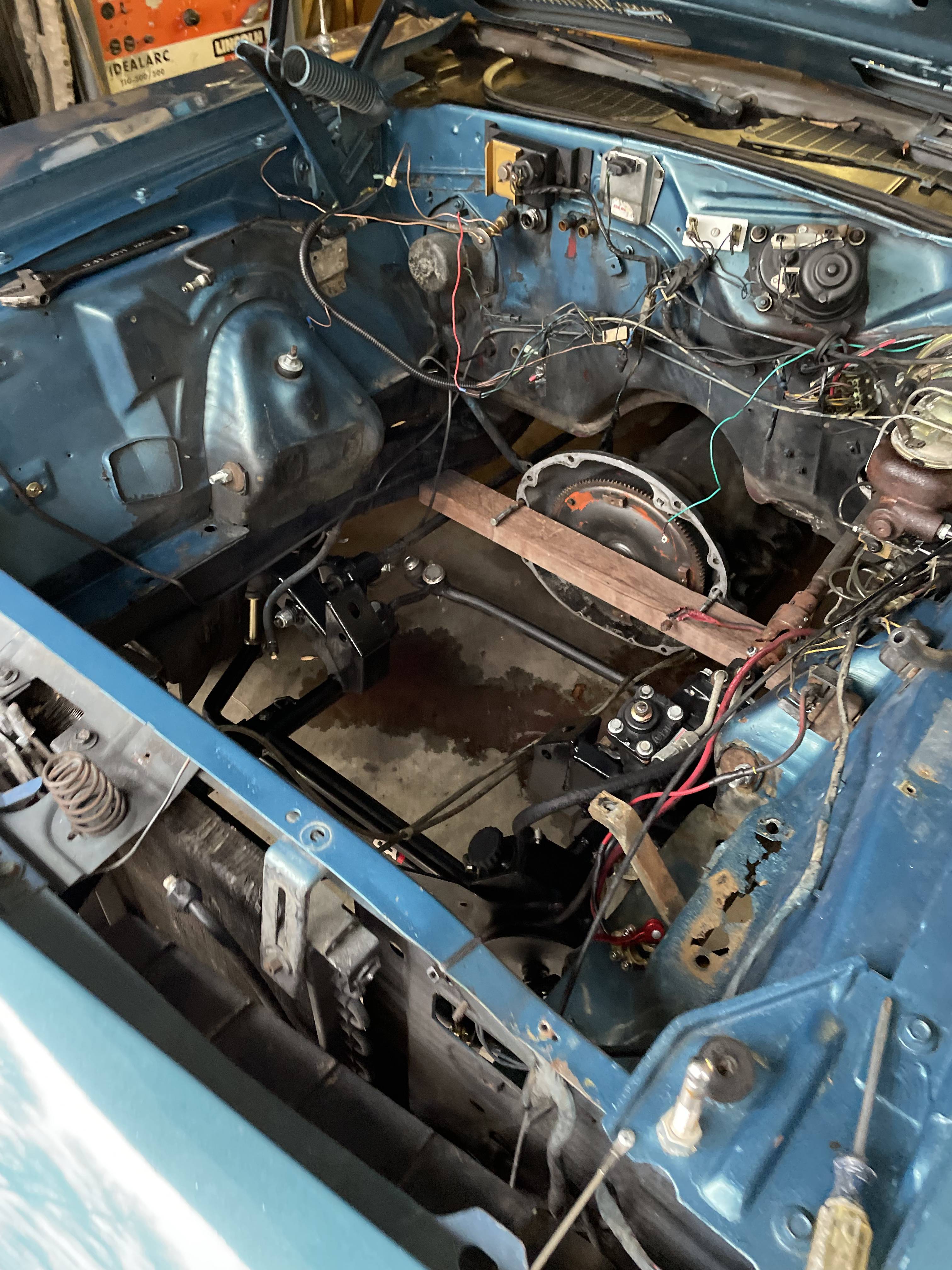

So, the rear end has been put on hold. I got so far as to get the third member sealed into the axel when I realized the bearings someone had recommended were the absolute wrong style for the Wilwood drum/disk conversion kit I was also installing. I bought the correct bearings, and was in the process of scheduling time to have the old ones cut off and the new ones pressed, when-- while coming home from a car show-- the timing chain jumped teeth.

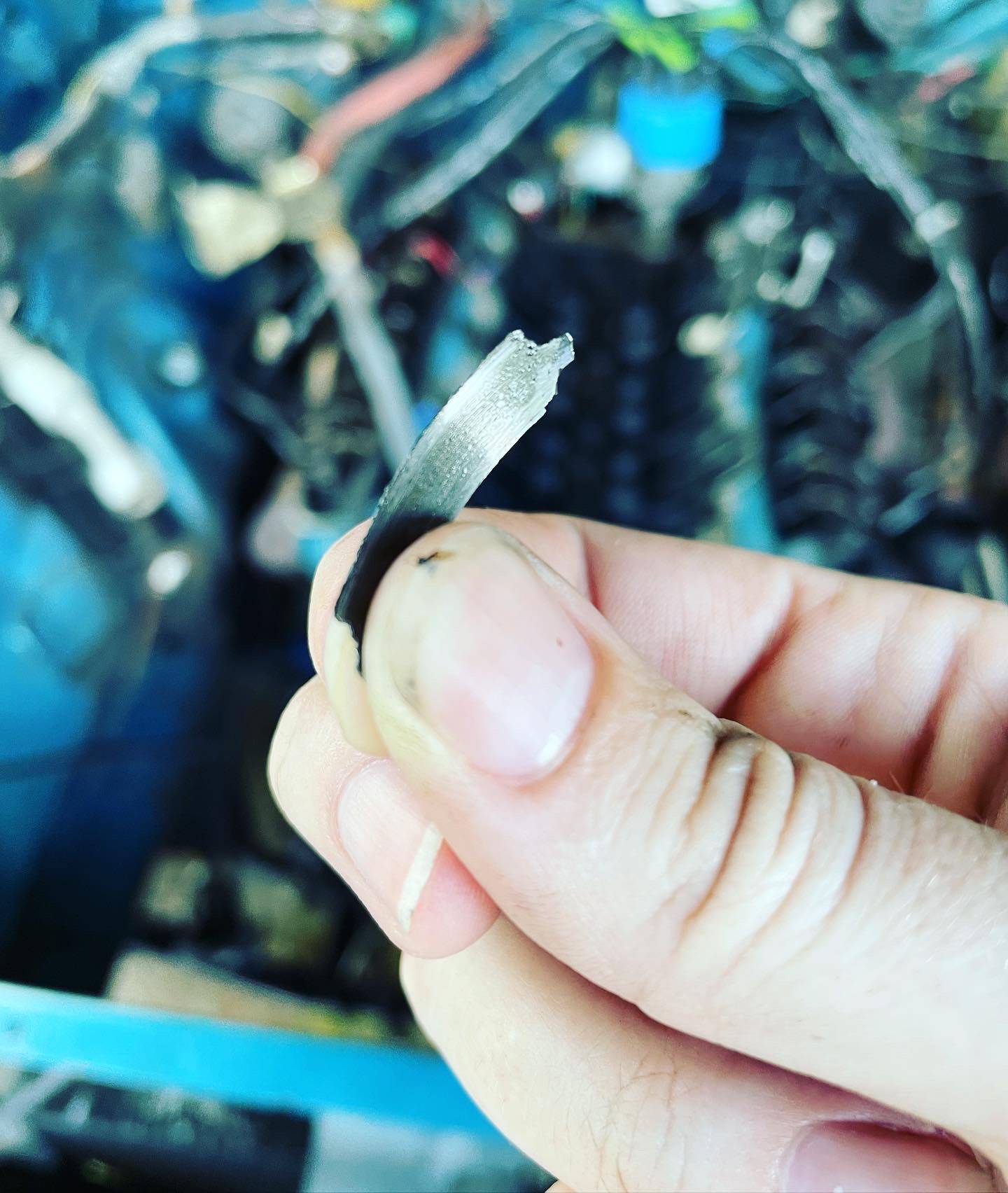

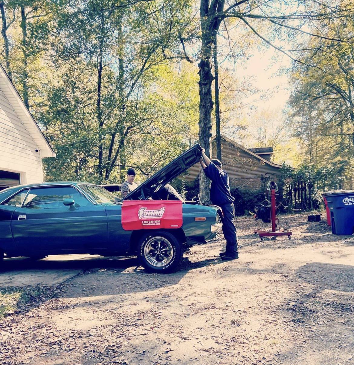

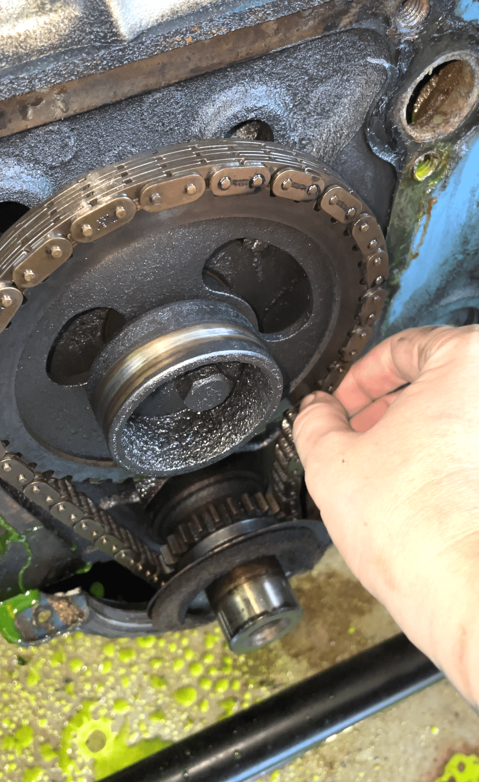

Car stalled out right in the middle of traffic. In August. In Georgia. In 100 degree heat... At first I thought perhaps I was just out of gas. I don't entirely trust my gas gauge, the car was running low and sitting uphill. After walking a mile each way to the nearest gas station to buy and lug a 3 gallon tank of gas back to the car ((Did I mention it was 102°F that day?)) And fighting with a modern refill tank that DOES NOT like having the fuel port under the license plate, I learned it wasn't out of gas. It wasn't overheated. It had oil. Finally was able to roll the car out of traffic and get a tow.

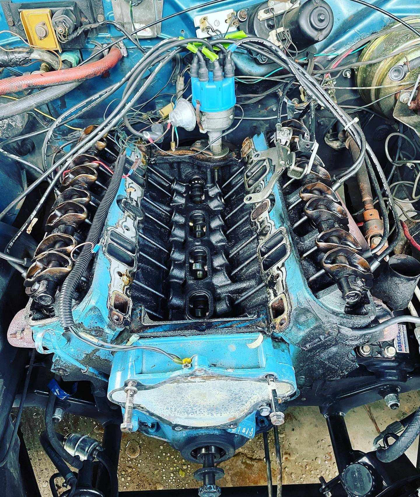

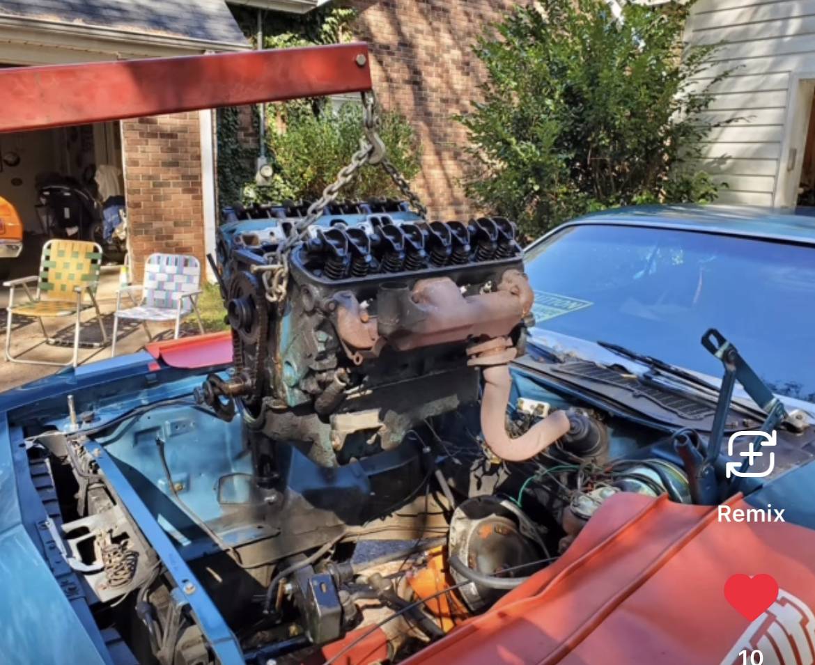

Next day I checked all the usual suspects. Air, fuel, spark... and after much testing and consultation, I determined it was the timing chain. Took me a few weeks to get the time, tools, and second-pair-o-hands to break into it, and sure enough the left side of the chain is as tight as you would expect. While the right side flopped around like it was drunk. So now I had a dilemma...
On the one hand I could spend $300, replace the timing chain, put the car back together and be on my way. On the other, I had already ripped out the broken AC unit, and the "Works but isn't the best" radiator. Fuel pump, water pump, alternator and all else was removed... Many of these parts need updated anyway. There was a lot of back and forth from my resident car experts on timing chain malfunctions causing bent rods that no one could confirm or deny. And the plan has NEVER been to sit on the 318. With the engine already half apart, I might as well pull the trigger on the engine swap I had always been planning, but now certainly DID NOT have the money to do. No time like the worst time, right? Pulling the intake manifold and seeing not only the state of the cam shaft but finding metal in there as well, pretty much sealed the deal.

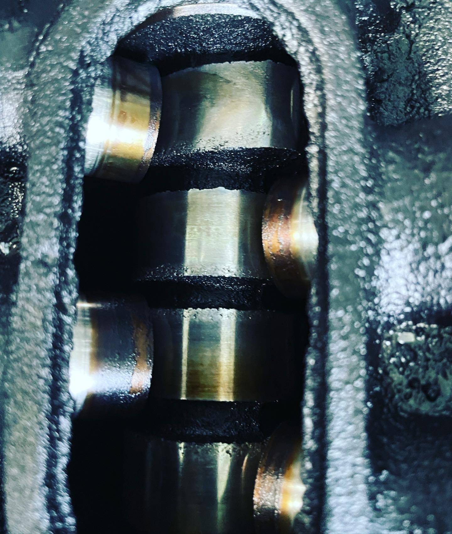

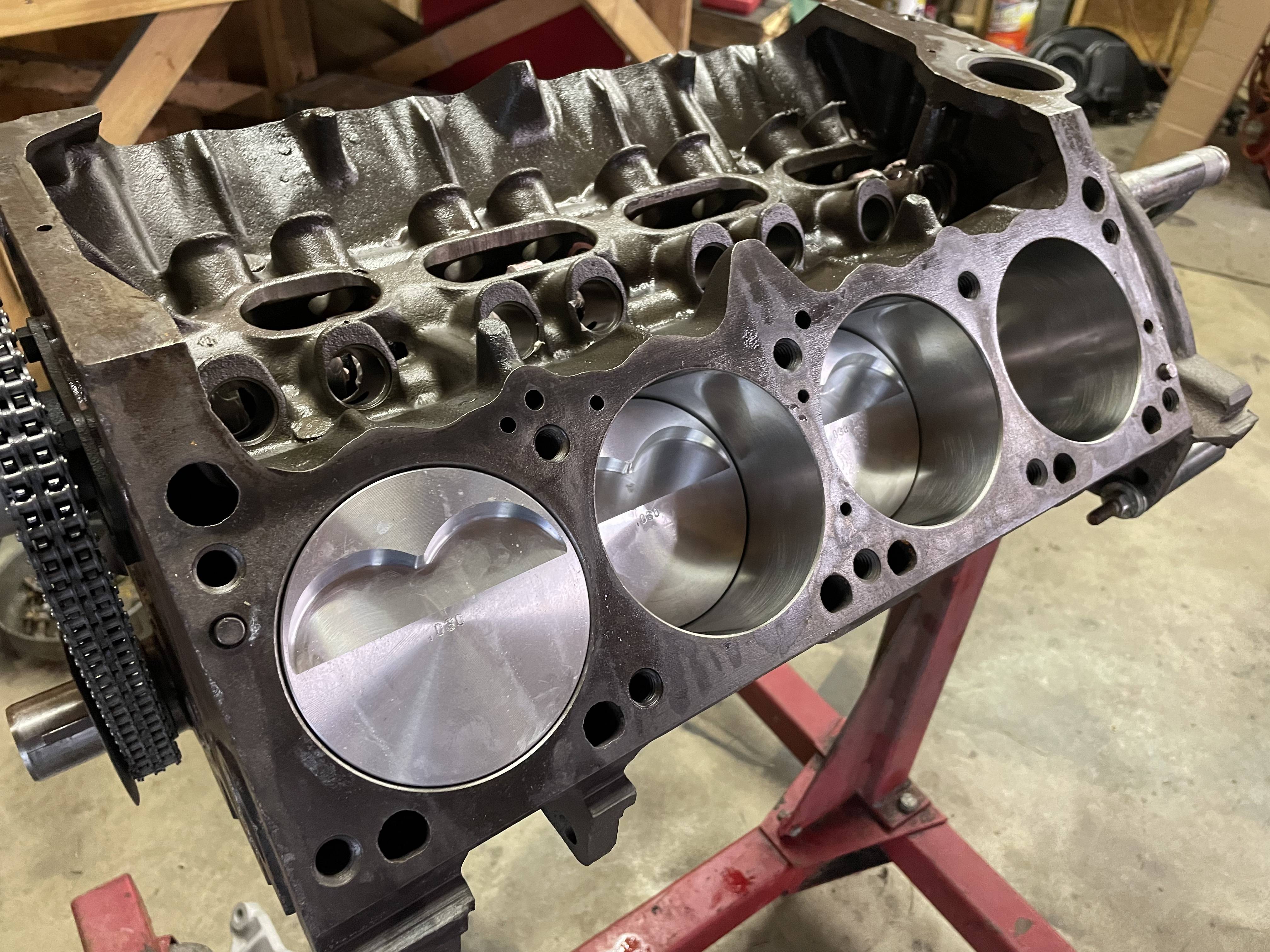

But I connected with one of the guys in my car club who had a lead on a stock 360. Nothing fancy. Machine shop cleaned up the block and did a 0.030 bore on it. Now I'm on a parts hunt. What to buy new vs. what to buy cheap. And of course one thing always leads to another... Need a new alternator? Time to go single wire, which means getting rid of all those ugly extra firewall components for an MSD box and matching distributor... New headers? Well time to do the exhaust as well then... Over and over.
And I'm not surprised or ignorant of this. 12 years of helping my Dad and I'm WELL AWARE that this is just what happens when you take on a project like this and frankly I'm looking forward to it! But here's hoping to have everything sorted and running by the end of the year!

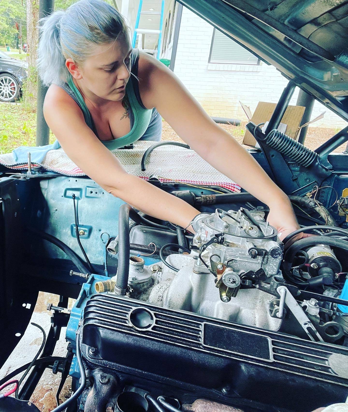

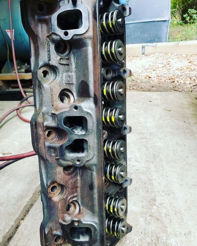

Update 11/15/22

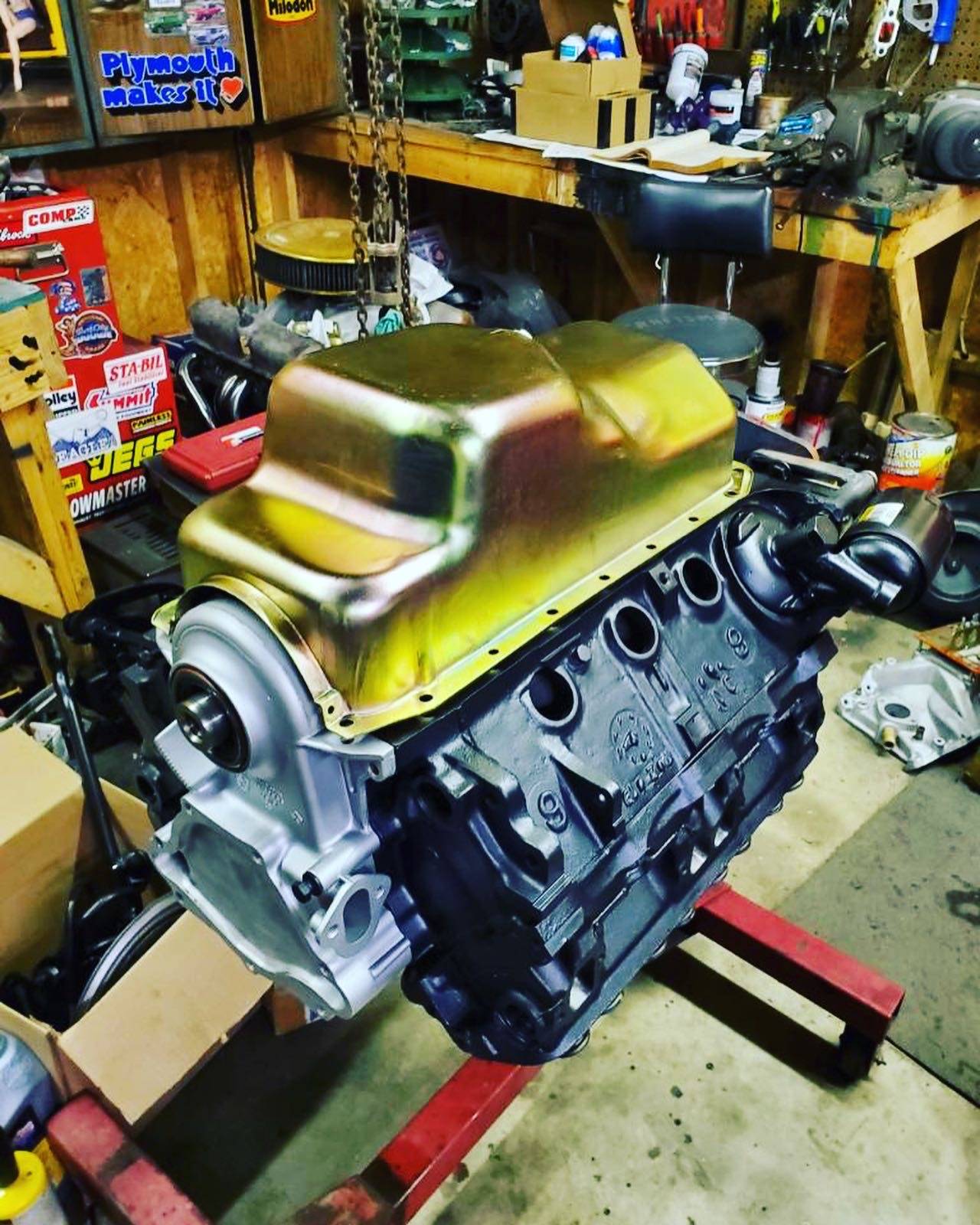

No time like the WORST time to decide to swap your engine! My 6 week gig is wrapped and the money is gone.
But after scrounging what little together I could, I was able to piece together a serviceable engine! It's gonna take a bit of time to get it all in and running, but only 2 hours after leaving her in the experienced hands of my buddy, he already had the 318 out and on the ground! Now it's time for me to do my part to clean up the wiring in the engine bay and start considering the next move... The remaining items are more expensive bits... A new radiator, AC system, and new wiring harness... None of which can be afforded right now... So this is about to get interesting...
But the good news is every photo looks better and better! I went with a matte black for the block. A lot of people will want to argue with color choice. So let me cover the two most asked questions on my instagram already::
Why not orange? Because it's not a Hemi, and I have enough of a job explaining my engine build to people without giving them the additional "Why is it Hemi orange if it's not a Hemi?"
Why not Chrysler blue? Because the car is teal, and will be eventually painted a darker teal and the Chrysler blue clashes horribly with the current color and will not fair much better if I darken the teal. I'm an artist, I care about color.

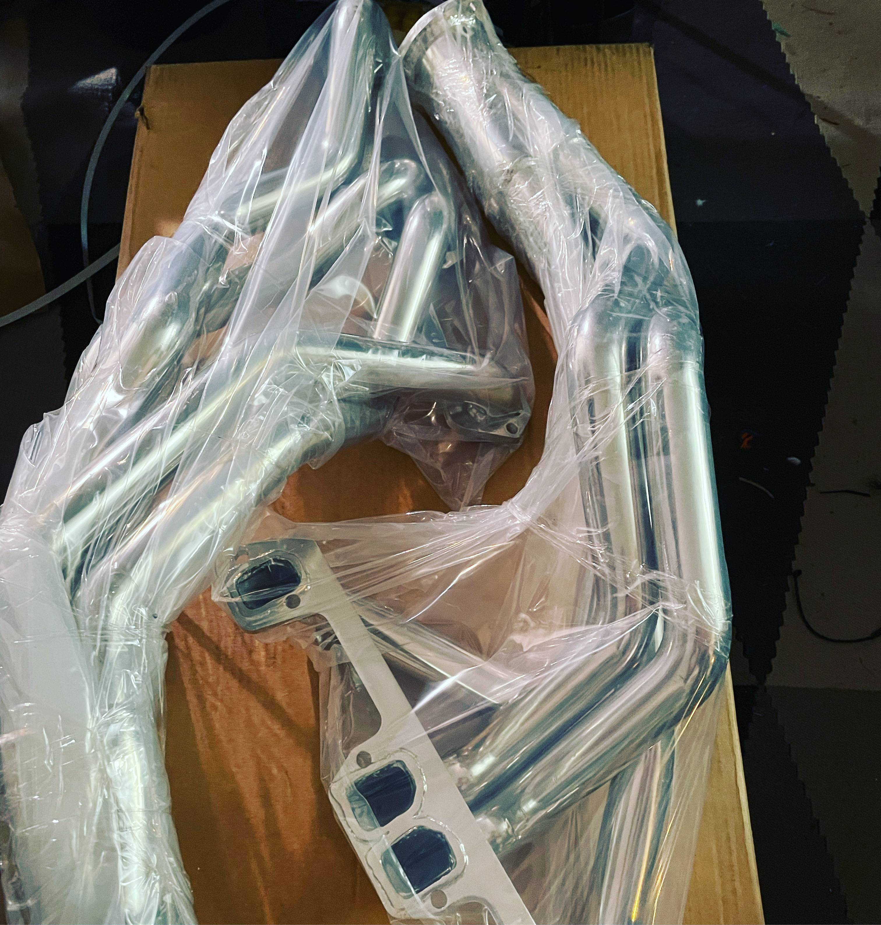

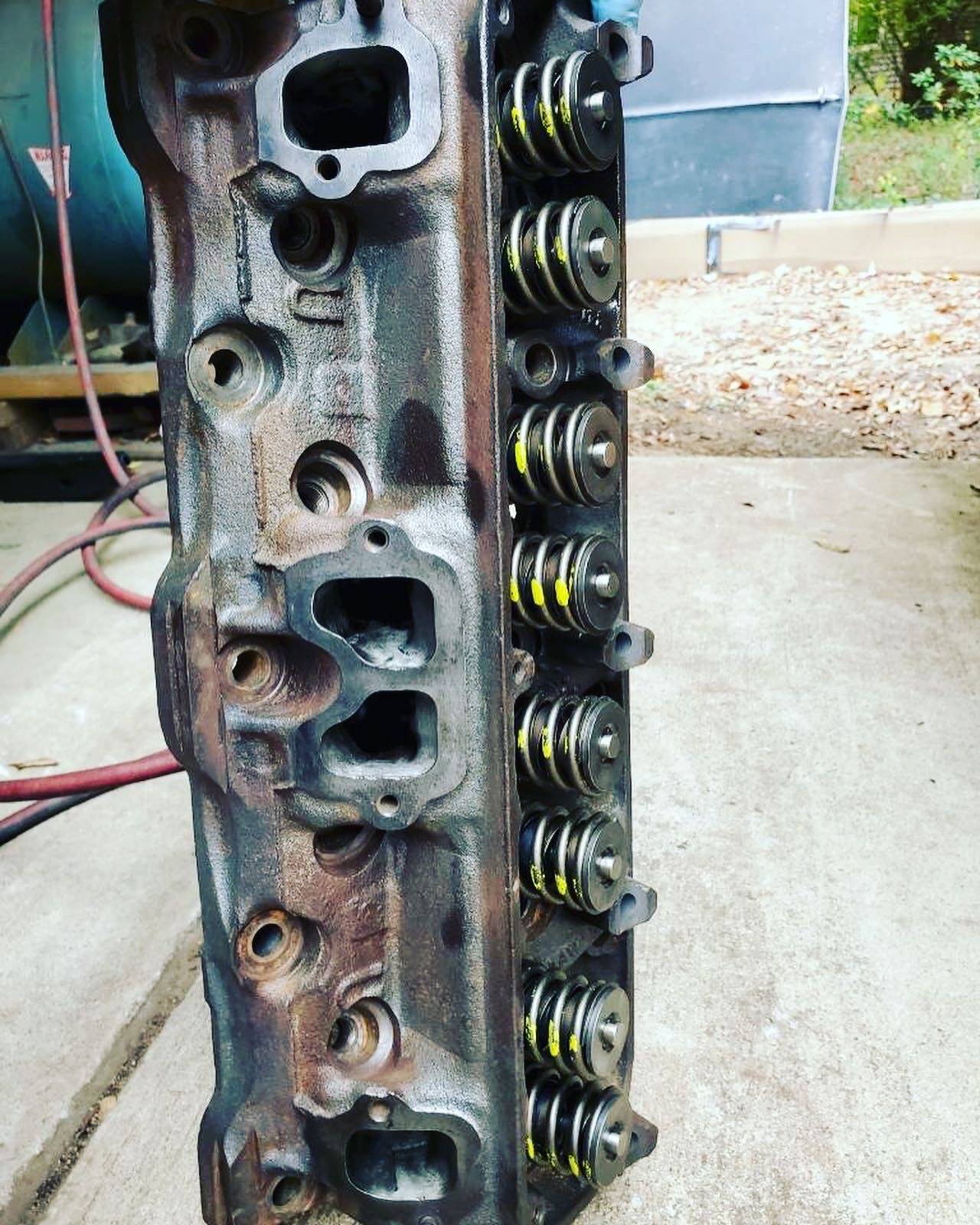

While I'm leaving the oil pan gold ((no one can really see it anyhow)) the rest of the engine is all going to be in silvers. Brand new Doug's ceramic coated headers, newly blasted, ported and bladed Edelbrock RPM Performer Intake, and silver painted water pump and timing chain cover. Eventually I want to cover all the hoses/wires in braided steel looms or just replace with braided steel tubing. The end result I want is a very clean black and bright look that will contrast with the blue of the car.

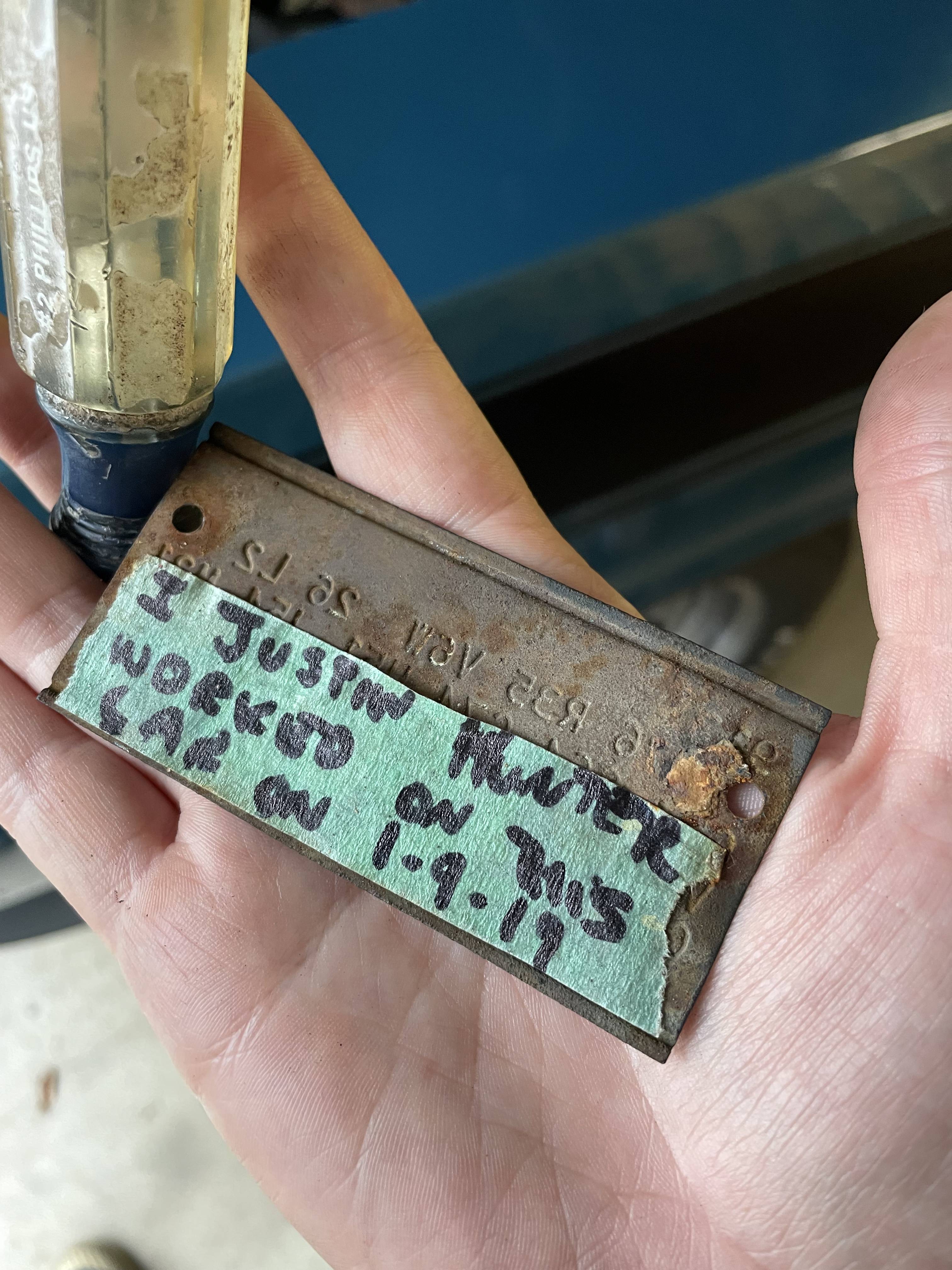

Justin Hunter, if you're reading this:: I need you to explain to me why you connected the windshield washer pump to the smog filter...

Nice pics and story/history. I have one suggestion... the oil pan... desperately needs oil control baffels... the factory non-baffled pan welcomes oil starvation in cornering, acceleration and deceleration. Simple flat steel plates can be welded in front and rear of the sump (a little channeled cut for clearance for the oil pump tube is needed, as well as a small hole for the dip stick). Or else, install the Milodon ProTouring style pan with Milodon pick-up... money well spent. Modifying the factory type pan with internal baffels is the lowest cost best mod for our engines!... and without any hassles with the new headers or k-frame.

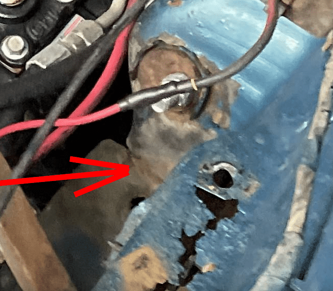

While you're cleaning up, ya' might take a good look at those UCA bracket to frame areas. I know A-bodies are notorious for rot.
It has a new Milodon pan. The pan on the 318 doesn't fit and the 360 was only a block when i got it. And the K-frame was replaced in 2021 with a full QA1 Suspension system.
