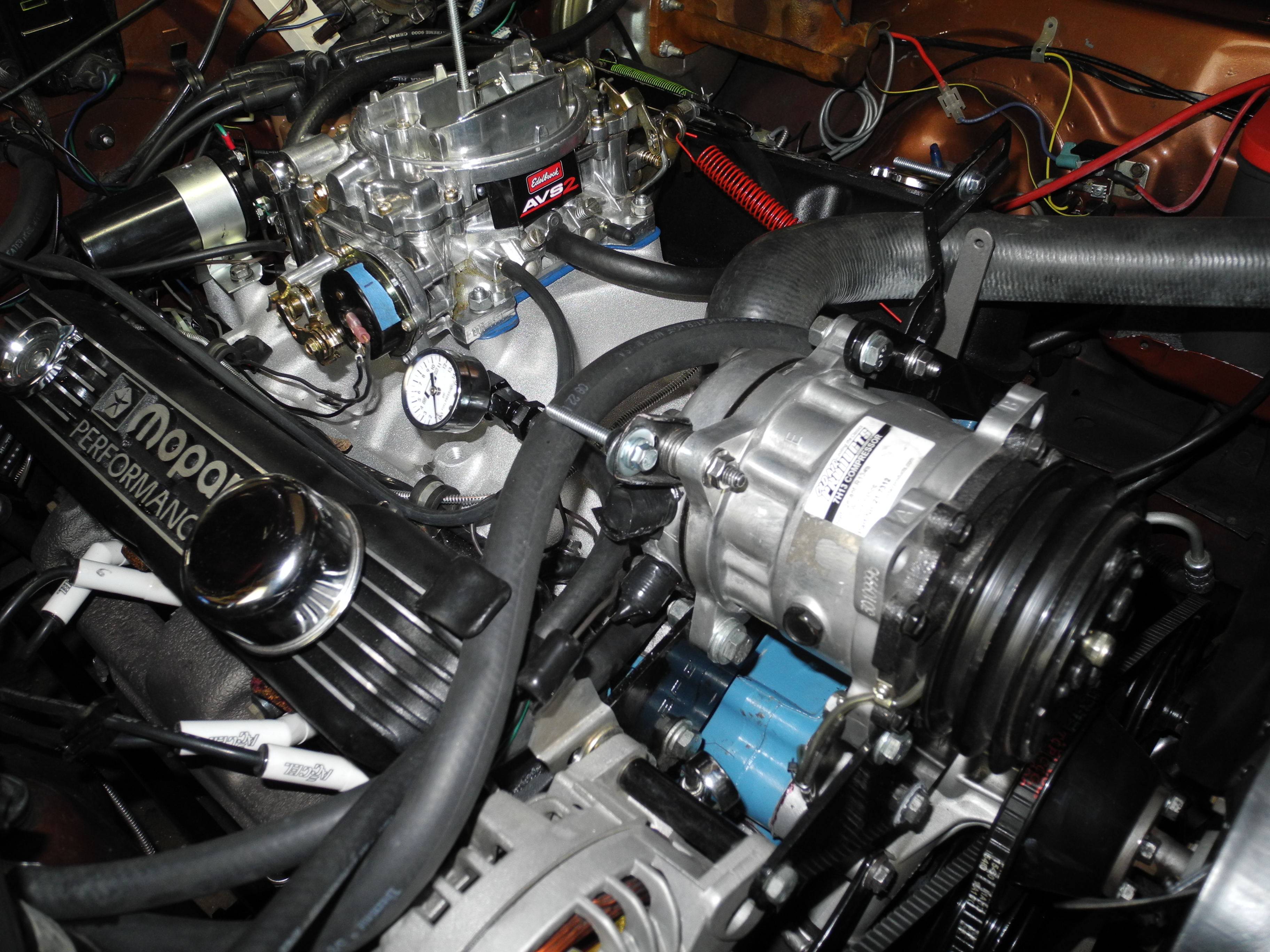

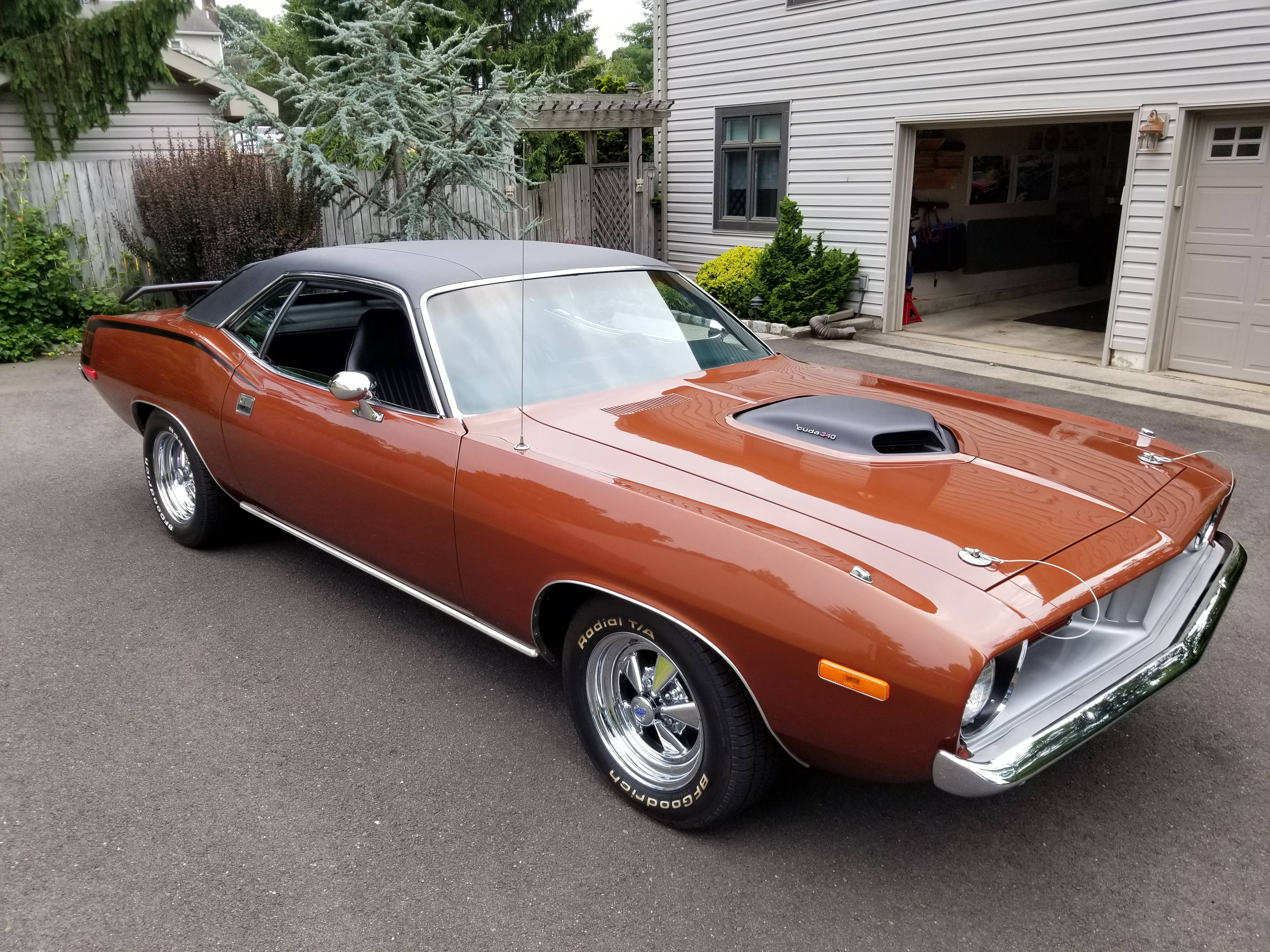

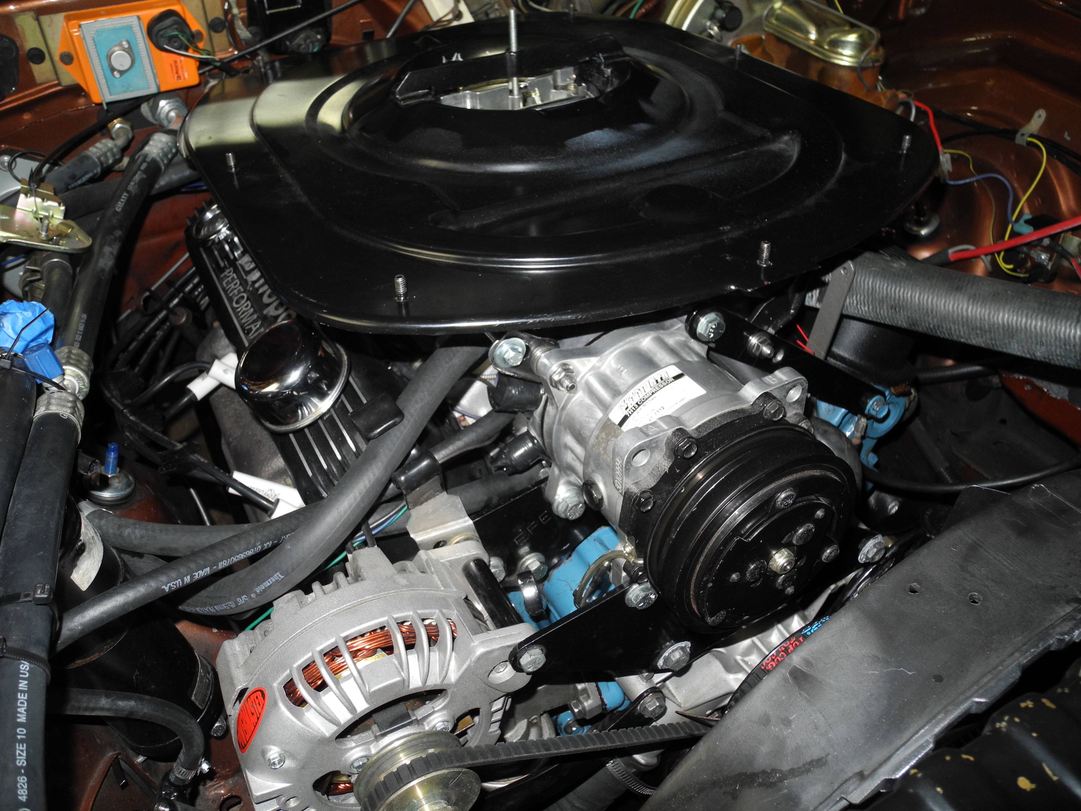

My shaker went on my 73 cuda 340 without an issue, can send you a few photos for your use. Used an sanden compressor like Chryco Psycho said. shaker kit from Ben.
Ralph
Mar 5, 2013
350
71
Here you go !
