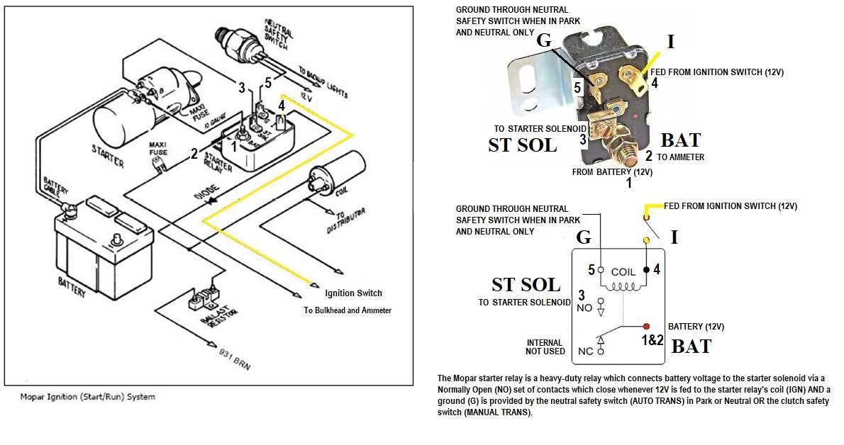

You have a volt gauge or amp gauge? that maters. The amp gauge always has power to it and to the alternator. Check the battery connections first, Fusible link then bulkhead connector also under column connectors. The next time it happens check what is mentioned in that order. Be familiar with all points so you can find it then. You might be correct ign sw going bad.

You have a volt gauge or amp gauge? that maters. The amp gauge always has power to it and to the alternator. Check the battery connections first, Fusible link then bulkhead connector also under column connectors. The next time it happens check what is mentioned in that order. Be familiar with all points so you can find it then. You might be correct ign sw going bad.View attachment 124085

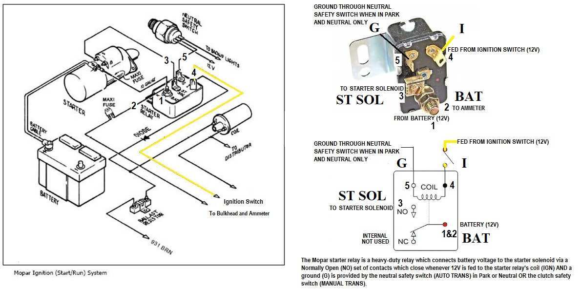

Alternator battery terminal matches battery output with multimeter and all connections and fuseable links are good and sound. There is no chance the neutral safety switch could be bad causing issue? Pretty much have it narrowed down to those two ignition switch or neutral safety switch

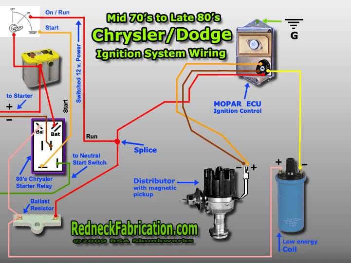

I short. The fuse box is powered up 2 different ways. Battery side is directly from fusible link through bulkhead connector. Batt terminal on fuse box always hot check there when you have the problem. The Acc side of the fuse box will become hot when ing sw is on. There again check. That is if it is wired as original. Also a 3rd power supply when car is running throught splice 1. Not relevant now.
Challenger RTA
Oct 28, 2018
3,969
2,088
PA Flood city
The ign sw can be unplugged at the connector and jumped from the connector. That can be done the there it is low current draw there or from the starter relay.

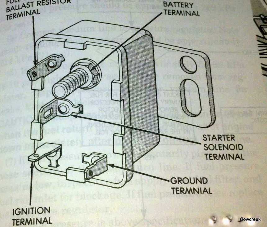

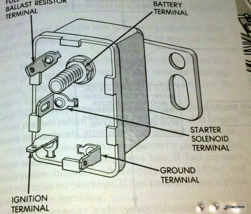

I bet you it is probably the starter relay or neutral saftey switch then, it turns over so something is blocking spark and the relay looks incredibly old worst case i will have a nice new one

The ign sw can be unplugged at the connector and jumped from the connector. That can be done the there it is low current draw there or from the starter relay. View attachment 124087View attachment 124086
@challengerrta your the freaking man!!! It was a stuck starter relay i tapped on the case a few times and it must of freed the contact. On the way to get a new one

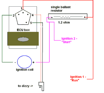

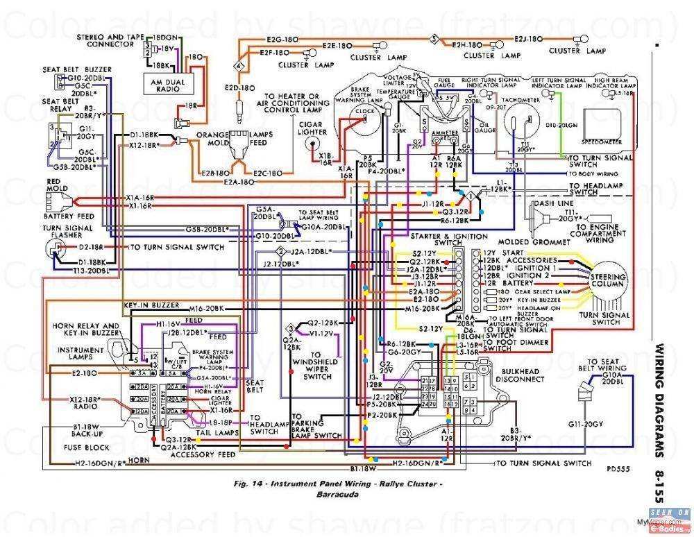

Look at the top diagram for start and run colors. Brown ing 1 start bypasses the resistor when starter is in gauged , dark blue ing 2 run. This is not how you have it wired now. But they have to be jumped. As I said unplug under the column use a jumper from battery red and feed run. Also from red touch to the start. that will by pass the ing sw. Try it a number of time and see if it works. You can use a house light sw if you want feed each one from the red. Leave it wired in and try the next day. Then you will know.

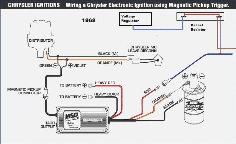

So i found my flickering issue, my wiper motor was hot an making a funky noise, disconnected it from bulk head that solved that, i have power to msd 6a but no spark to coil and tested coil to be good so i think i found my intermittent spark problem.

With the plug under the column is plugged in. Use a test light to check for power. With the key in the run position see if there is power there. dark blue ing 1 start, With the turned to the start position check for power. Brown ing 2 run.

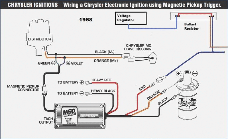

The msd box has 12v but its not sending spark to coil so the box is shot it appears
Challenger RTA
Oct 28, 2018
3,969
2,088
PA Flood city
That's what I was wondering. All I can do is keep shotguning you answers if I don't have the diagram. many of parts have gone by the way because of bad connection.
