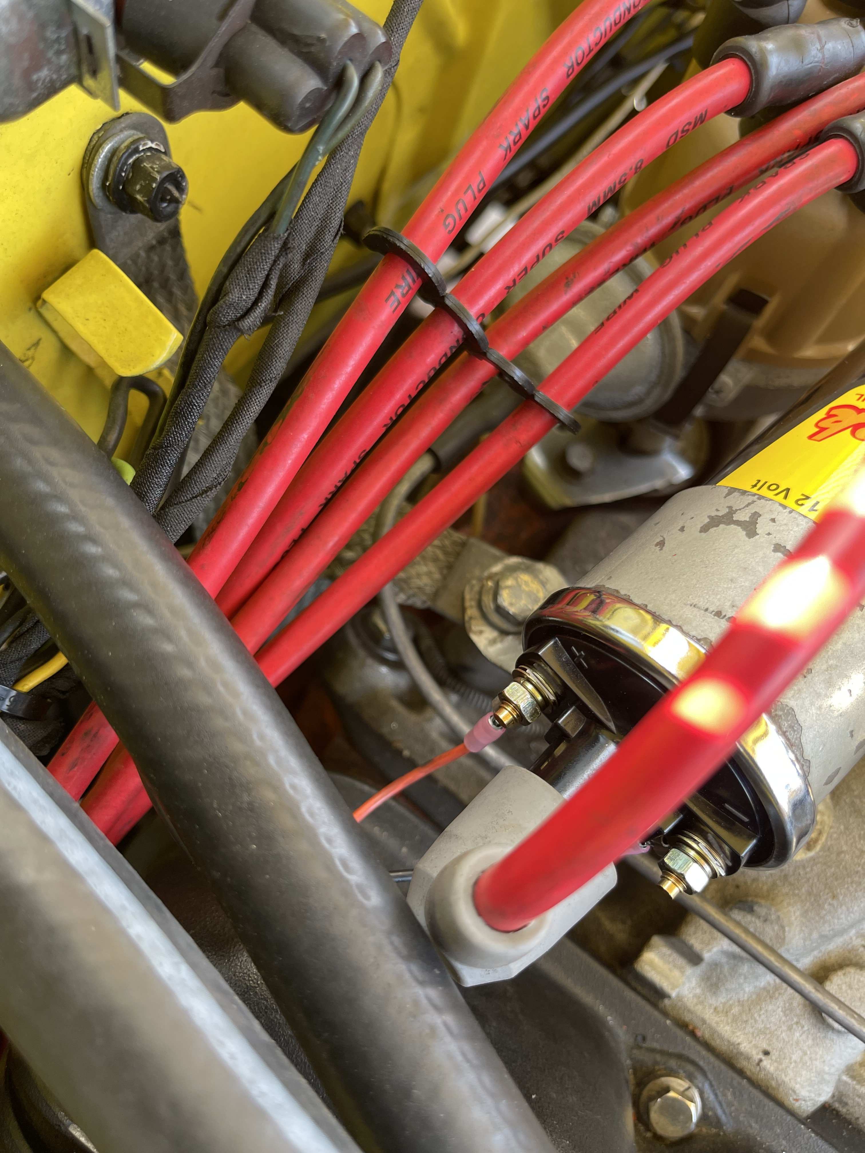

The orange connection to coil thats where my problem is lying it is intermittent to the coil

You read and understand how a coil fires. It fires only when the primary power is turned off and discharges through the secondary windings generating spark. The MSD unit is now controls it through the distributor.
Orange + to coil?

i shoverd a screw driver through coil wire and grounded screw driver and no spark, so i have positive juice to blue and brown for msd to receive the starting power

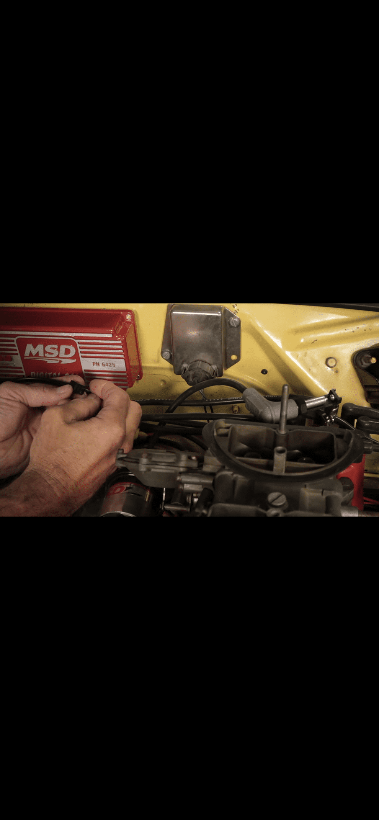

So i did jumper test to see of msd6a box is working and it is sending spark, but when starting either with key or jumping starter relay no spark. It doesnt make any sense why i shouldn't have spark

So i just double confirmed the msd video trouble shoot junper green and violet it had vicious spark to coil, so the ignition system is working properly so i have it completely narrowed down finally,
The coil wire works
The coil works
The msd trouble shoot magnetic pickup jumper worked showing fantastic spark from coil.
so the problem lies with no spark turning over the orange and black wires are not feeding coil when turned over
