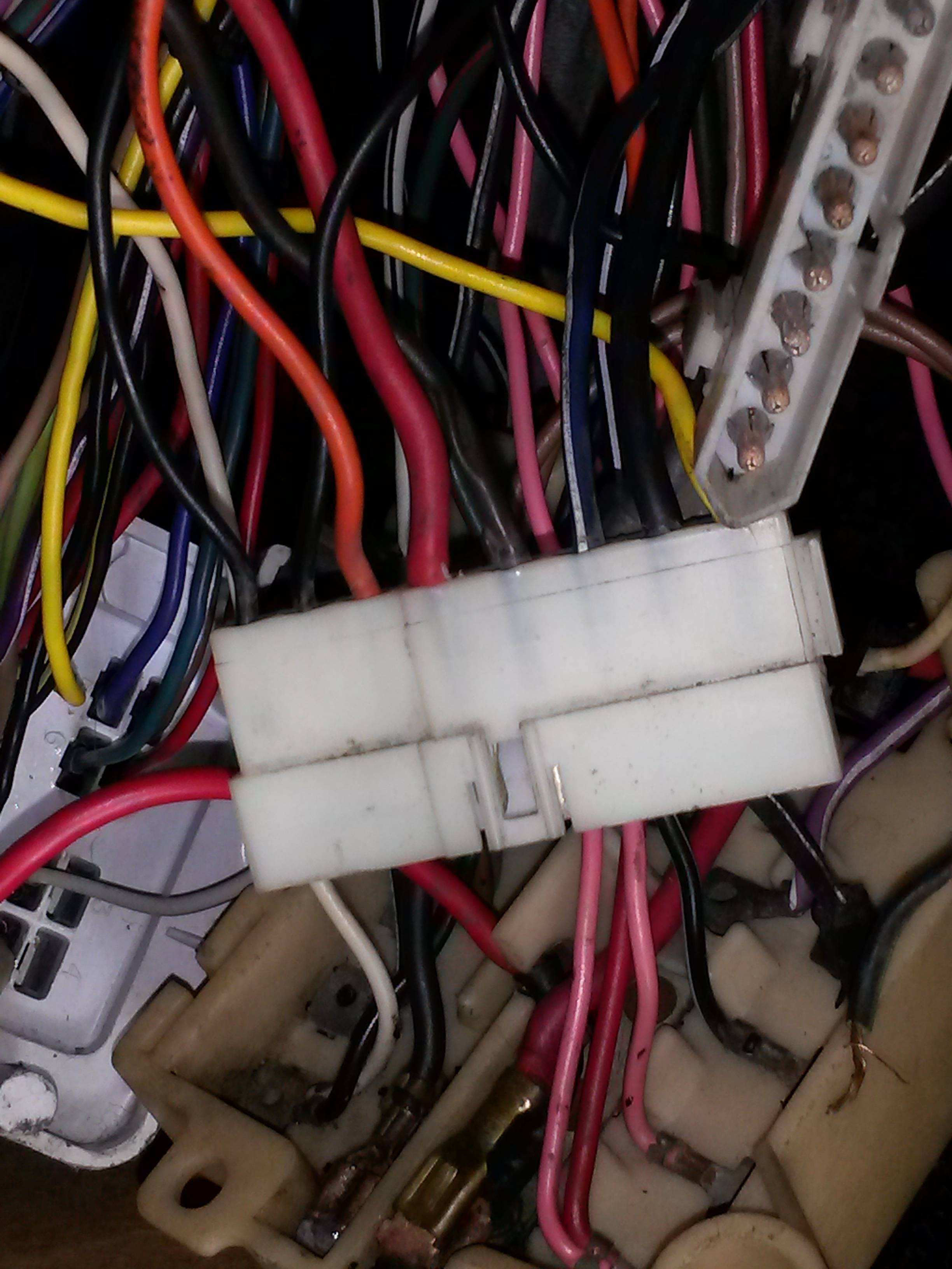

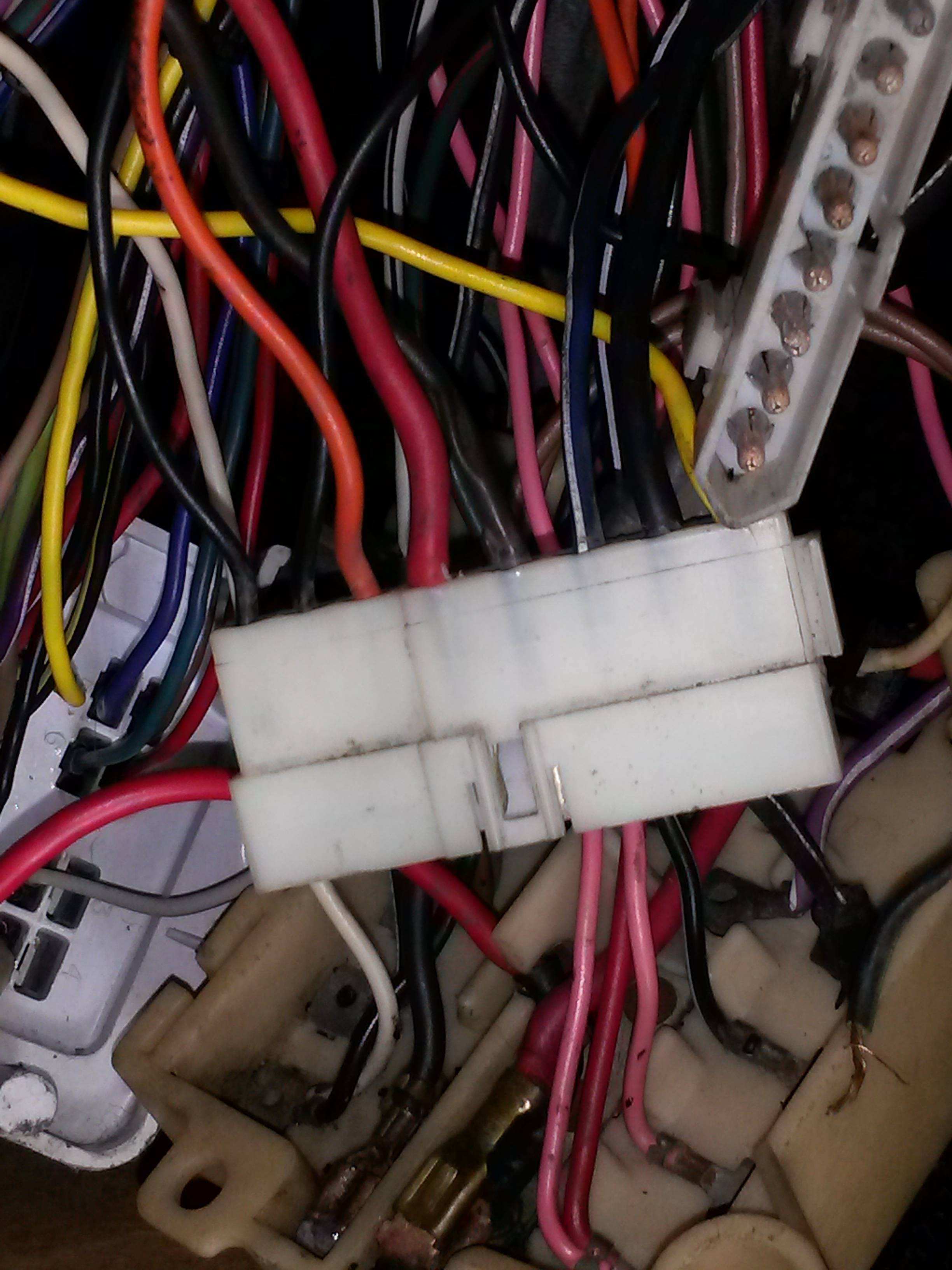

The way I resoled that problem was to use a pointed object. like to point of a test probe and expand the male connector. Then if need be use a small needle nose plyers or screw driver the close up the female connector. Dielectric grease will help reduce corrosion and aid in connecting and disconnecting. The picture that I posted, that's what I did.

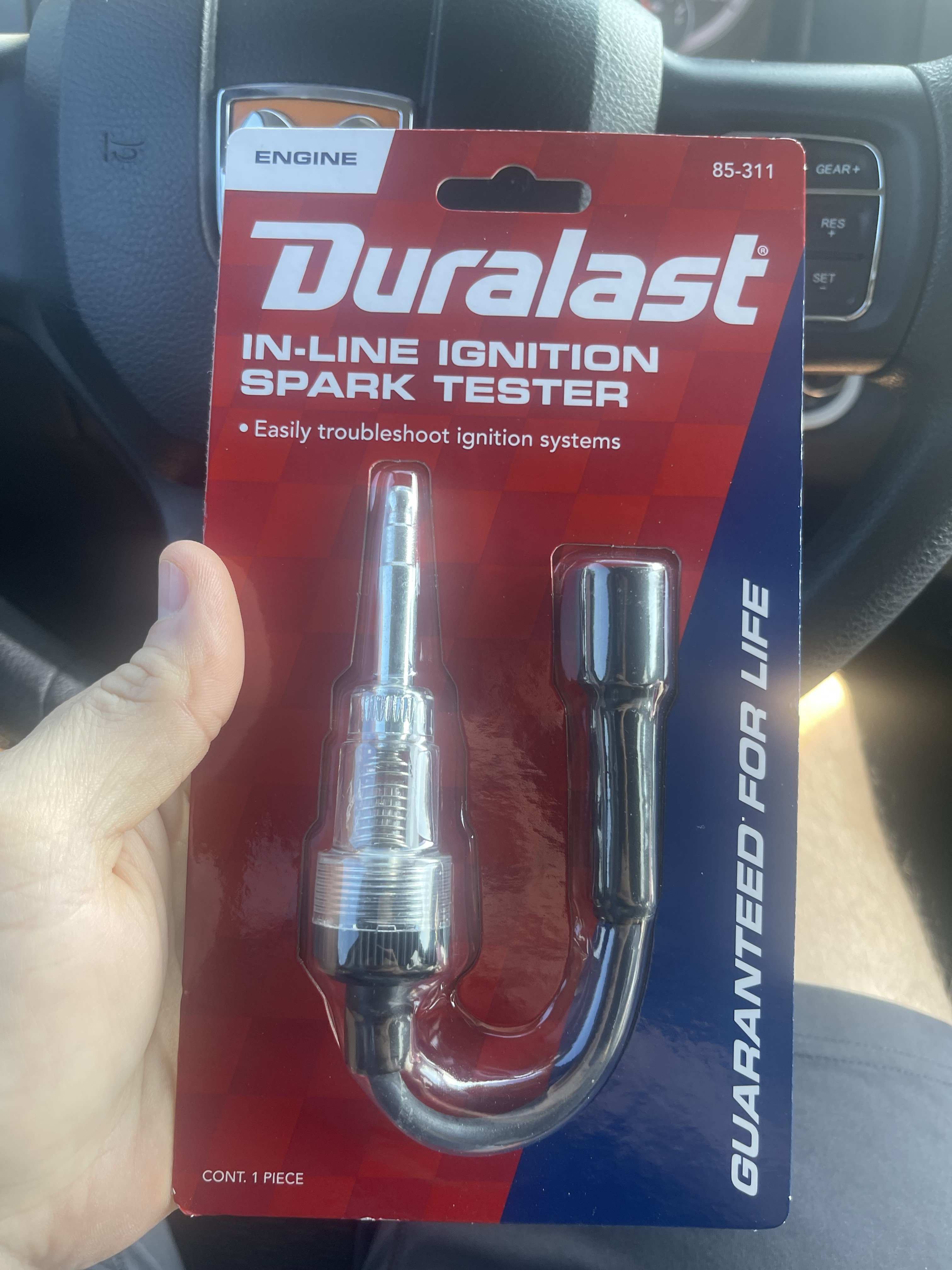

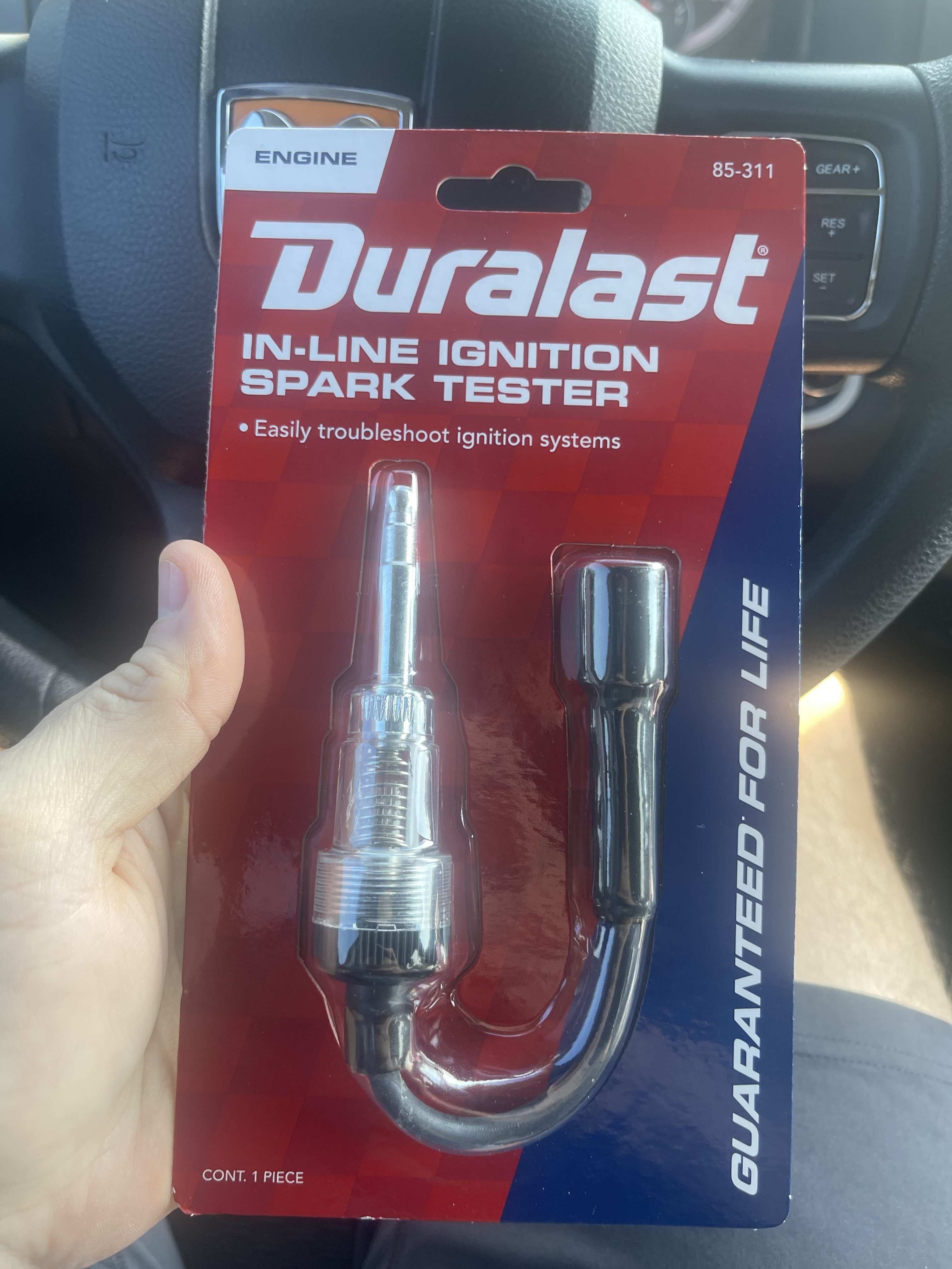

That is a good tool to confirm what you already know. I think it is faulty connections (plural) as Adam has a mentioned.
That why we were both suggesting to start at the connector.
At the beginning it seem to read no power at all or sometimes. More than one bad connection and it could be.
