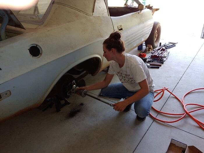

    Yesterday pulling the axle shafts. She's taking the dif in to class to get her teacher to help swap it from 2.76 to 3.23 rear gear and to install limited slip. Can't see it in this picture, but my wife's Subaru is in the next bay getting a transmission swap, so as I said, other car projects take up a lot of time!

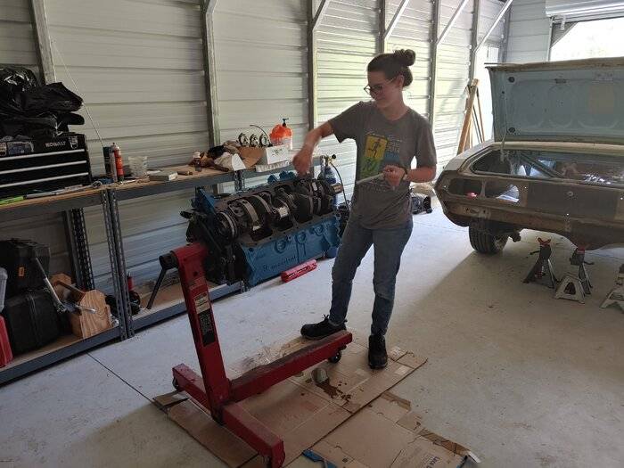

    Worked on tearing the engine down two years ago. Pulling the pistons.
    Also, we found that one of the pistons had not grown up yet!
    On more serious note, we were bit surprised to find flat-top pistons in the '72 360 having been of the understanding that most 360's came stock with dished pistons. I figured at first that perhaps someone had replaced the stock pistons with something like TRW's. When we got the pistons out, we noticed the Chrysler logo and a Mopar part number. A little research and I found that some of the 360's did use flat top. Learned something or maybe I was misled and the flat tops were a lot more common than I thought.
    Check rod bearing clearance during re-assembly:
