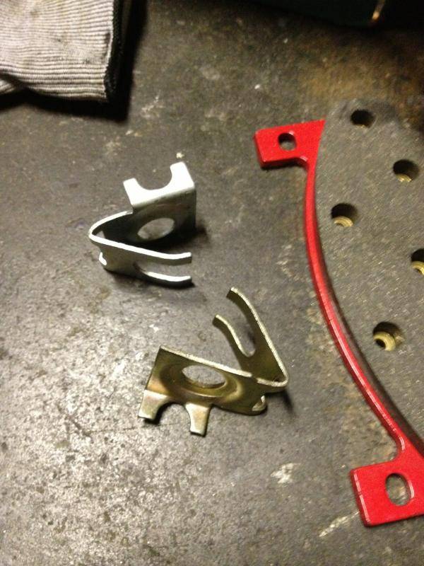

Hi! The disc brake swap is going well, an hour at a time in between work/wife/kid/Ducati distractions... I'll post a complete walkthrough when I'm done.
After a few days of browsing the forum, I'm seeing mixed opinions on whether or not to use these clips. They look like they keep the caliper pins from rubbing against the rubber bushing on the inside of the caliper at the very least, so I'd like to run them, but now I can't seem to find them. Anyone have a source for these or a decent reason NOT to use them?

a fully loaded rebuilt caliper should come with them , Wagner or Raybestos may have them too

They are available from most Auto Parts stores, sold as a brake hardware kit. Don't use any of the so called anti-brake squeek chemicals. Every thing must be CLEAN. The factory never uses any of these liquids,gels or sprays. Make sure to thoroughly clean off any rust or dirt from any areas that make contact. If you must use a lube, make it a dry lube that will not attract dirt or dust. Also use new brake fluid from a sealed container and thoroughly flush out the old, contaminated fluid. Brakes are the most important system on your ride.

Clean and dry... Thanks, will do. There is some kind of rubber preservative (it looks more like dielectric) clear grease on the caliper bushings but I won't be using any of the other anti-squeals unless the pads give me noise, then I might go back in and do a little bit of stop-squeak between the back of the pad & caliper. We'll see how it goes without first though.
The two clips pictured actually came with one of my rebuilt calipers (bought them years ago) and the other one didn't have them. Every parts store I've been to (4 different ones) so far has the spring and bushing kit (typically by Carlson), but no one seems to have these clips. Even YearOne refered me to Steven's Performance (who's still getting back to me).
