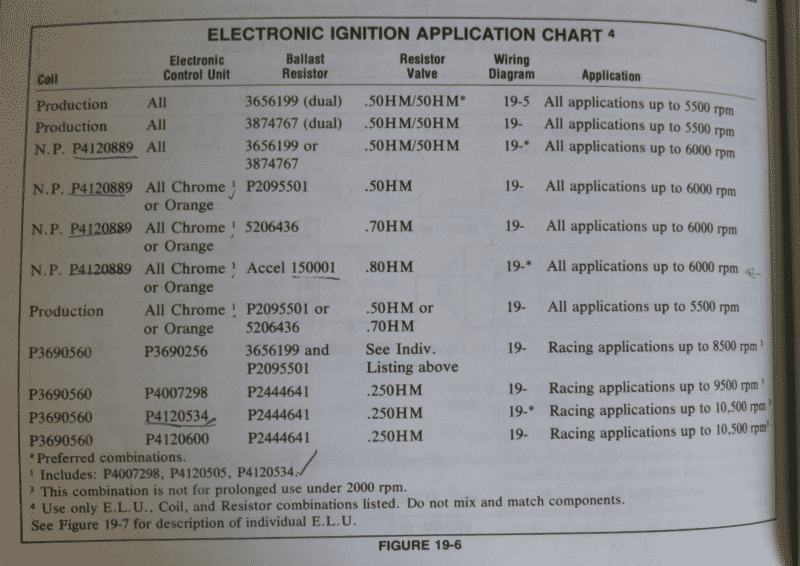

6 Coil getting the correct voltage all the time. Bad connections. Bulkhead connection, wires, switches. Bad coil, correct MSD coil? Temporarily. Put a jumper wire from battery to resistor run wire side only. Blue. Take it for a drive. Try on alt stud too.
