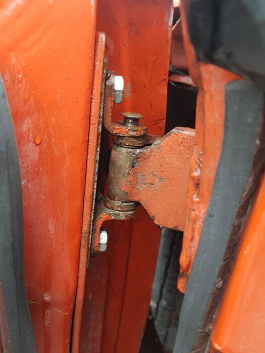

Back in the day I replaced my door hinge pins & bushings. Ever since I replaced my steel doors with fiberglass ones, my driverside upper door hinge pin keeps creeping up. One/close the door a few times and its moved up almost a 1/4 inch. Any tips or real fix for this? I'm starting to think about tack welding the pin down since tapping it down all the time is annoying. There should be no way thats its worn out already as I've never really driven the car lots, less then 5000 miles in 20 years.....kinda sad

Something is not adding up. OK I reread the post and see that you redid your hinges . The upper hinge pin was a press fit. No way to come loose if the hole is not worn ( shouldn't be, they almost never wear on the uppers). The pin would have raised grooves, knurling if you will, that press fit into the pin hole. How about a picture ?

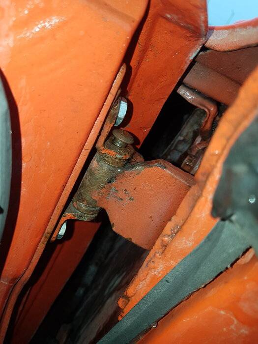

Yes fiberglass doors, pin is not long enough to drill/install cross pin. Heres 2 pictures, let me know if somethings "missing" as i did this 20 years ago as a "green" mopar guy....lol

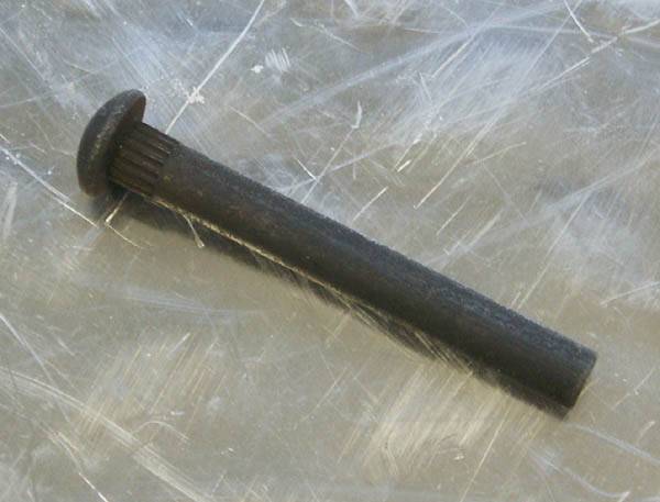

You can clearly see that the knurling is missing from under the pin head.
At the least, just need a new pin. It is a standard GM size, available at most any auto parts store. Just cut it to length and tap it in.
If the pin hole is hogged out, the hole would need to be welded and redrilled, but it would be much simpler to get a replacement (used) hinge part.

Yes, now that i look at it your right. Thankyou, I will fix it right
