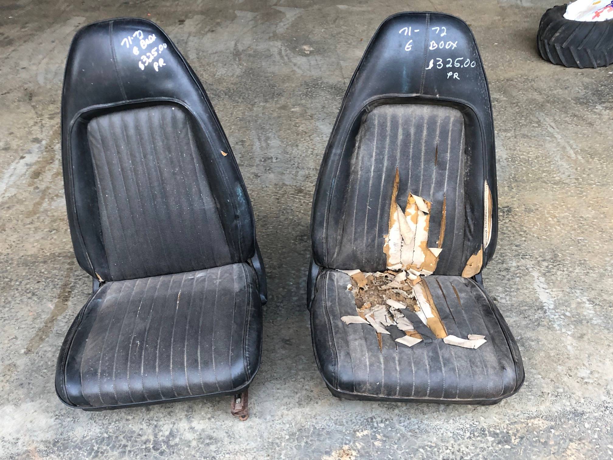

Guys, bought these at a swap meet many years ago for my 73. Seller said they were for 71-72 cars but would fit a 73. Question is, time to order new seat covers, can i order covers for a 73 or do I need to order ones for a 71 or 72. Basic question , are the frames the same for 71,72,and 73s.....thanks.....Can t seem to post photo , must be too large.....

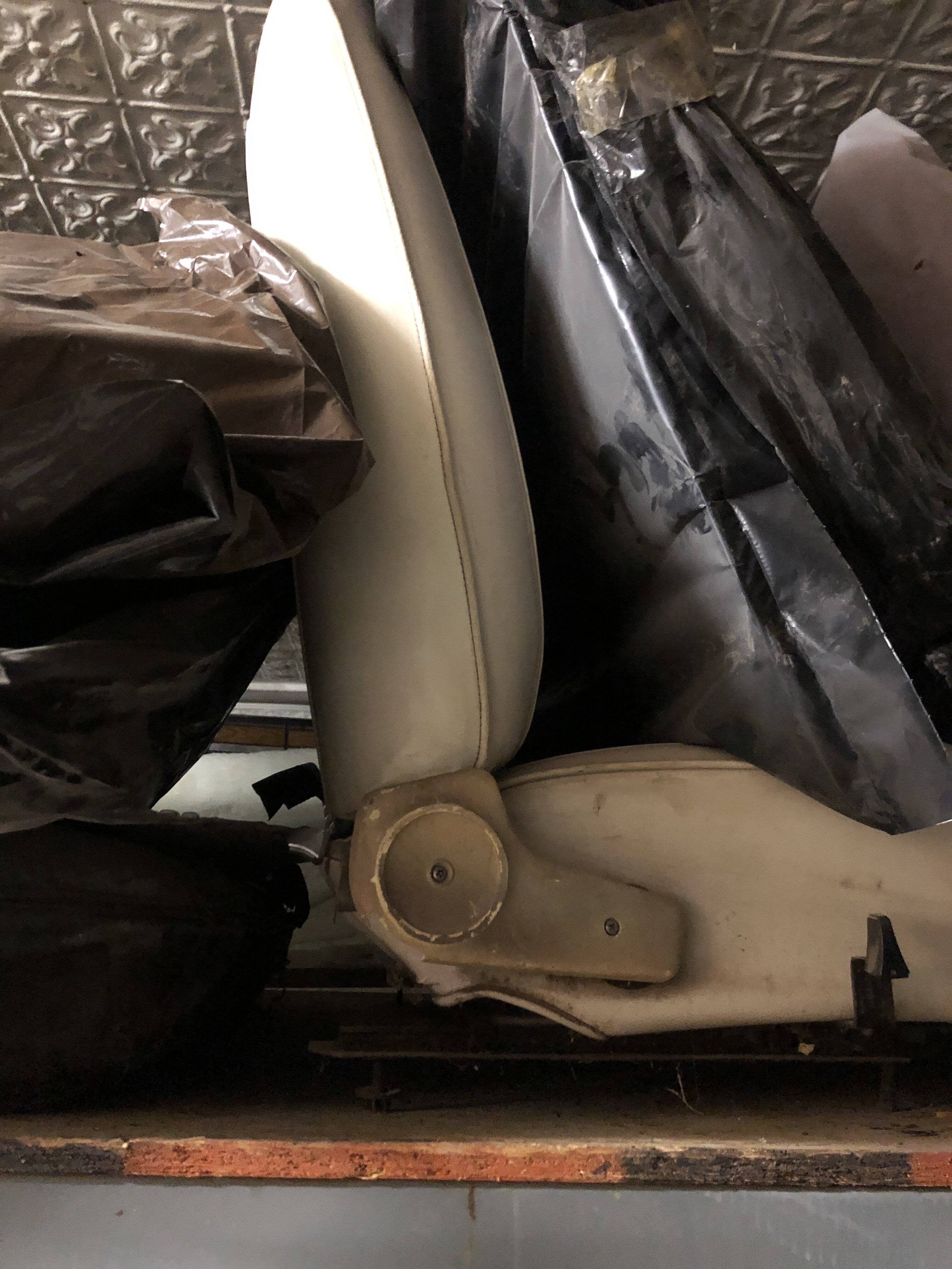

Seats and backs are different in the years with some overlapping. Theses are 70 and early 71.

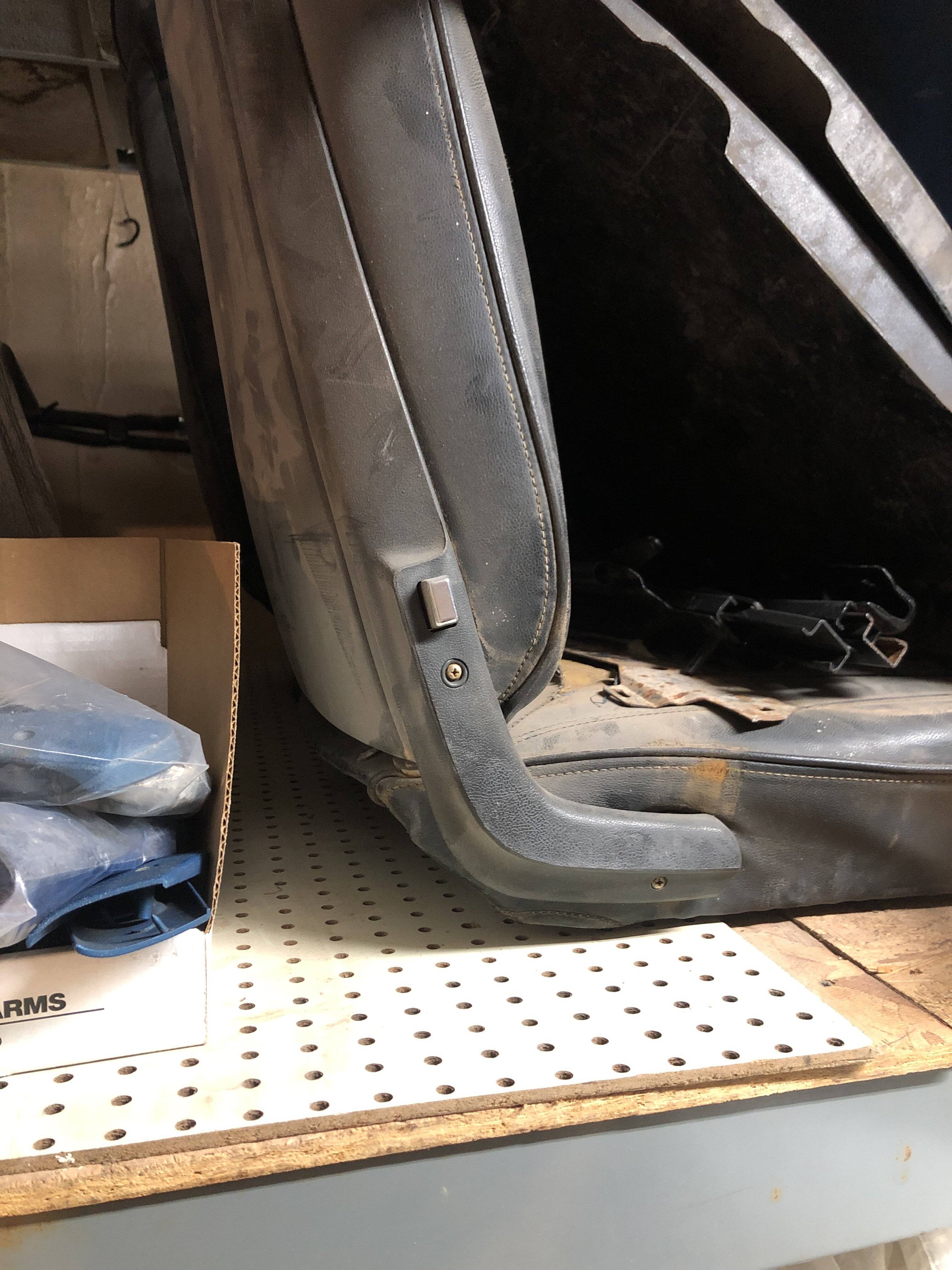

These are 71 with chrome buttons. Notice the back of different than 70. The plastic back goes down to cover the hinge bolts.

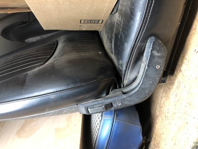

72 looks the same but with a black button and same back.

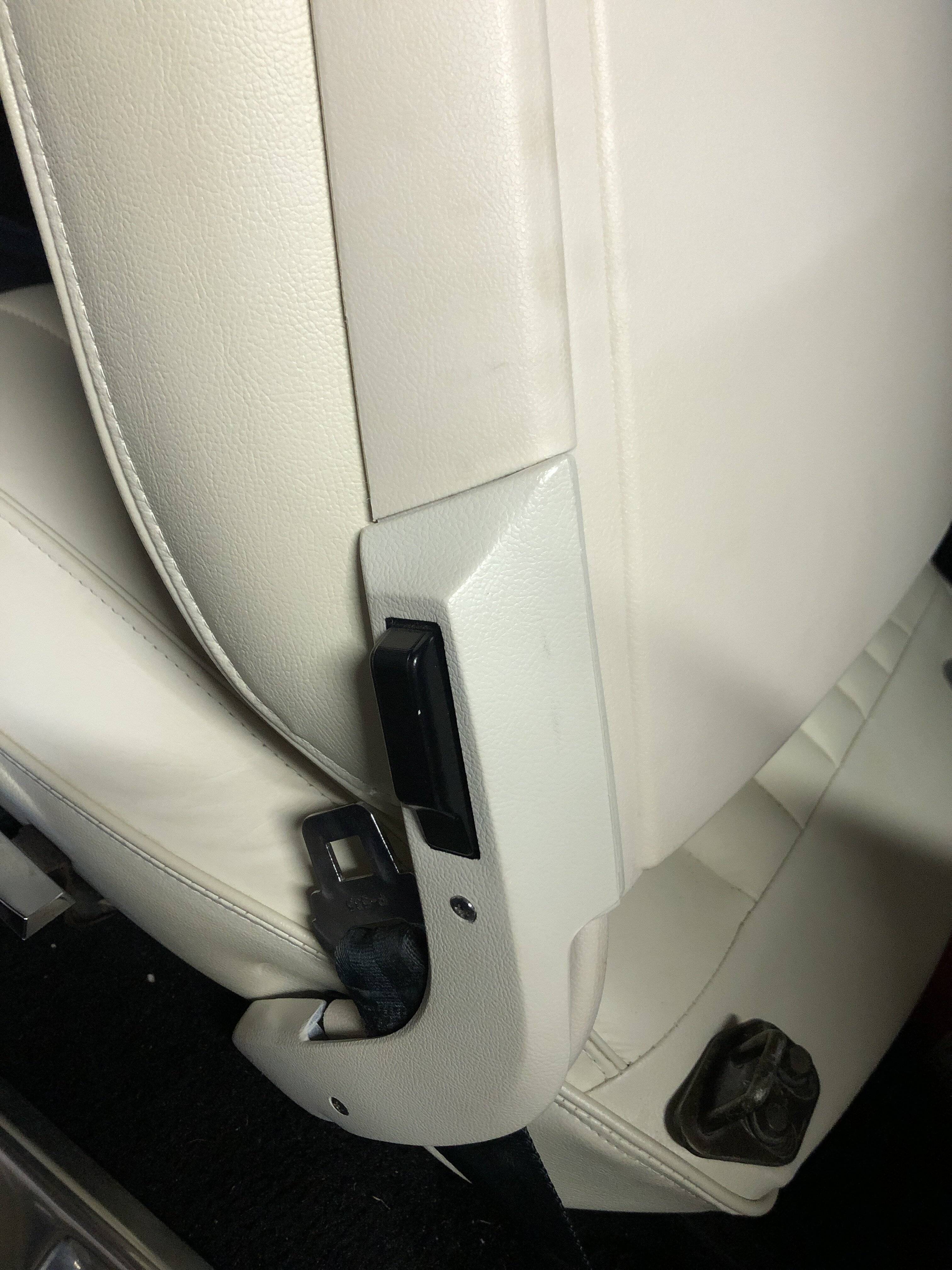

This is 73-74. Notice the back is material and not plastic. These seats are not the same frame as 70-72.
