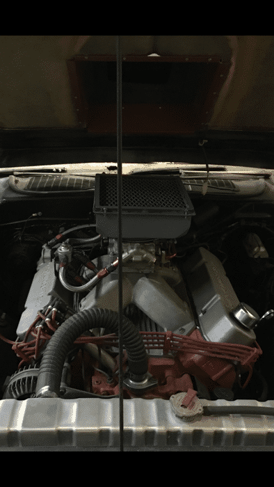

Maybe some kind of offset baseplate would put the filter in the center for you? Would have to cut the hole in the hood bigger though.
we’re you going to put a scoop on it or leave it like it is?
Ted70challenger
May 9, 2020
42
6
A offset filter base is what I did to center the filter in the scope. You can see it in this picture.
Ted70challenger
May 9, 2020
42
6
And if you put the carb/filter in the scoop then you will need solid motor mounts. The engine will move 2-3 inches easy with the stock mounts
