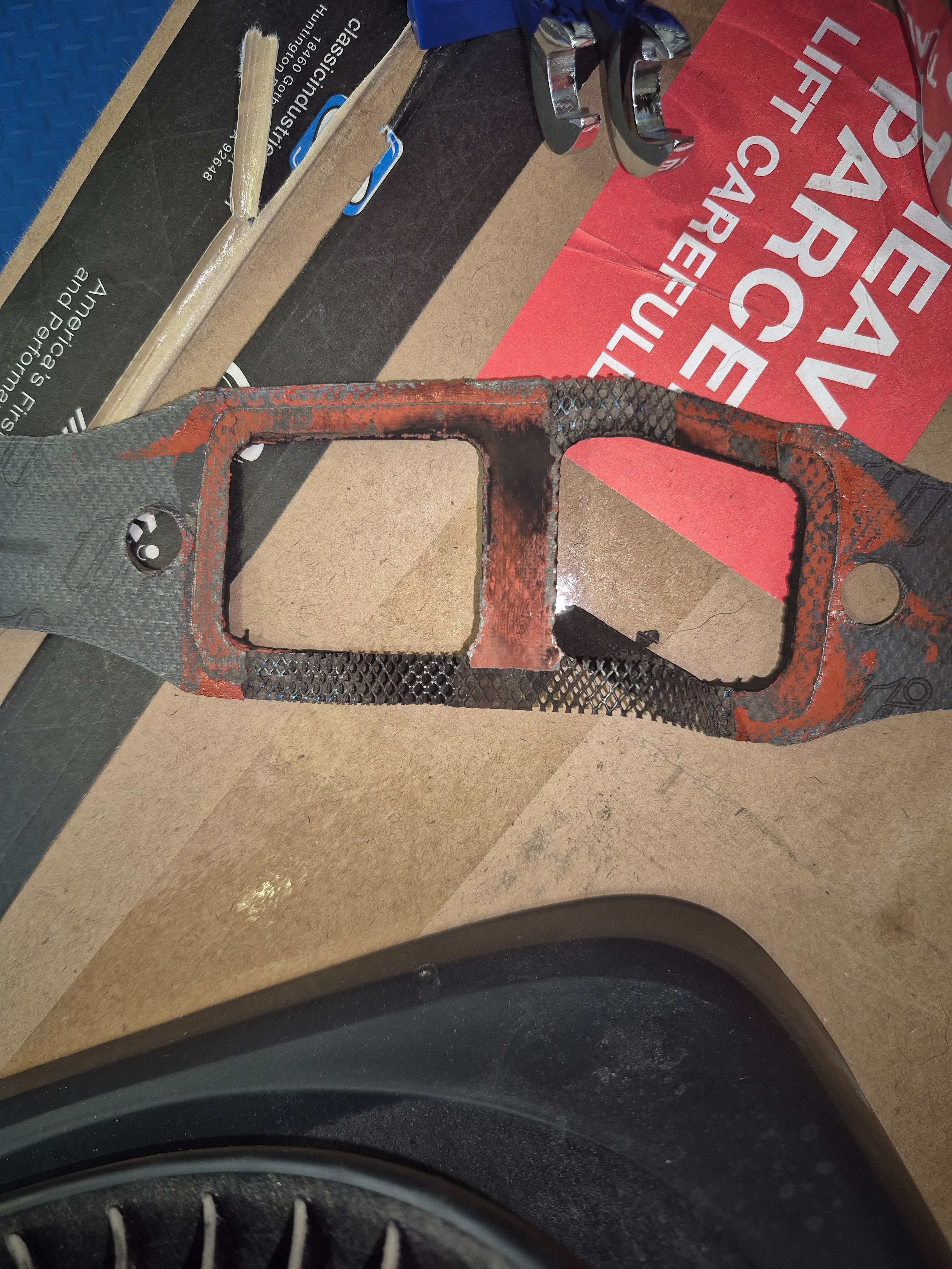

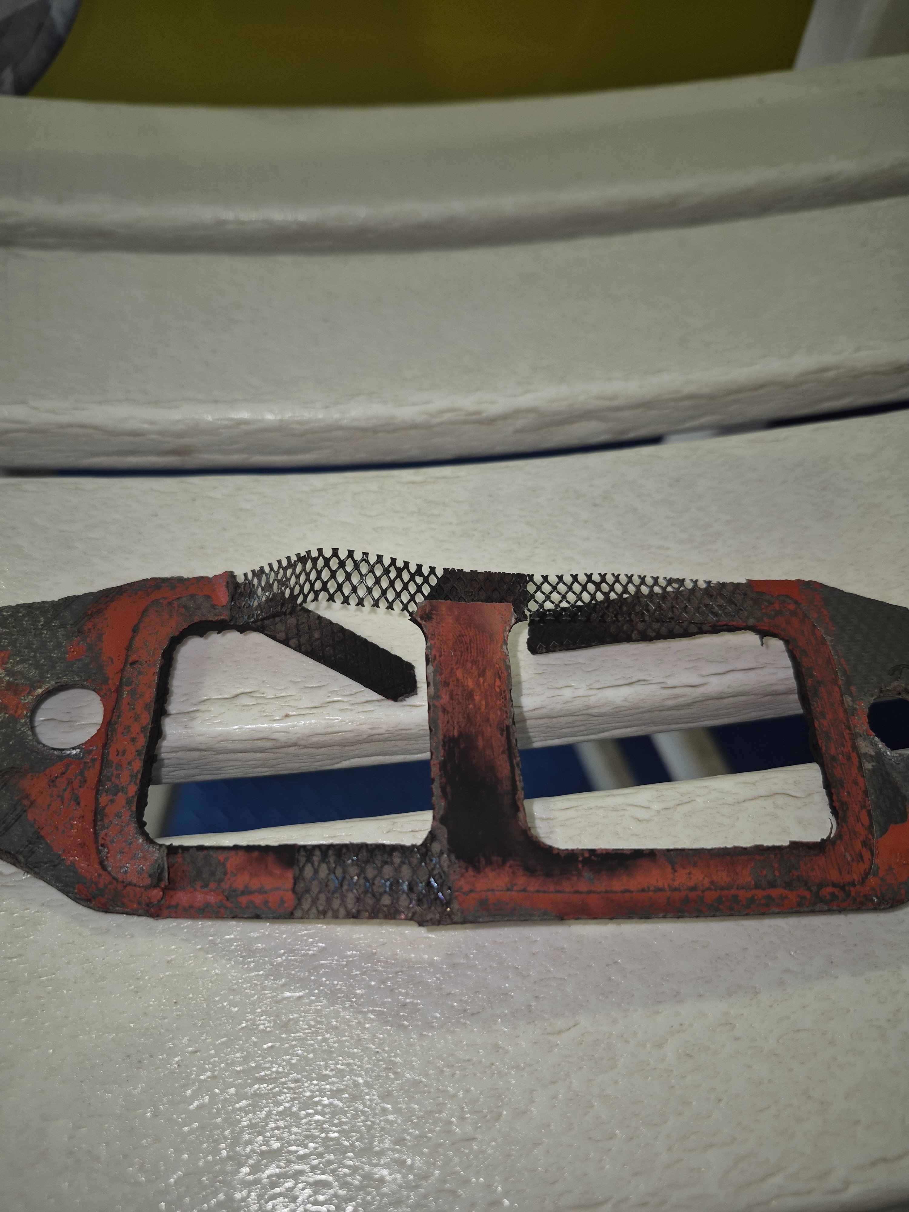

Yesterday at 1:36 PM #1 7DCUDA383A Well-Known Member Joined Sep 11, 2024 Messages 283 Reaction score 72 Location 60 Miles West of STL I think this was the issue , TTI gaskets about 5 months old , maybe it was me putting them on , I don't know , I still need to do the passenger tomorrow , this is driver side only , I replaced with Remflex gaskets .
Yesterday at 4:34 PM #2 pschlosser Well-Known Member Joined Dec 8, 2022 Messages 1,537 Reaction score 840 Location Santa Rosa, California yes, this looks like your smoking gun.
Yesterday at 7:13 PM #3 heminut Well-Known Member Joined Dec 28, 2008 Messages 1,046 Reaction score 966 Location Deming, New Mexico Yup, definitely an exhaust leak!
Yesterday at 8:27 PM #4 Xcudame Well-Known Member Joined May 27, 2023 Messages 3,105 Reaction score 2,405 Location Southeast Arizona Here's hoping the Remflex gaskets work out better! Much cheaper and less pain replacing exhaust gaskets than a camshaft and lifters!
