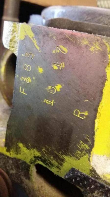

Jun 3, 2015 #1 C CUDA71383 Active Member Joined May 27, 2015 Messages 30 Reaction score 1 Can some one help decode this engine stamp? Last edited: Jun 3, 2015
Jun 3, 2015 #2 C CUDA71383 Active Member Joined May 27, 2015 Messages 30 Reaction score 1 not sure what the r means?
Jun 3, 2015 #3 challenger6pak Well-Known Member Joined Feb 27, 2011 Messages 4,038 Reaction score 898 October 17 (E) 1970 383. It would be built for the 71 auto production. Is it the original engine to your car?

Jun 3, 2015 #4 challenger6pak Well-Known Member Joined Feb 27, 2011 Messages 4,038 Reaction score 898 IIRC R meant regular fuel, as in non high test. Last edited: Jun 3, 2015
Jun 3, 2015 #5 C CUDA71383 Active Member Joined May 27, 2015 Messages 30 Reaction score 1 no a guy gave it too me so im going to put it in my 71 auto cuda he also gave me a seized 67 440 that I don't need its seized due to being in the back yard for years
