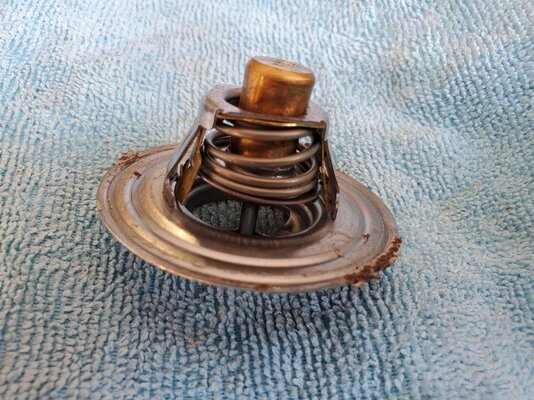

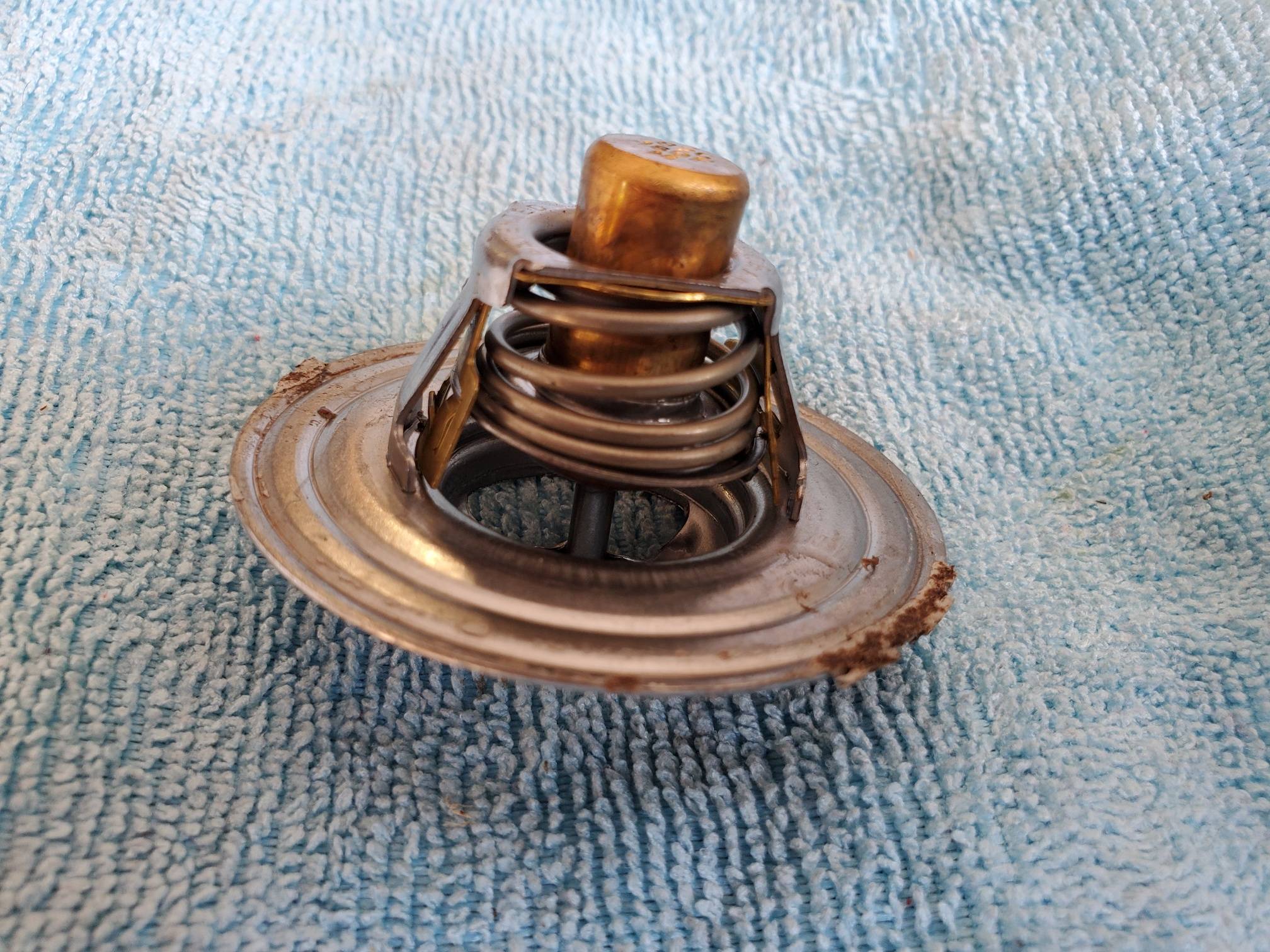

I would pull thermostat and test in hot water. I might be open when cold. you want no gap at all. no day light at all.
You were right. The thermostat is stuck open. Here is a picture. Do you think I should stick with a 180 or go to a 190? Thanks

Just pulled the thermostat. It was stuck opened. Thanks

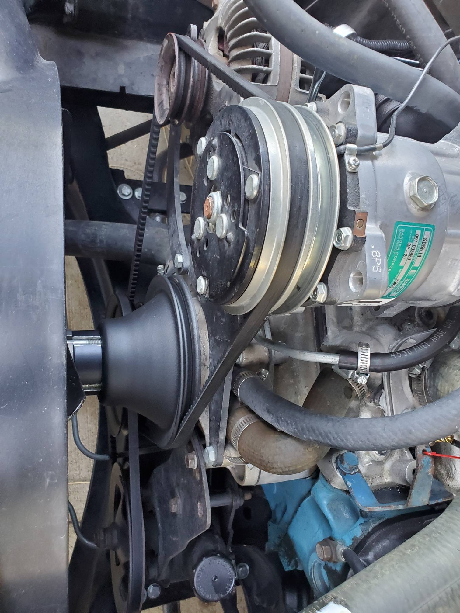

I live in So. Calif. The temps are running in the high 90/100 degree range. I was driving on the freeway and noticed the temps were getting close to 250 degrees (AutoMeter gauge). I had to turn the heater on to cool the engine down to 190 degrees. I just had the radiator rodded out, new 180 thermostat, fan clutch is new, checked the timing, factory style fan shroud, and have fresh 50/50 mix of antifreeze. When I bought the 360 engine, I had it rebuilt. I didn't have the water pump pulley so I bought one on Ebay. The problem with this pulley was the belt hit the water pump housing, which I ground down. I ended up replacing both the water pump and crank pulleys because of alignment problems with the power steering pump. I purchased these pulleys from Vintage Air. They are supposed to be factory correct. The new water pump pulley is larger than my Ebay pulley, could this be the problem? The water pump belt drives the water pump, the A/C, and the alternator. Or, is the ambient air just too hot? Thanks.
What's your ignition advance for full mechanical (wide open throttle) and full mechanical + vacuum (at cruise)? A "late" burn will not produce power, just heat. Degreed timing tape on the balancer will help you diagnose. I run 35 degrees at WOT and 50 degrees total at cruise. You may just have a broken vacuum advance.
