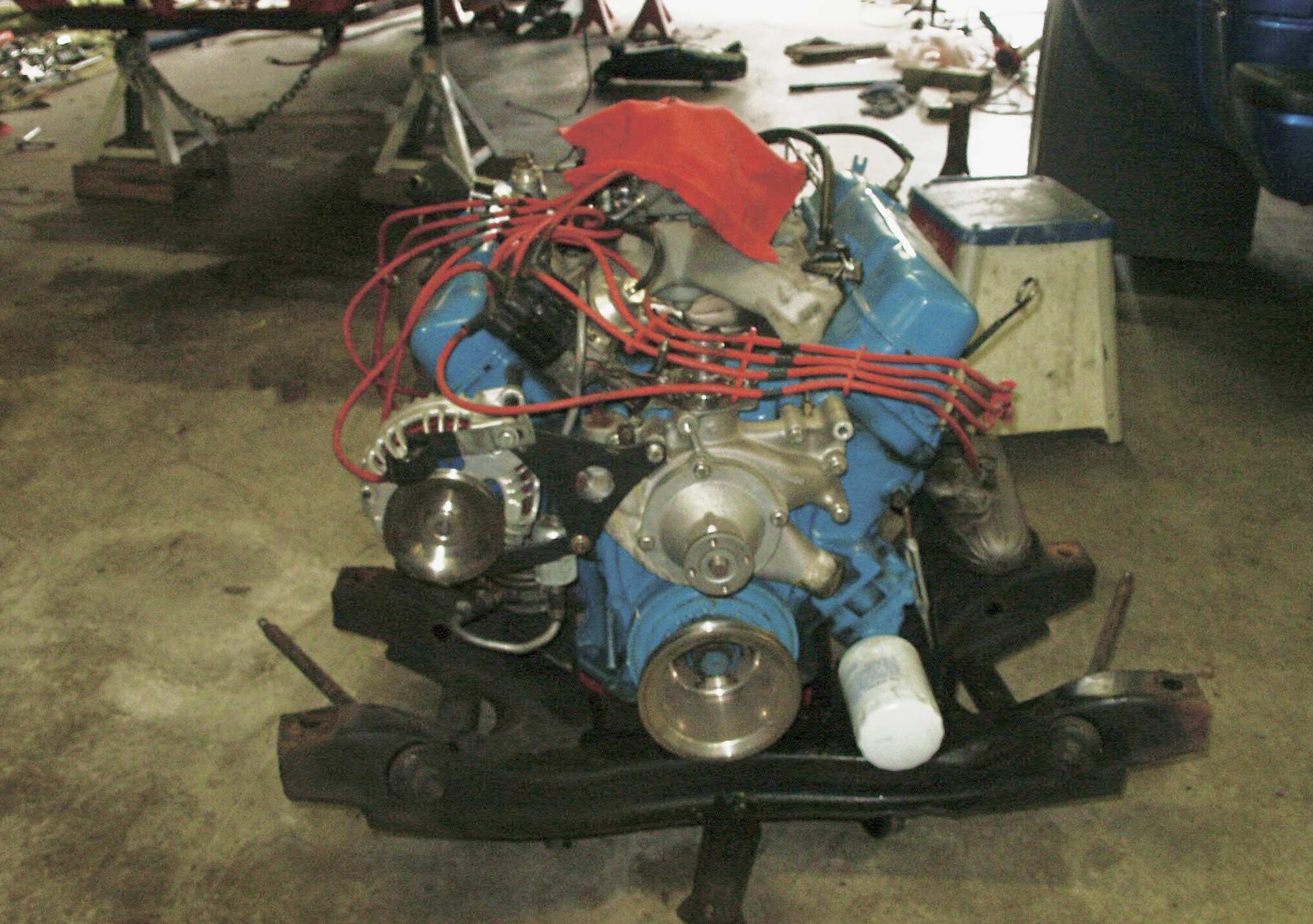

Well....from the bottom it shall be! Picked up my short block yesterday and the machine shop owner (e-body guru) says its way easier from underneath. He also said installing the cam bearings are worse than installing headers, glad he did that and not me! Thanks everybody for the headsup on dropping the k member.
Will take me a week or two to get rolling ( job gets in the way). Hopefully fire this thing up in December.
440, stock crank, icon pistons 10.5, TFS 270 heads, TFS intake, Davinci carb, Hedman headers, Lunati cam, Howards rollers, Harland sharps etc....all the usual suspects!
Challenger RTA
Oct 28, 2018
2,668
1,338
PA Flood city
A good while back when I was working on mine I was going to install from underneath. By happenstance I had it up like this, maybe not quite as high. One day my son just happened to show up and it happened. Motor and transmission bolted together. lifted with engine lift at about a 45 degree angle tail shaft down. picked up tail shaft to clear core support lowered down shaft into engine bay rolled back in place. Placed floor jack under tail shaft. I lowered engine while he raised tail shaft. went pretty good. Hood was off.
I had some junk in the trunk so it wouldn't teeter.
