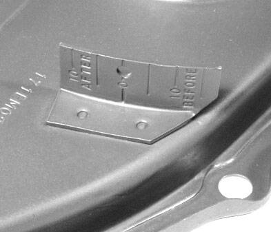

As you bring the engine to TDC you should be able to see marks on the timing cover. Line up the balancer mark with 10 before (add a little for 12 degrees). Insure your dist rotor is pointing at #1... confirm wiring order & direction of rotation, counter clockwise. With the engine sitting in this position hook up a timing light to the battery and #1 plug wire. Turn the ignition to the run position, but dont start/crank the engine. Slowly turn the distributor, back then forward, while holding the trigger on the timing light; when it fires you are good to go. Tighten the dist and attempt to start, then check timing while running. You can/should install a timing tape on the balancer so you can set the timing at 36 degrees total advance at 2400 rpm or so... or use a timing light with a degree dial.

Adam, you're a genius (at least to me). It never occurred to me to use the timing light like this. Brilliant. Perfect. I did try to put a timing tape on my chrome balancer. It was a disaster. I couldn't line the tape up with the TDC mark because of "crap" in the way and it wouldn't stick to the chrome. Eventually I ended up saying many bad words and the tape was in a useless crumpled heap. I know, try again.
