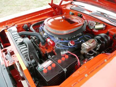

Took the Challenger out today for a brief trial run and it ran great. No further problems with the radiator fan. OMG, thanks to everyone that helped. D :)
I've been following along and am relieved to hear this as well. Now how about some pics???

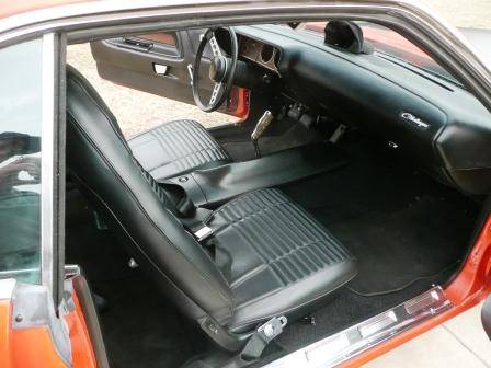

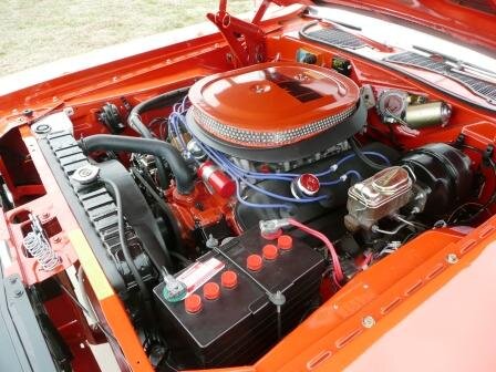

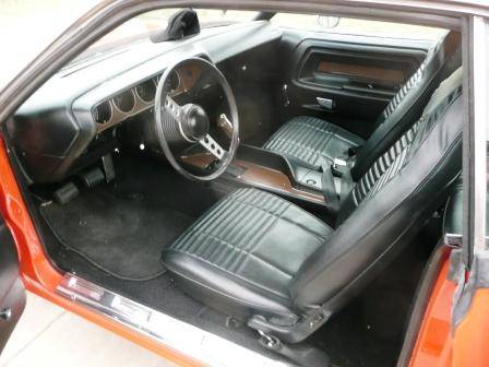

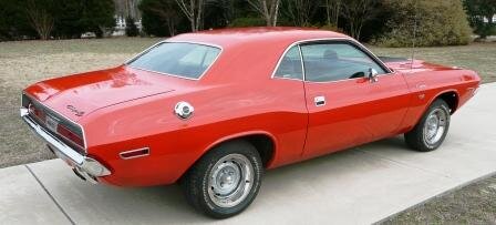

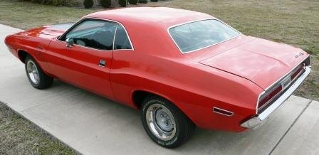

Photos of the 1970 Challenger R/T
ChallengerInsPhotos-11.jpgChallengerInsPhotos-9.jpgChallengerInsPhotos-7.jpgChallengerInsPhotos-5.jpgChallengerInsPhotos-4.jpg
Damn nice looking Challenger! I suppose I could go back in the thread but is this an original Hemi car?
No. Clone. Originally a light blue 6 cylinder auto column car.
You know there's probably fewer /6 Challegers around today than Hemi powered ones? Lol!
I have a three spoke steering wheel for the car. However, I'm 6'4" tall and 225 lbs and I had to be a contortionist to get in the car with that wheel. The steering wheel you see is an option for the car and works slightly better for me. :)
Very nice car Dave the only thing I would change is the steering wheel I'd put the standard padded 3 spoke wood rim or a rimblow on it.
Funny you should mention that. I have another project Challenger. It is a 1973 that came with a 6 cyl. If I had the original engine I would strongly consider an all original restoration. I'm still thinking about it but in the absence of the original engine I'm thinking T/A. :)
