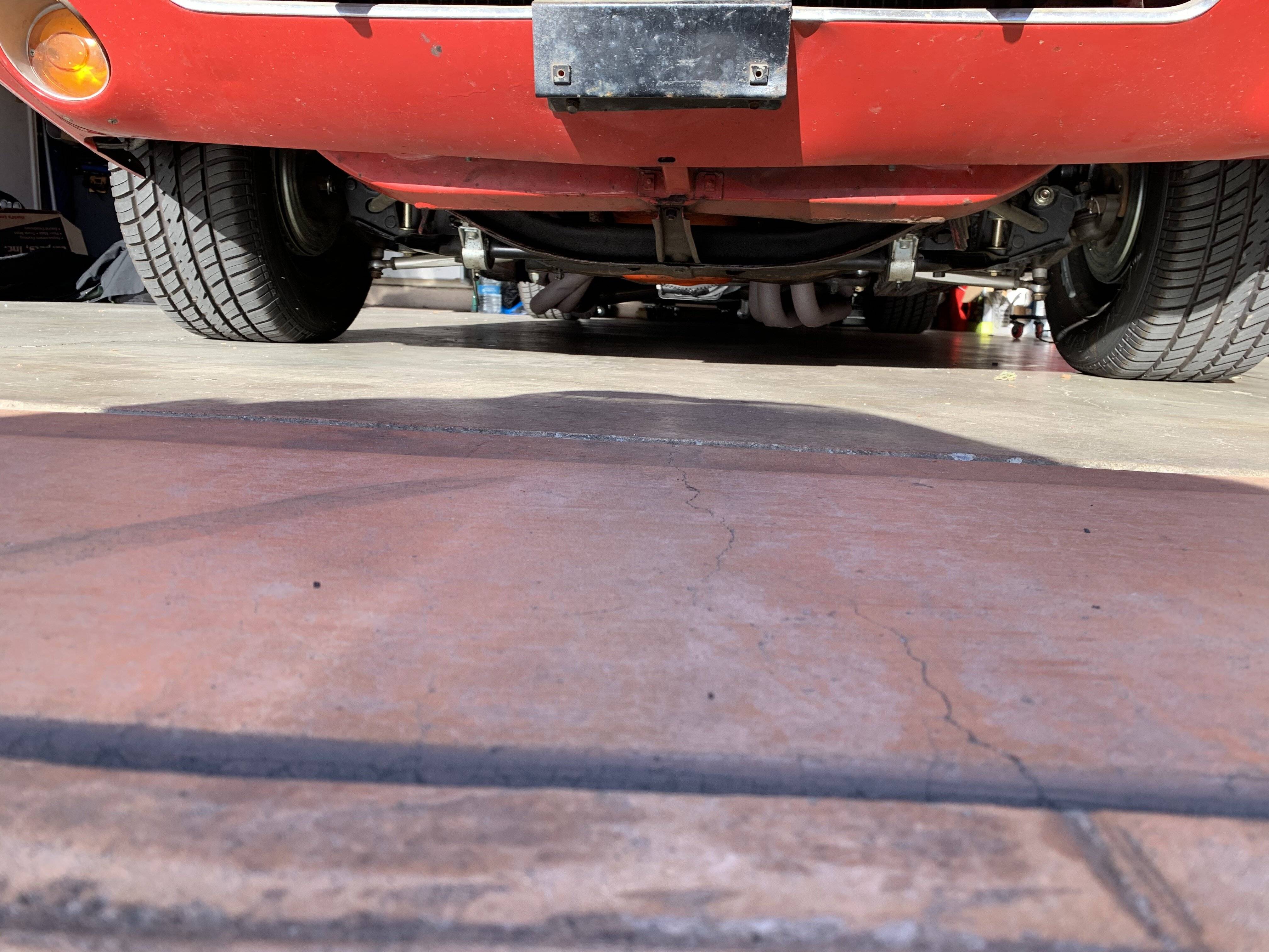

My 70 Challenger has a 360 crate engine with apparent BB headers and H pipe exhaust (unknown brands). As you can see the ground clearance is terrible which wasn't helped by the Hotchkis TVS front and rear kit that I installed. I have also converted it from a 727 tranny to SST's 5 Speed Tremec. I am planning on getting the TTI 1-5/8 x 1-3/4 small block headers #340BE because it sounds like they will fit w/ full starter and no other issues (fingers crossed).
Because by now I've learned that something always seems to come up, I'm reaching out to see what issues you recommend I anticipate or what else I should consider doing while they are out. Also, should the new headers fit and line up with the H pipe? thanks for any feed back.

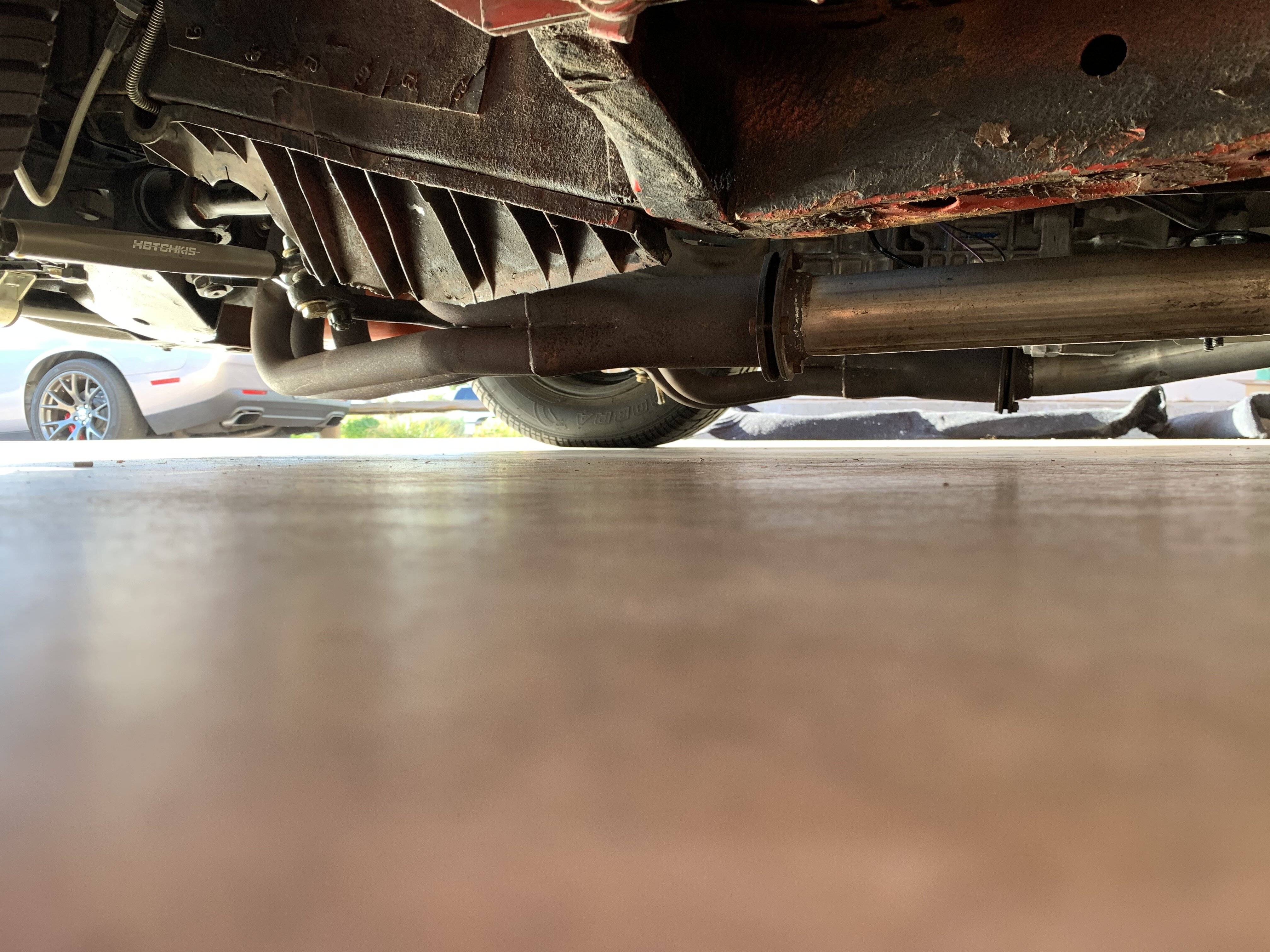

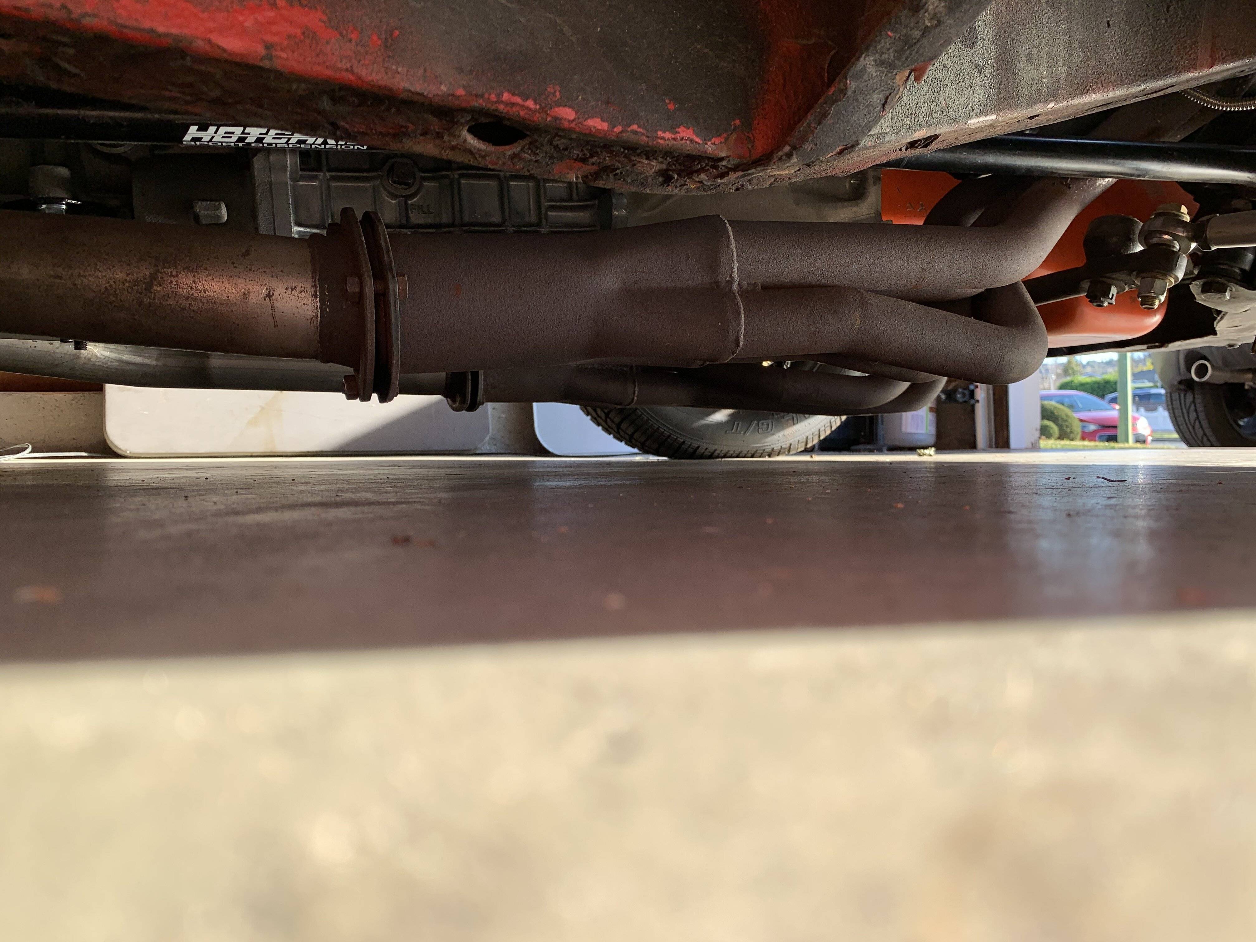

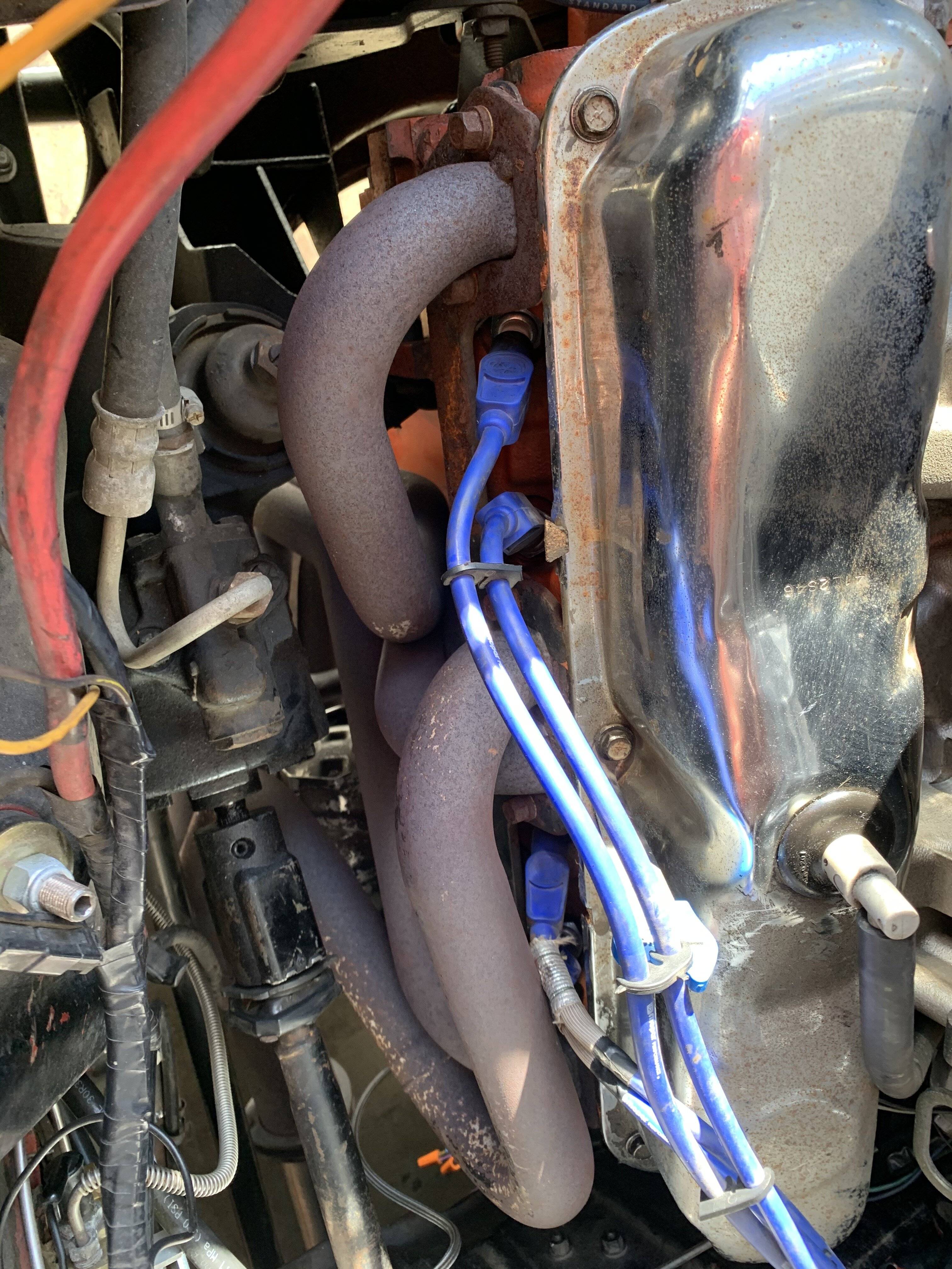

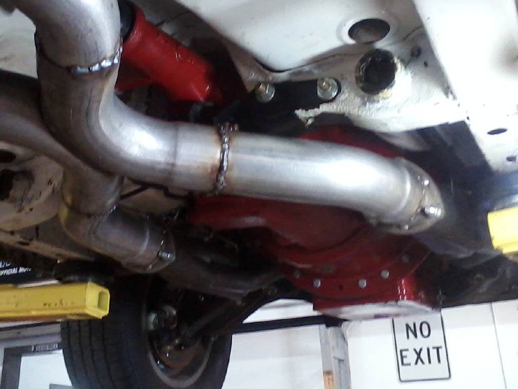

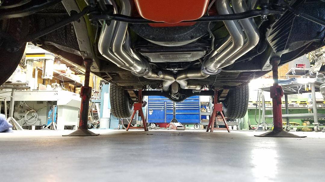

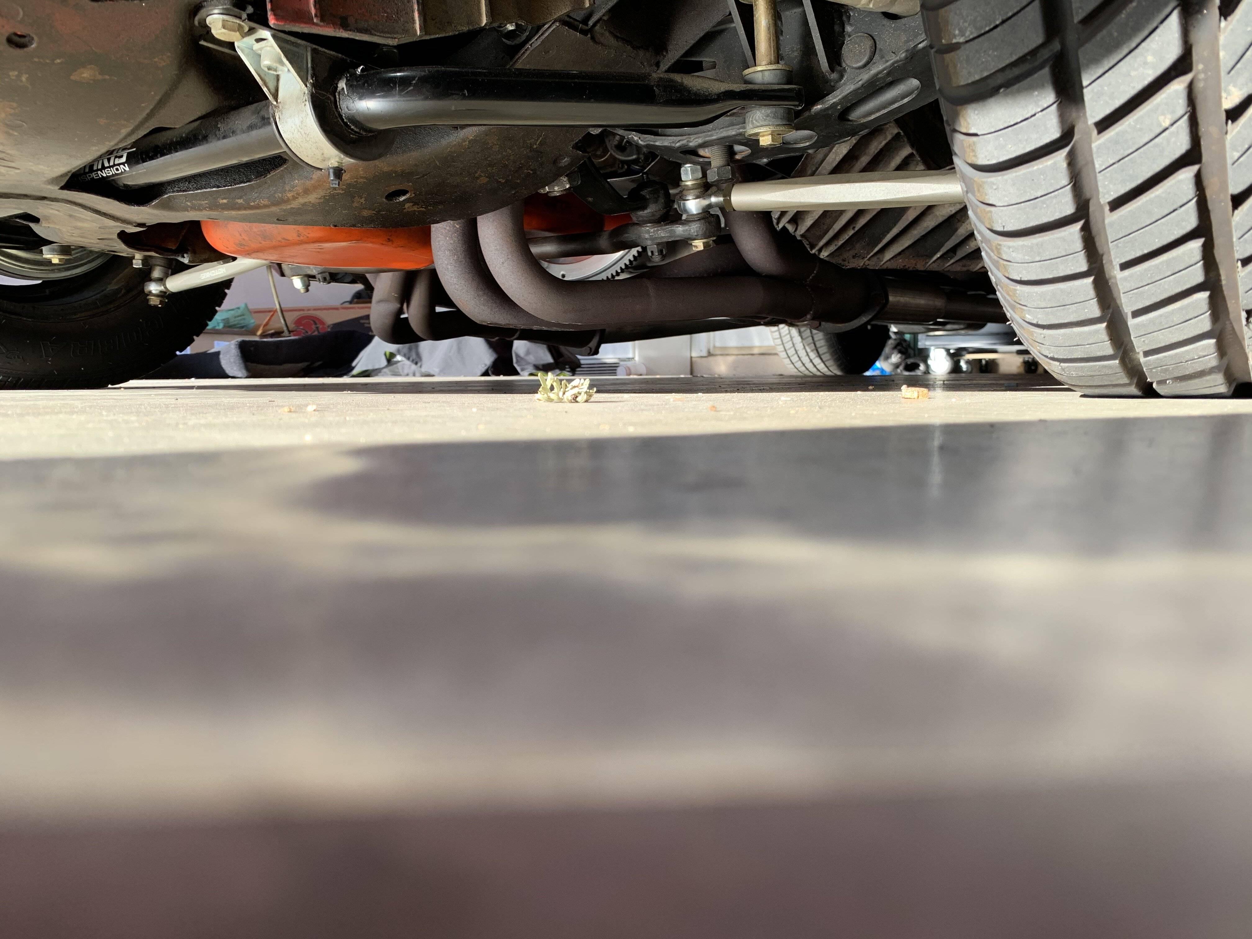

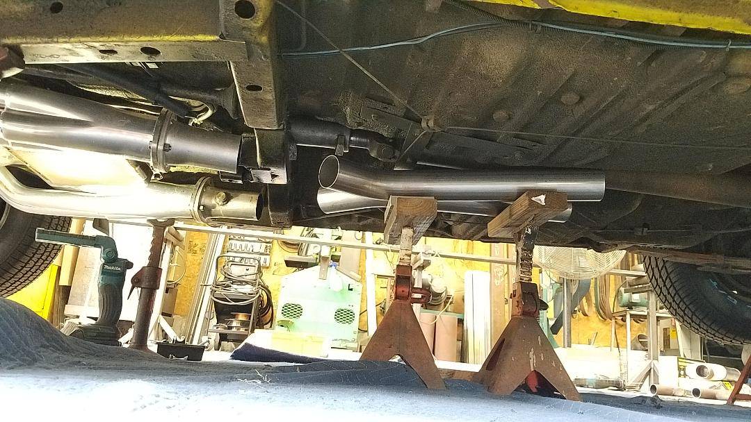

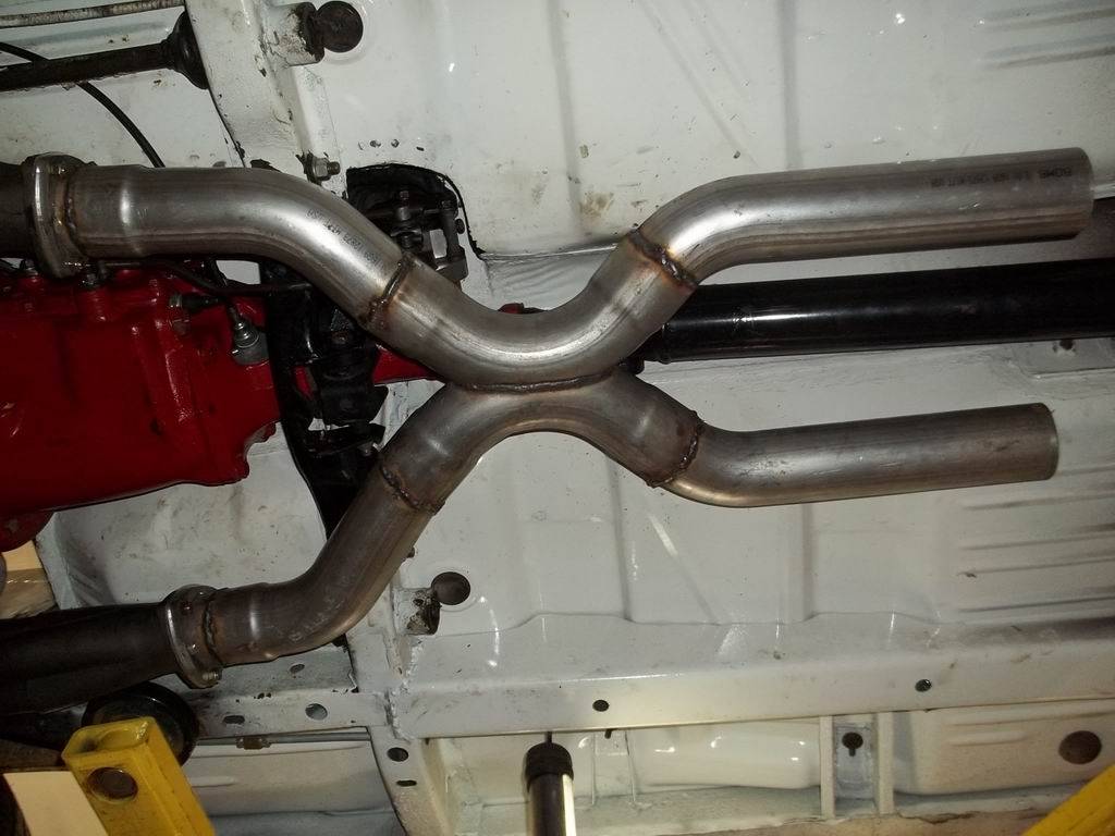

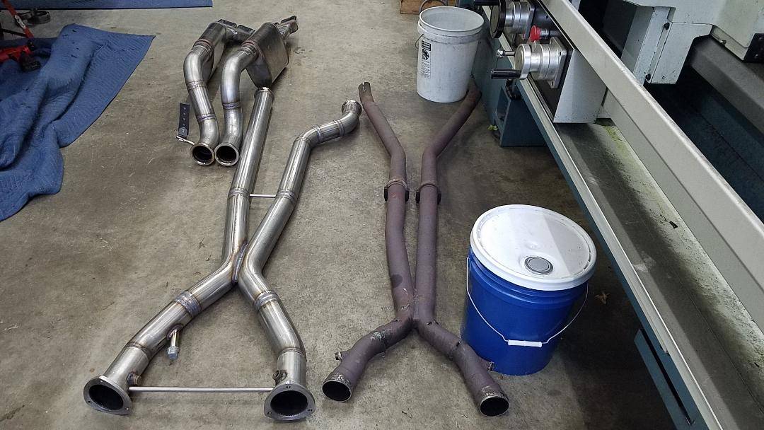

I recently installed 2" TTI headers, and a 3" exhaust on a 440/505. The flanges were the lowest point. To keep everything "up" as much as I could, I put a spacer between the trans mount and the trans to raise the back of the trans about 3/16"and I raised the shift linkage around some too, per TTI's instructions (727 auto). I could not raise the front of the motor any because I was already close to the hood with the carb/air cleaner.
A trick that worked really good was to "roll" the first elbow from the collection up a bit. That got the tubes higher next to the drive shaft early on. If you look close on the installed photo, on the tube on the drivers side, you can see it rolled up a bit. As a side note, this job was a major pain to build. It took my brother-in-law and me 2 days.

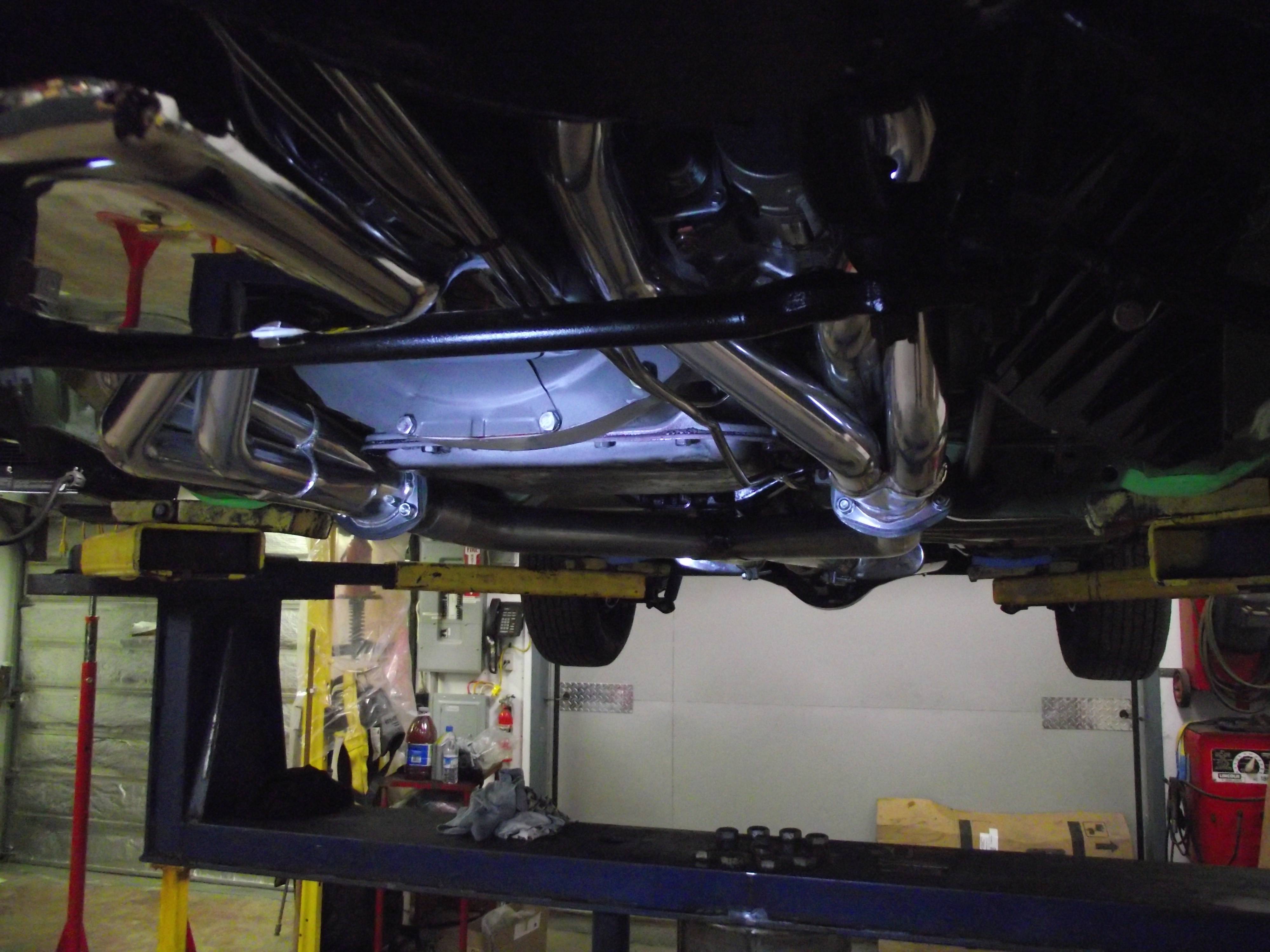

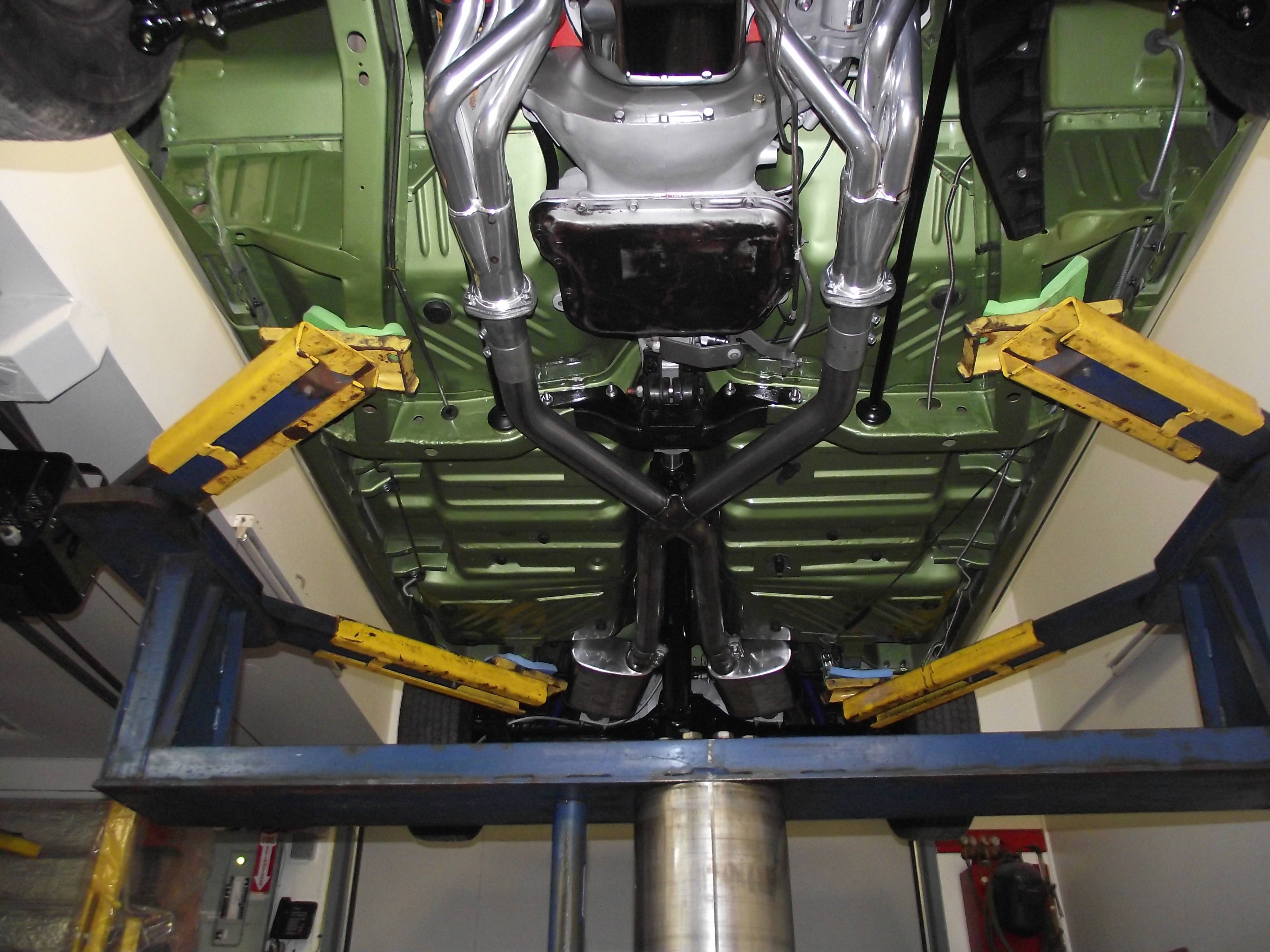

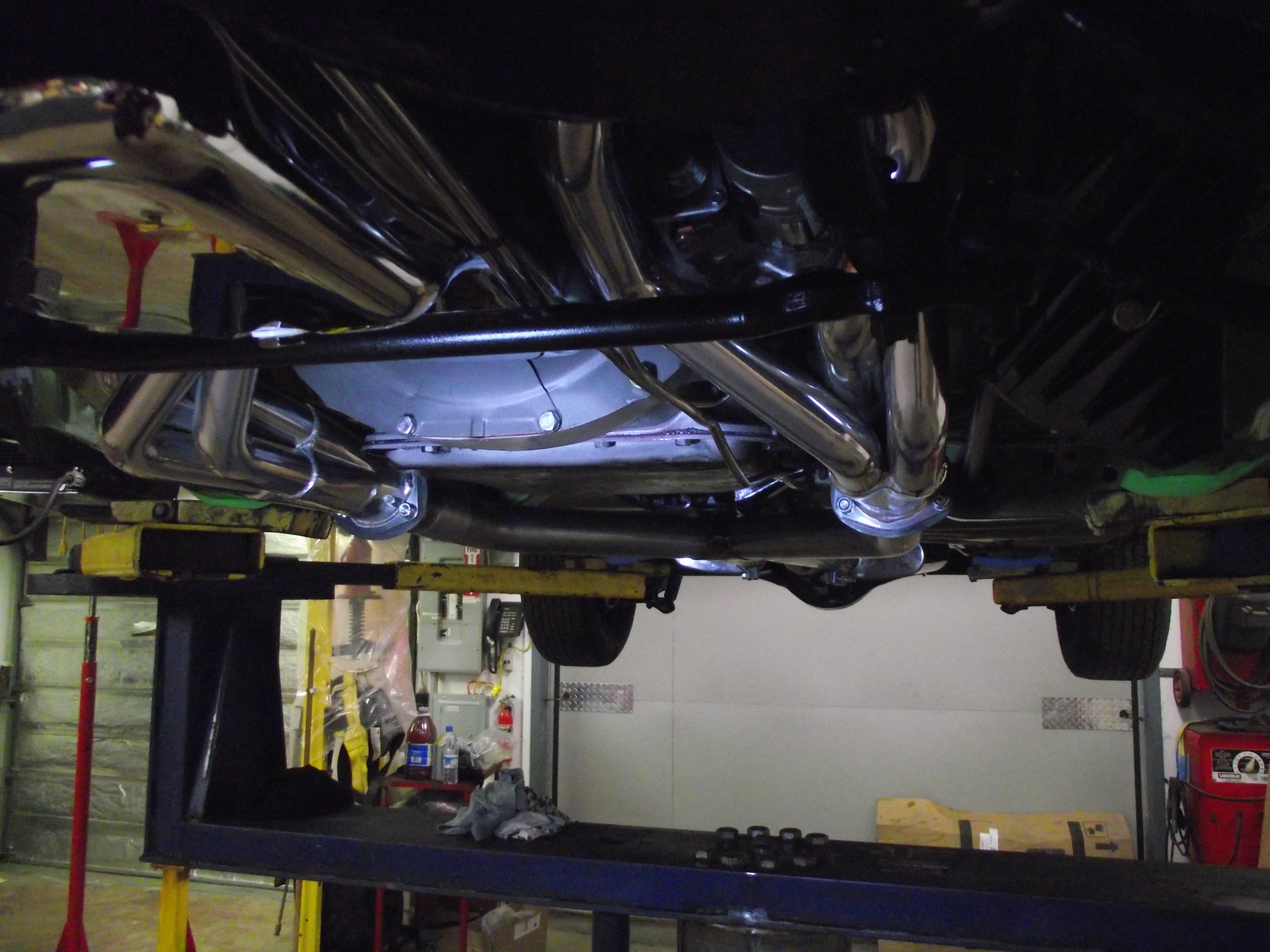

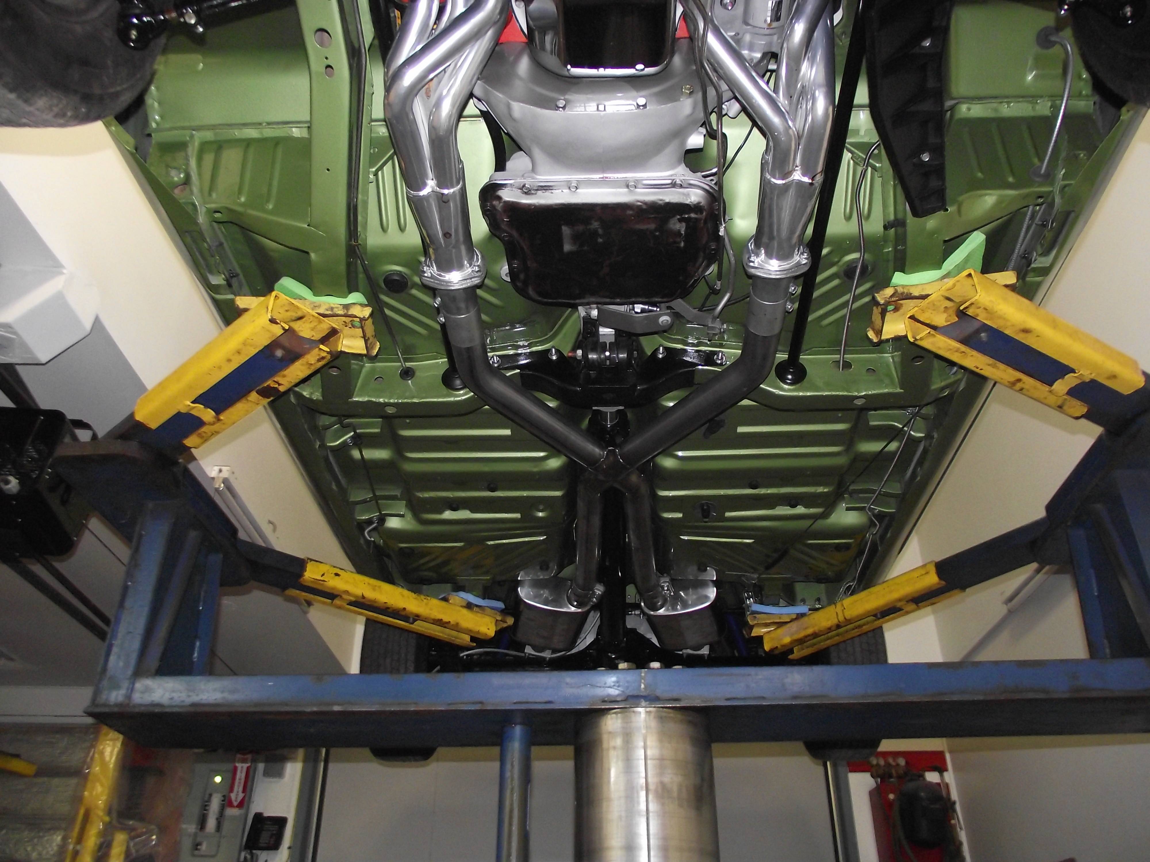

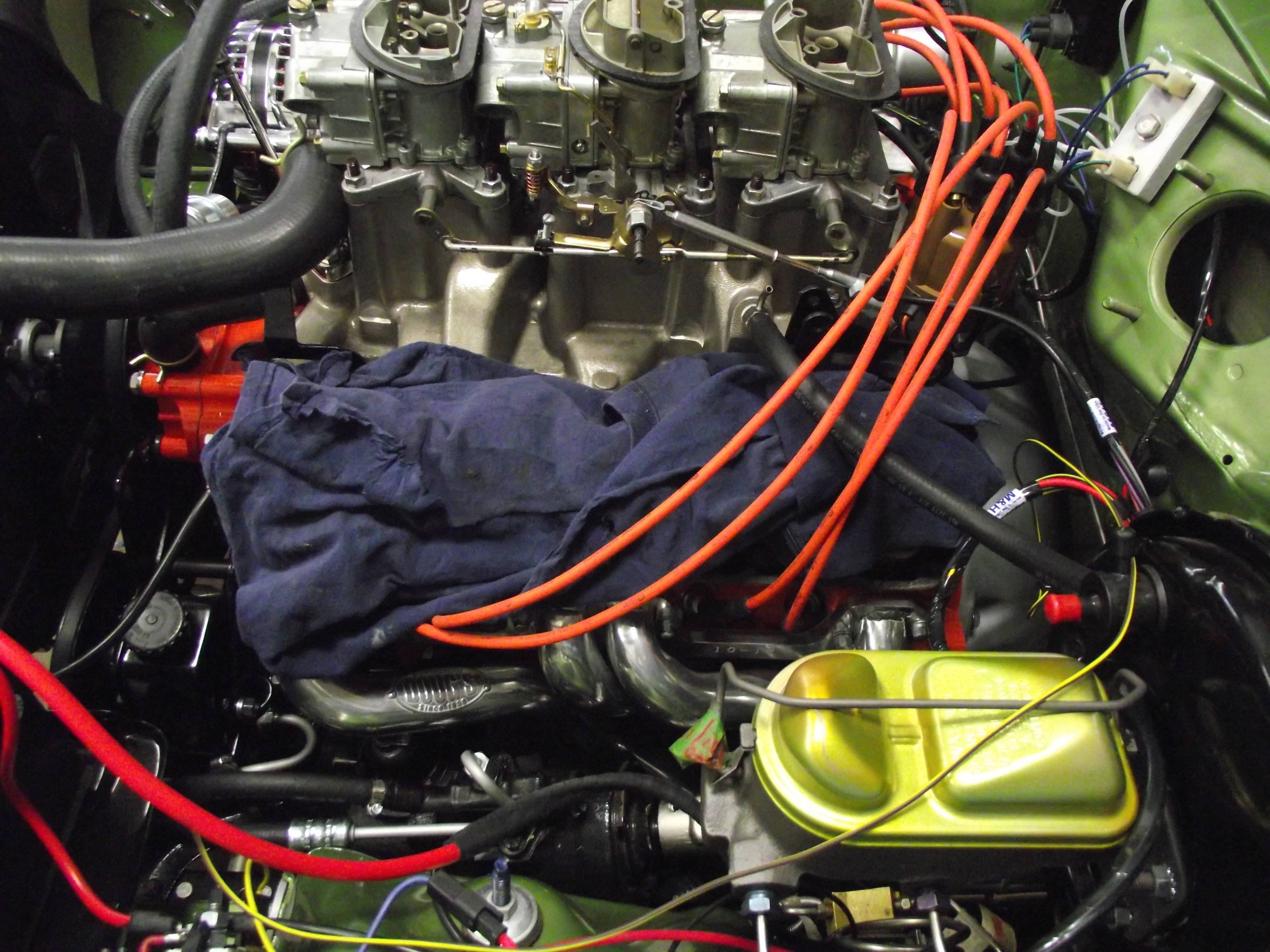

71 Barracuda ,340 six barrel, auto trans. Doug,s headers and 2 1/2 magna flow exhaust.
engine installed from top, lots of room and ground clearance is excellent as seen in second photo .
