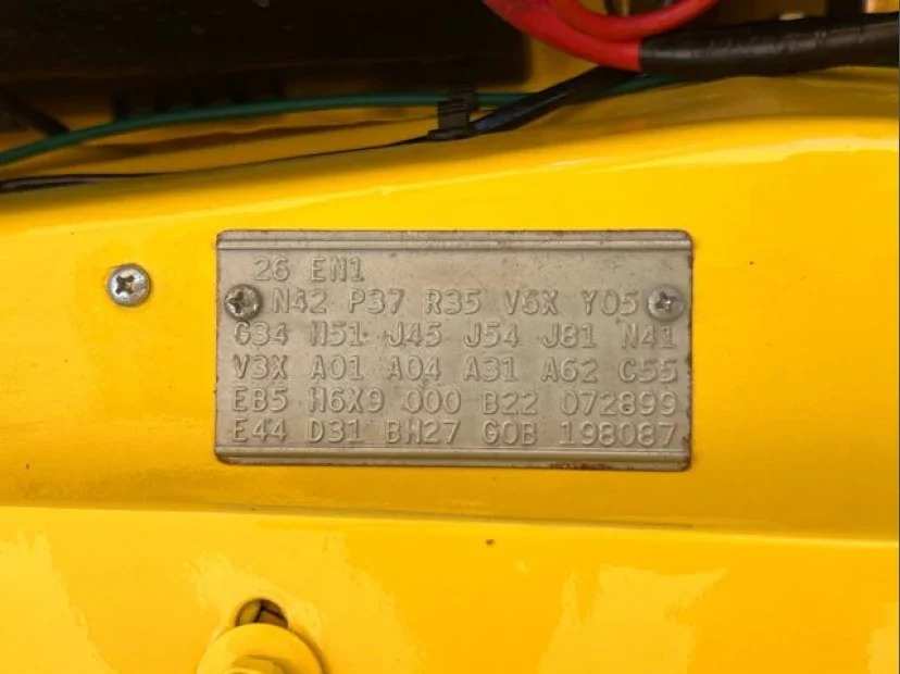

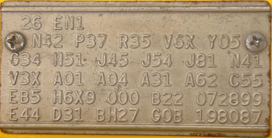

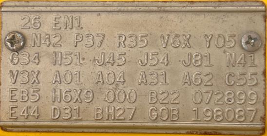

I'm looking at a tribute car and I have a question on the fender tag. I'm not concerned about the items listed on the fender tag matching what the car has now since I know it is a tribute car. The fender tag lists A31 axle package, but the car was born as an E44 "G" code 318 car and from what I have researched, the A31 axle package was not an available option on a 318 car. My question is... Could this be a fake fender tag? I haven't had my hands on the car yet, so I don't know if the body numbers match and are in place. TIA

Well, since it's a special order car "Y05", and if the salesman was willing to check A31 for a 318, it looks to be possible. They even ordered a Rallye hood with hood pins and a "Go Wing", plus chrome exhaust tips. It would be an interesting Barracuda convertible to see! Also, it would be interesting to know who ordered it. In short, it could definitely be a phony fender tag.
I agree. This would be a cool car to see if all options were in place, but this one just seems too far out there...

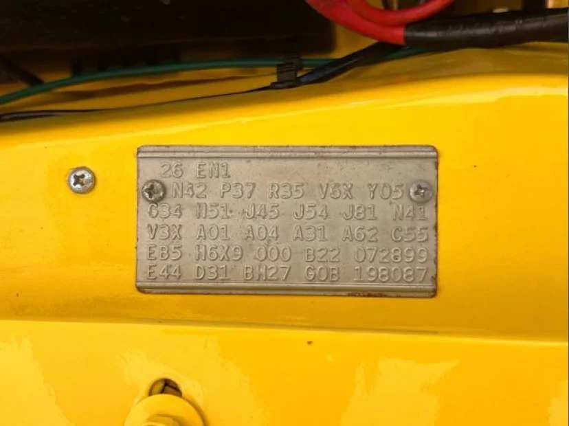

The tag you posted has all indications of being a repro tag.
The J45 - Hood Tie Down Pins, J54 - Sport Hood, and J81 - Rear Spoiler were not available options on a November 1969 Barracuda.

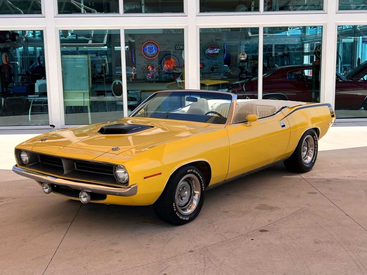

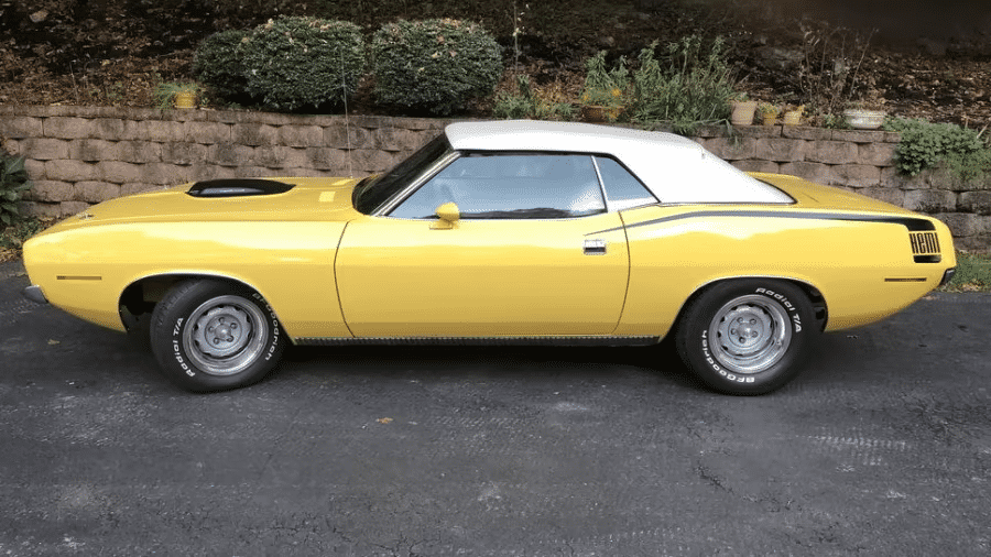

BH27G0B198087 went through Mecum in Harrisburg 2019 and did not sell. It is a color change car and looks like they were going for the Nash Bridges look but on a 1970 versus 1971.

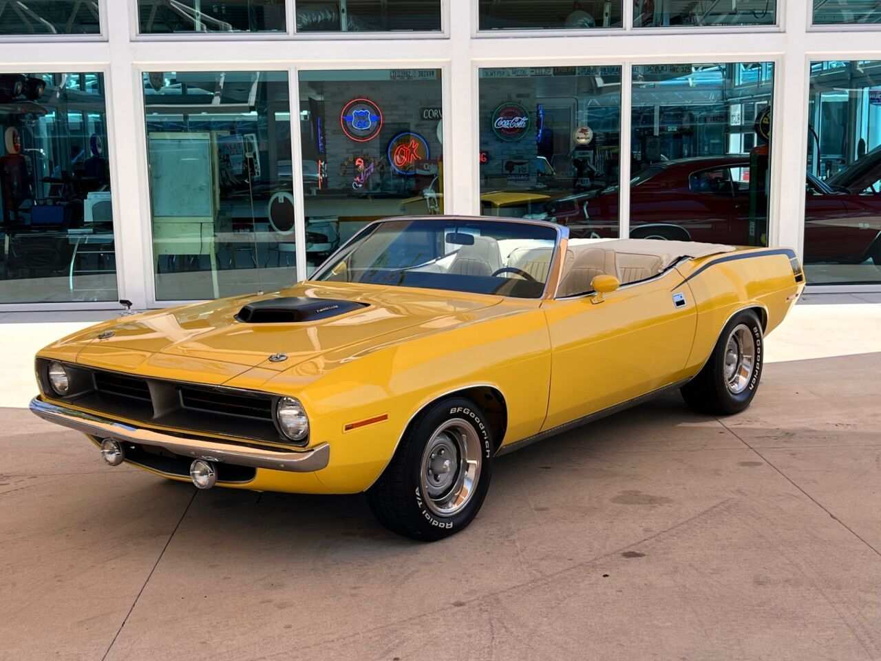

The car pictures look pretty good and it has a Hemi in it. Hard to go wrong with a Hemi convertible!

MoparCarGuy has all kinds of factory documentation. So odds are, it's a reproduced tag like he says!
This tag looks too perfect with very, very little rust on the edges. My guess is it's a repro tag. I've seen some repro tags with strange options on it (such as the A31 here), showing options that couldn't have been on that particular car or a code was not in the correct position on the tag. Plus like you said, the A31 axle package was not available on a 318 car but Chrysler did some bizarre things back then. Since it's a tribute car and you're ok with that, I wouldn't worry about the tag or the options on it. Good luck with the car!

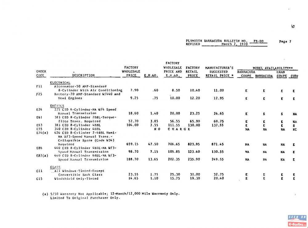

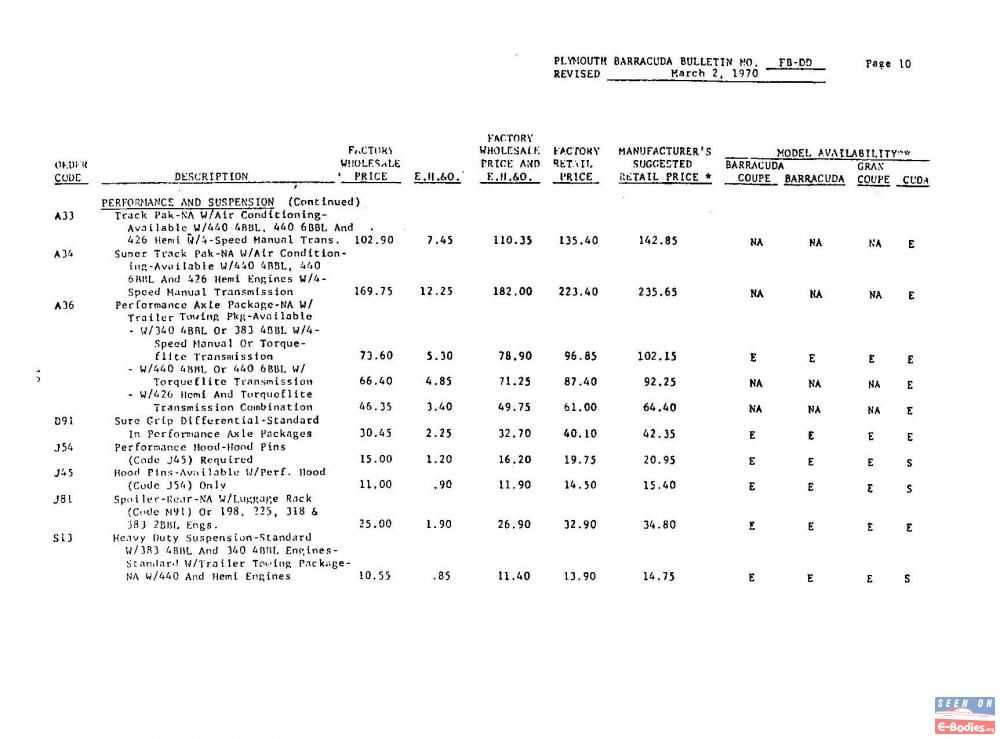

now i'm curious.... When were these options (J45, J54 and J81) available to order for a 70 Barracuda/Cuda?

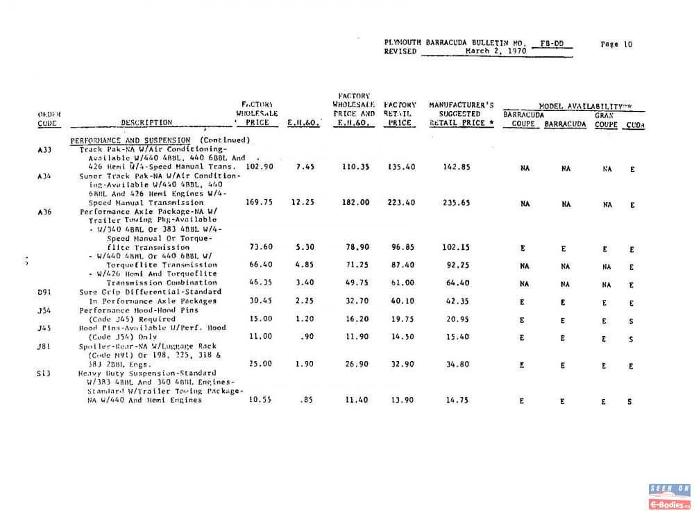

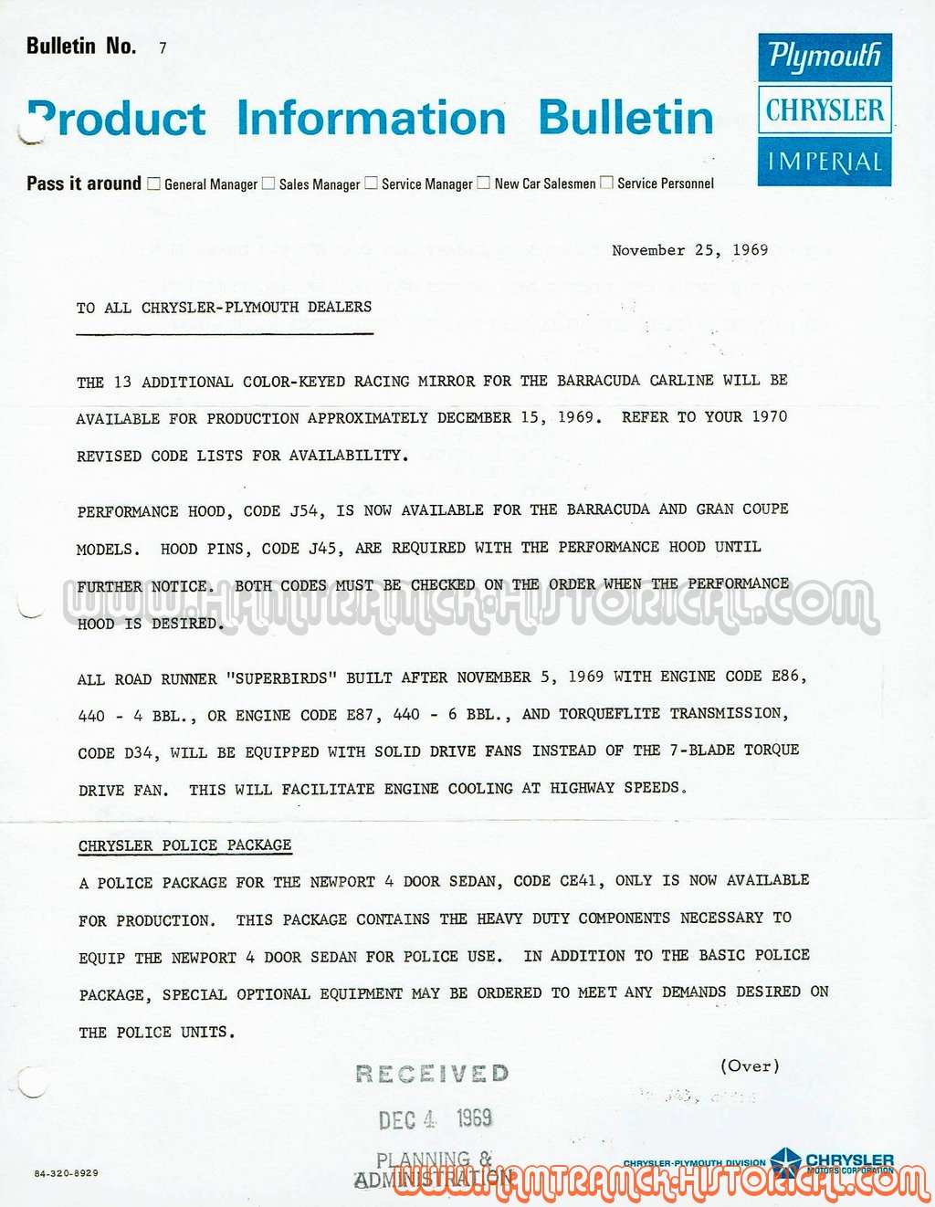

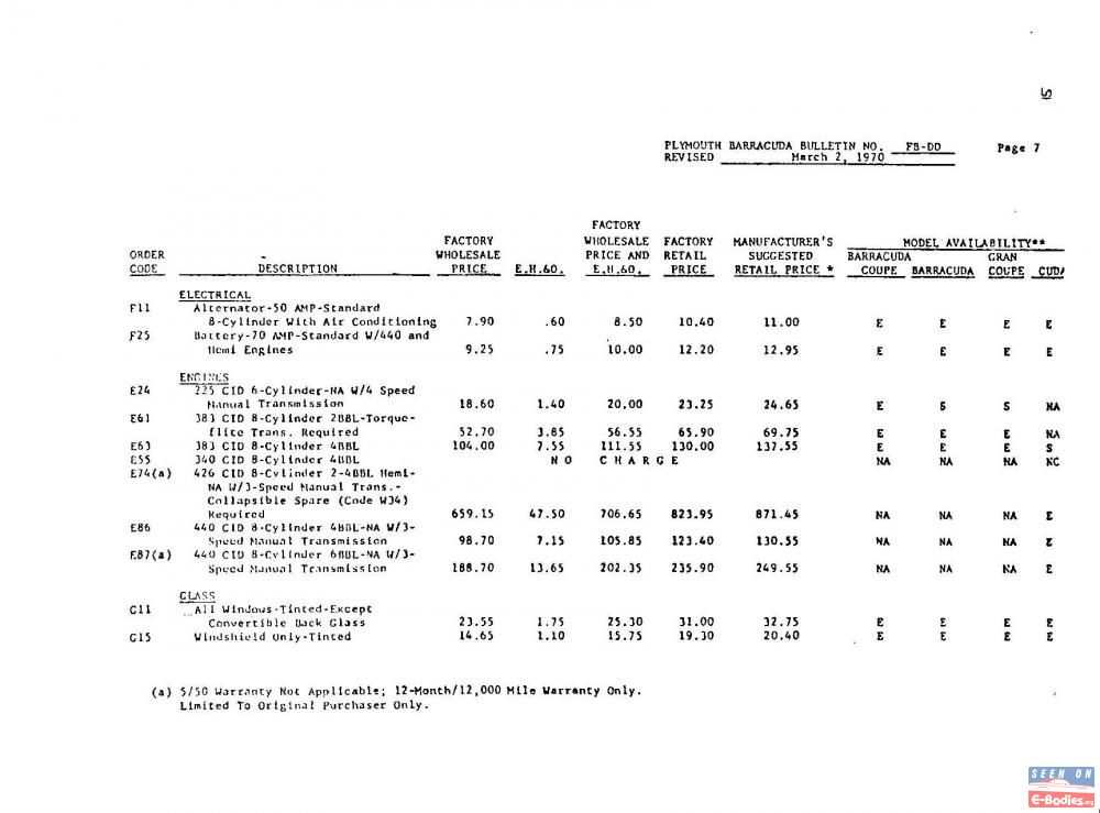

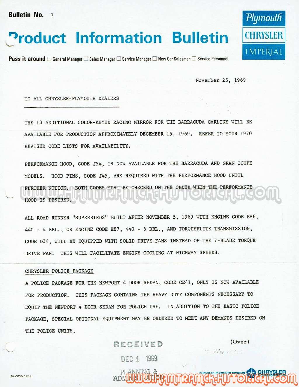

The J54 - Sport Hood was announced as available on the 1970 Barracuda (BH) models on November 25, 1969 which was two days before Thanksgiving Day (11/27/69). The sport hood and additional colors on the color-keyed racing mirrors became available on December 15, 1969.
The J54 - Sport Hood would likely have shown up for mid-December production. That means a Barracuda (BH) model with a standard 225 6-cylinder could have ordered the sport hood for mid-December production.

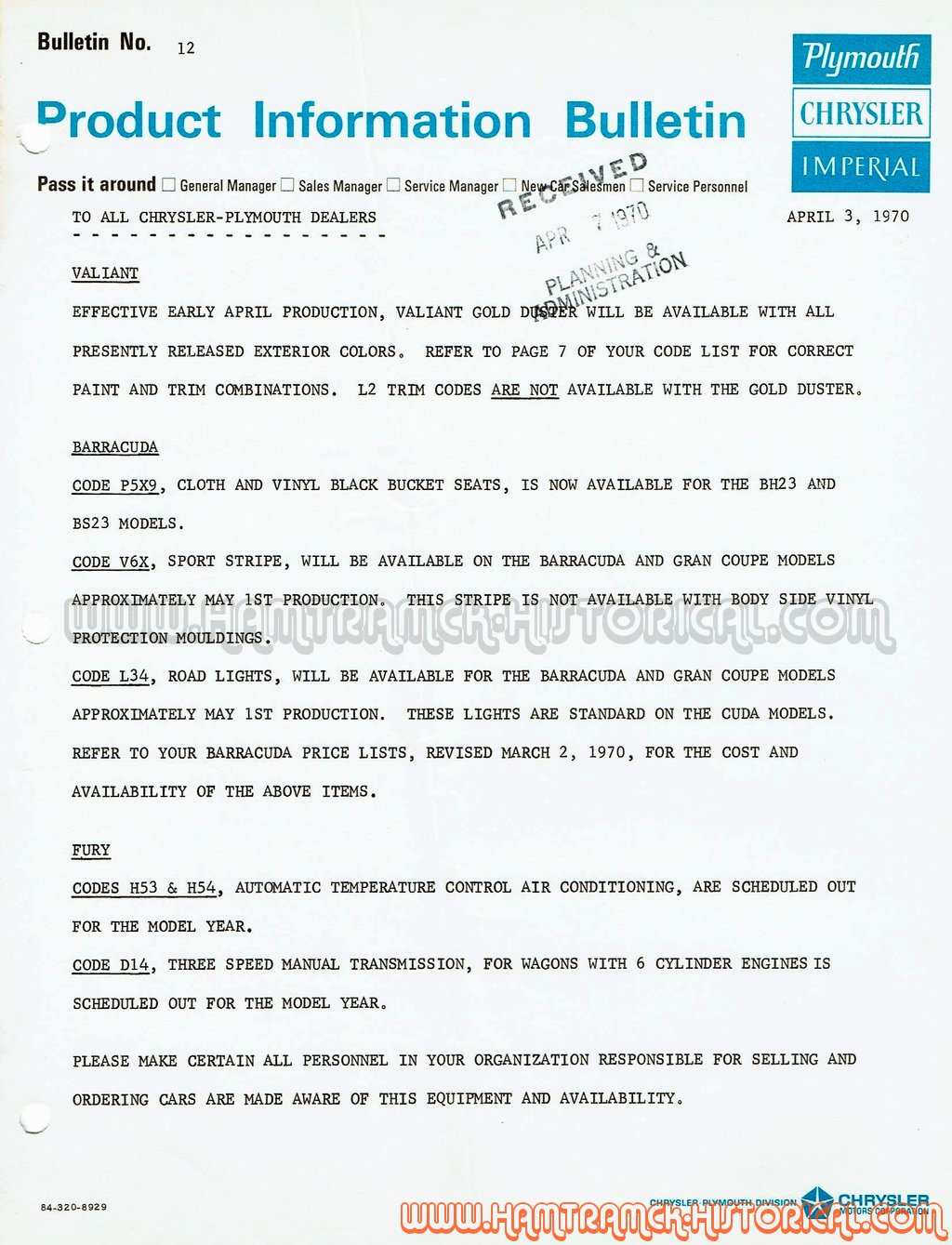

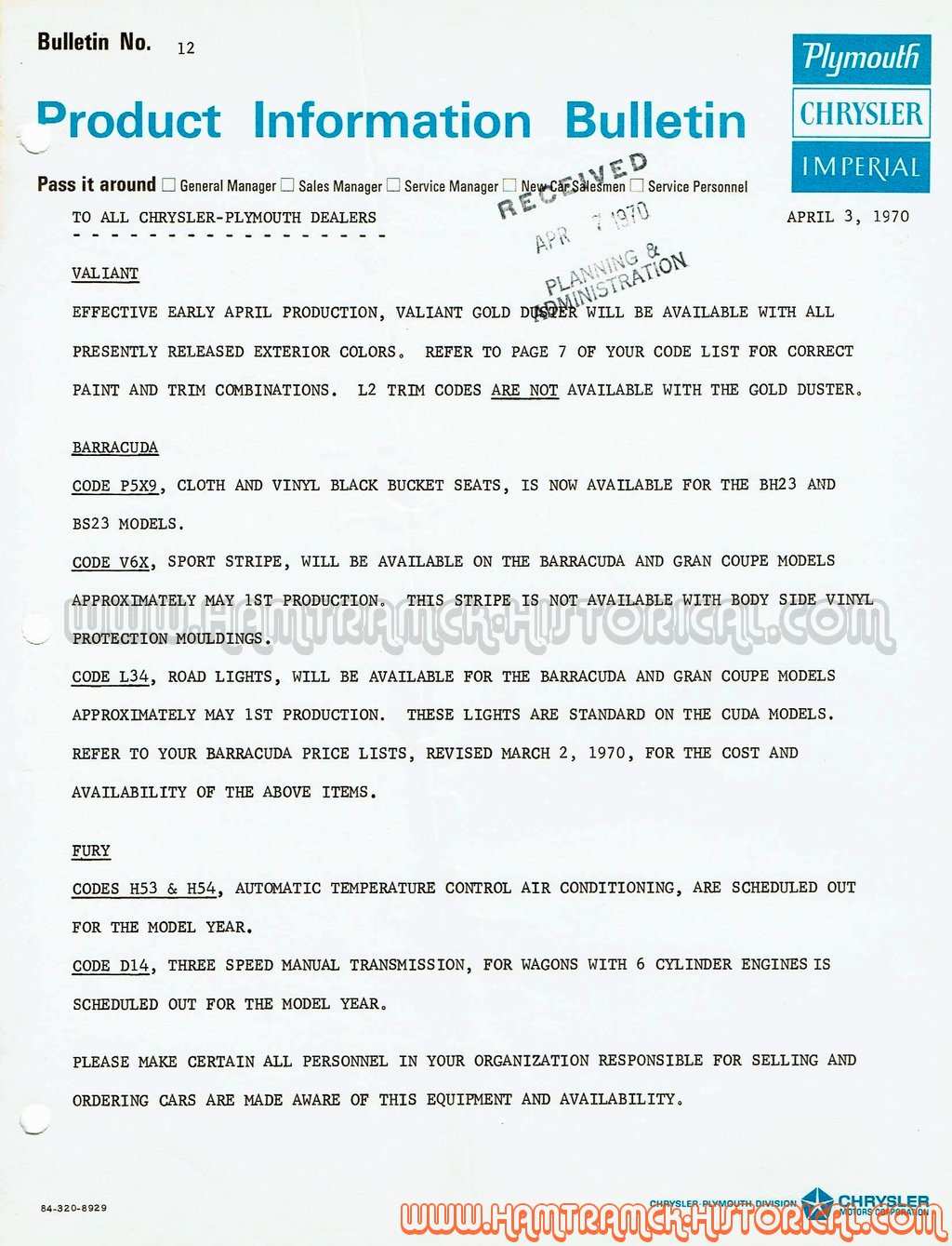

The V6X stripe was announced on April 3, 1970 for May 1st production in a Barracuda (BH) model along with L34 - Road Lamps availability. Be aware that the V6X stripe which mandates an engine callout of "340", "383", "440", "440-6", or "HEMI" would have been limited to only the engines that could be optioned on a BH-coded Barracuda. That would be limited to the optional, extra cost 383 2BBL/4BBL for the hockeystick stripe.
No 340, 440, 440-6, or HEMI engines could be ordered in a Barracuda (BH) as they were only available on the Cuda (BS) model.
Now we need to have anyone out there with a Barracuda (BH) respond with documentation showing their car was equipped with a standard 225 engine or optional 383 plus any of the below options:
J54 - Sport Hood (For BS & BH models and required J45 - Hood Pins in 1970); Very common on 318 Barracudas with no hood engine emblems but are there any 225-equipped Barracudas with an optional Sport Hood?
J81 - Spoiler, Rear (Pricing sheet below shows the J81 would be optional (E=Extra Cost) on the 383-4BBL only)
V6X - Hockeystick stripe (Black-only) with "383" callout.
The V6X stripe was announced on April 3, 1970 for May 1st production in a Barracuda (BH) model along with L34 - Road Lamps availability. Be aware that the V6X stripe which mandates an engine callout of "340", "383", "440", "440-6", or "HEMI" would have been limited to only the engines that could be optioned on a BH-coded Barracuda. That would be a 225 6-cylinder or a 383 2BBL/4BBL which were extra cost.
View attachment 124037 View attachment 124038
View attachment 124039View attachment 124040
Great information on BH Barracudas' option availability
Thank you for clarifying what was possible!
