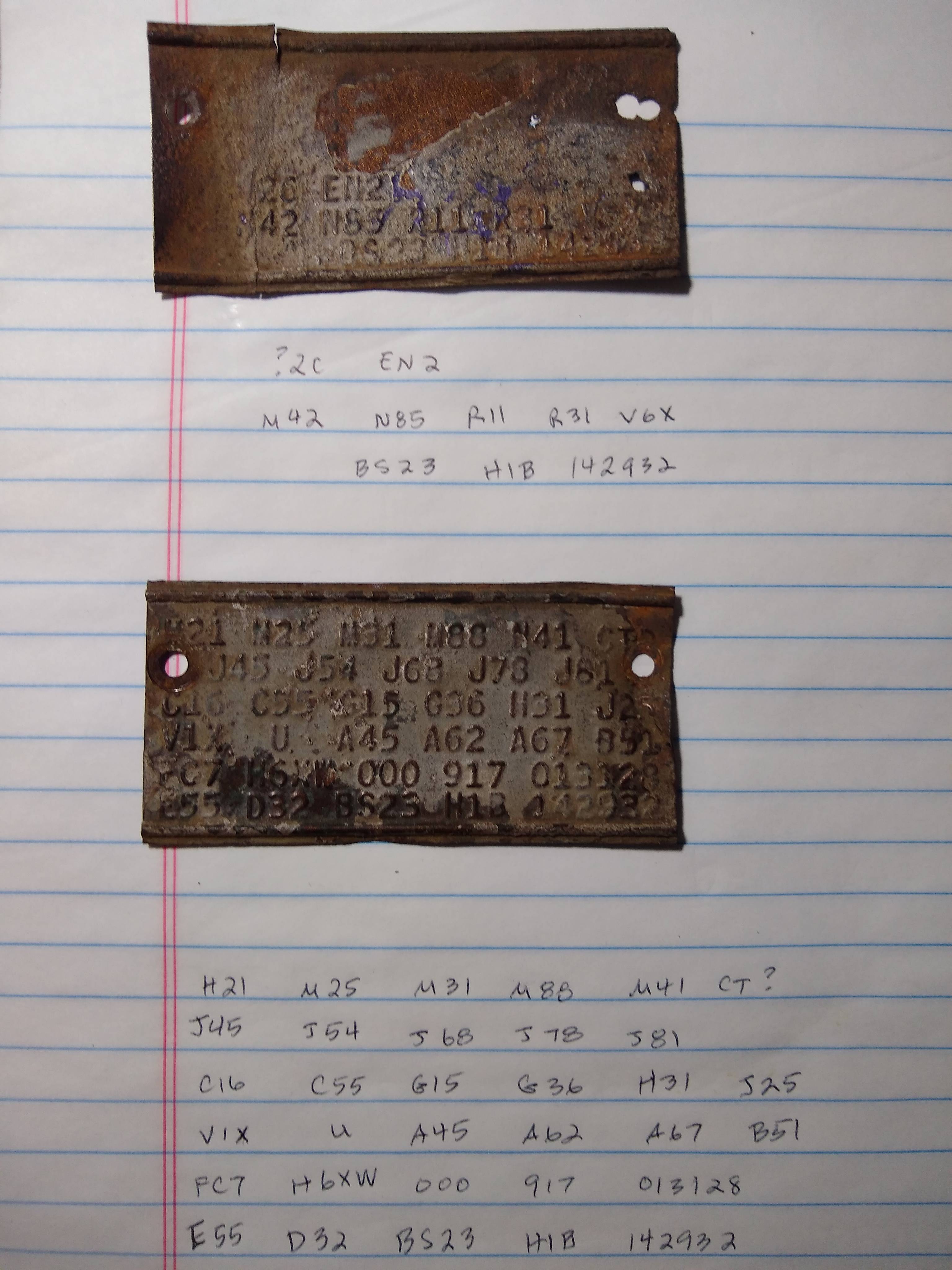

Fender Tag

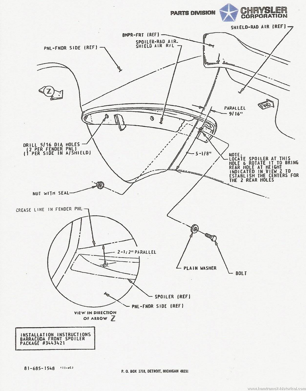

And the hole locations for the front spoiler.

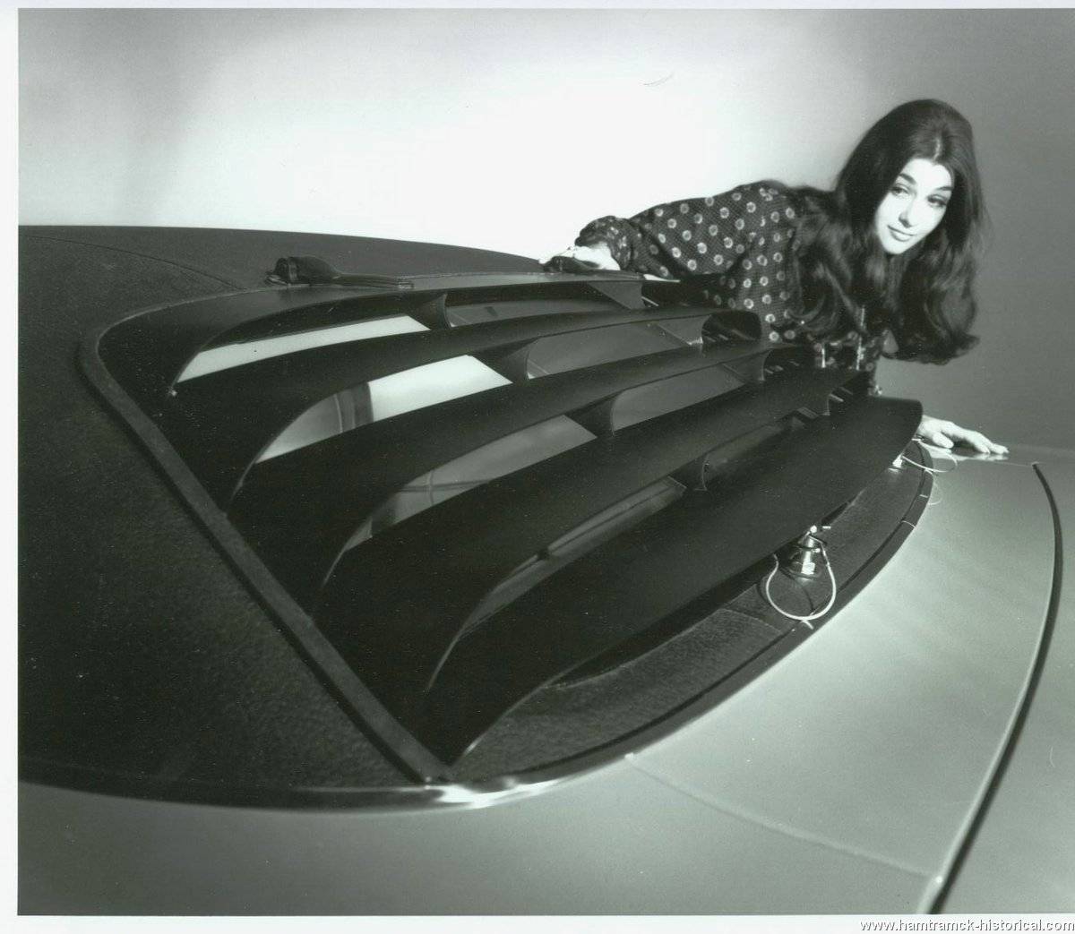

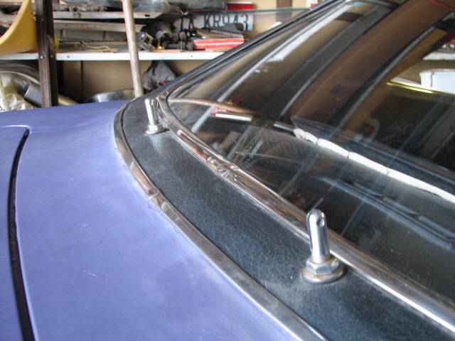

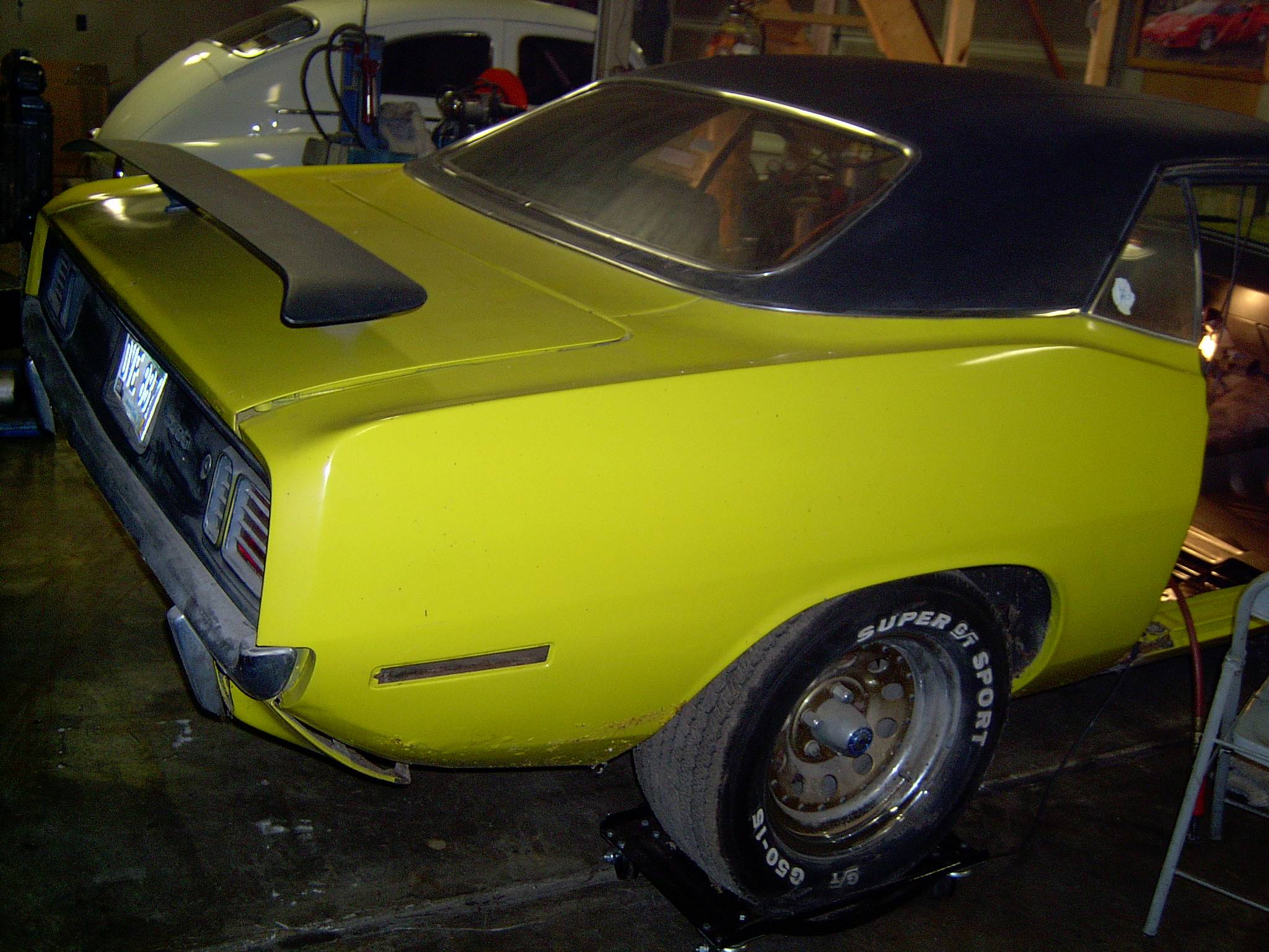

no, not a bunch of pics yet - just my original "introduction" post when the car was brown in the 80's. It is a long term project I am doing myself, as time & $$ allow & still getting the lay of the land of the forum. Here is a closer pic of the rear glass, and I never had the 'posts' for the window louvers so ?? and yeah, it's been painted twice so chin spoilers could have been easily filled. thanks again for the replies

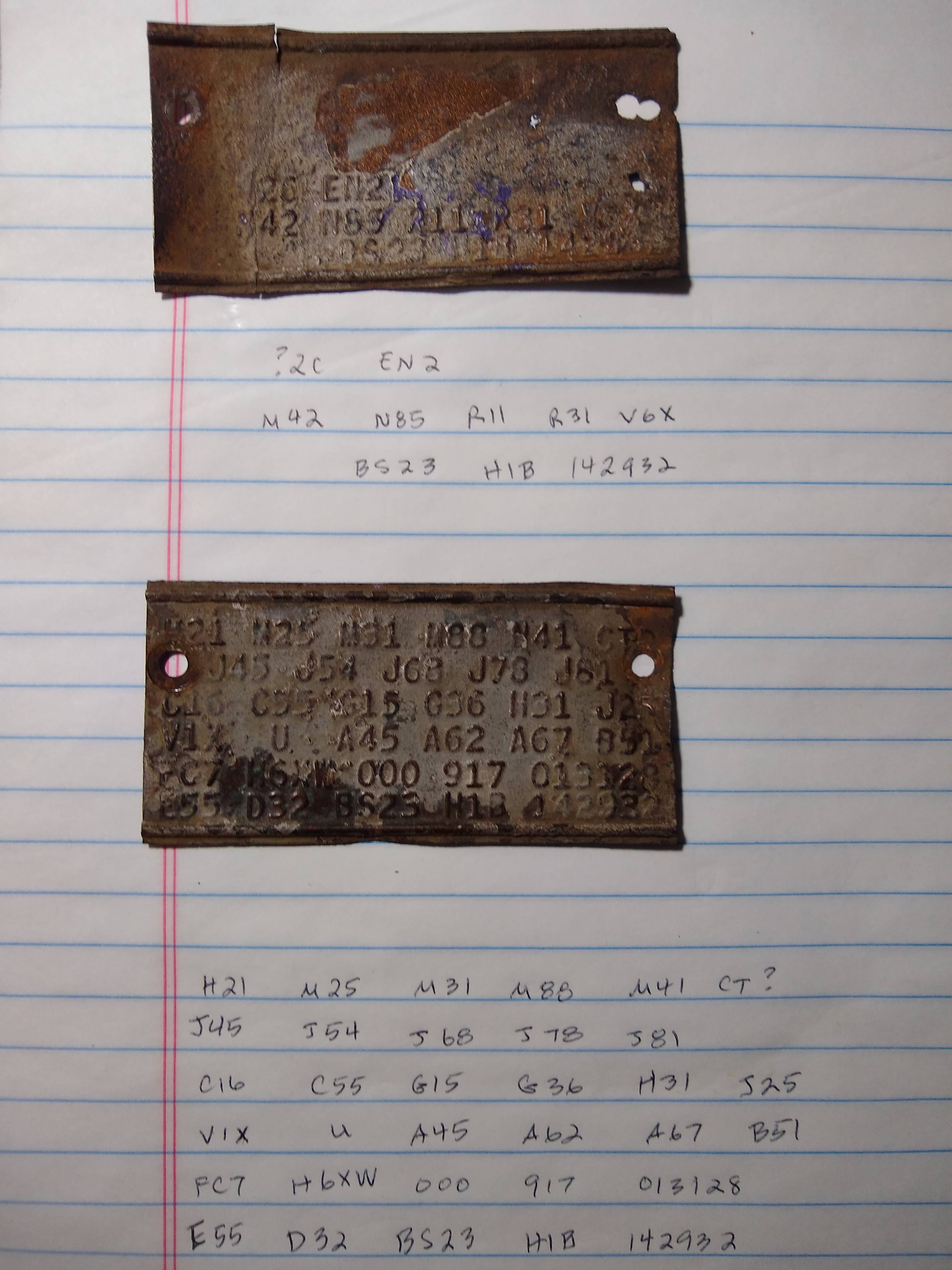

Pulled the tags off my fender, haven't found the broadcast sheet, and looking for some tips on best way to preserve/ refinish the tags - without destroying them. Also used an online decoder at Stock Mopar, posting here if anyone can fill in the missing "not found" optionsView attachment 79635
soak them in
Evapo-Rust The Original Super Safe Rust Remover, Water-Based, Non-Toxic, Biodegradable,​
