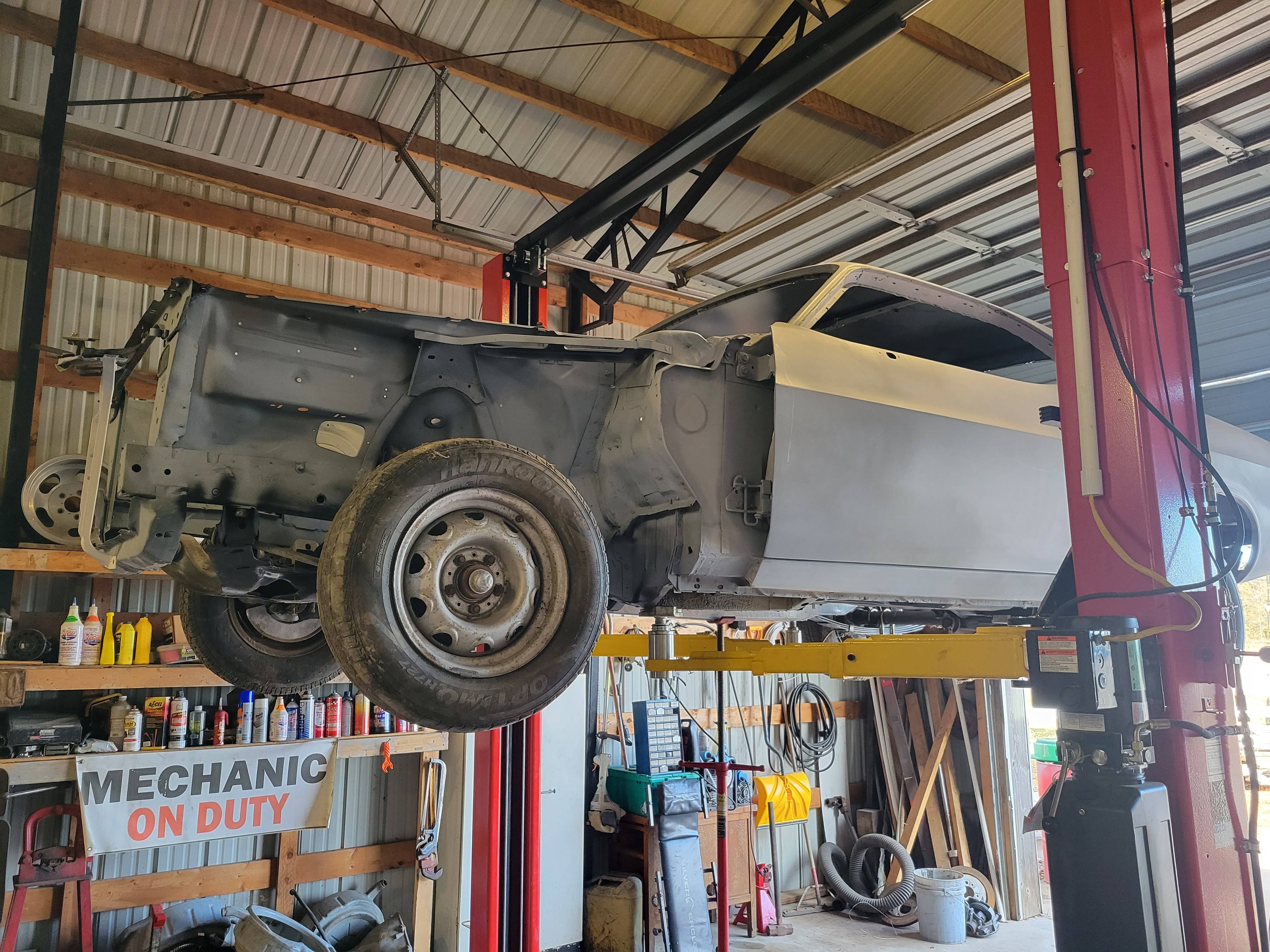

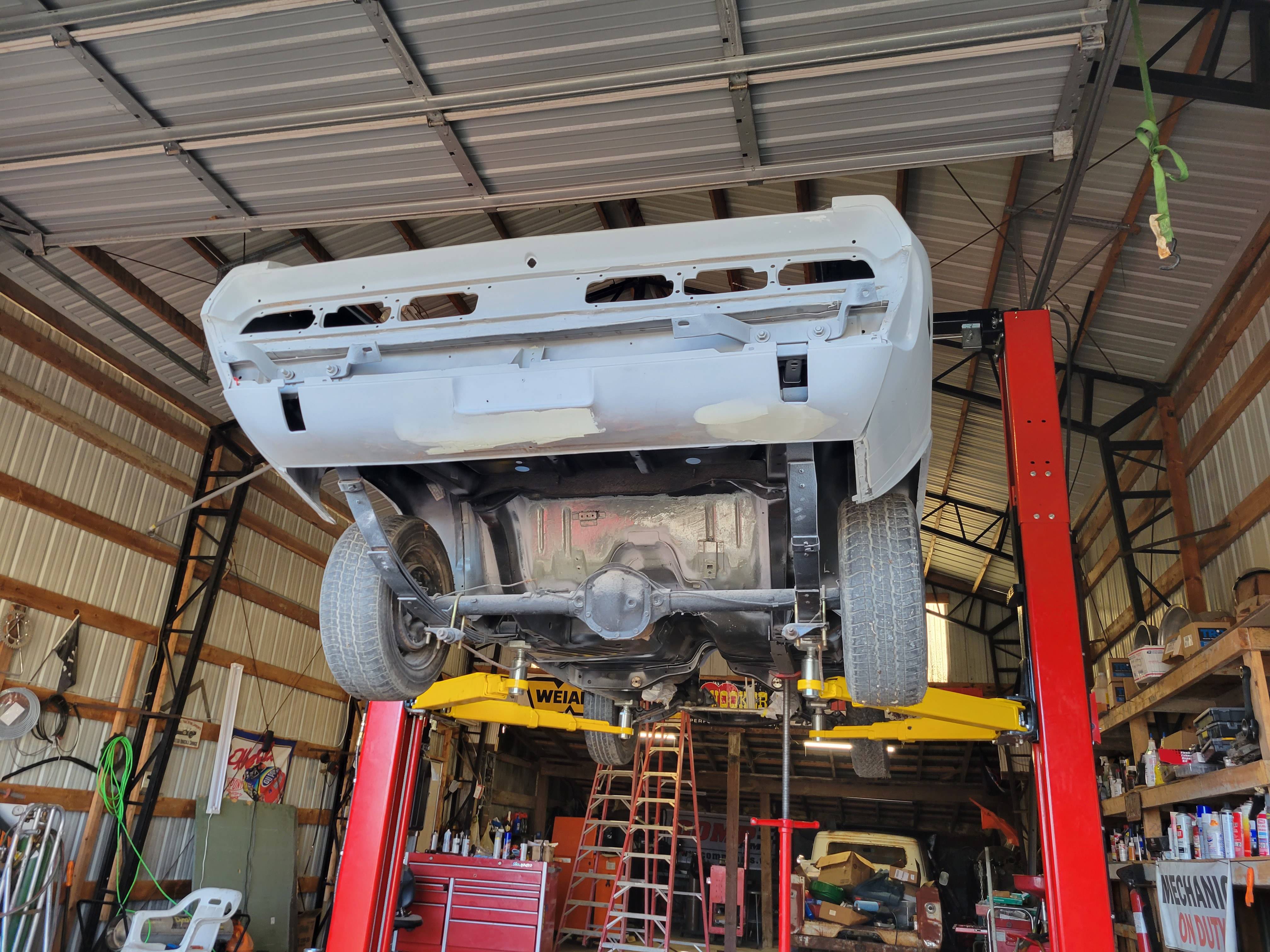

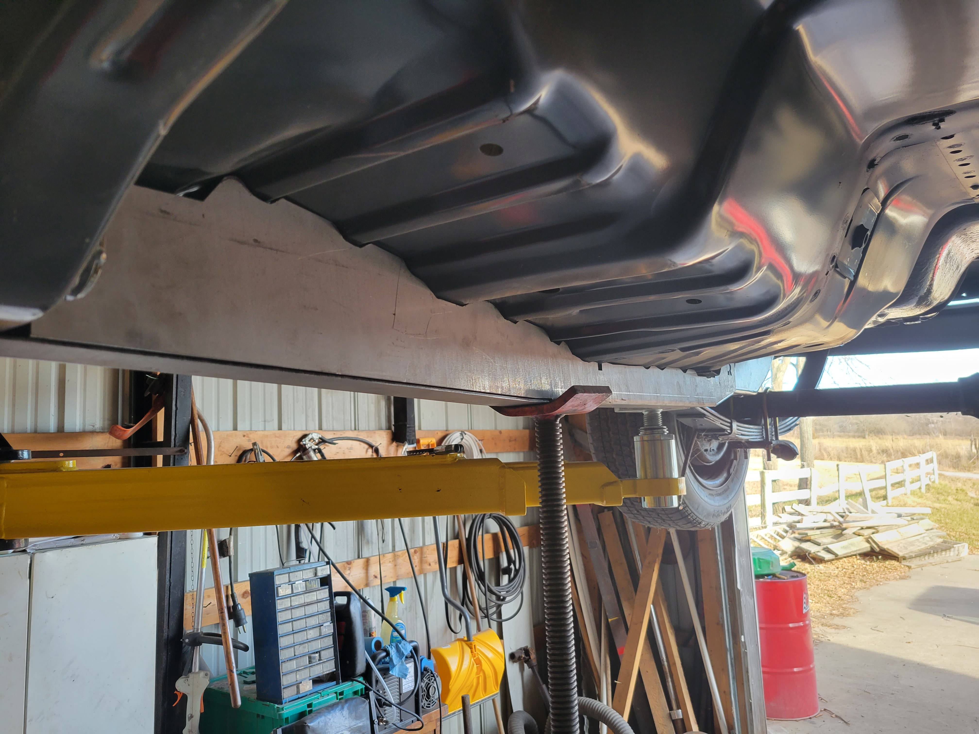

I am finally installing my frame connectors. If you don't hear from me by tomorrow, send a search party

Hey, now, you guys are going to muddy the water, and I'll never be able to unload this axle.

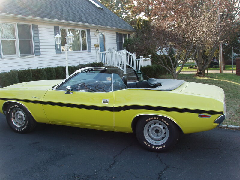

Just saw this and thought I would chime in. I have a convert. If you ever saw it on a lift you would see the door to quarter gaps were outrageous.
Back on All 4's - it looks goods. Point being when I do install my Frame connectors - the car will be supported under the rear axel and at each lower control arm.
318/auto/ 8 3/4. Best of Luck.

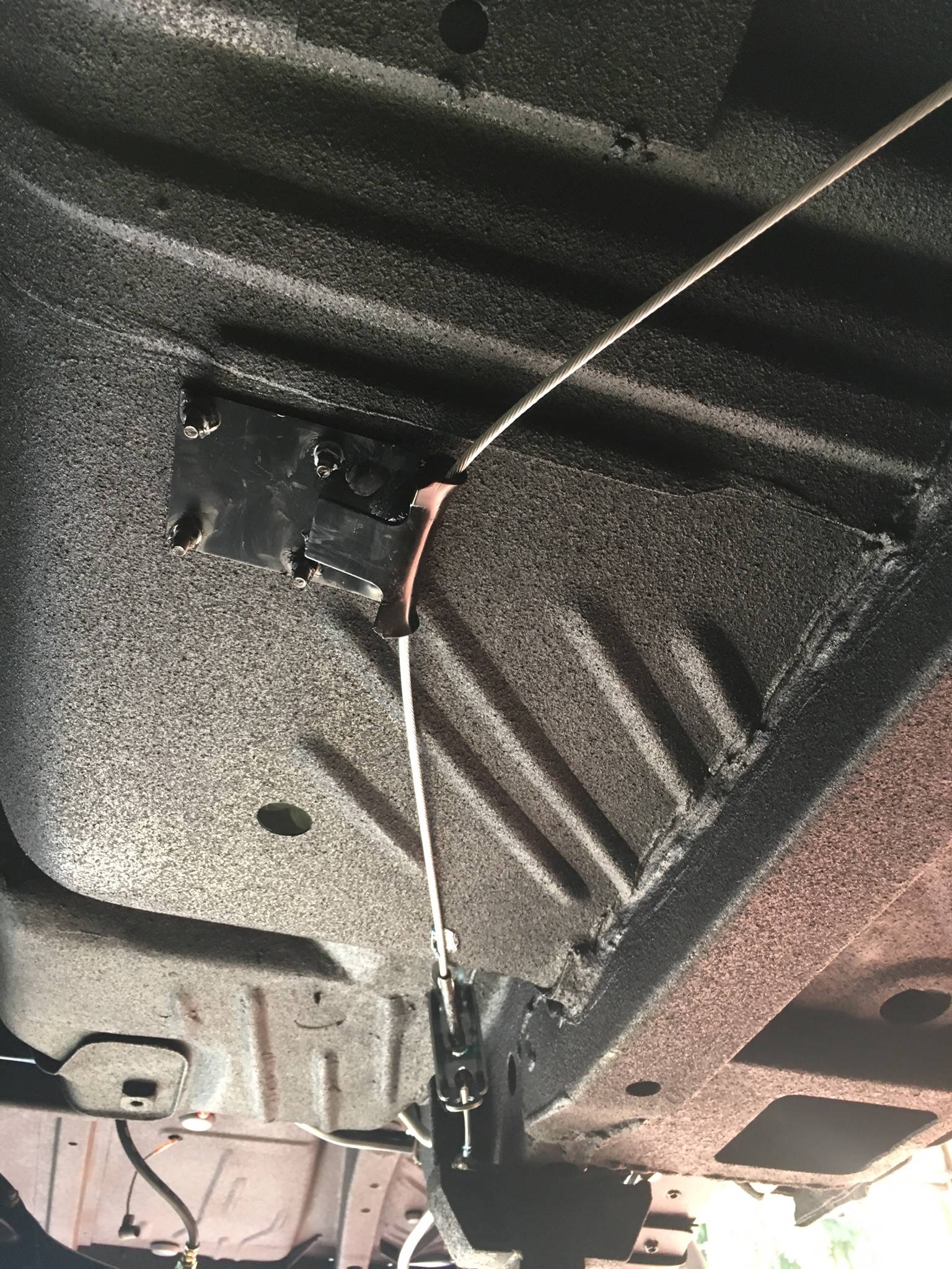

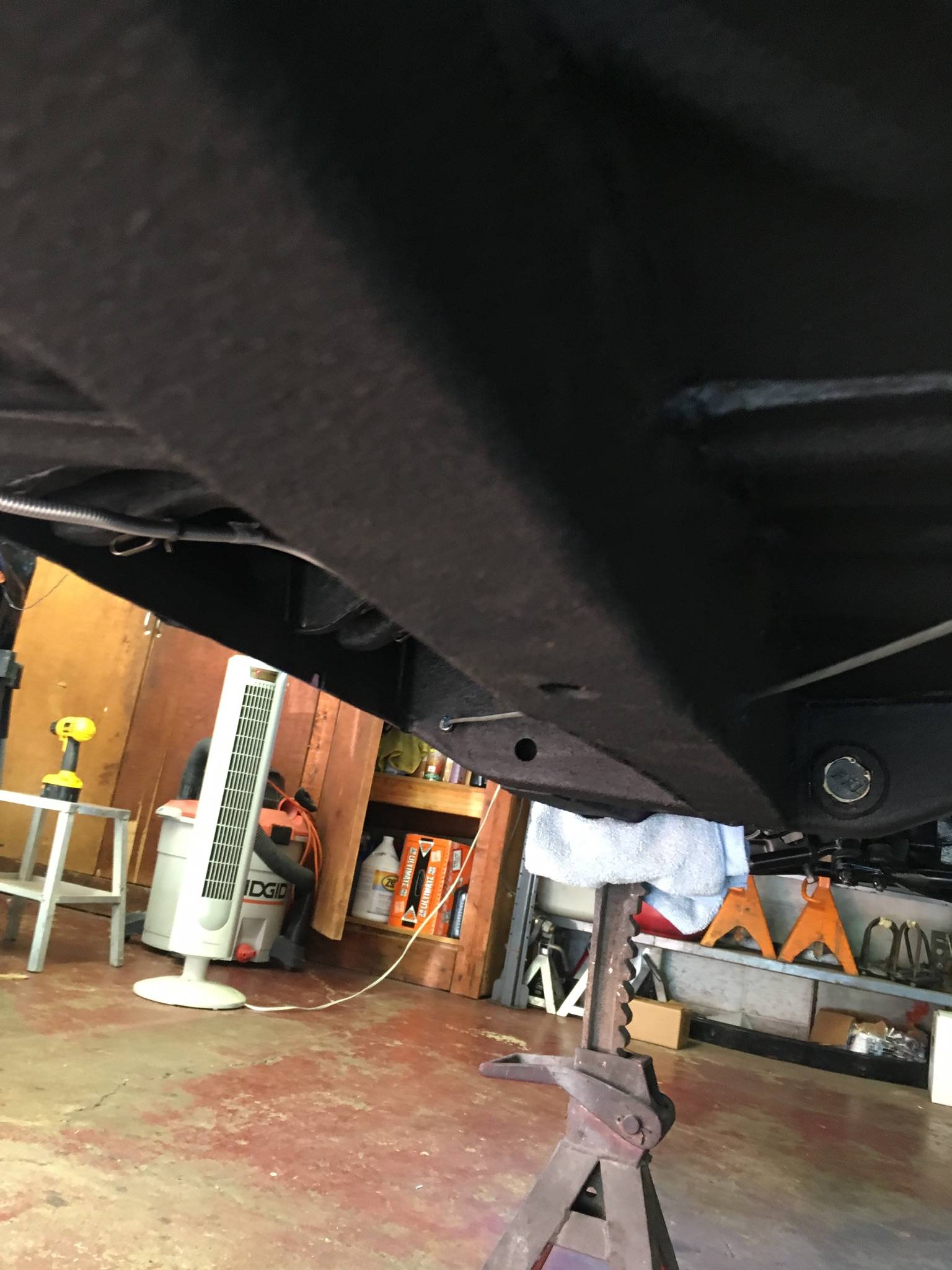

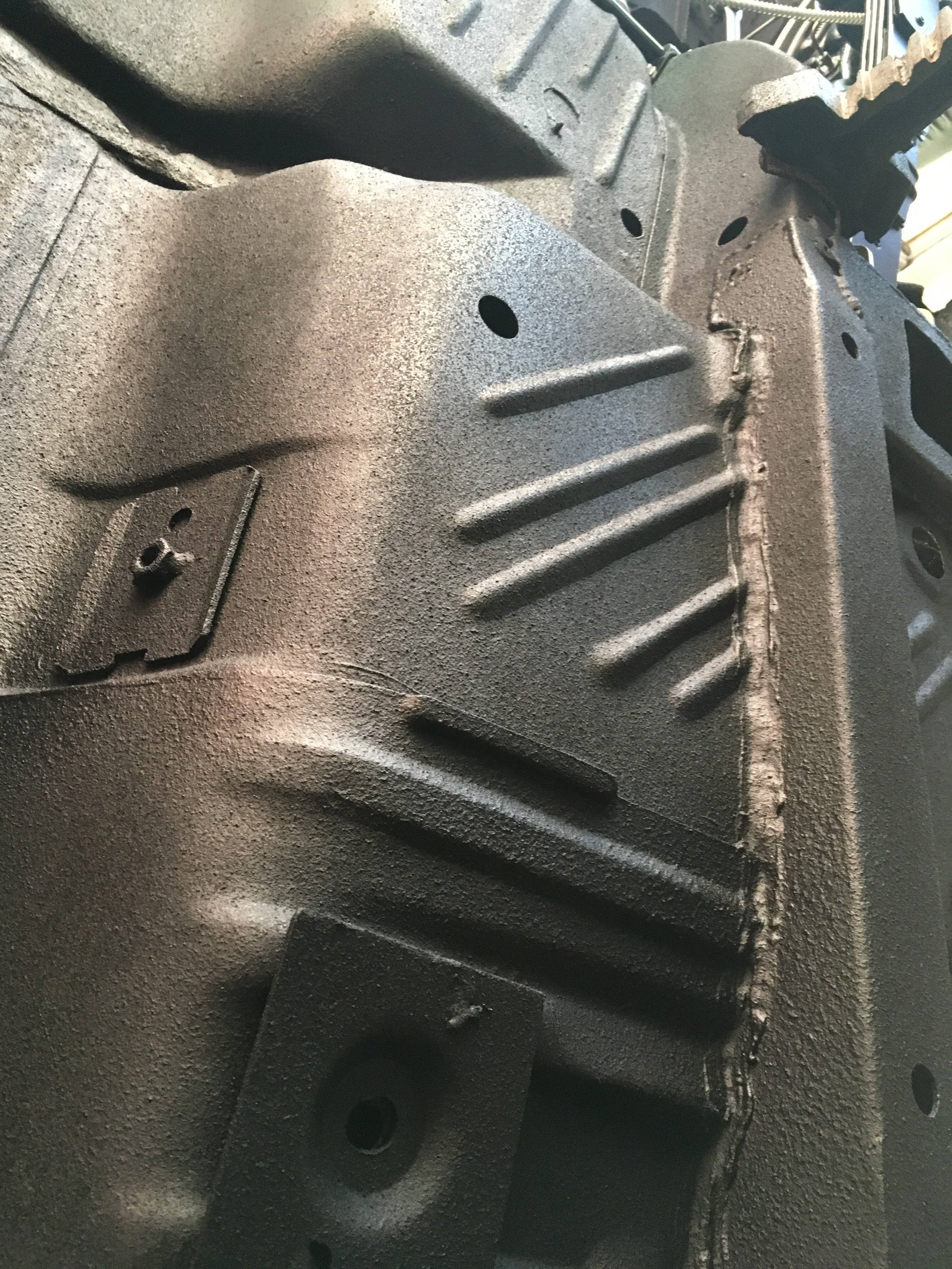

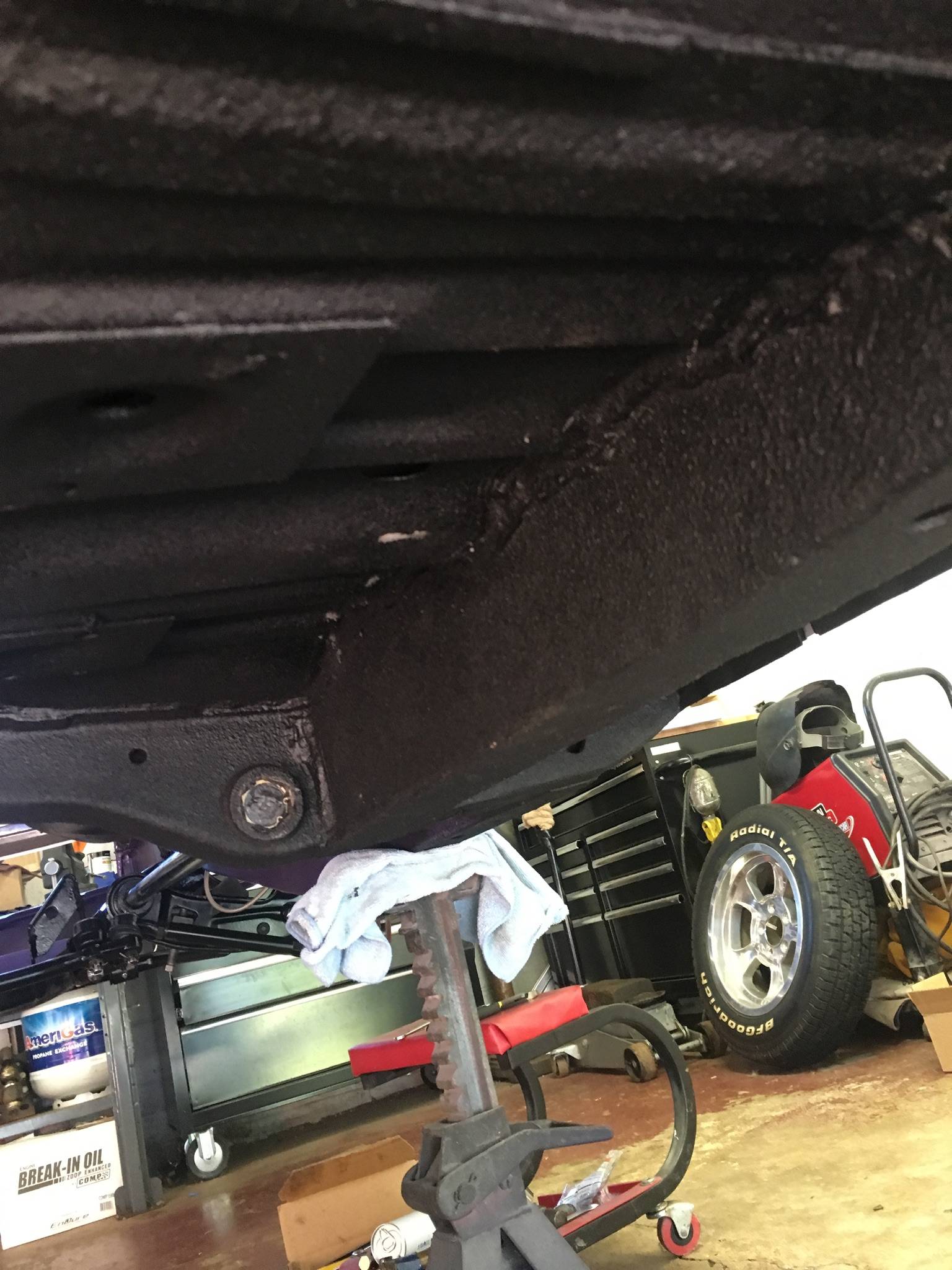

This is how it turned out for me.

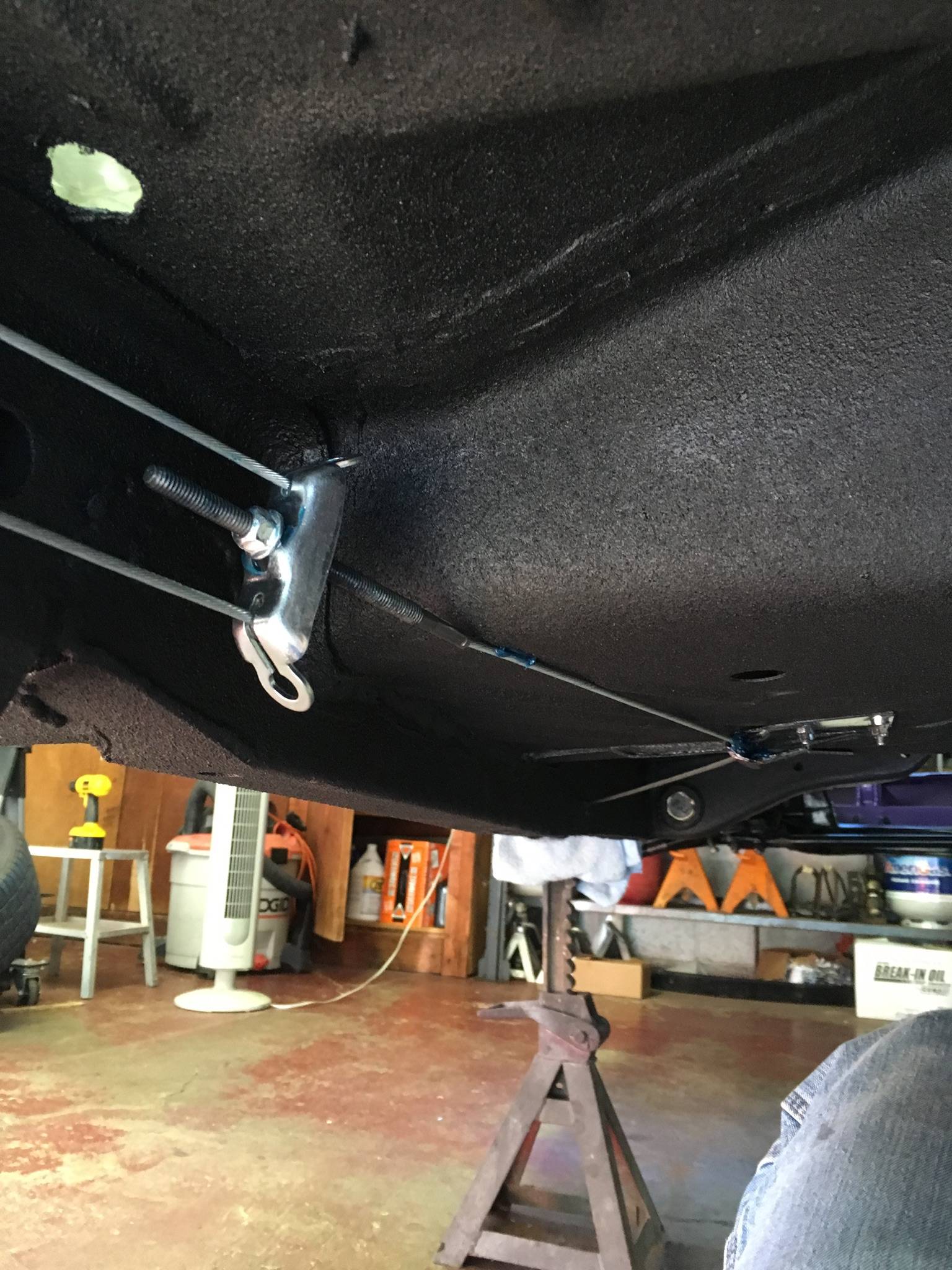

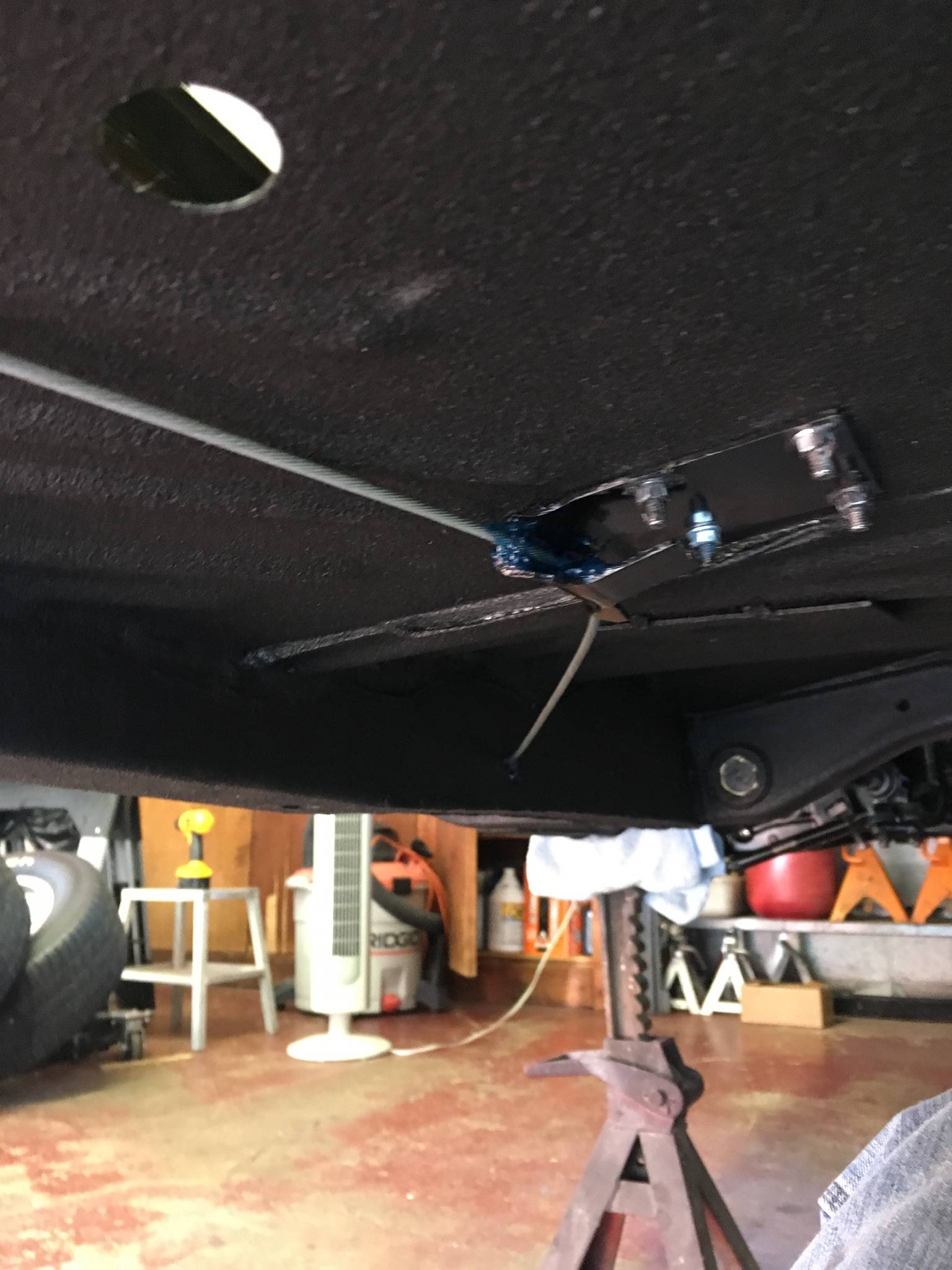

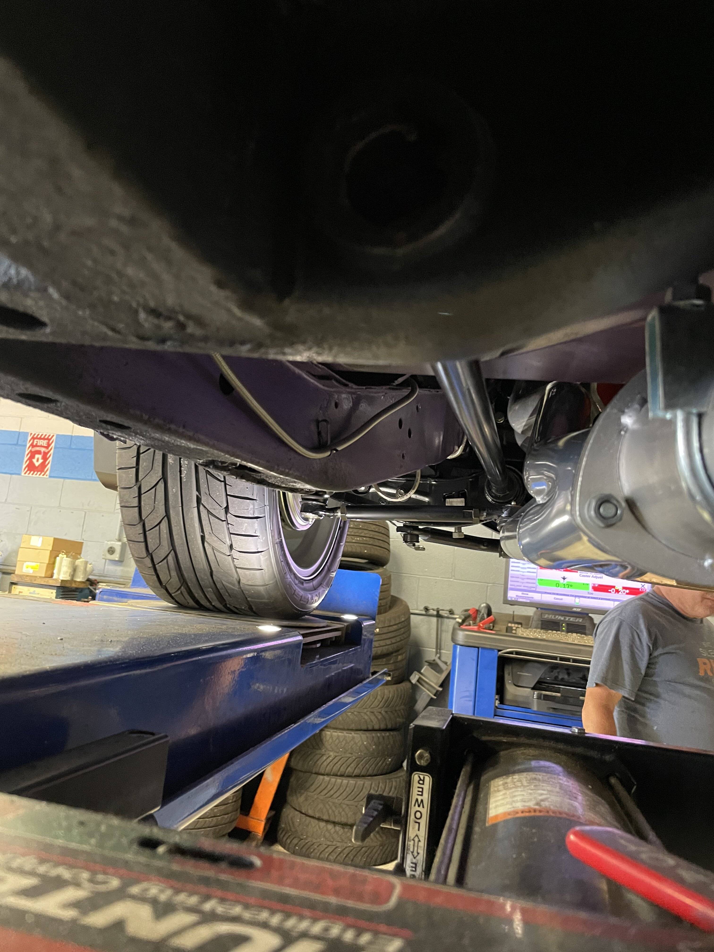

Hello Pistolgrip496,
I have a set of these frame connectors and was wondering how you routed the emergency brake cables since the path for them will now be blocked due to the frame connectors themselves.
I cut holes in the sides of the connectors so they route thru them.
I ran the cable through the connector

having welded in frame connectors and more building a track car...i would remove the rear eand and springs, engine and k frame etc as currently that unibody is flexing from all the weight hanging off of it, rather than at rest.

Doc Corey
Apr 8, 2018
132
30
Raymore, MO
I assure everyone that I lifted it on the rear axle and front tires. If it's going to flex, the 426 Hemi will probably be responsible...

@Doc Corey awesome build - what type of jack (if it's a 'jack') that's pushing up on the leaf spring in first post?
Also - what kind of paint/undercoating did you use on the bottom once you welded the frame rail connectors in?
70chall440
Dec 11, 2010
1,261
983
Western Washington
Typically I put sub frame connector in with the car on my lift, I have also done one on my Rotisserie, either way I have never had any issues due to the manner the car was supported during the installation.
