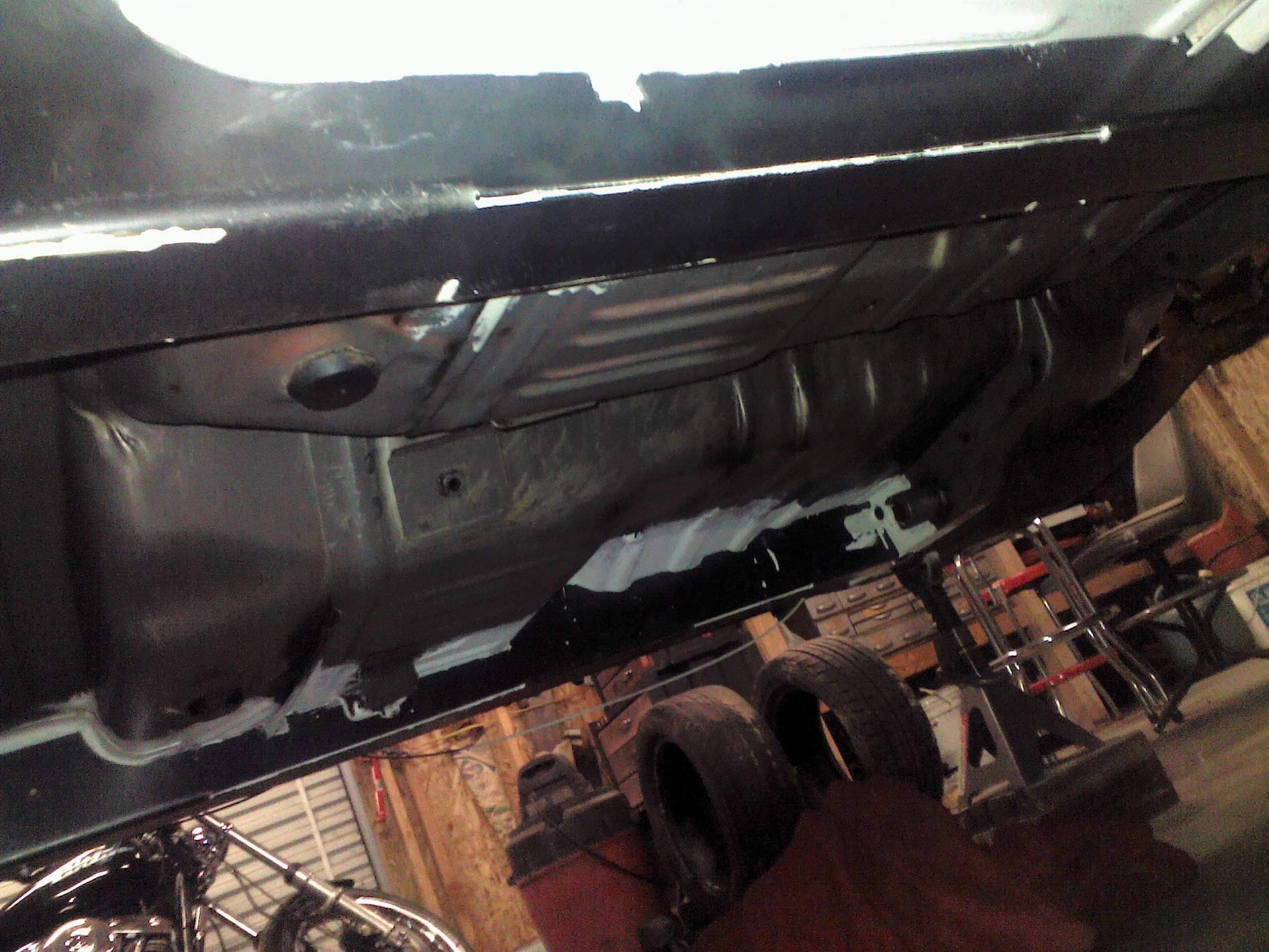

By happenstance I had mine up about 18"-2'. And was scaping, Wait trying to scrape the under coating off, Not going to good. As I laid on the floor and took a breath. I glanced to the side and the 55k btu torpedo heater caught my eye.
Had a 6" elbow and stuck it in. Slid it under and in seconds the undercoating fell off. So I would move every second or two, so the undercoating would not fall into the elbow. What didn't fall off would only have to touch with a scraper.
Under the factory under coating was kind of bright metal with stains of undercoating. So I did a light sand blasting to clean up.
All the interior was out
A second person would make it easer, turning the heater on and off.
My intention was to clean up a little, inspect and preserve.
I got a little carried away. In for a penny in for a pound.

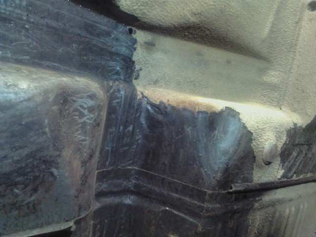

I saw a guy on You Tube removing it with one of those scale remover/needle pin pneumatic gun things.
It looked like it was easy and did a good job.

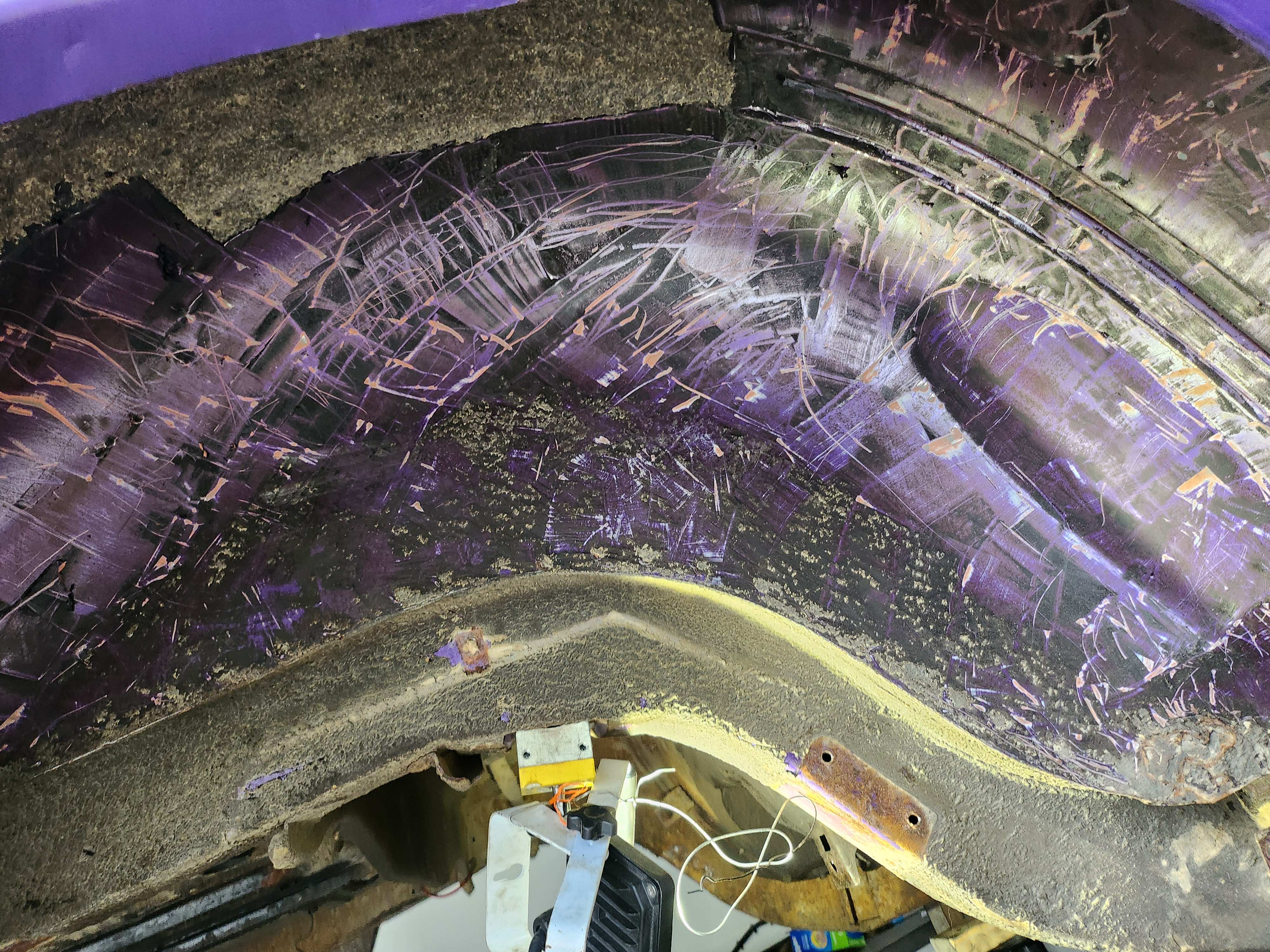

Thanks to all for the suggestions. The best combination for me was using a heat gun and the little Harbor Freight pneumatic scraper. I finished curved areas with a wire wheel.
