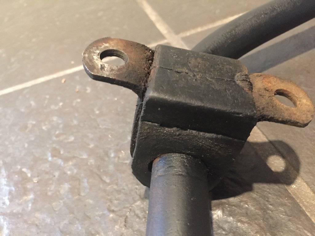

Cleaned up the front sway bar and brackets

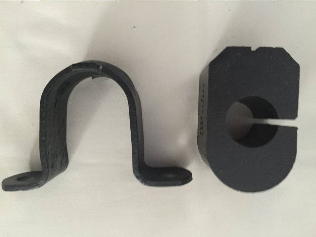

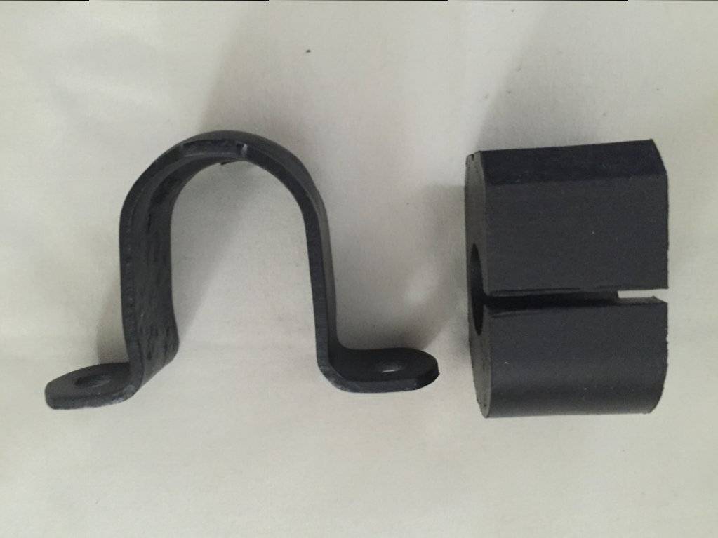

Purchased Moog K5241 Bushing Kit to change out the bushings (listed for Challenger and RT models w HD suspension)
The bushings fit the bracket appropriately, but: the center hole in the new bushing is too small
Sway bar measured w a micrometer = .85"
Original bushings (not in terrible condition) are one piece w no slit
Replacement bushings have a slit, the center hole measures slightly less .79"
This means the new bushings would have a slight gap opening at the slit when placed on the sway bar.
I would think they would compress around the bar when tightened down?
Is this the correct sway bar bushing or are there original (no slit) bushings available?)
Do not want to use poly!
Thanks for any feedback.
